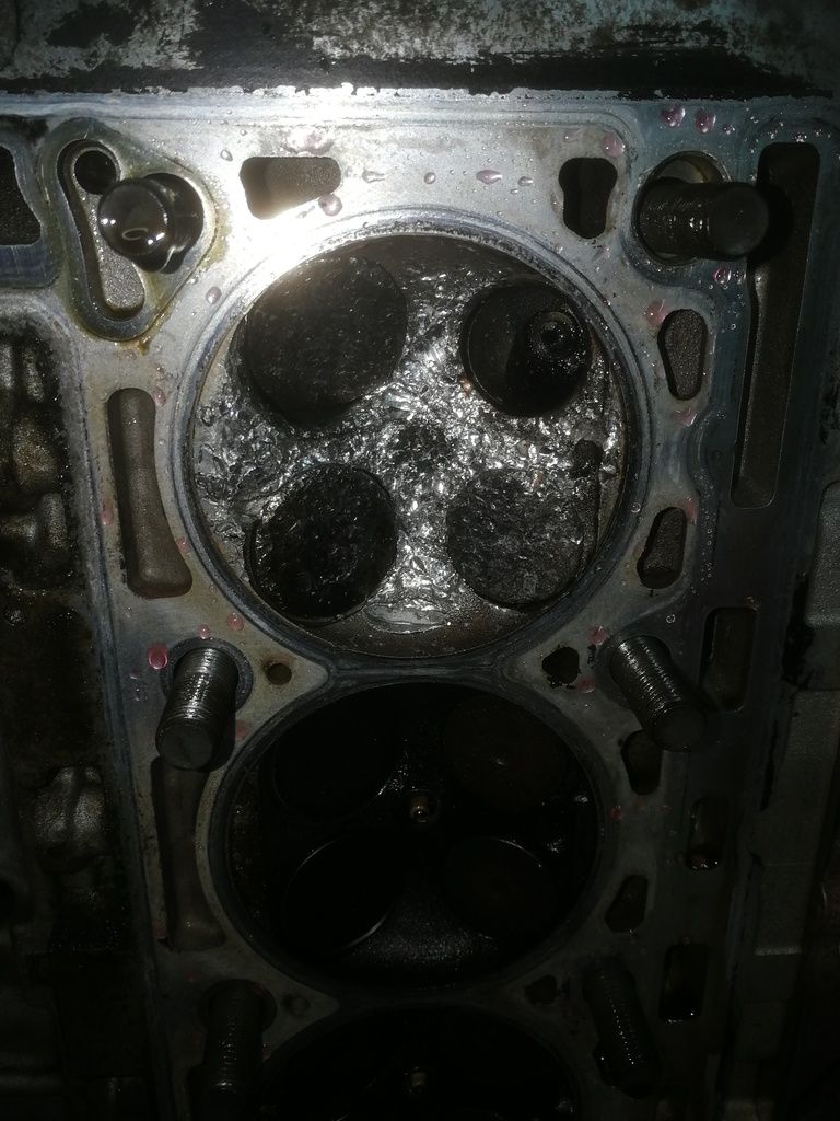

    Renault valves are two piece and are joined together by heat, the ones i have fitted are one piece (Supertec) so there is less chance of breaking due to heat cycles, although the car that my engine came out of was involved in an accident.
    When i was trying to get the head rebuilt or replaced, i was told it was quite a common problem with the valves breaking.
    Also the valve springs are not very strong, so there is a possibility of valve float at high rpm's and the valve touching the piston.
    Car at the time was running 305hp

  5. ianplymouth
    ianplymouth RSM Club Member
    I was sort of lucky, i didn't forge the engine before this happened, i would have left it as it was if it hadn't done this
    IMG_20171019_153101_zpsi0rhzhdf
    IMG_20171019_153240_zpsiqp83pqc
    I hate photobucket, doesn't look like i can upload pics now

    and that was a 250 engine and not the original 225 lump, that caused so much damage to the bore it only just took out the damage with full size over pistons
    Engine had done less than 40k miles
  8. Oh Shit, that looks very very bad.
