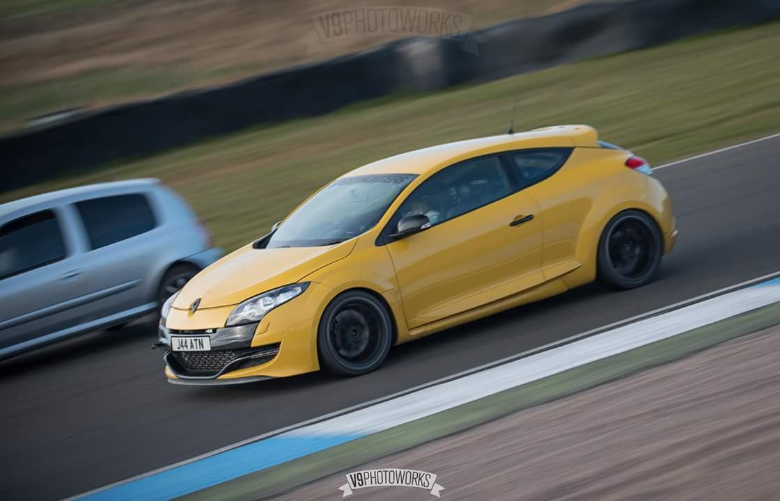

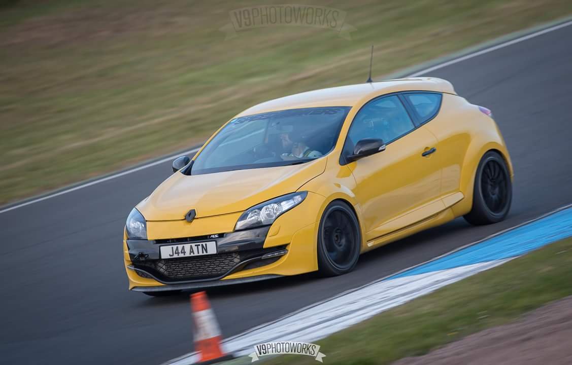

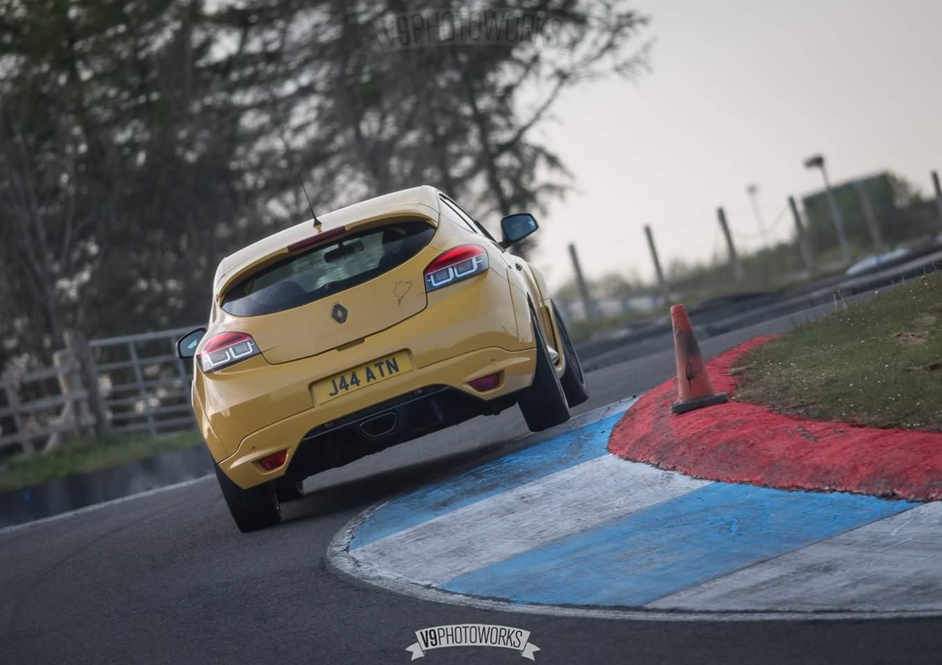

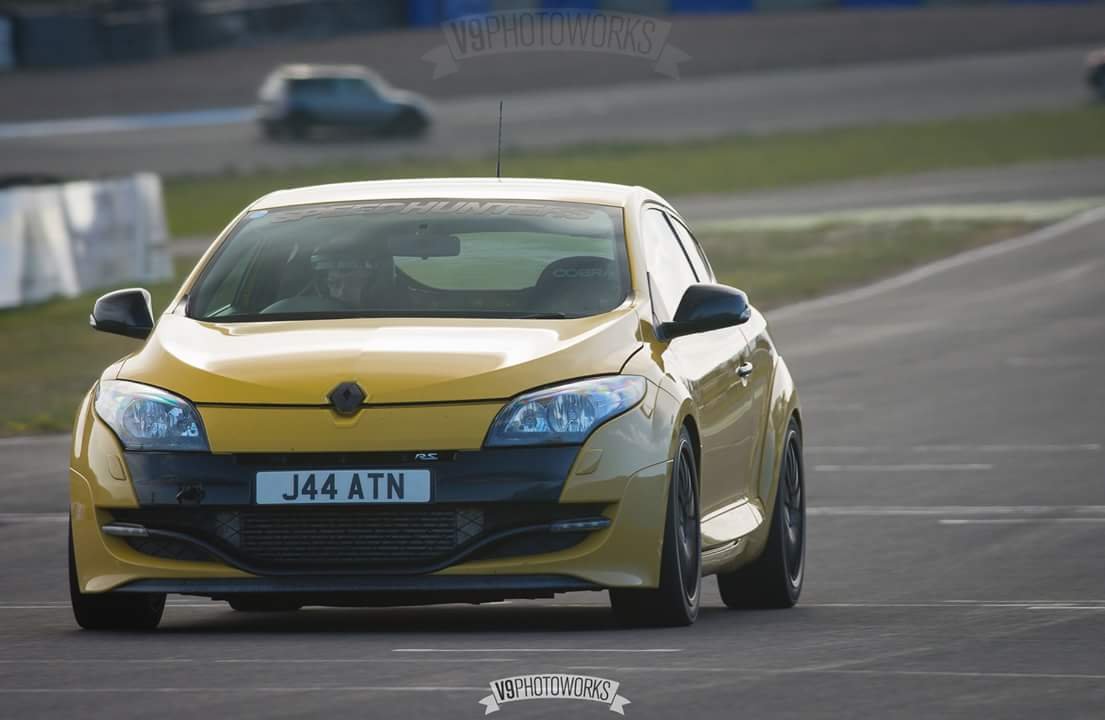

  34. -Jamie-
    Went to KH, car went well other than some fairly serious brake problems.
    Need to tweak the setup a bit more but for what's essentially an out the box setup it's bloody superb! [​IMG][​IMG][​IMG][​IMG]
    StephRS and Nigelo like this.
