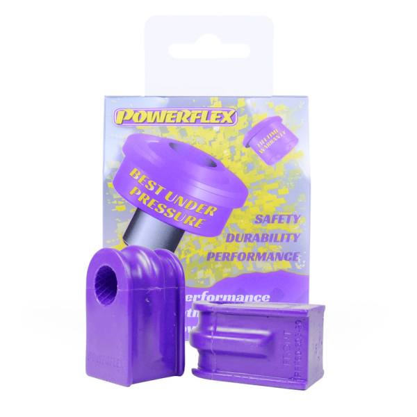

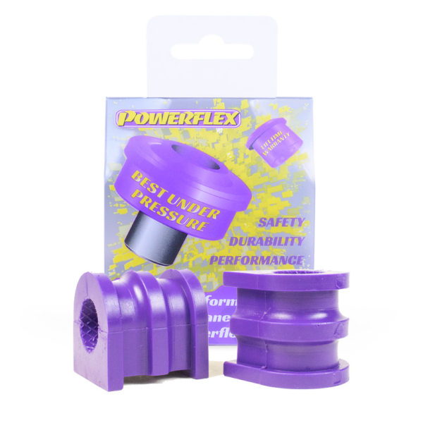

    and make sure it comes with the spacers for the bushes, the R26 has shorter bushes compared to the 20mm ones
  4. Would a Poweflex Kit have the spacers needed?
