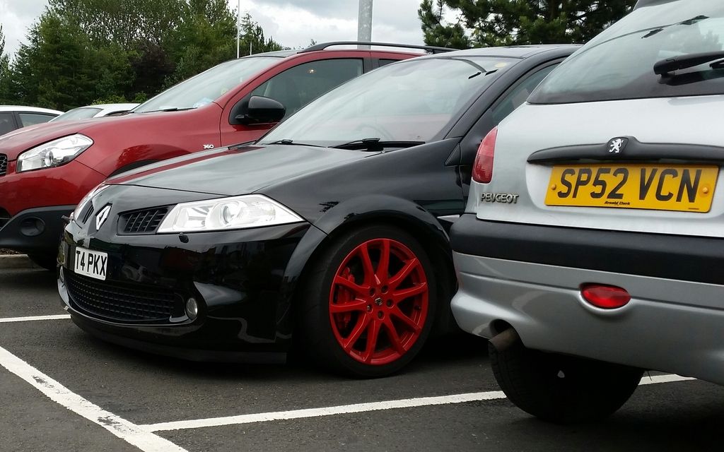

  1. Do I need to get bolts with a slightly longer thread size as the R26.R and R26 wheels have a slightly different offset, or is it too small to make a difference?
    Is the Standard thread length 28mm anyway?, would 33mm cause any issues?
    They are really growing on me in red, I may have to keep them like this..lol
  2. It has nothing to do with the offset mate it's the thickness of the wheel that determines the bolt length, if you used a spacer then yes otherwise no as the alloy wheel thickness is the same as an R26 wheel
