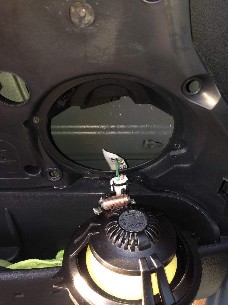

    I know there are hundreds of threads about this but none actually say what you have to do once you have the speaker off.
    Heres a pic of my speaker off, you can see at the bottom where the water is leaking.
    Do i just put sealant on the back of the speaker to stop the water from going into the pocket?
    Mark
  2. I put it a single bead of black silicone sealant all around the edge of the hole where the speaker contacts it, plus slathered a bit extra around the screw holes and bottom edge. Other than it looking a bit messy, you can't really use too much as it just peels off if you ever want to remove it, and you can't see it once the grill is back in place. I found the back of the speaker cones was all mouldy from the damp, so I sealed around the electrical connector with a bit of self-amalgamating rubber tape while I was at it. It all worked fine, but then I decided to take the stereo out and go back to hardcore "R" spec about a month later anyway :smile:

  8. Around the middle section of the door seal (bottom) if you pull the rubber seal it should clear the whole and water too :smile:

    Markblack@MRS RSM Trader
    Water runs down the back of the door card and comes in where they are bonded together
  12. As Mark says... This must be the design as there are drainage holes for the water to escape.. They just get clogged up hence the build up...
  13. Mine did the same and filled to the speaker! Just pull back the rubber seal around the bottom of the door and a load of crap/mud and mould will come out together with the water!
