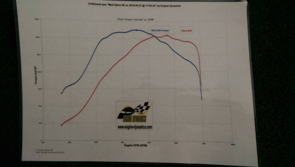

    done a few more bits to it since ive had it back from engine dynamics
    firstly i took it back 3-4 weeks ago to get it finally mapped, it made 309bhp and 325 ftIbs. really happy with evn in 6th gear you put your foot down and it pulls like a train.
