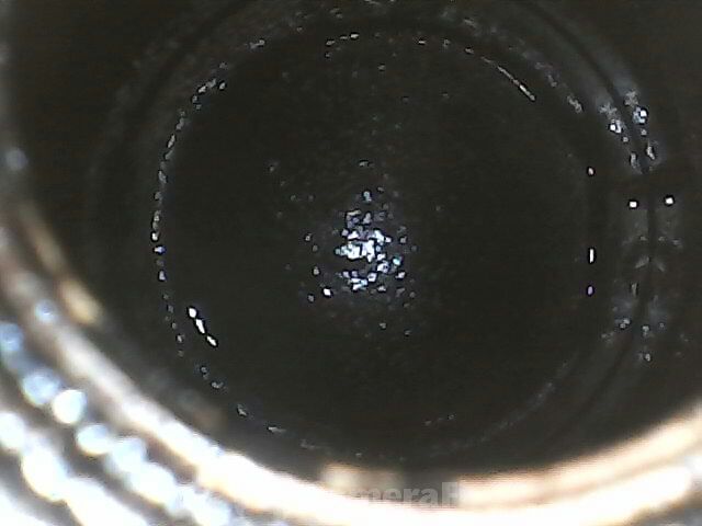

    somethings gone very wrong,
    Driving along the motorway and i smelt something but thought it was a lorry then look behind and a plume of smoke is coming from my exhaust :rage:. stopped and lifted up the bonnet and smoke was coming from behind the engine as well, i had thought it was the turbo. rung up the RAC got recovered home and decided to have look and started by taking the spark plugs out (i did think/hope the turbo had blown). spark plugs 123 were ok and when i pulled number 4 out it was black and covered in oil. looked in to the bore and its got a pool of oil in it. so it getting recovered to see whats really wrong with it tomorrow or monday
  7. Fuck that mate, thats terrible, especially when the car is looked after the way u do. Such a nice motor, i feel for u mate
  8. Surely that'll be something simple like a worn valve cover gasket or o ring on spark plug? But then is it a cambelt off job for the valve cover gasket on the f4rt
  9. Jesus mate, good luck, hope its something minor
  10. Doesn't sound good mate, keep us posted :cry::cry:
  11. Kev said it sounds like ring land failure unfortunately :worried:
  12. When my ring land failed the chunk of metal bounced about in the cylinder destroying the lower half of the plug and the exhaust valve.
    I wouldn't think the worst until you have had a look in the cylinder, it might be something much simpler.
  13. matt e

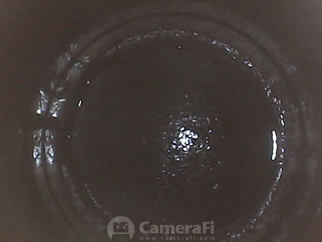

    got the car back from the person, they were not really interested on working on it. so i drove it back tonight very cautiously instead of paying another recovery driver. i bought a endoscope from amazon and took a couple of pictures of the piston.
    there seems to be a little chunk or something on the left hand side

  20. Ugly pictures , I hope it come's back soon to 100% :coldsweat:

    heard back engine dynamics, they put a borescope in and found its damaged the bore so will now need re-boring and the only pistons that are available when you rebore are forged ones. so im having the engine rebuilt and getting it forged and a few other bits done aswell.
    not very good news but i was kind of expecting it though :cry:
