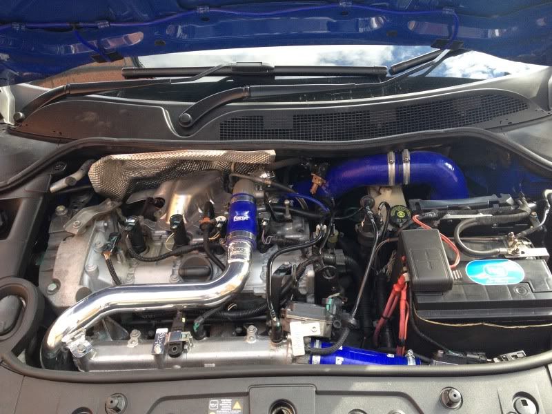

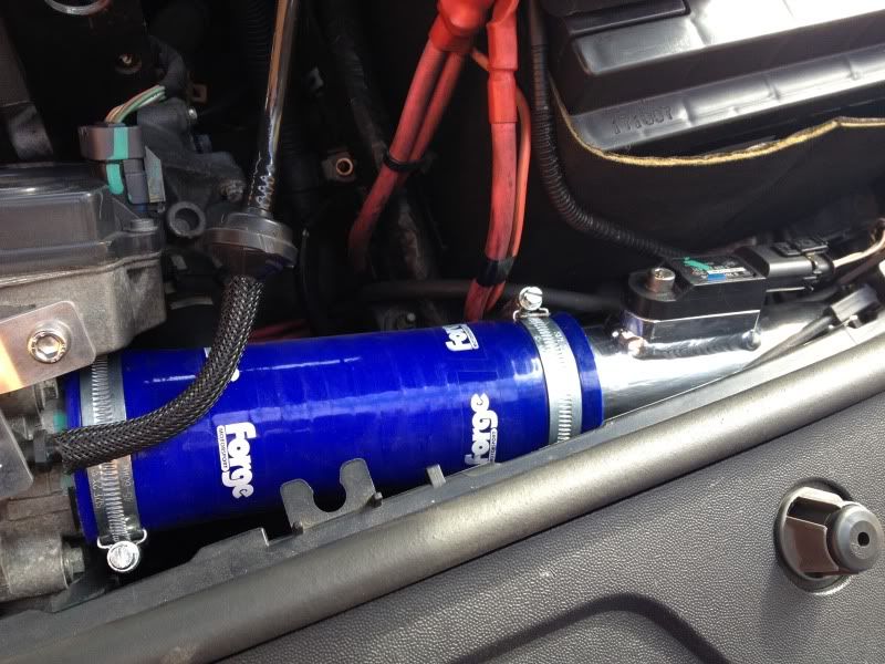

  3. i had the same with the pipe :worried: I get a new from forge....
  4. And fitted with no vibrations :-)
    while I was at it I replaced all my trim clips to these, so much better than standard ones

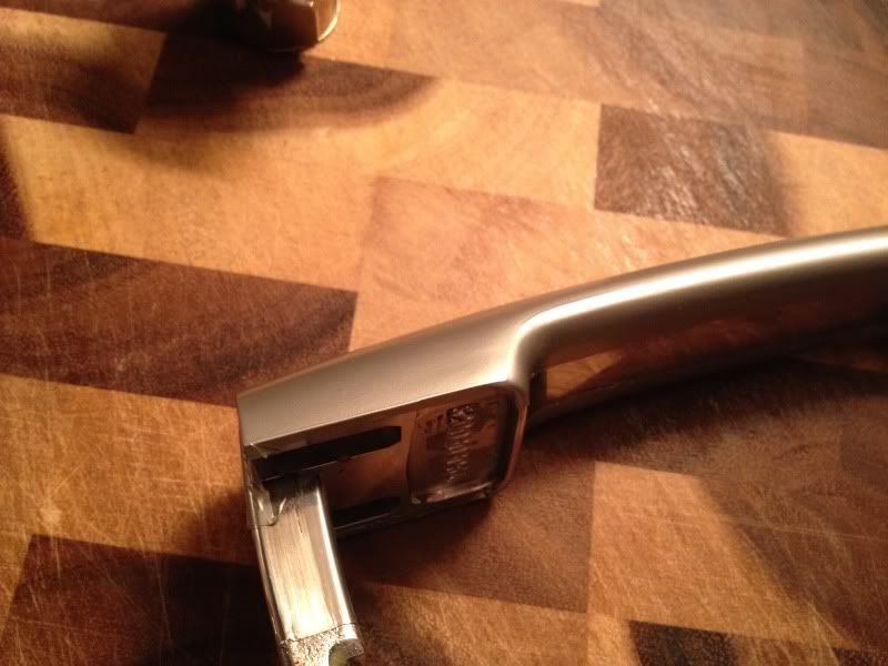

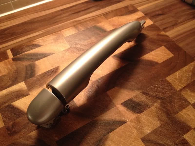

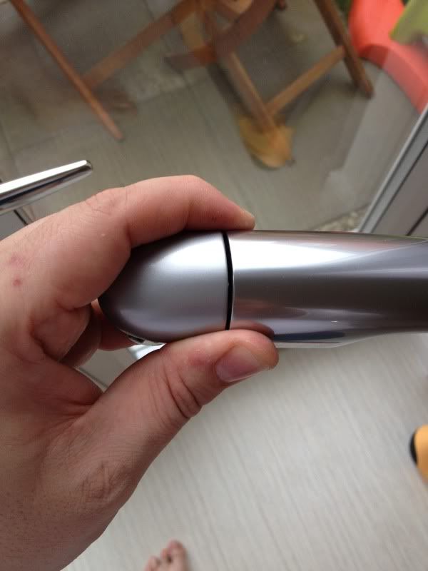

  11. Another job I've been wanting to do since I've had my megane, but it being low on my list I've left it.
    its the normal issue with the handle bits cracking. It's not just a paint its a foil/metal type cover on them. As I found out by slicing my finger when removing it :-/
    i decided to cover them with some very similar colour vinyl I had in my garage, if it didn't work I wouldn't be down any cash.
    Pics
    All done
    1 down 1 to go

  13. Good job mate, I can't make out what the 1st picture is though , something green
  14. That's the handle part, that's the colour underneath the silver foil material. It just pulls off nicely

  24. No pics :-( but had my drivers side shaft changed over and solved the annoying clicking I had and while I was at mark blacks he noticed that my top engine mount had dropped and this was causing the bad vibrations I had ( I thought it was the forge hard pipe kit I had on and was gonna strip the front end off today to check it out) had another new one there in half hour and fitted as the other one was only 3 months old and failed
