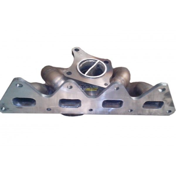

  1. Has anyone looked into this? Seems you could get made up a standard flange to v-band adaptor giving options for more turbos.
  2. You can make anything you like, would still retain the standard restrictive manifold though so when fitting an aftermarket turbo a custom mani would be my choice
  3. iirc the standard manifold can flow around 400ish
  4. Tbh you'd be better o getting the biggest/baddest hybrid you can get.
    it would be kinda hard to fit a twinscroll turbo with vband so performance will decrease!
    never seen 400bhp out of them though?
  5. get a v band manifold then pretty much whatever turbo you want
