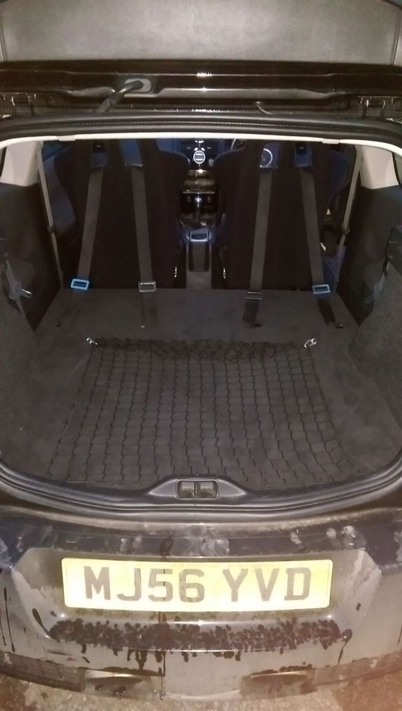

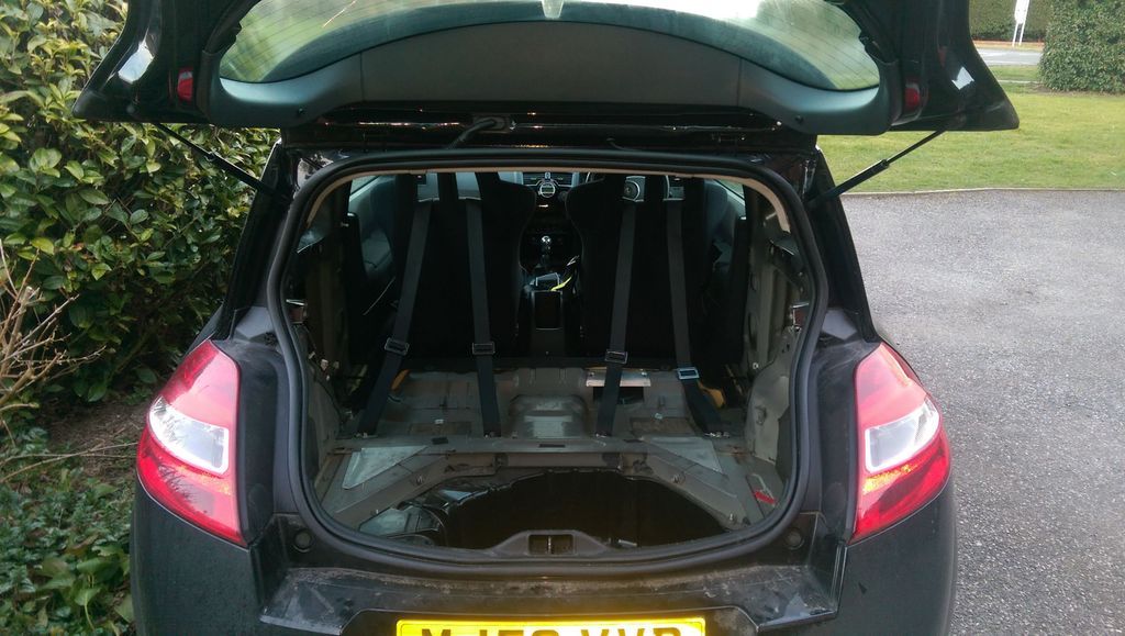

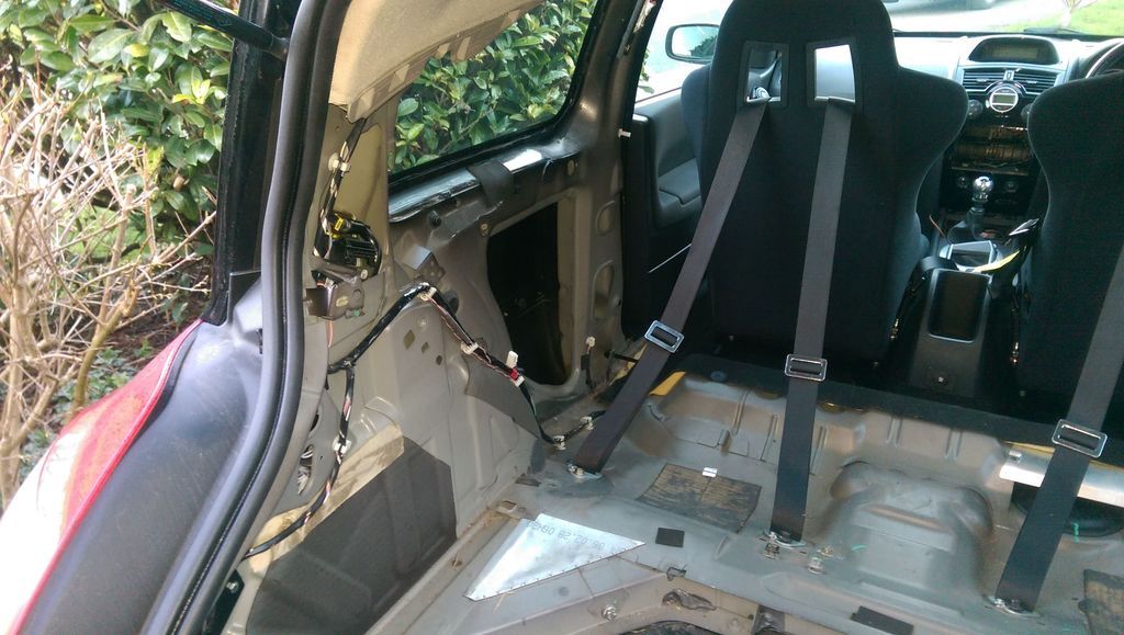

    At this point I removed the rear seats -
    Then I removed some more bits from the boot.
    But this did make things loud and it looked un tidy. I had some materials lying around so i built a false floor, its added 7g but I reckon I have removed almost 50kg from the car so I maybe able to live with it and ultimately its functional.
    With a net in place -
    At this point I bagged a harness from Dave, its only a single mount but will do the job until new seats arrive and I have some more money.

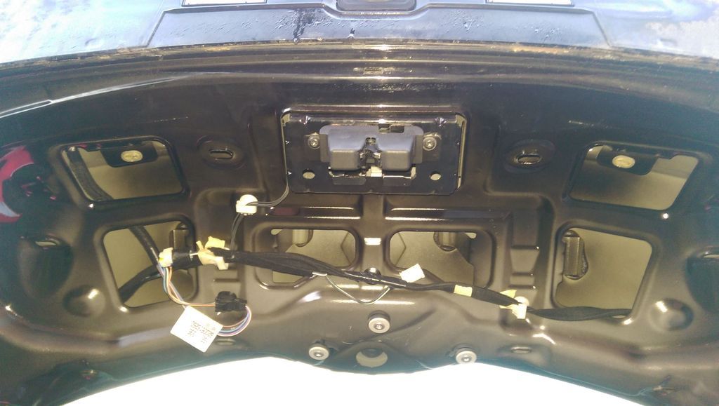

  4. [FONT=Calibri, sans-serif]Quick update... finished fettling with the camera mounts in thecar for use on track now all the gopro attachments had arrived.[/FONT]
    [FONT=Calibri, sans-serif]So first step was to constructa mount from the gopro gooseneck and attachments which will allow me to swapbetween my phone and a gopro simply.[/FONT]
    [FONT=&quot][​IMG][/FONT]
    [FONT=&quot]Removed the rear reading lightand fitted a 3m mount. -[/FONT]
    [FONT=&quot]Resulting in this -[/FONT]

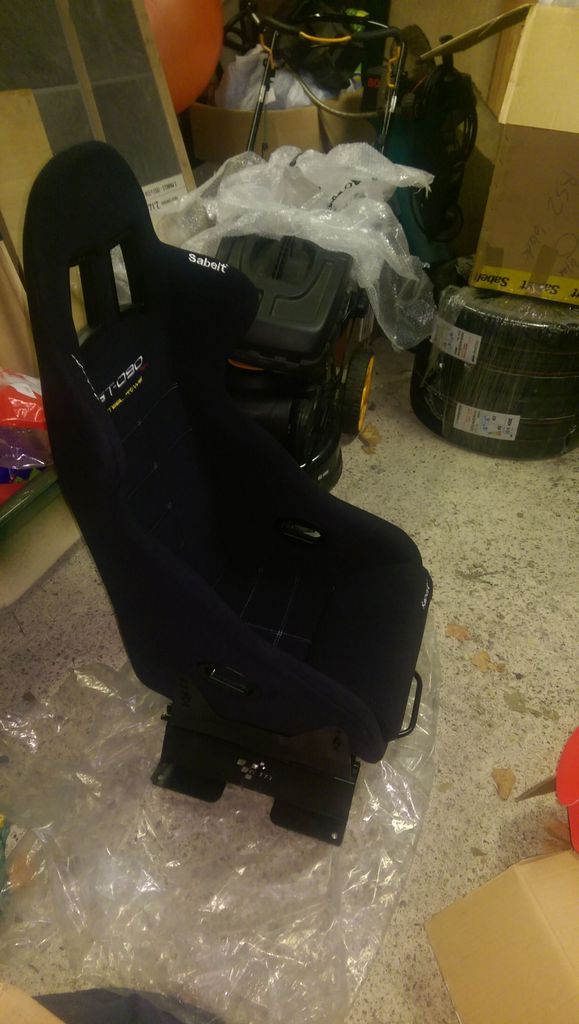

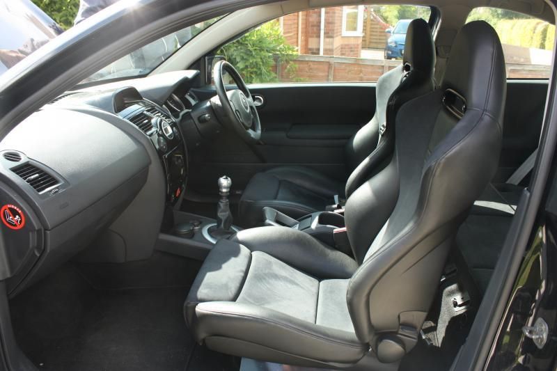

  5. [FONT=&quot]I sold my Recaro Trendlines and the bloke came to collect them(for his Toyota Hilux!) so next up was some lighter fixed back buckets. Alwaysbeen a Sabelt fan and these tick the box for me (mainly as all in - runners,side mounts, seats and harnesses were less than i sold the recaros for!). Theguys at GSM performance did a cracking deal so I got underway with getting theminstalled. Unfortunately no pictures during but plenty after. A pretty straightforward bit of kit to fit. The worse things to fit where the KTEC subframeswhich was disappointing given their price.[/FONT]
    [FONT=&quot]Seats built up in the garage - [/FONT]
    [FONT=&quot][FONT=&quot]http://s1060.photobucket.com/user/Tobyswain/media/Car/IMG-20141010-WA0004_zpsjisnjdb2.jpeg.html][​IMG][/URL[/FONT]]
    [FONT=&quot]Fitted -[/FONT]
    [FONT=&quot]
    [FONT=&quot]http://s1060.photobucket.com/user/Tobyswain/media/Car/1401286_10152716484256405_4603048773475486966_o.jpg.html][​IMG][/URL[/FONT]]
    [FONT=&quot]
    [FONT=&quot]http://s1060.photobucket.com/user/Tobyswain/media/Car/10714495_10152716484301405_8865204507550567607_o.jpg.html][​IMG][/URL[/FONT]]
    [FONT=&quot]
    [FONT=&quot]http://s1060.photobucket.com/user/Tobyswain/media/Car/1913443_10152716484406405_1657704230346573443_o.jpg.html][​IMG][/URL[/FONT]]
    [FONT=&quot]
    [​IMG][/FONT]
    [FONT=&quot]I am on the lookout for theRenaultsport seat covers as they do a more black and logo’d version.[/FONT]
    [FONT=&quot]To finish off I then had set ofthe Nankang NS2R's in the 120 track compound fitted to complete ready forBlyton on Sunday.[/FONT]

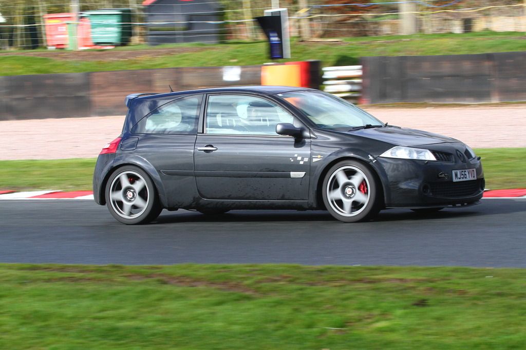

  6. Did a trackday on the 26th October at Blyton park so a few pictures from there.
    And a video....
    https://www.youtube.com/watch?v=iqV_nMdbqTE
    Car performed well generally (until Lunch!) and it was my first chance to test every change i had made so I was finding my feet with dialing in suspension and tyre pressures.
    Just before lunch I got blacked flagged as the marshall thought he could smell gearbox oil, must have a good sense of smell from 100m but needless to say I came in as it was plausible due to the fact that it had just been changed and there may have been some residue. Evidently there wasn't an issue with the gearbox but there was a what appeared to be a potentially fatal noise coming from the engine with a god awful metallic tapping/ticking noise coming from the bay. We had a quick look, swapped plugs and injectors around but didn't seem to cure it so I left it to cool down at Lunch and went to re-asses after, it was making the same noise so left it for the rest of the day with the plans to limp it home (didnt seem down on power, nor got louder/worse when engine speed increased). Left Blyton at about 4pm and went via a petrol station about 5/6 miles away. On arrival the ticking had stopped. Mix of emotions, relieved it was looking promising, pissed that i had missed half of my day over something simple like a sticky lifter. It hasn't missed a beat since, though its probably only covered about 250 miles since.

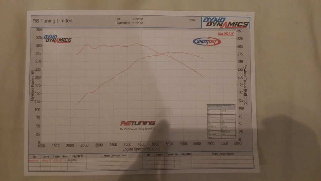

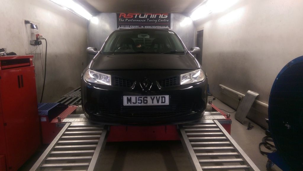

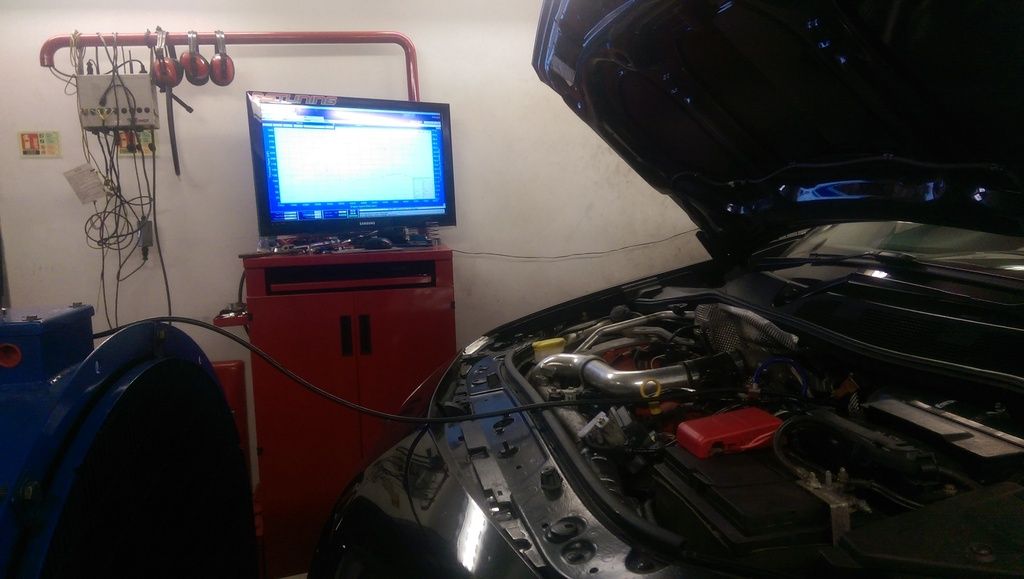

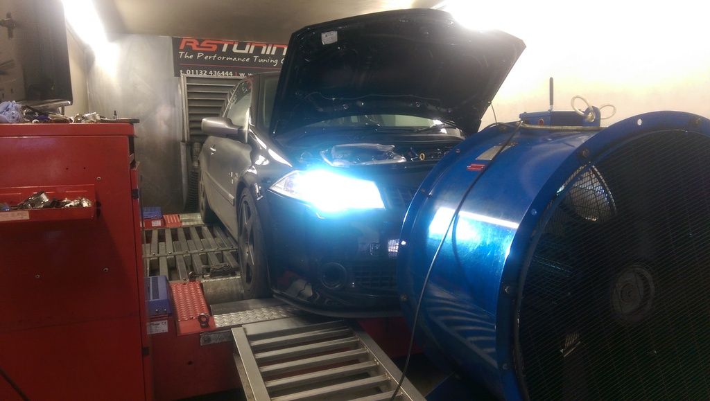

  9. So took a visit to see Paul @ RS Tuning today with the view to map out the EML issues and have the map tweaked as it was allegedly held back due to the slipping clutch. Greeted by the guys and had a chat about the car,seemed to be reassuring that it was the clutch that was the reason it was held back etc and Paul strapped the car down. Loading up the previous graphs the car actually made 261bhp/270ftlb. Paul did a comparison run and it made264bhp/271ftlb. He set about mapping it.
    It made power of just over 280bhp/300ftlb (which Paul tried to cap it at for as long as much as possible).The thing that really impressed was not only the ability to make good power but how long he spent fine tuning the torque curve to maximize its power through the rev range and to make sure the fueling was spot on (of which he must have spent 15 minutes tweaking). Overall, not that I'm chasing figures the power has made a noticeable difference lower down the rev range and I’m really happy with it.
    [FONT=&amp]Pics & a couple of from the day.
    [/FONT]
    [FONT=&amp][​IMG][/FONT]
    [FONT=&amp]
    [​IMG][/URL[/FONT]]
    [FONT=&amp]
    [​IMG][/URL[/FONT]]
    [FONT=&amp]I have already misplaced the graph with the AFR but Paul spent a hell of a long time tweeking the fueling to makre sure it was pretty much flat all the way through.[/FONT]
    [FONT=&amp]With a chart -[/FONT]
    One thing Paul did say was that he knew that the car had the airbox mod done and that it had been done since his last map. He said he knew because he had to tweak the fuel trims to suit. Suggesting that the increased airflow is certainly noticeable so it can certainly be considered a positive mod.

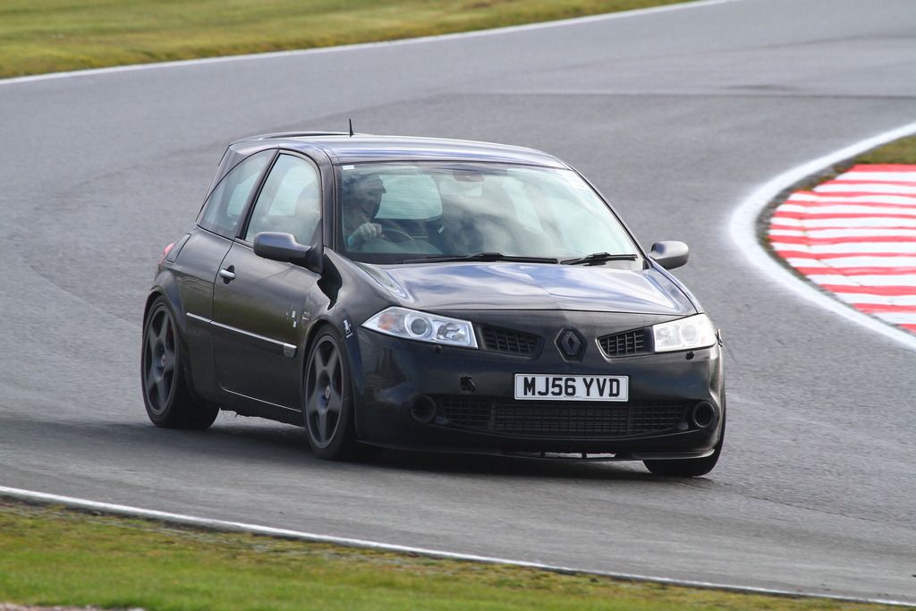

    Track day booked for the 31[SUP][FONT=&amp]st[/FONT][/SUP][FONT=&amp] March at Oulton Park so next up is getting the car sorted andready and then I think the next purchase will be more bushes and some more geo/corner weighting.

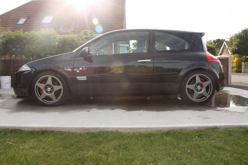

  11. [FONT=&amp]So I've been a little busy over the last few weeks with a few additions here and there spurred on by a foolish mistake of selling car parts without replacements and in time for the track day at Blyton...[/FONT]
    [FONT=&amp]
    First up was to get the coilovers on as i had sold the r26 dampers and cooksport springs.
    [/FONT]
    [FONT=&amp]
    Hub still needed moving up 10mm or so at this stage.[/FONT]
    [FONT=&amp][​IMG]
    [/FONT]
    [FONT=&amp]So I started to play around with heights and camber etc at this stage. I mirrored another Megane's setup that's a very similar car as a benchmark until I can get all the geo setup and corner weighted and here is how she sits.[/FONT]

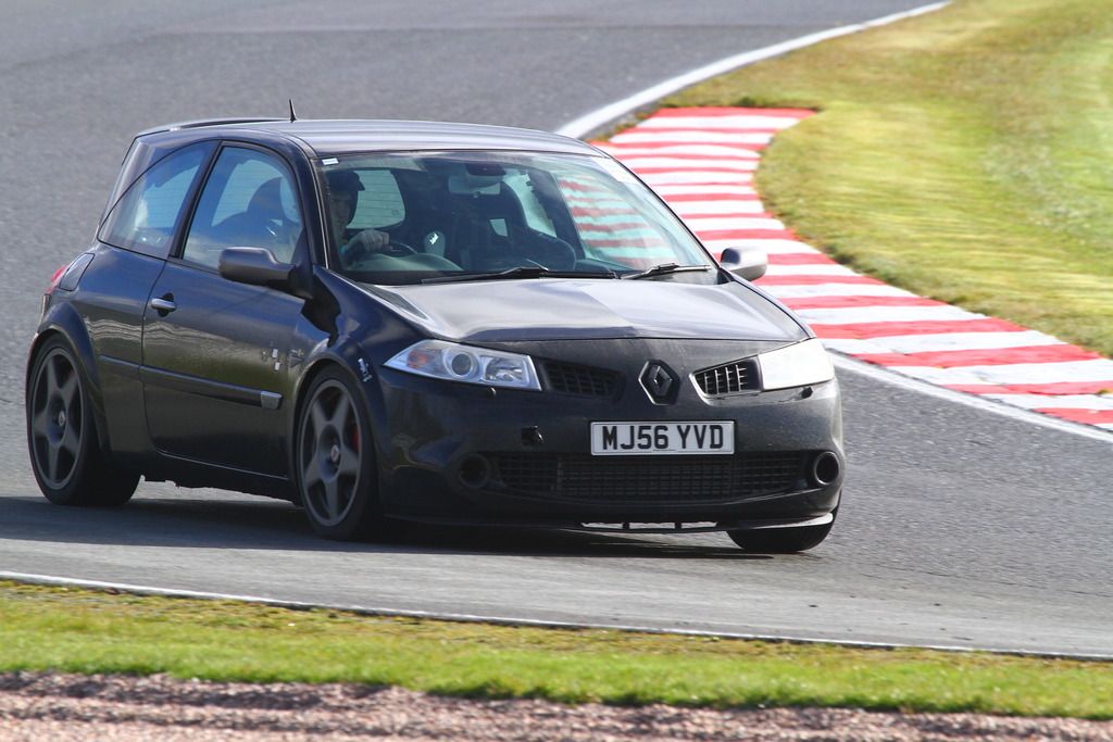

    Hopefully Oulton next Tuesday will be the first of several track sessions this year that should be reliable with the work done! Then there's more to come!

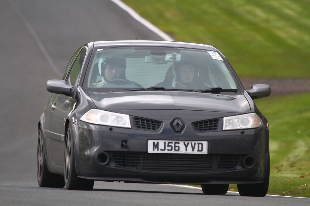

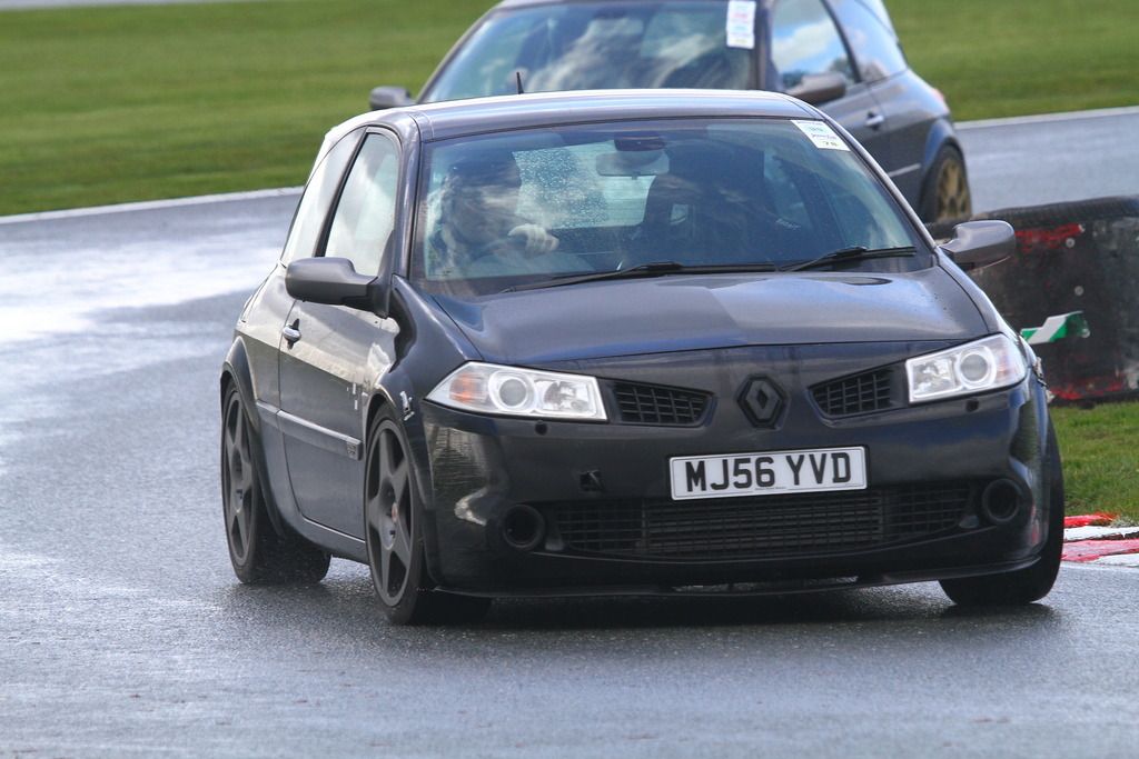

    Turned up as a passenger with Dave to the day at Cadwell on the 14th and there was a good turn out from here with plenty of r26r's in attendance and it was a great day.
