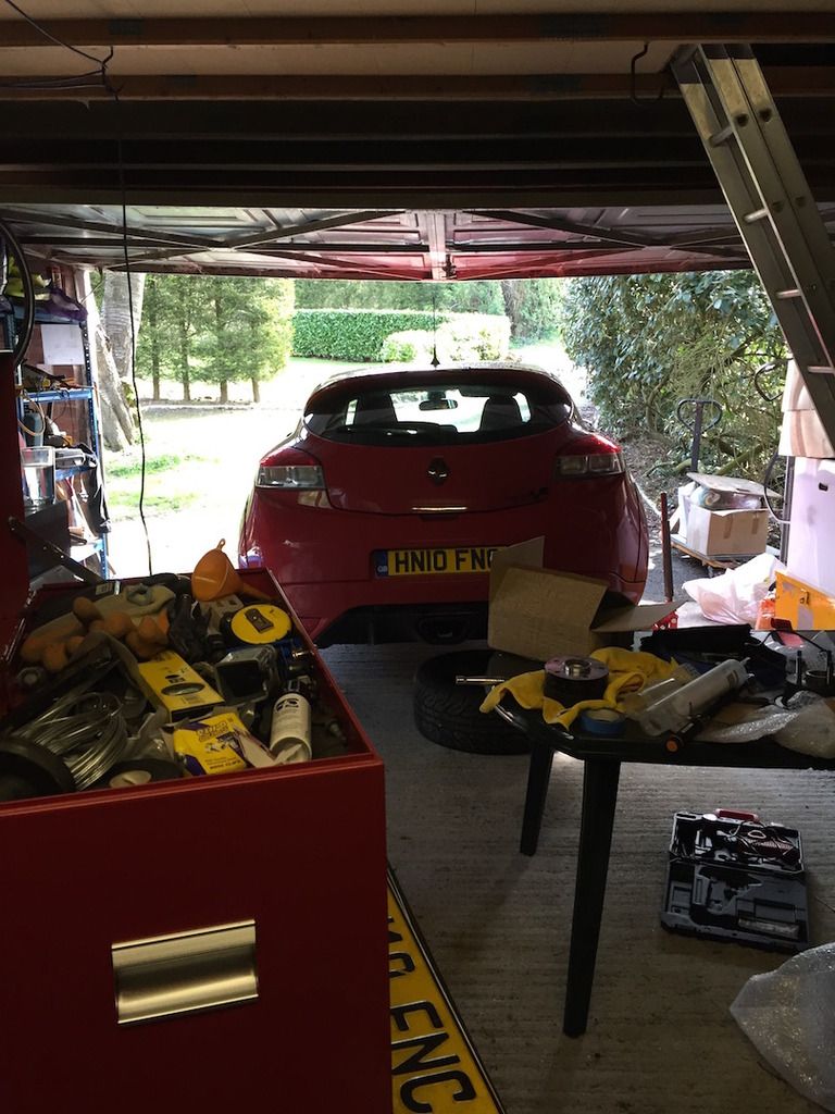

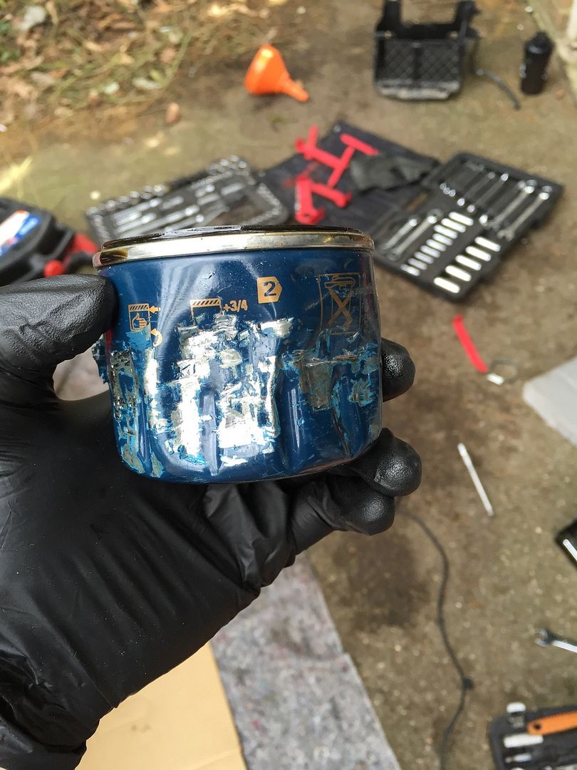

    bastard oil filter

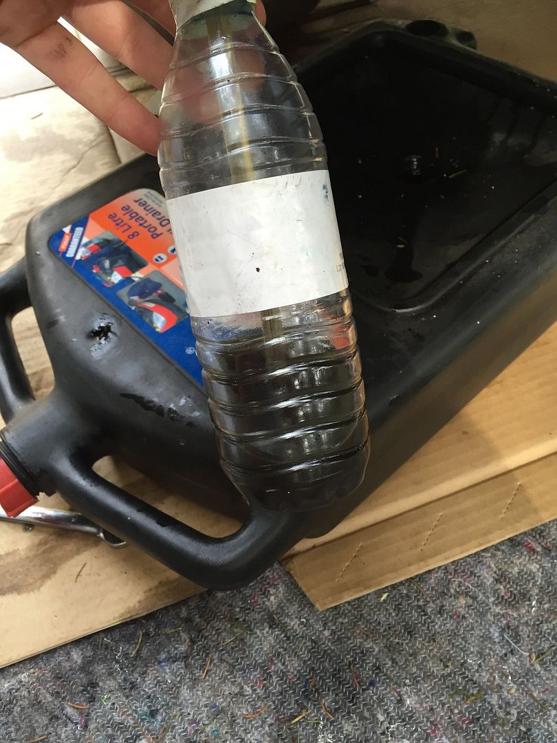

    clutch fluid was rottttennnn

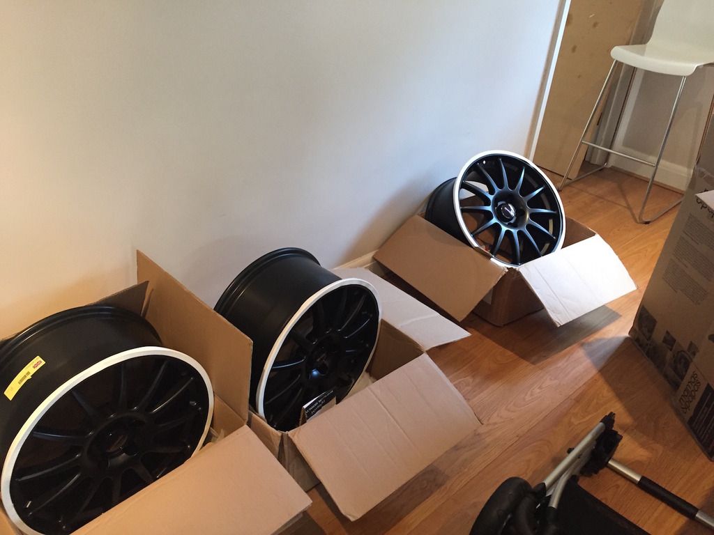

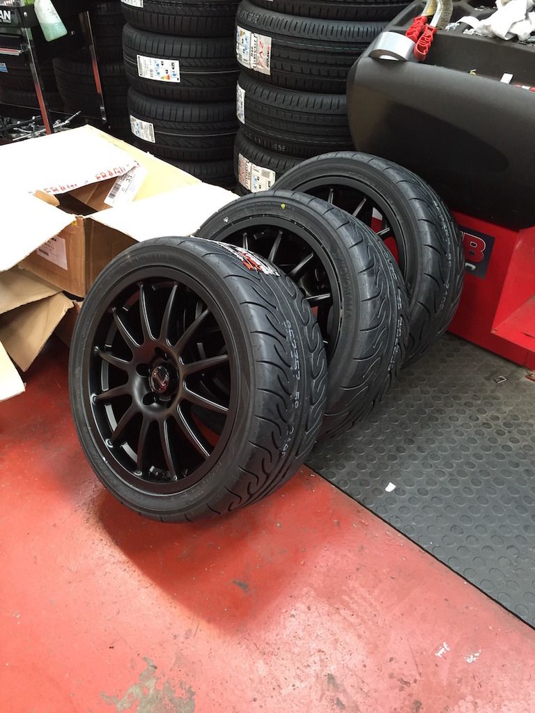

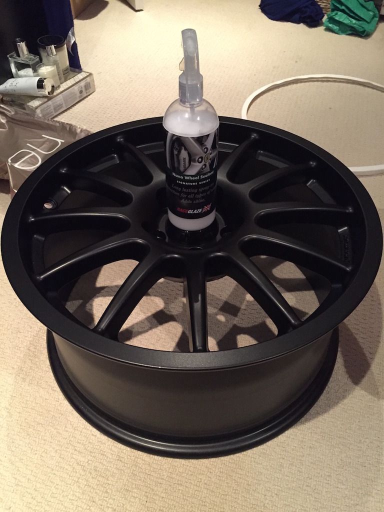

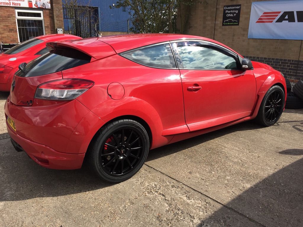

    some 18" td 1.3's in my life with ad08r's in 245/40/18
    sealed in raceglaze nano seal
    [​IMG][​IMG]
    looks great, very happy

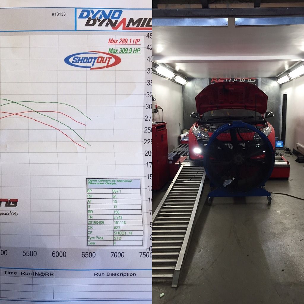

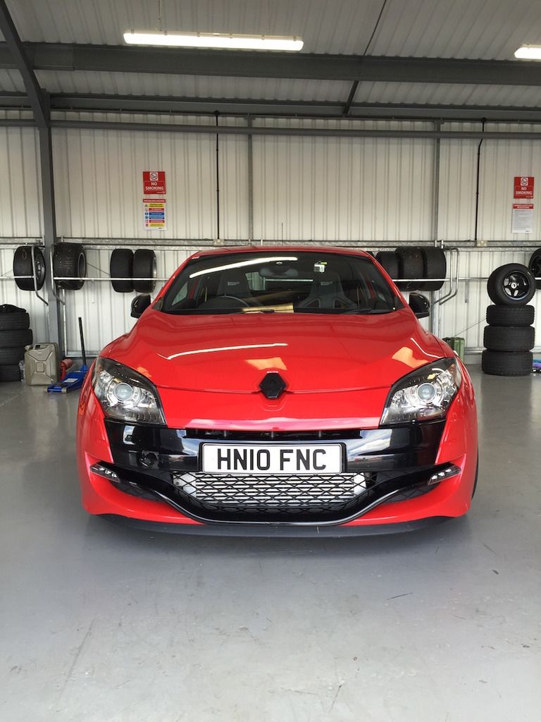

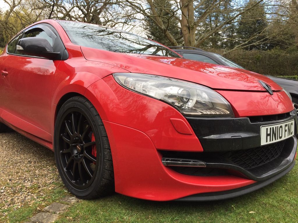

    trip to rs-tuning for decat and remap went well, paul said the intercooler from k-tec was a bit dated and didn't flow great but happy with 309 for now, pro alloy cooler soon.
    [​IMG][​IMG]

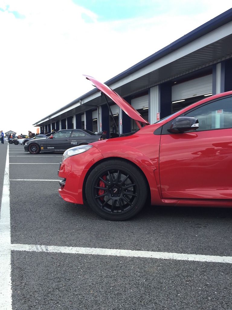

    then time to get it out on track to see what all the work was about
    [​IMG][​IMG][​IMG]
    car was great, unfortunately it started chucking down about an hour after I arrived so didn't get much time on track, I ran the ad08r's in the damp but not the soaking wet, they performed brilliantly, no videos worth seeing as after my first 5 mins to warm up they made me take the go-pro down, needed to be tethered, ran like a 1:00 lap in my first sessions, was obviously a lot more in it, sure I went faster than that in second session but didn't have any video or timing running. most importantly enjoyed it a lot and car was solid, bedford autodrome next saturday

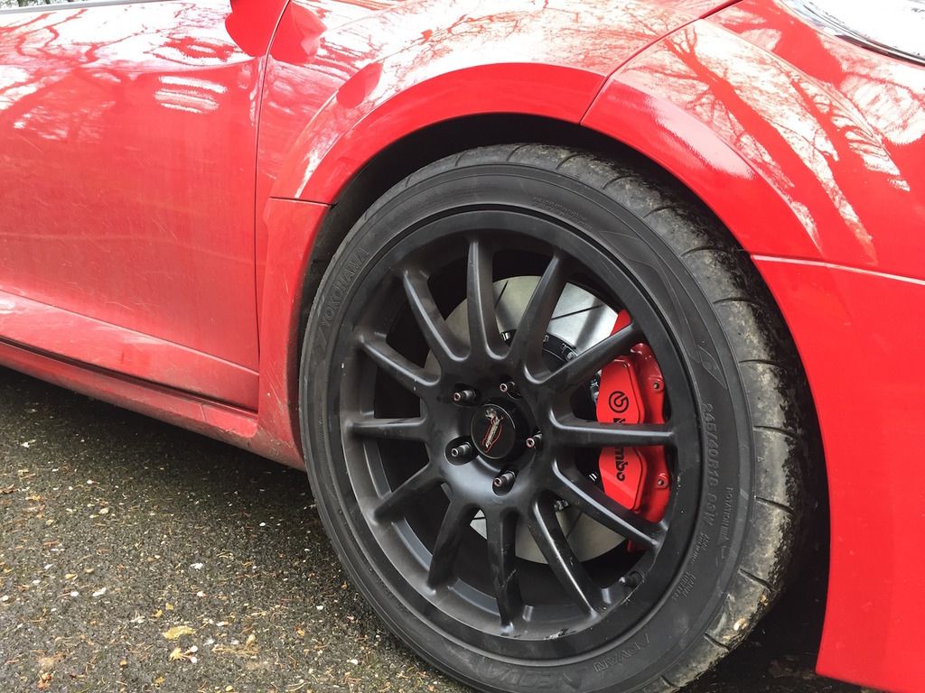

    Can I ask what width and offset the wheels are?
  14. yeah sure bud, they're 18 x 8.5 et 55, tyres 245 40 18

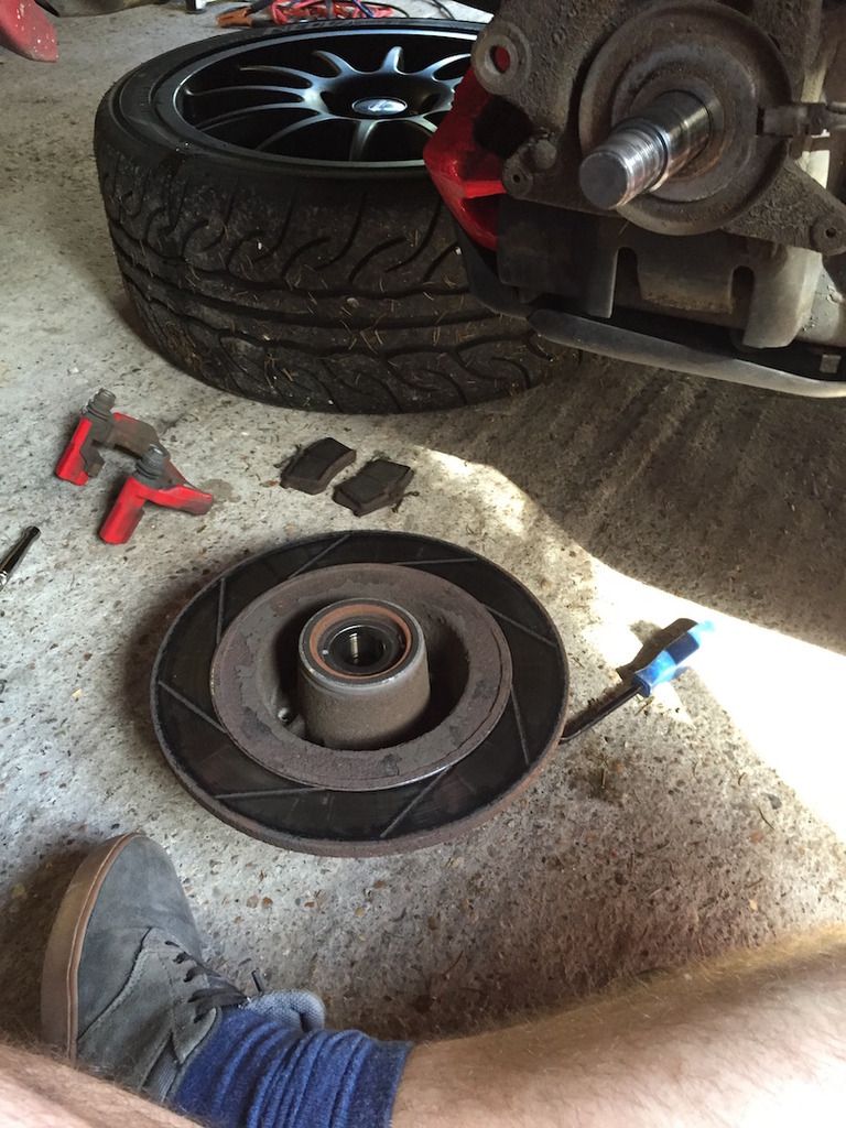

  18. So yeah spent some more time in the garage naturally

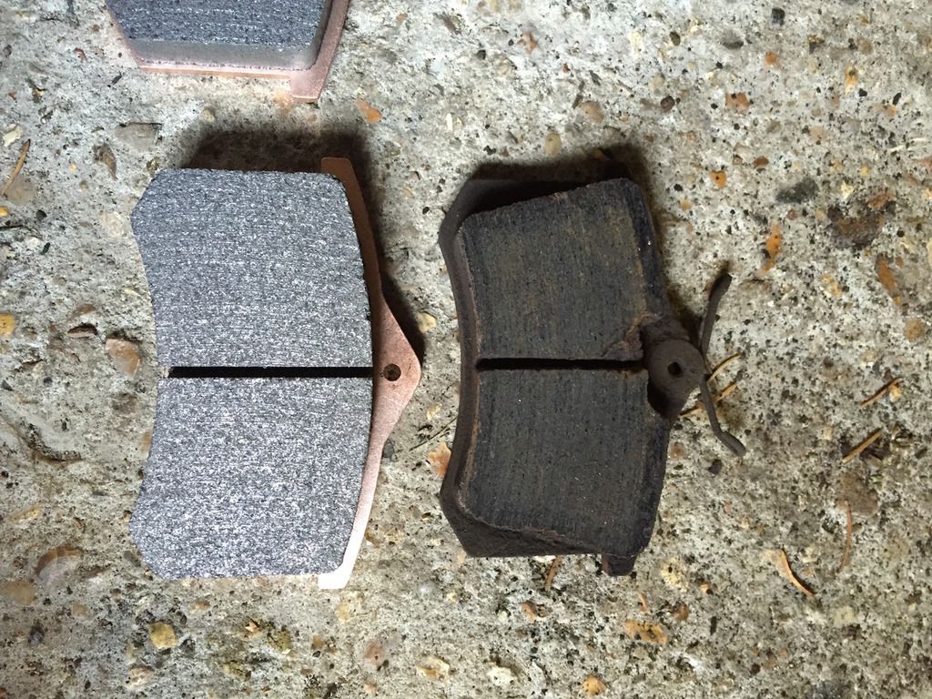

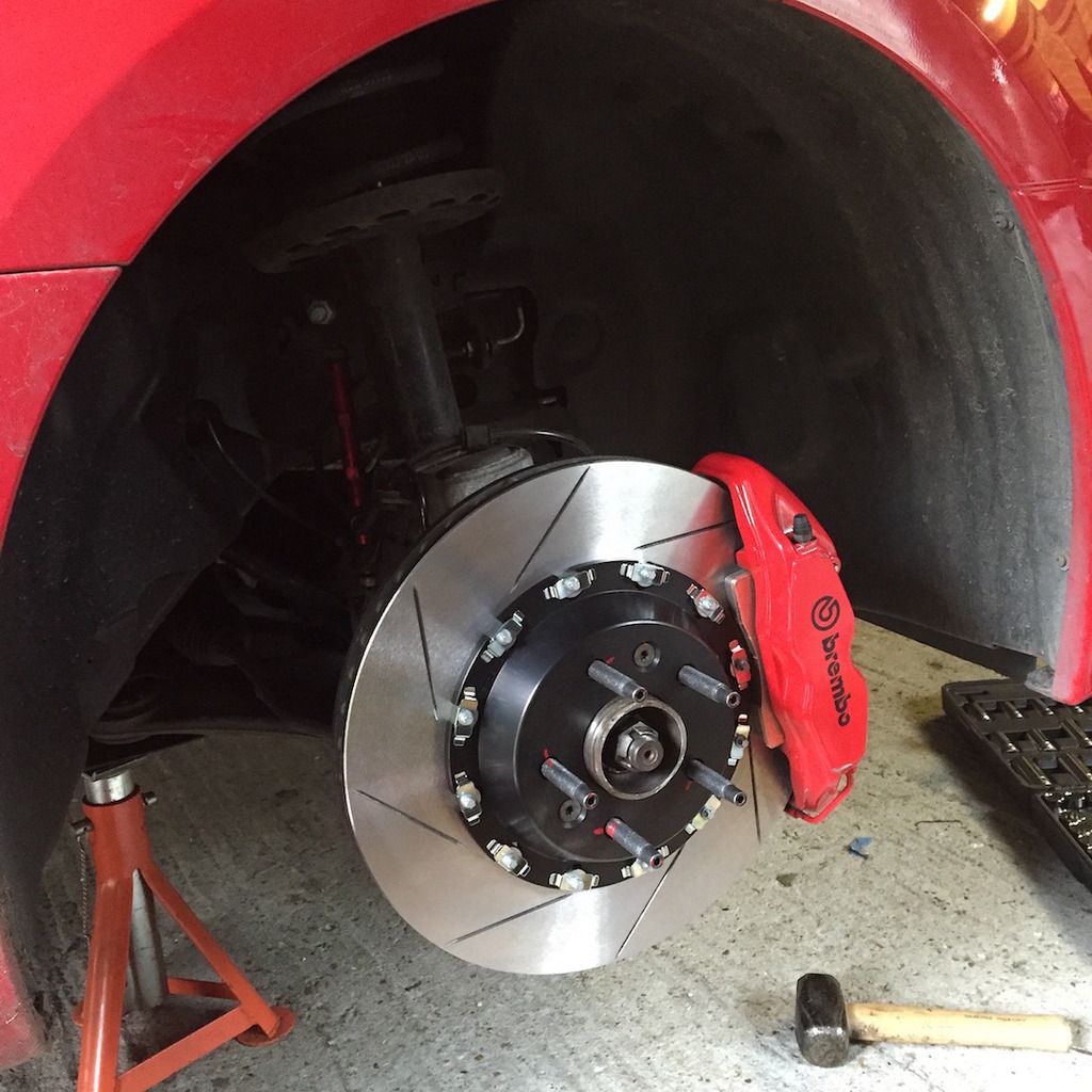

    the brakes where on their last legs so I felt like an upgrade, front 355mm reyland with sprung floating hat upgrade, new rear cup discs, carbon lorraine rc5+ pads all round, pure motorsport 75mm stud kit now I'm not using spacers the 90mm studs where way too long. I used paint marks to check up on the studs not moving after loctiting.
    found the rear pads weird, apparently they dont use anti rattle springs and as you can see the pad surface area is much larger compared to ds2500. I now get pad knock and front and back but dont really care

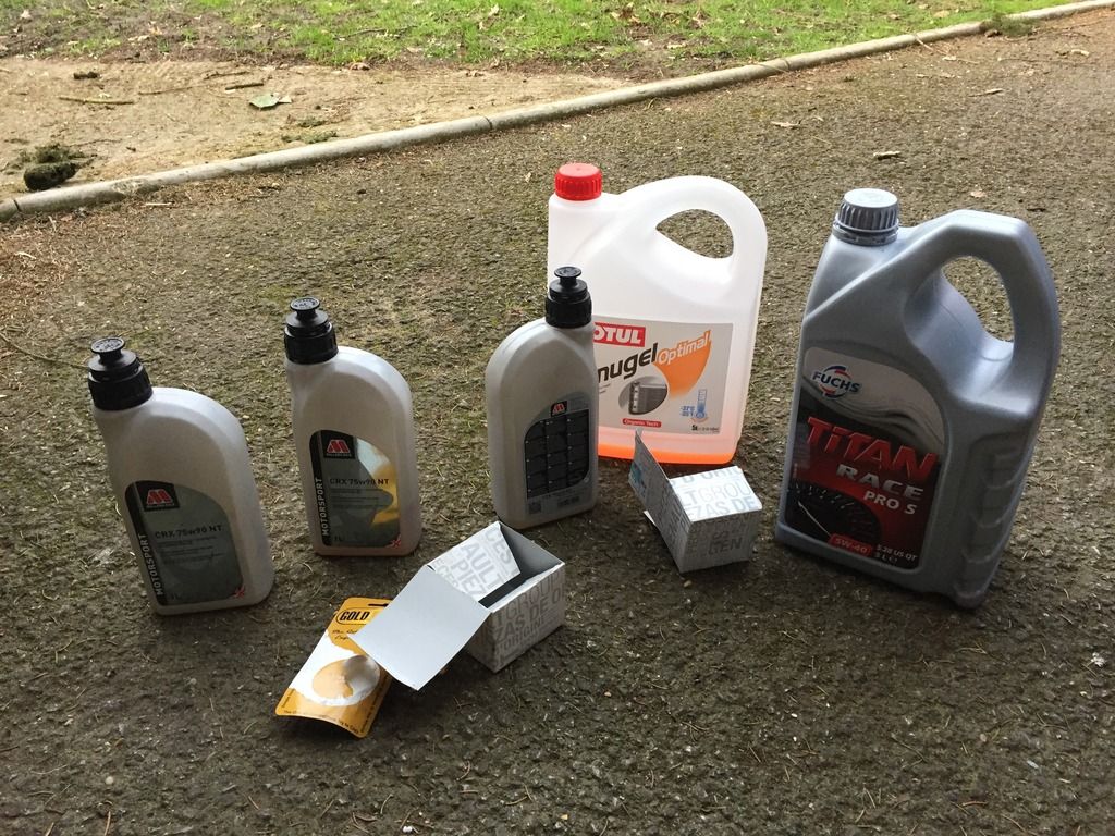

    Random question but what gearbox oil and how much of it did you use?
  21. Red suits this car so good! :sunglasses:
    durmz likes this.
  22. Hey bowen
    Millers crx 75w90 nt and about 2.7 litres approx but I wouldn't reccomend it personally, it runs fine warmed up but when cold its dog shite, really tough to get in first second and reverse. Warmed up its sweet and ran great all day at the track but I'll be changing it soon when I speak to opie oilman, probably redline

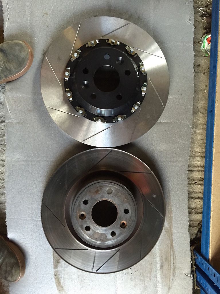

    How you getting on with the Reyland 2 piece discs? By the looks of it the PFC ones are going to be very hard to get hold of for a while now so looking at what other options there are. How heavy are they Reylands?

    I really rate them mate, for the money I think they're spot on. Once the rotors wear out I'll look at replacing them with directional vaned rotors but for now I'm happy. Goodwood has some hard breaking zones and it just stopped and stopped. The suspensions been the biggest problem so far, extra power extra breaking is showing the softness of the h&r springs. Fordwater flat out at 130mph was interesting lol, she was happy enough but fair amount of body roll. Really looking forward to getting out and trying the nitrons.

  40. Sorry, and they where just grams heavier than the standard worn disc. One thing that did make me think a bit is I think they're 2mm narrower than standard at 28mm thick but it doesn't seem to have been a problem. The bell is obviously has the correct offset to sit the new disc central in the calliper so I've got no idea if it would be an issue to replace the rotor with a 30mm item in the future, as these seem more widely available
