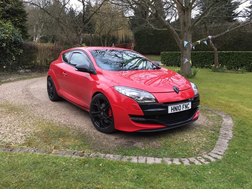

  1. Posted up a few months ago about looking for a 250 in the new year, was desperate for a certain spec and was willing to hunt for it. Another rsmegane member Chris_P messaged me and the rest is history
    This is the night I picked it up
    Spec is xenons, yellow/black material Recaro's, 19" steevs, rs monitor, climate etc etc, its had a stage 1 kit at k-tec with full exhaust and downpipe, intercooler and panel filter, along with whats imo not a great map.

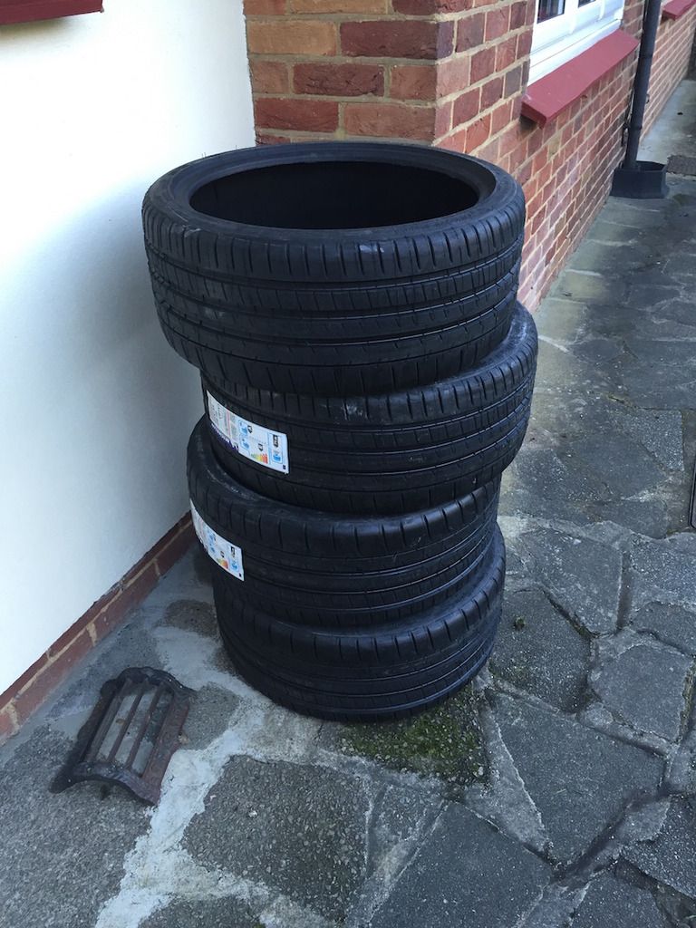

    4X Michelin pss

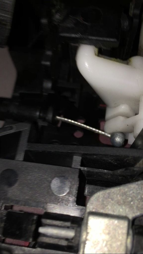

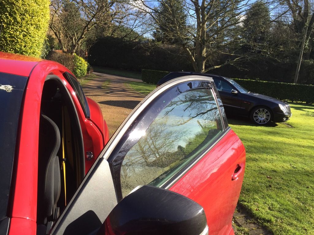

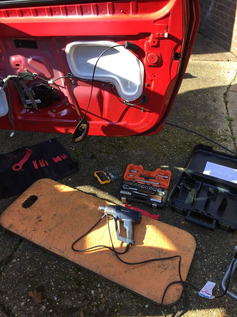

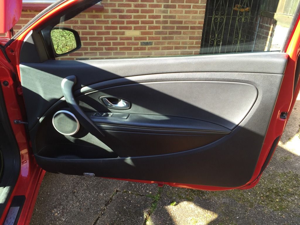

    attacked the door problem first;
    had to cut back the glue on the insulation
    after some sneaky 'poke phone in door and try to take some pictures'. you can clearly see the problem
    managed to poke it back in slightly then used a screw out of the door card to properly seat it, sorted!

    wheels straight off to paint it with the new rubber, £140 a corner for 235/35/19 :eek:
    and this is how she sits, patiently waiting new boots, picking up tomorrow morning thankfully

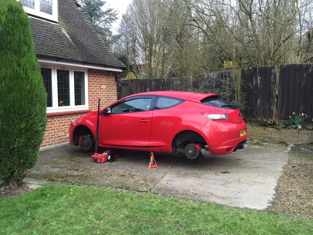

    Lots of plans, will be detailed, doing arches as its up on stands atm, unfortunately its had a knock from under neither and the nsf wheel arch liner is foobard, time for a new one. Soon for a remap at rstuning, later in the year will be on kw's, Evo Corse sanremo 18" in black with some track orientated rubber, uprated gearbox mount, retrimmed wheel and gaiters, new floor mats, complete fluid change, plugs and filter, all bloody sorts

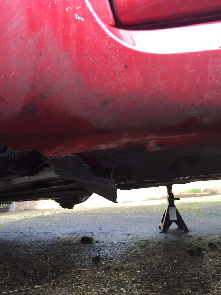

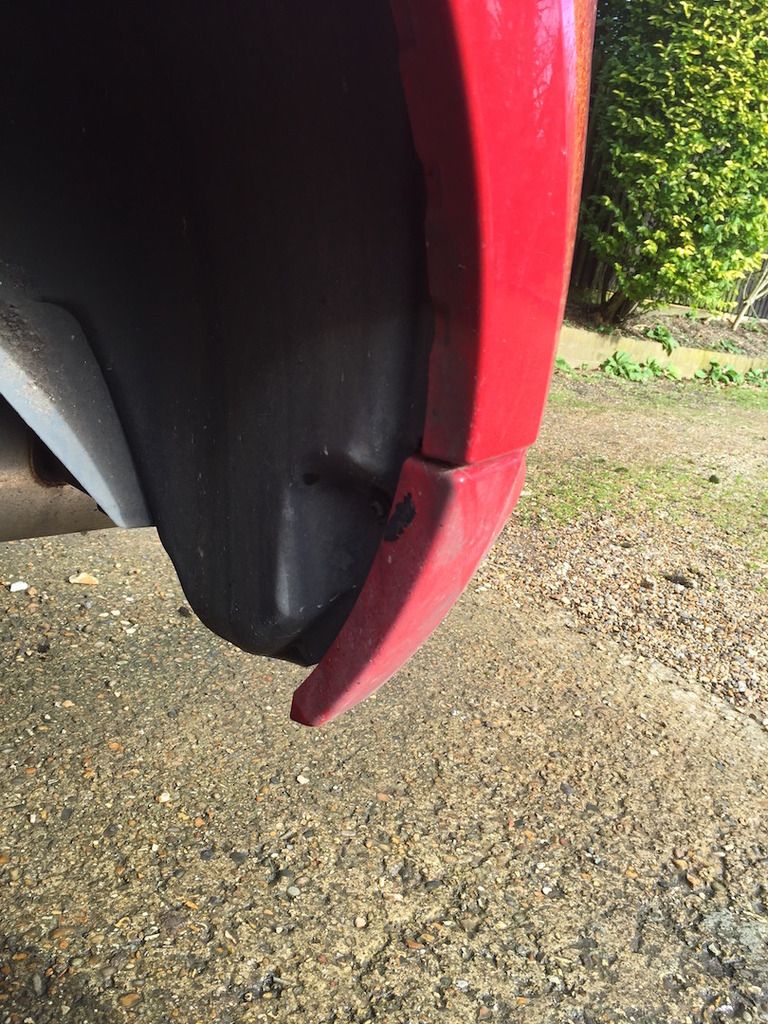

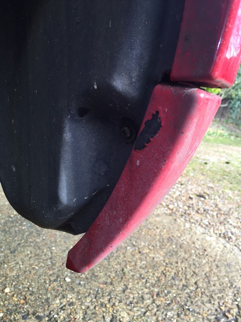

  4. thank you kindly sir. So here's the down side update. Not massive problems but they will need to be sorted, wont be happy knowing they're there lol

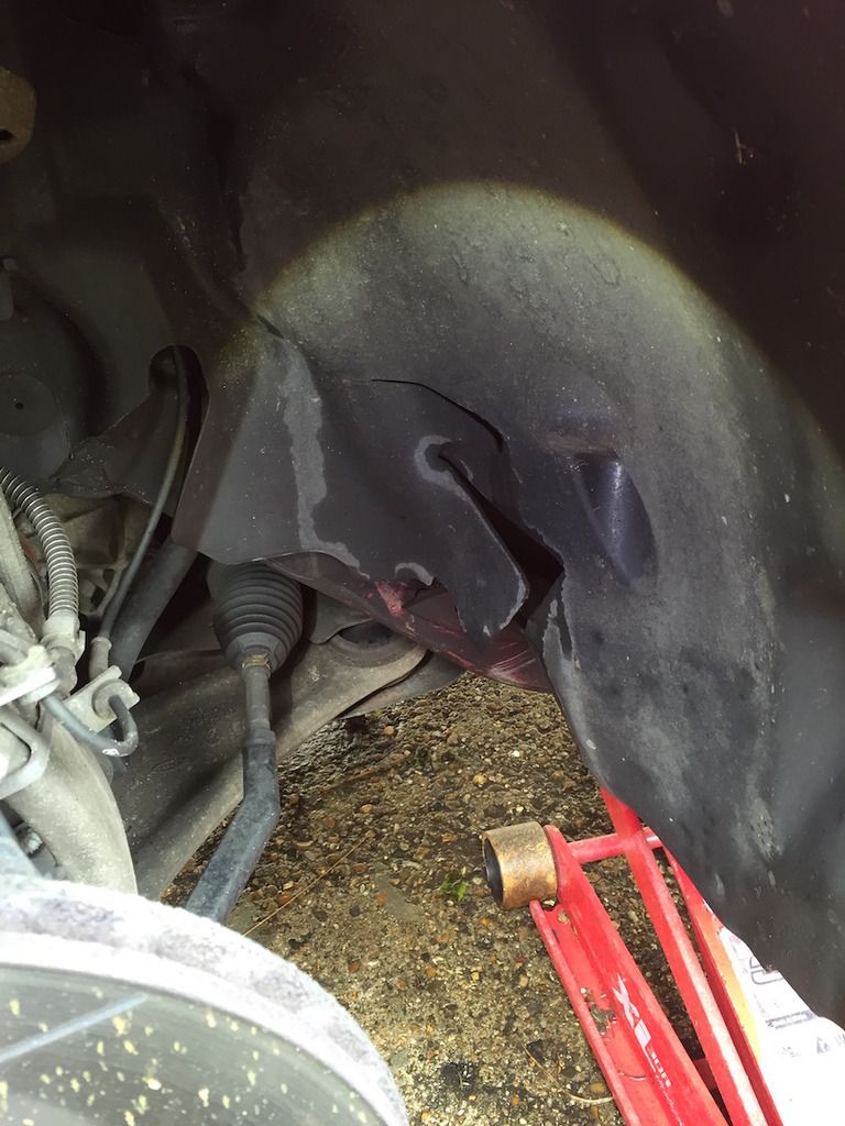

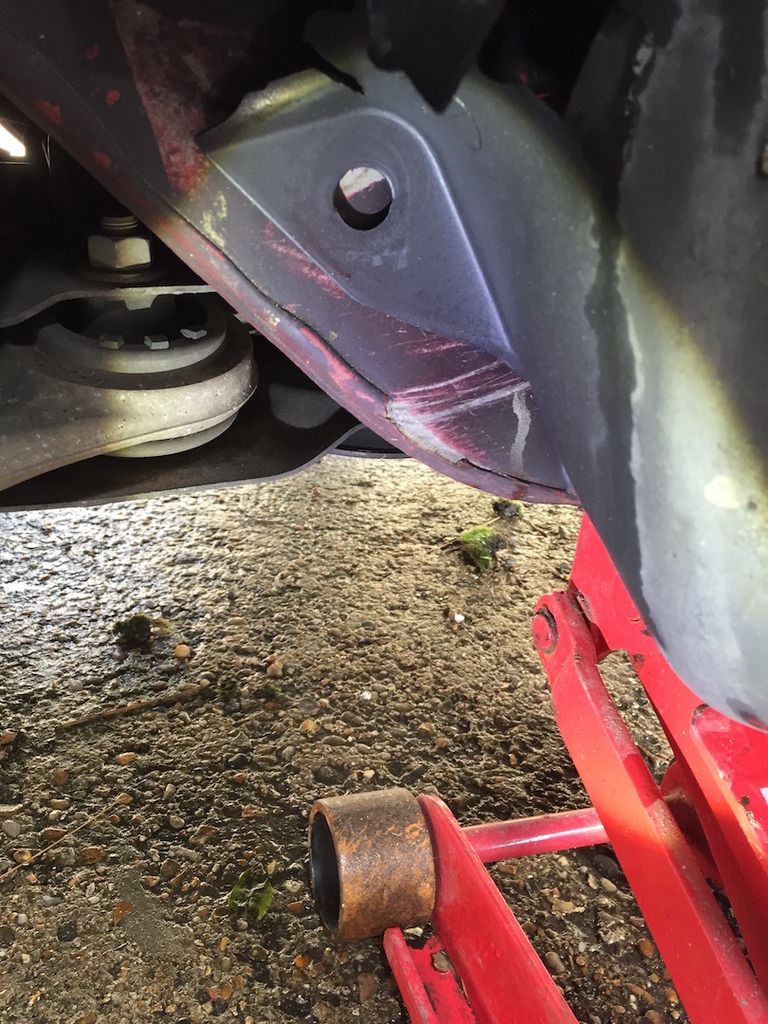

    So somethings taken a whack underneath the nsf wheel arch
    If anyone knows an arch liner going let us know, getting on to a dealer in the morning, I assume these are the same as non rs versions? will check fleabay etc.
    metal underneath looks scratched, will get the liner off, rub down and some protection on there.

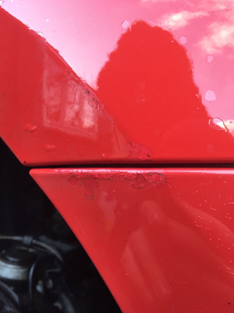

    Any advice on how to tackle a little paint would be appreciated, theres a small patch flaking off in the nsr arch
    Will gently peel off the shit bits, slight rub, ipa and some touch up paint, just want to stop it in its tracks, doesn't need to be pretty.

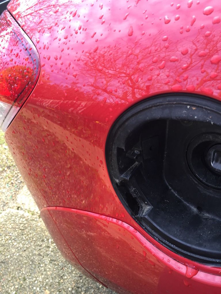

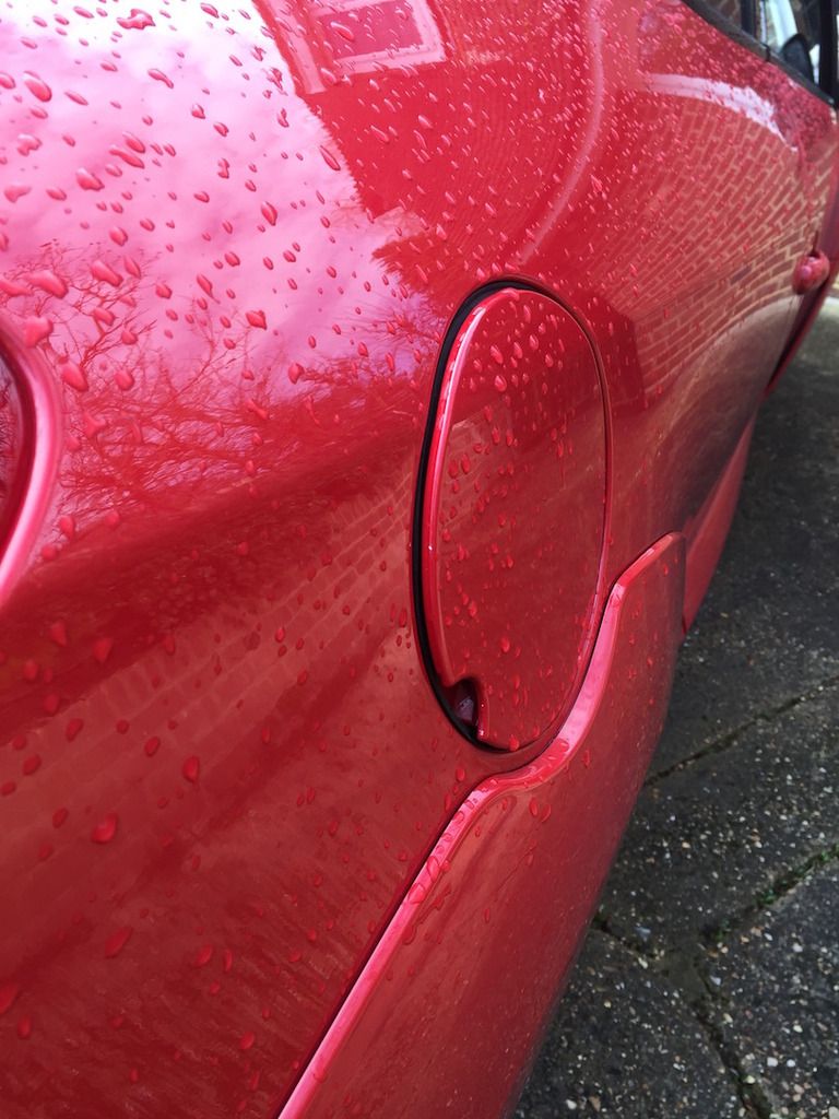

    Anyone know of why the fuel cap hangs out a bit?
    I'll look into it but its obviously a bit loose in the fitting and is hanging on the piss slightly, the rear of the inside is flush with the body work, should obviously slightly indented and the front so the outside is flush

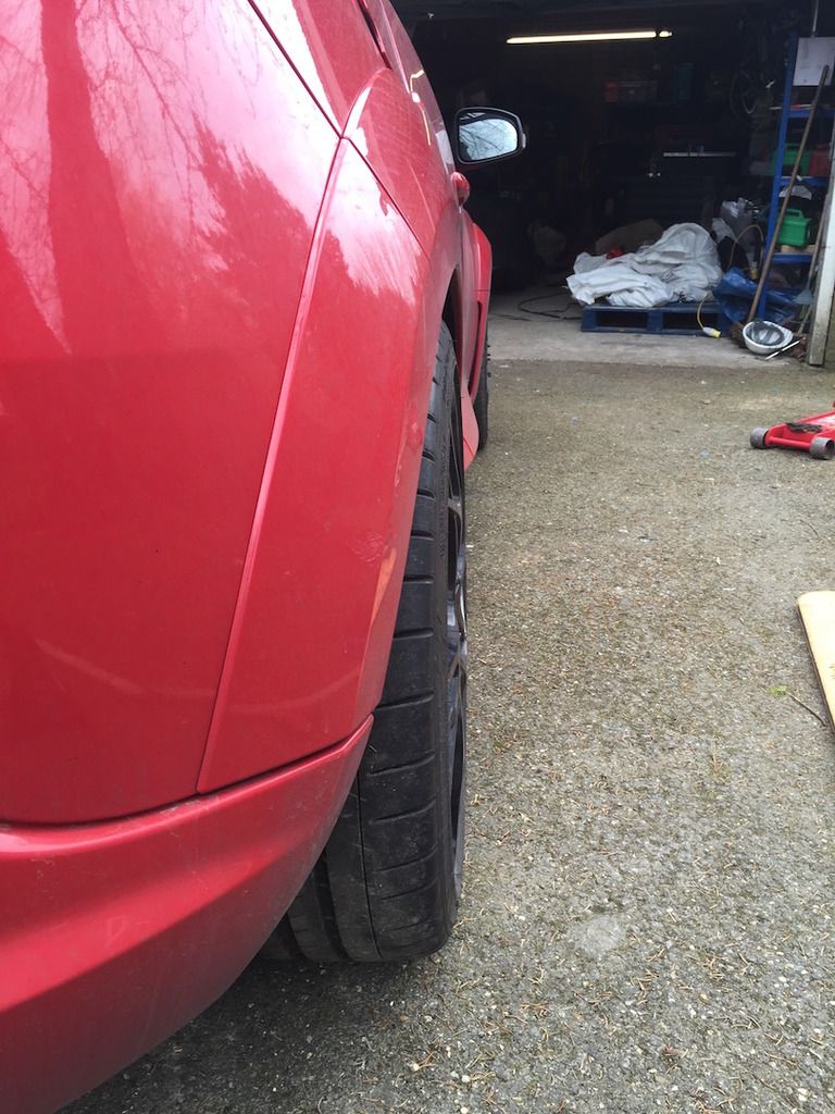

    The nsf wing has had a nick and been repaired by a buboon....
    this will need sorting properly, its crap
    I'll get to all these little bits, no dramas, for some good news
    Rubber!!

  8. Haha, yeah I am mate very happy. It goes very well, was a right handful on the old tyres, sure the new pss will sort it out a bit. The maps very torquey but has a flat spot, it builds torque nice and quickly but then it backs off before coming back. A tank of V-Power drastically helped but it's still there.
    Nurburgring early september, hopefully brands and snet in the summer

  15. Was just looking at the flaking paint on the underside wheel arch. I had a mk3 clio 200 that had the very same issue.

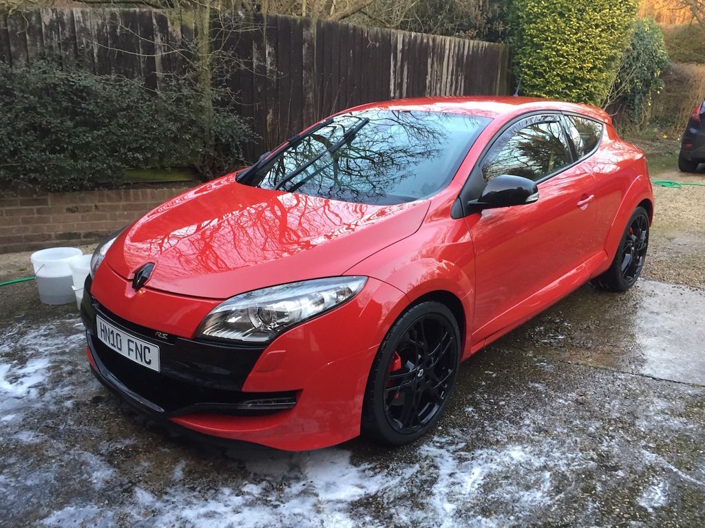

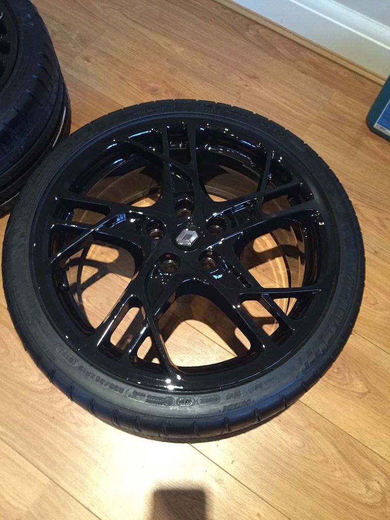

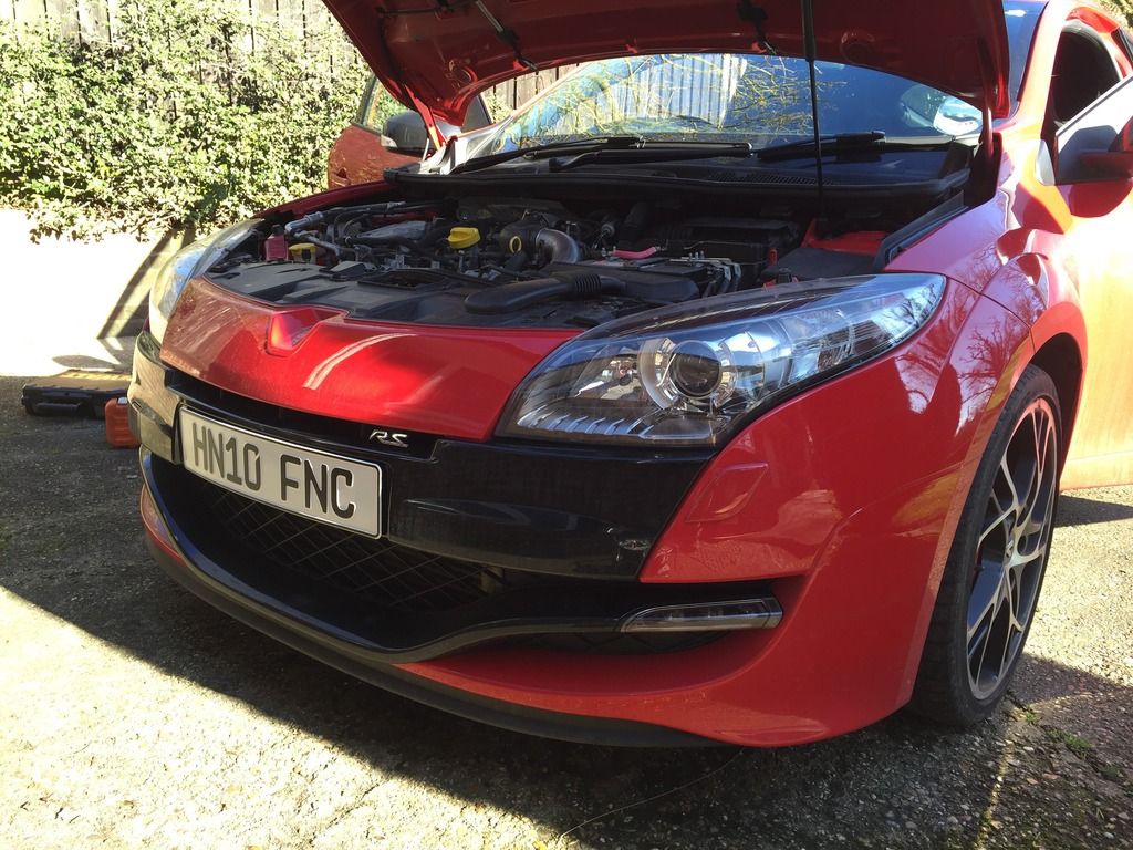

    Thanks guys, seems to be a gooden. Got the wheels back on
  24. Much better now they are black :smiley: red and black look great together.

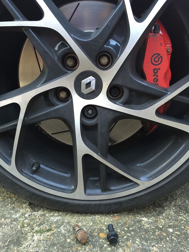

  25. bit of an update,

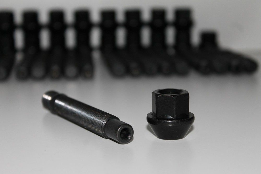

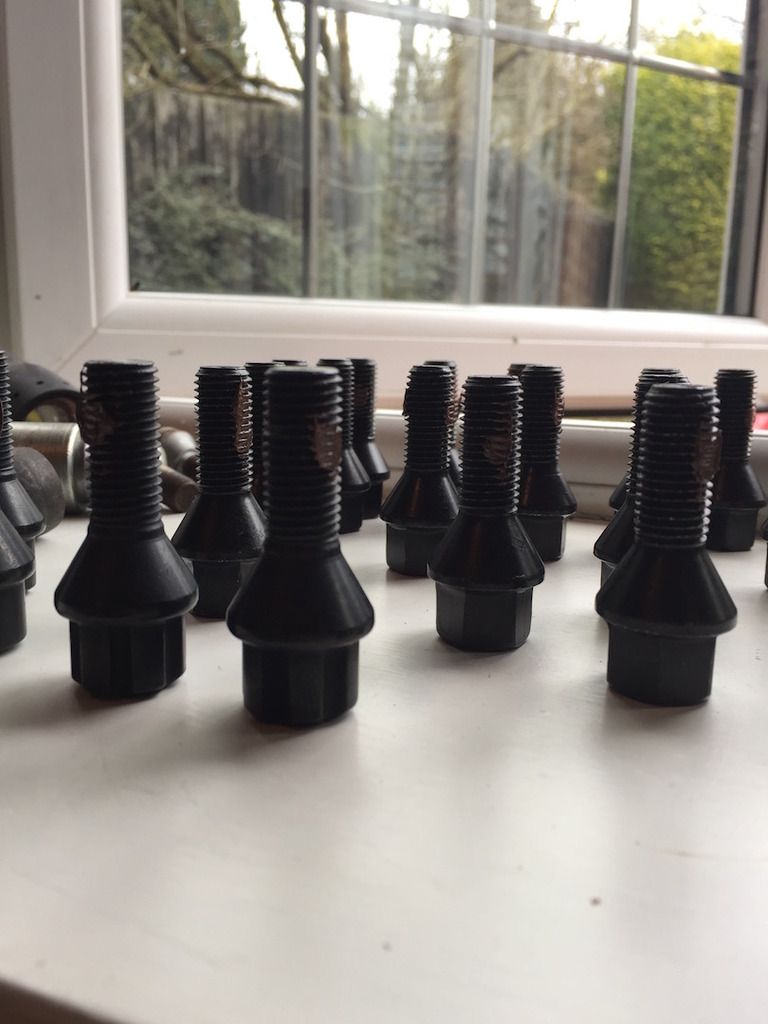

    with me going to tpi bolts I noticed they dont have a rotating collar like the stock bolts, so after I cleaned up and sealed the newly refurbed wheels I copper slipped the bolt holes and bolts to try keep some easy movement there.
    [​IMG][​IMG]

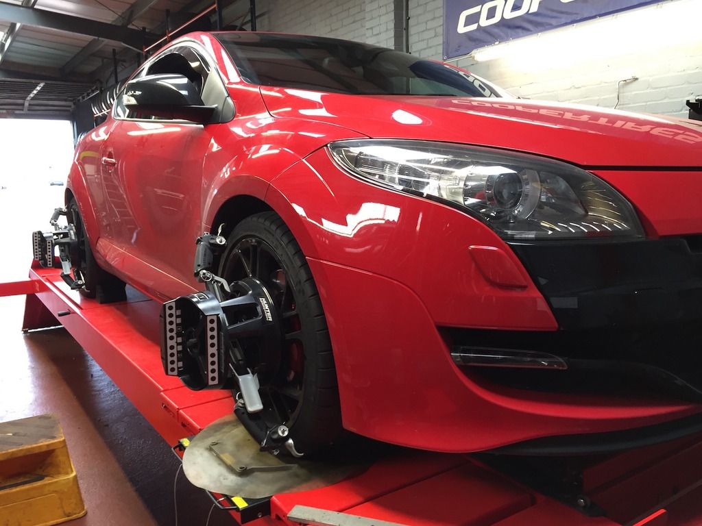

    After some driving on the wheels I wasn't happy, couldn't decide if the wheels where poorly balanced, alignment or just me. A trip to Tyre-smart essex in Witham revealed all 4 wheels not perfectly balanced and uneven toe out at the front wheels.
    running slightest amount of toe in for daily driveability. Really recomend tyre-smart essex, guys there know there stuff, dont use impact guns and take the care that car guys take. Needless to say it drives a lot happier now.

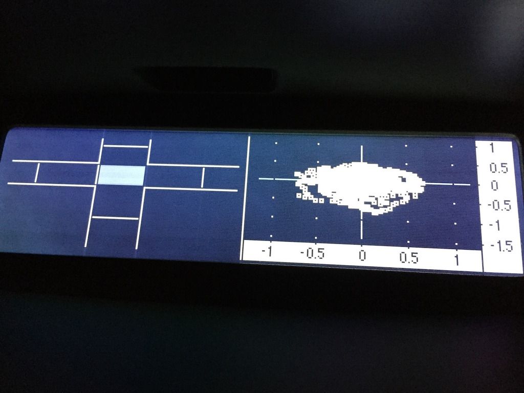

    had a play with the rs monitor, made a blob,
    cool story, I know.

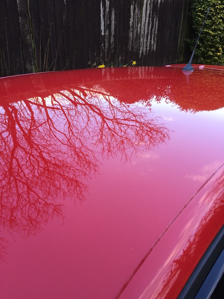

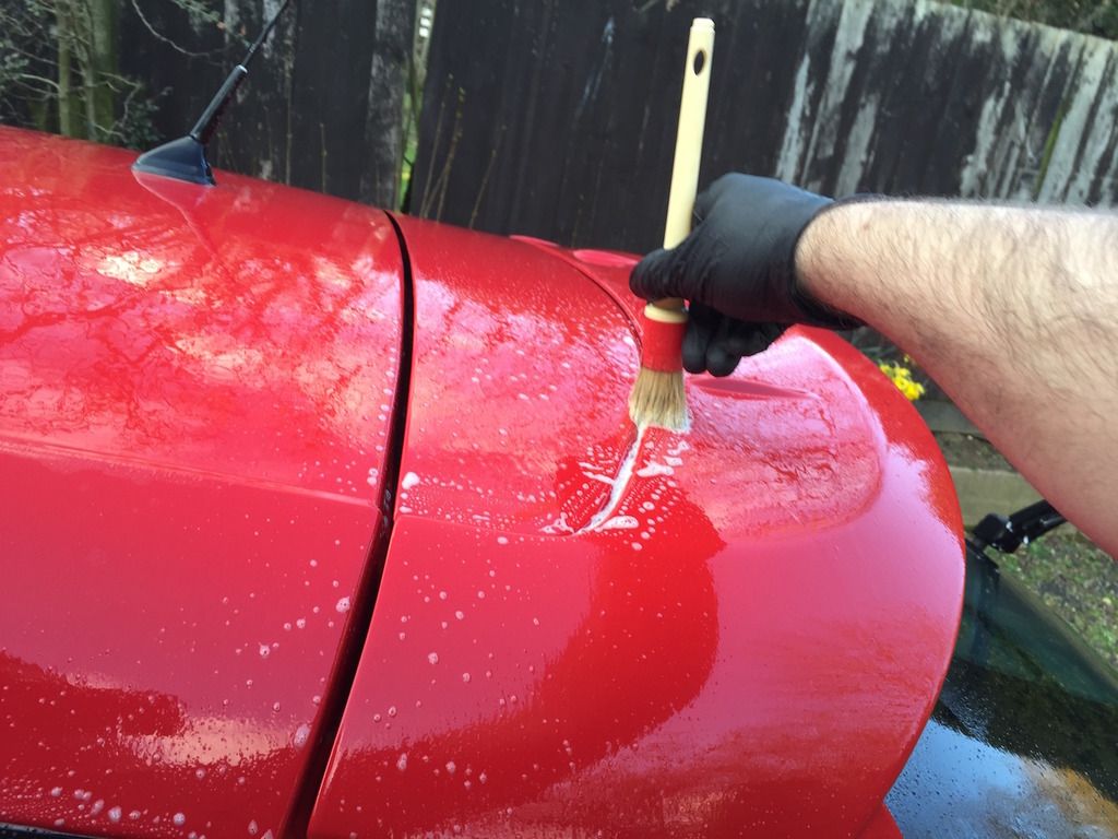

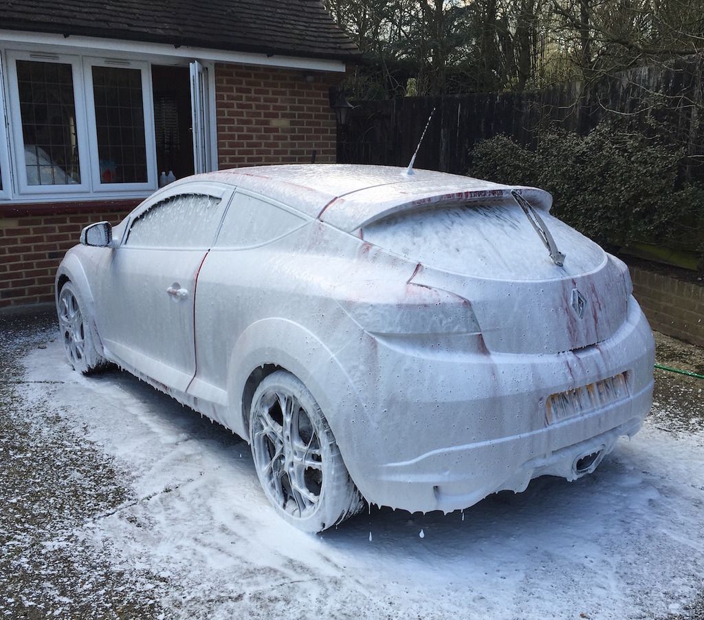

    Started on the detail, hate the first wash, just reveals all the bad stuff, the megane has some really shit stone chip repairs and some heavy scratches on the bonnet, going to rub back the excess with wet and dry, re do with paints4u kit and try to smarten them up, see what happens.
    new i6 automotive foam lance doing its business with ultra mousse
    [​IMG][​IMG]
    got going with a strong apc mix and cleaned out all the panel gaps etc, lots of crap accumulated in the gap in the spoiler[​IMG]
    two bucket wash, I use a lot of autosmart products, great value in bulk and good for everyday needs[​IMG]
    after a couple hits of tardis and a clay, starting getting to work with this lot
    atm I'm left with this, after only managing to finish sealing the roof, so lots more to do, will work on the bonnet next, see how far I can go with the scratches[​IMG]

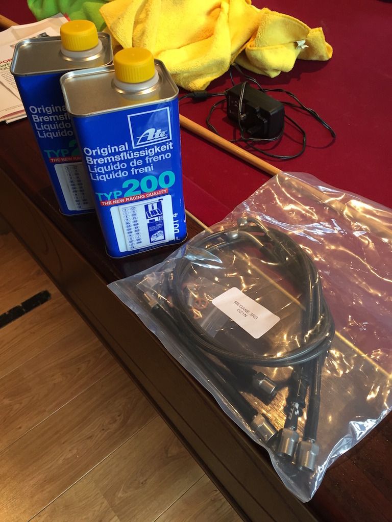

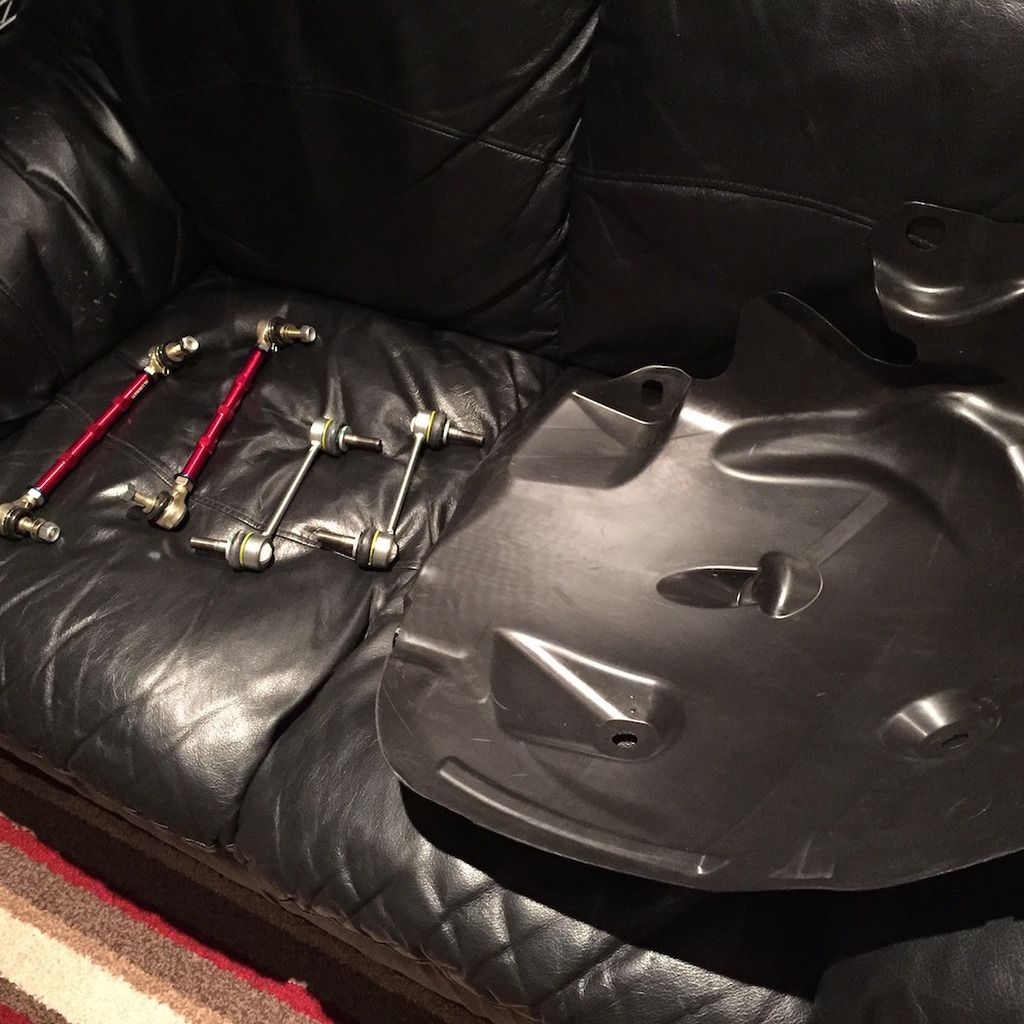

    more bits came in the post,
    got a new arch liner, k-tec brake lanes, ate fluid, new brake pins with p clips, more interior clips and arch liner clips, will crack on with it all tomorrow.
    Also got a vibratechnics gearbox mount and some h&r springs on the way as a temporary fix to the arch gap while I get some money together for clubsports or similar.

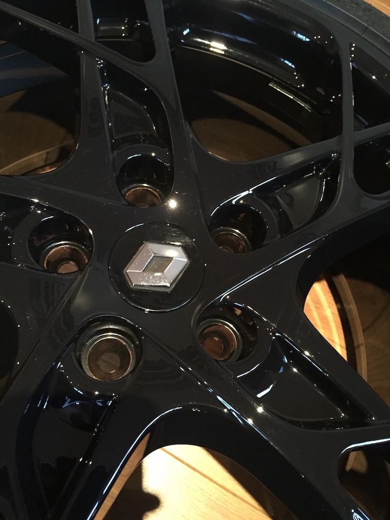

  26. -Jamie-
    I'd remove that copper slip from the bolts. Big no no.
  27. whys that?
  28. Was always advised to copper slip bolts, never been told not to. After some research I see what you're saying, possible over torquing, makes sense. Wheels are coming off today anyway, will see how they are and consider a clean up
  29. 2nd on removing the copper grease from the wheel bolts .. My front wheels kept coming loose on track years ago .. Couldn't figure out why .. When they got hot the bolts just came loose . Turned out to be the copper grease
    Just rub them clean with a rag and that should be ok .. I would definitely remove it all from the wheel holes tho .. Brake cleaner should sort it
  30. Ok, points well made, thanks for input chaps.

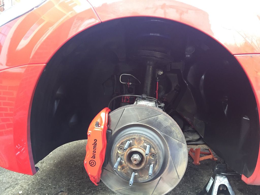

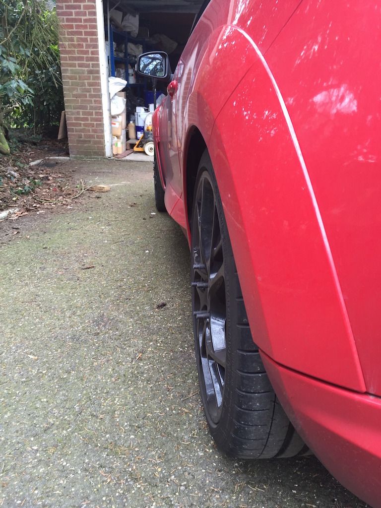

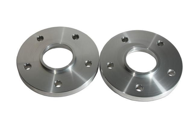

  33. Looking for opinions, negative positive or otherwise on spacers. The standard wheels will only be for road use, the odd bit of spirited driving at most, in the summer it will run on some 18's (possible td1.3's or enkie rpf1's in appropriate offset) so I was looking for a solution to easily space the standard wheels essentially for looks (yah yah scrub radius etc etc) whilst it not taking a lot of effort to swap over.
    So, I ordered a stud conversion kit, not k-tec, elite-developments M12-1.5 stud kit with black nuts, and having superforma make up some slip on hubcentric spacers at 20mm. Obviously stud length appropriate to accommodate spacers, and also having superforma make the stud holes M12 width, obviously, but with a small chamfer on the hub face side so that they don't bind on the bulge that separates the thread on the stud going into the hub and the the thread coming out the wheel.
    I realise thats not exactly a question but if anyone has any ideas as to a problem or otherwise with the plan? Just as I've not seen anyone using this system on a rs250, I'll get pictures up of the fit and quality when they arrive. I've seen problems with spacers failing with the extra bolt system, shouldn't be a problem with these and again I wont be tracking on them, If I decide to track on these wheels, which is unlikely, the spacer will come off.

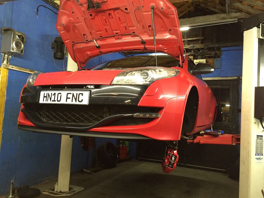

  34. So I've been doing some of this some of that
    Buddy dans a mechanic, useful being able to use his shop after hours,

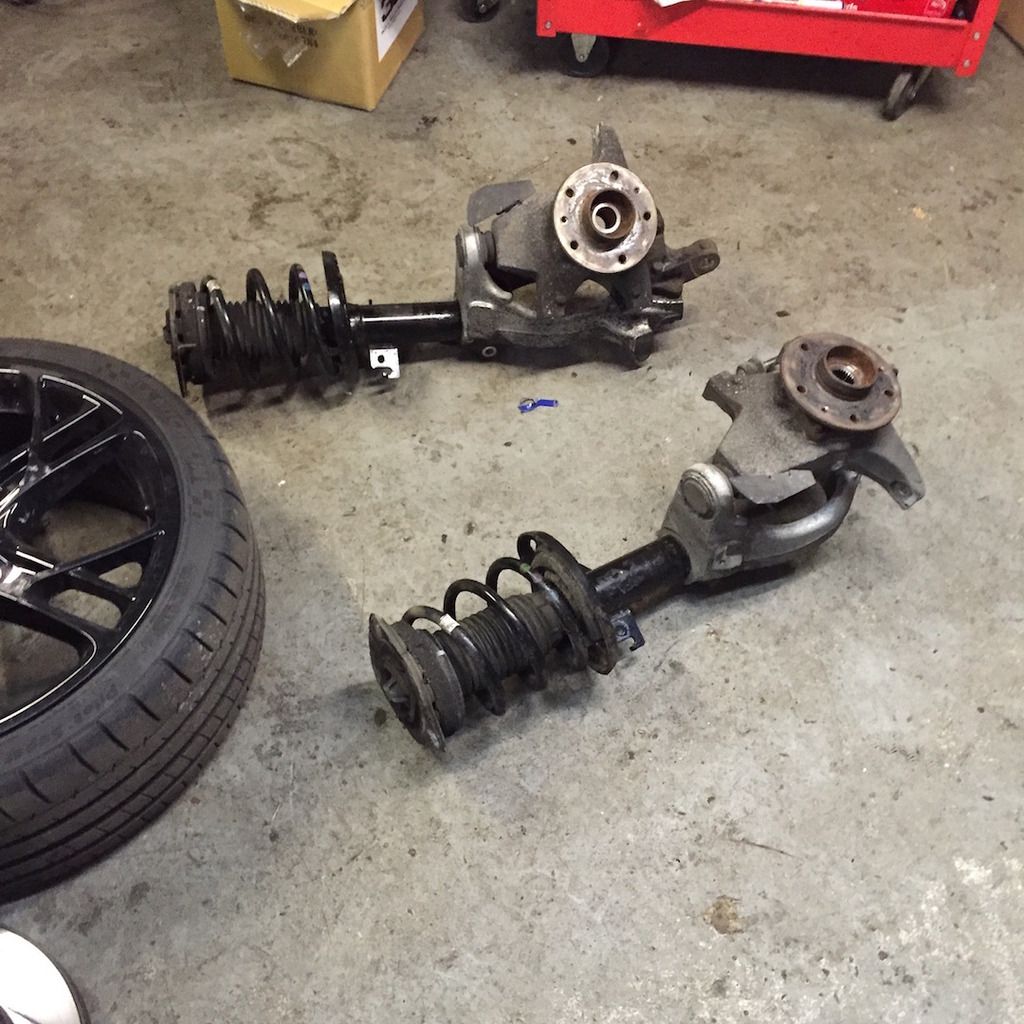

    spring change was a bit of a pain, the shops spring compressor wasn't an ideal fit due to the already fairly short standard springs but we got it done.
    Looking decent underneath now, lots of stuff fitted.

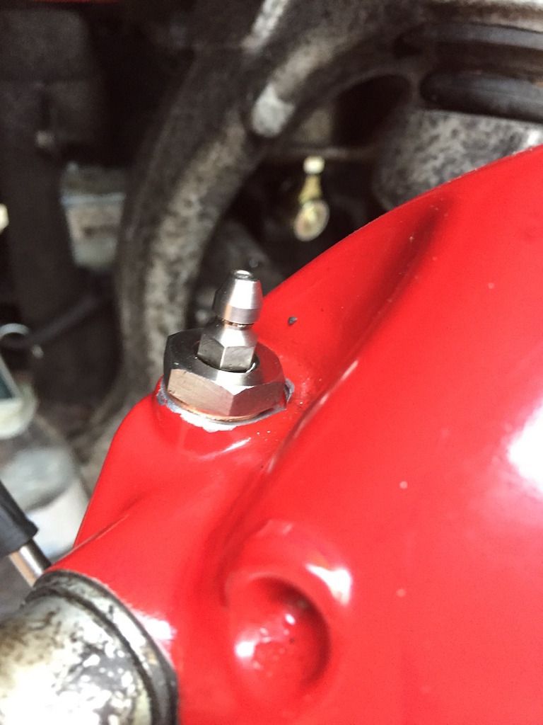

    during the bleed the nsf inner nipple threaded out, noticed when I turned it back the fluid didn't stop...
    Drilled out to 11mm, tapped to m12x1.0, fitted motorbike bleed nipple sleeve with its own seat and smaller m6 nipple on a copper wash, better than new
    Fitted 20mm slip on spacers, hence the very long studs, took some work, but much happier with it aesthetically, which has its importance too, ride wise it feels more stable, but certainly less turn in, maybe a little more understeer but haven't pushed it, either way this will be the setup on the stock wheels, plan for new wheels in the summer in a better offset.

    and as she sits today,
    The rears rub a little, need to remove the screw in the rear outer liner and look at what can be/needs cutting if any.

  35. Looks good mate, where did you get the spacers from? I'm dying to get some 15mm ones for mine but can't find any anywhere. (I've got studs so need slip on ones)
    Just seen the post before, I'll give them a call lol

  37. Well as I found out the hard way, theres a reason no one makes them. On the front hubs the centre bore locating lip sticks out 18mm. At the rear its 17mm but, the hub bearing has a large cap to keep the elements out. Whats this means is to be a hub centric slip on spacer the center bore needs to be atleast 18mm deep. In other words, you wont get a 15mm slip on spacer, 20mm is minimum really, otherwise it wont be hubcentric and thats no good.
