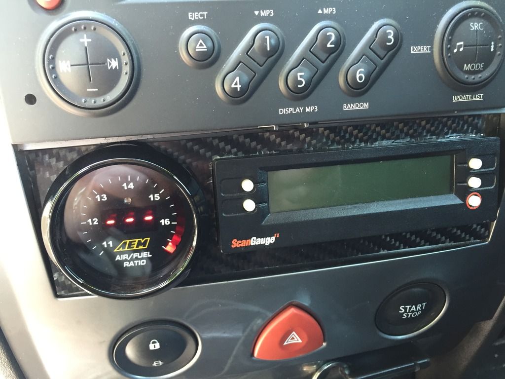

    I finally managed to get my AEM AFR gauge working last weekend.
    To power it I used a piggyback fuse holder and the 15amp Radio fuse as the source for my 12v switched power so it turns on and off with my ignition.
    To give better access for feeding the wires where they needed to go I removed the glovebox.
    Piggyback fuse holder in place.
    To earth the circuit I used an eyelet connector fitted under the screw below.
    To keep the carbon fibre panel in place I wanted something not too permanent so I've used double sided tape.
    And the gauge working with ignition on :grinning:
    Thanks to @matt e for the advice and for the rear brakes discs which are next on the to do list.
