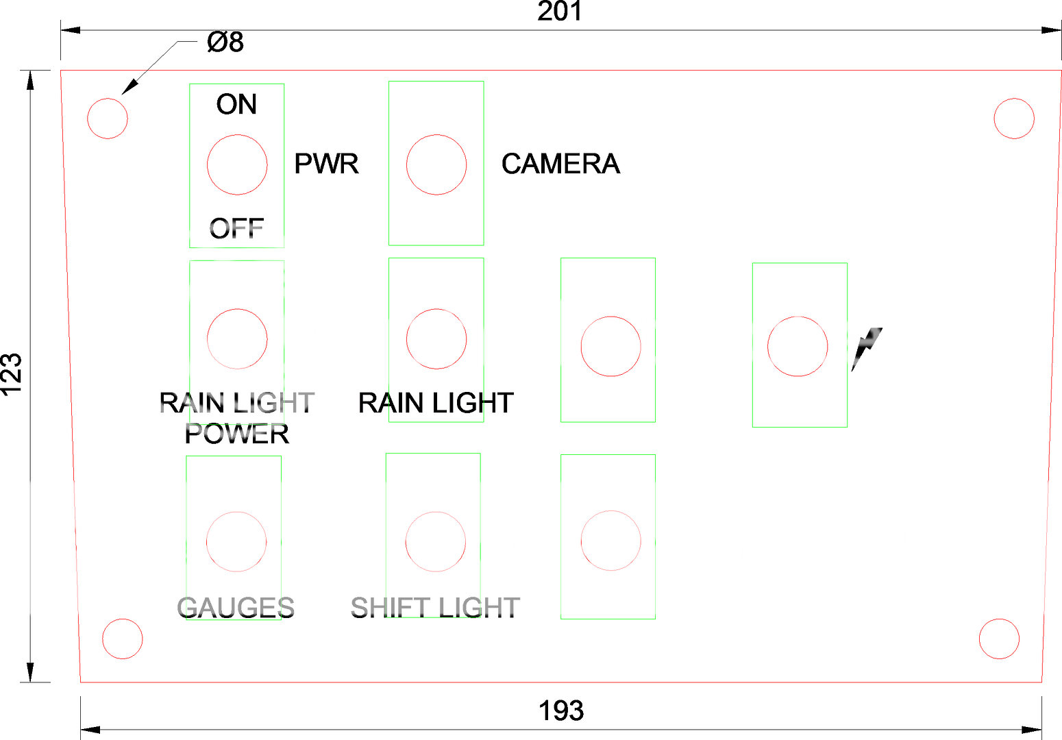

    Have a custom switch panel coming too
  23. Switch panel!
  24. Epic build... well done man.
