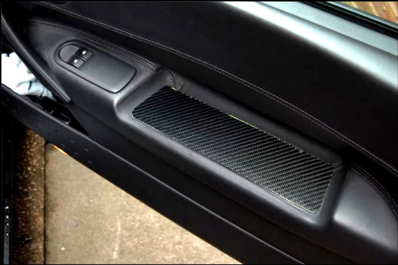

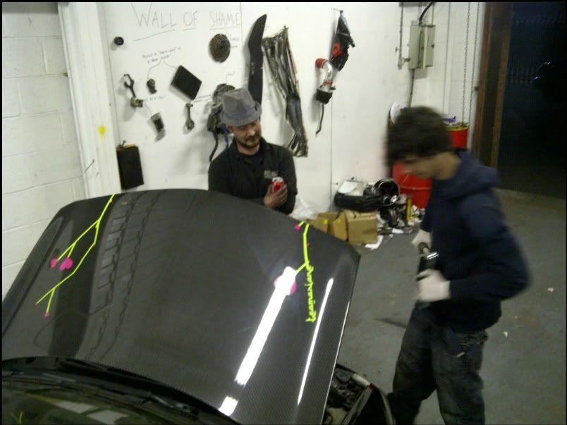

    got 'richngem' to fabricate and cut some carbon fibre sheet I bought from TDINorth in warrington (off one off their TA cars) for £20 quid and he sent me up a sample of it so far.
    we were going to resin it in but i prefer screwing/self tappeting for when/if i need to access the window regulators (which break weekly on the meganes) so 3 maybe 4 black screws will hold it in place on both doors, i like it
    test fitted....
    yes its not the proper piece its a test piece as i had spare so no it looks rough, not fitted, etc. te green is marking tape, not mould :wink:
    total spend, £20 pounds.

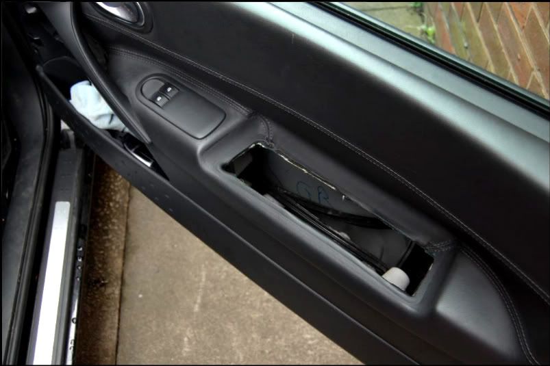

  3. Naith
    Fitted this...
    Took it straight off.

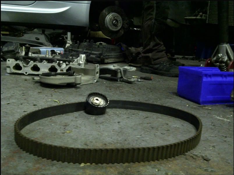

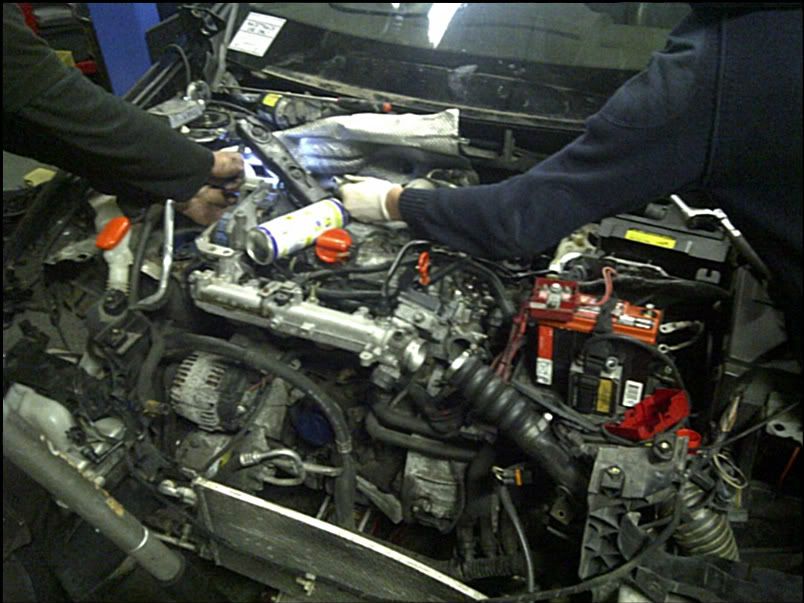

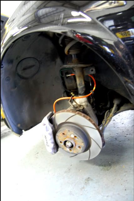

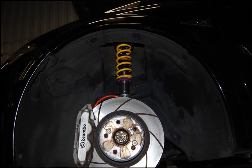

    Arrived at BTM for 10.30 am yesterday, fred wasnt there, we waited.
    Yesterday it was myself and rich(richngem) doing the work on my car whilst fred overlooked when needed.
    Rich was having aux/cambelt along with some catcams put in so fred was really busy making sure that was setup well whilst we cracked on. Neil (withoutabix) was in the area yesterday so he helped out all day too.
    big thanks guys as ever.

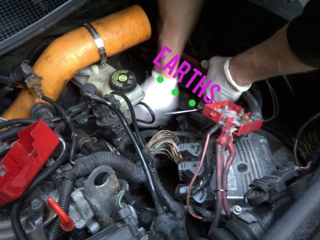

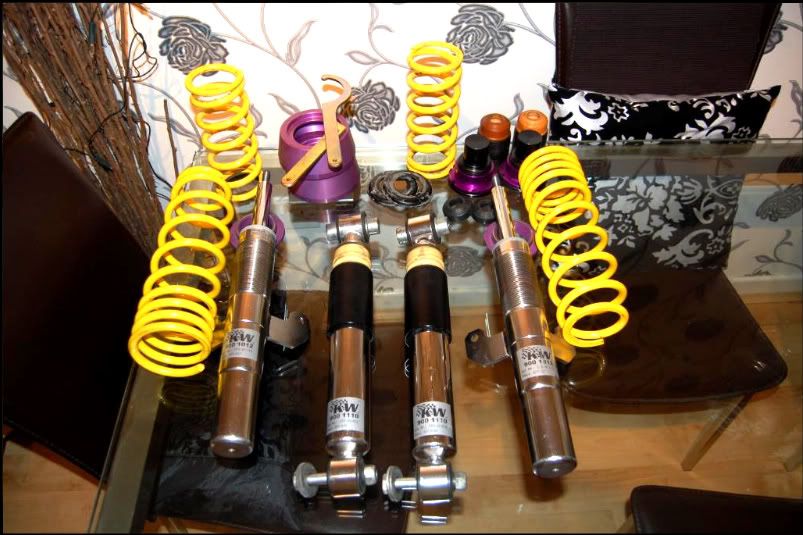

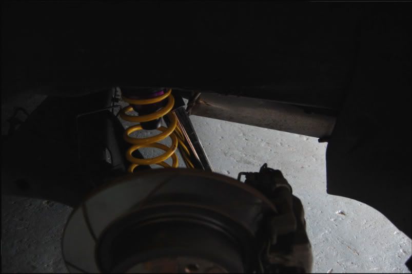

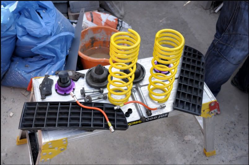

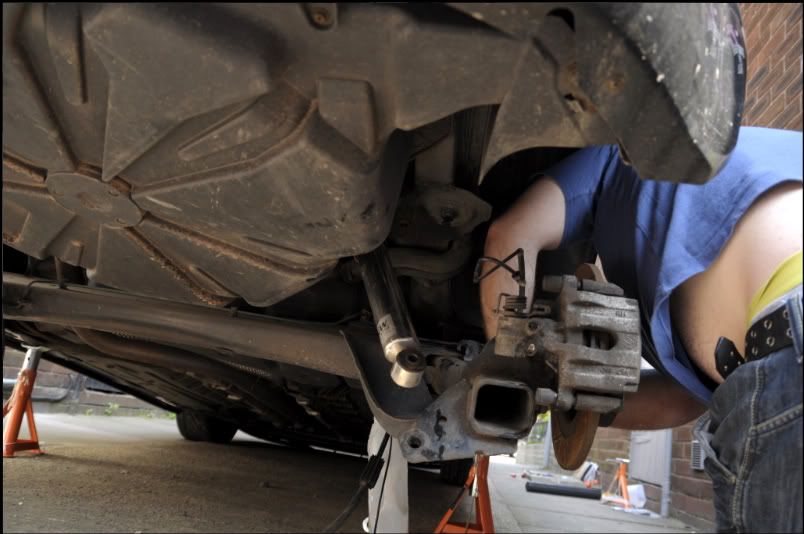

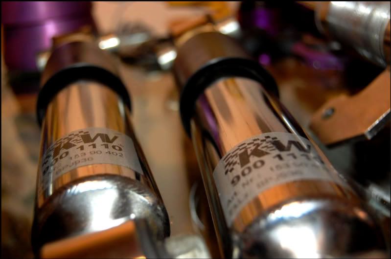

    basic stuff to start with, fred has a cig(4), rich consults his diagrams he's made and I go off in a sulk because i cut my hand and was hungrey. i had the rear of the meg setup with 'cup suspension so rich and i knew basically how to do the rears which were in fact easy.. and done within 45mins.
    i wont go into to many specifics but "FREDDDD" was shouted alot. basically the eibachs were jamming and wouldnt come out as we wanted. we eventually got them out and cleaned them and the mounting areas up, copper greased everything and then looked at the OEM top mounts (i'll be getting adjustables but lets take it one step at a time).

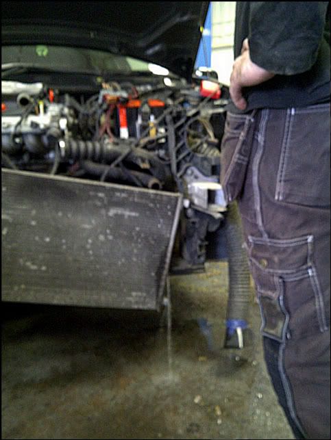

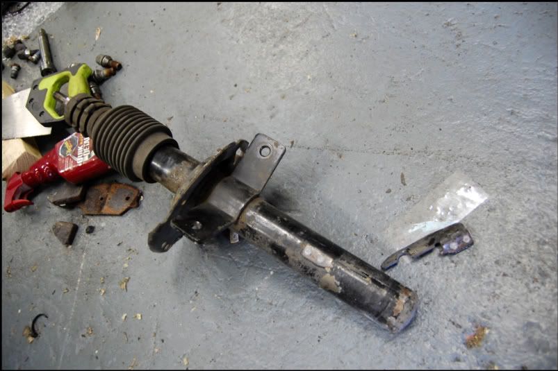

    front unit out, with snapped linkage and mounts [​IMG]
    Then disaster (as ever with TDK), the driverside ball bearings in the topmount had basically spilled out as we pulled the arm off the car, neil spent 20 minutes looking for little balls on the floor, found a few, fred smashed some random car part open and used the bearings out of that too.
    Job Done...
    So the Variant 3's..
    night and day... if im honest, the car rides ever so slightly harder, but less rattle- ridden, the roll is none existant and traction has improved massively. i'll run the car at silverstone this week and we'll see then. the car needs corner weighting and maybe a tinyyy drop all round, but be told, im not dropping it to ghetto ride and look like a badaman.
    i've only had a small chance to drive it in the wet today (TC/ASR off) and it seems to unsettle itself under corner braking, squirms abit and move her fat arse... this by no means bothers me as megs as standard are like this and due to previous lack of weight over the boot im used to it but i think she needs tweeking and odd bits of setup. Which will no doubt take 32 years with the V3's. fronts are half way down, rears im not 100% but this is for now so i can get them bedded in for the next few weeks at least, oh and till i can afford adjustable top mounts.
    whats shocked me though is how you find yourself hitting the worry button before the car does, the grip is verging on scary, riad and myself did a little trafford park run this morning and into roundabouts i'd usually understeer into the pavement on, she gripped, gripped, gripped... thats it. Riad said there was easily about 10 mph into a certain corner (and thats in the wet!)
    so here she is, more additions to come this week, sorry for crap pics after but i've just been so busy and this alone has took me 5 hours to do as photobucket is on the blink and i've been mad at work.

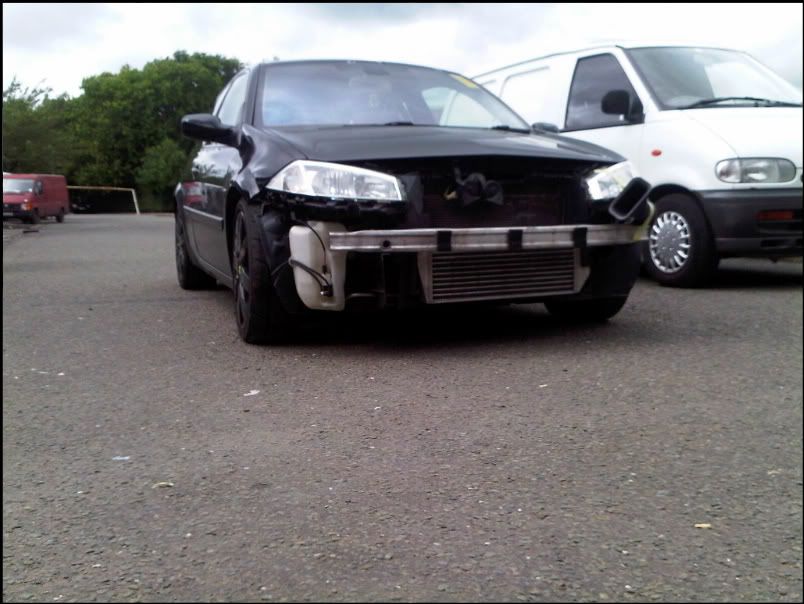

    Got the car out on track after silverstone decided access should be across a gravel carpark... the car was full of stones by this point and they were deposited on track entry, which i wasn't happy about. An M3 binned it and another car dropped its gutts on track too which didn't help...
    getting to the track also tore my splitter off and ripped the bumper off, luckily i had black tape in the car so just taped her up and cracked on... silverstone Stowe circuit, taking in sections of the new arena...

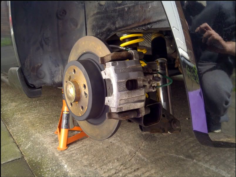

    from tonight, April 2010.

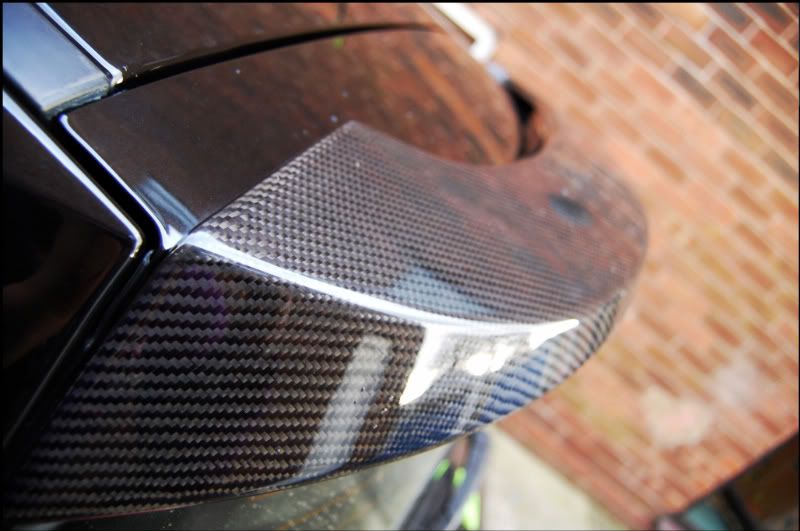

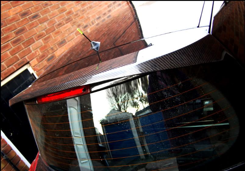

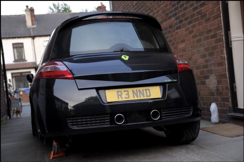

    Fitted my new rear carbon fibre spoiler this friday, was a MAJOR ballache as this one doesnt fit like the OEM renault one, the holes are slightly different. same with the cage from the same company, but hey ho I haven't bought from them and managed to fix both situations.
    I dropped 4 screws into the boot, took me 3 hours to do a ten minute job too.
    to top off a poo day Riad kicked the spoiler when I had it resting on the floor ready to go on, it chipped the lacquer a little but these things happen and it was an accident.
    excuse the crap pics, had a reallllllly busy weekend and it rained dropping half the volcanic ash on the car today so they are all round rubbish!
    its not that noticeable as the pics make out, I think the camera settings kind of bling it up a little when in reality its quite subtle if I'm honest.
    impressions... well its bloody light, 1.5KG saving over the renault one I'd say. I keep thinking it will rip off at speed, but CF is very strong and if it flexes then its ok because formula one cars wings flex and that gives them better top end speed :wink:
    its got rid of the centre hole that the OEM one has too, I wasnt sure at first, but its growing on me every time I look at it. Best of all I sold mine on and got this at a good price so it cost me less than a night out... I'll get some better pics this week when I fit the new induction setup and rip some more parts out.

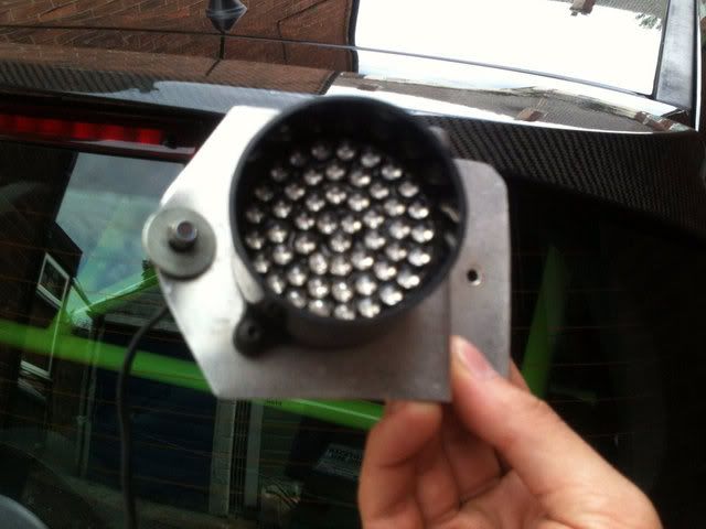

    been a while... she's in preston having her windscreen fixed, roof flatted and repainted and a whole new front bumper/undertray put on, the front bumpers been a mess since i bought the car so its about time a new one was added.
    i'll also be puting a circular CAF in to replace the rectangle one on as present, she'll look lovely.

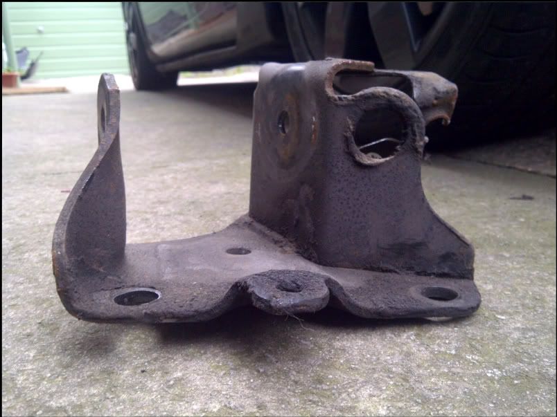

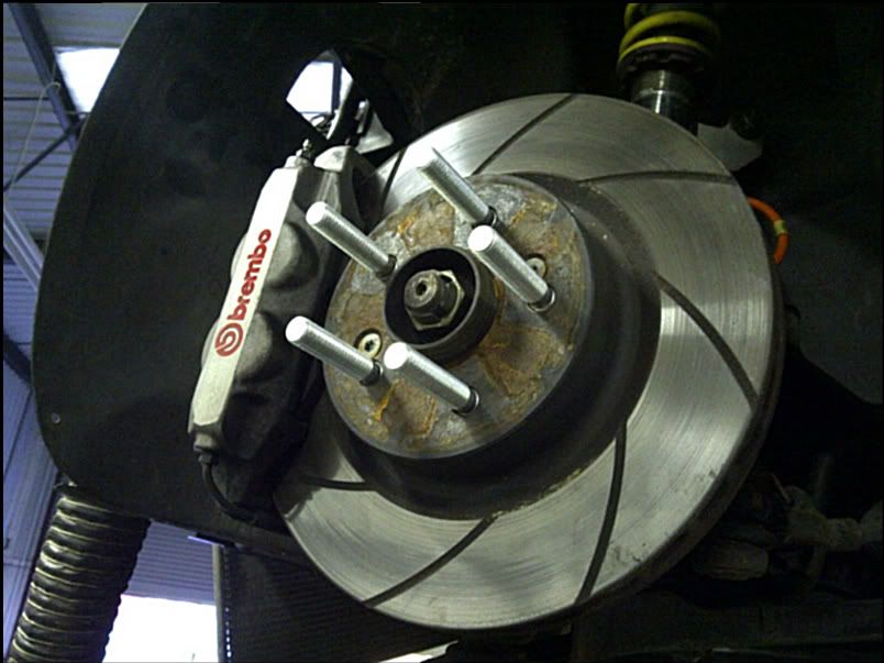

    whilst the car was jacked up we checked on my dead droplinks and tried to fix the centre heatshield which is rattling, on closer inspection one side of the shield the bolts have totally been sheared off, i think this may be the train track i hit in france at erm speed.
    i will sort it next week mind, clamp something to the remainders or weld some new plates on, we'll see.

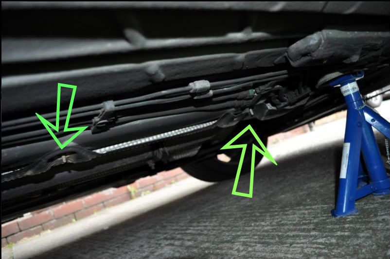

    about 5 months ago i was bought skirts that have just been sat there, i never had the chance to fit them but mat offered them up today and we cracked on...

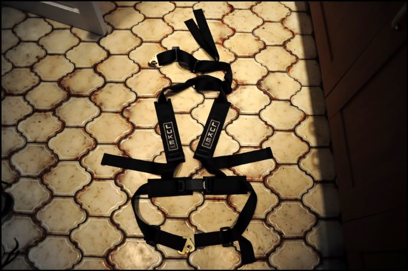

    I was going to make a little thread about some nice little harnesses I bought ofF brown bear ready for some buckets when I'd saved for a month or so...
    but in true renaultsort style i took it to the next level...

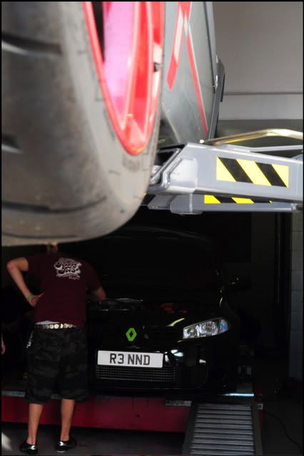

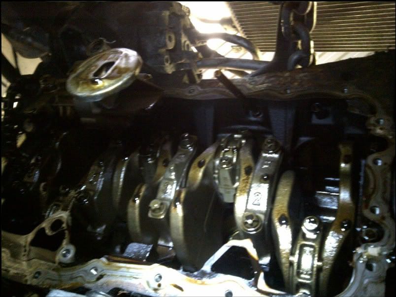

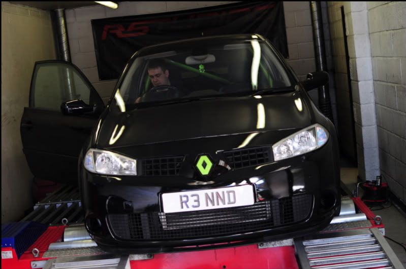

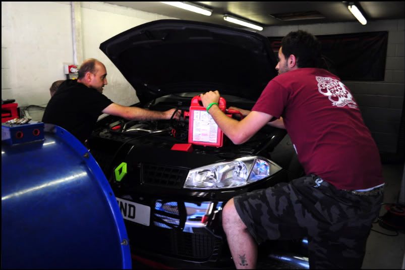

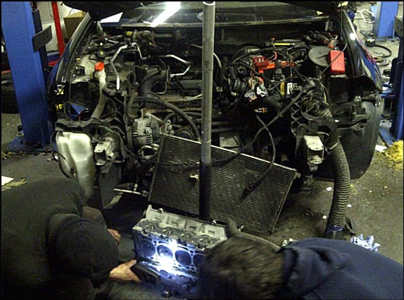

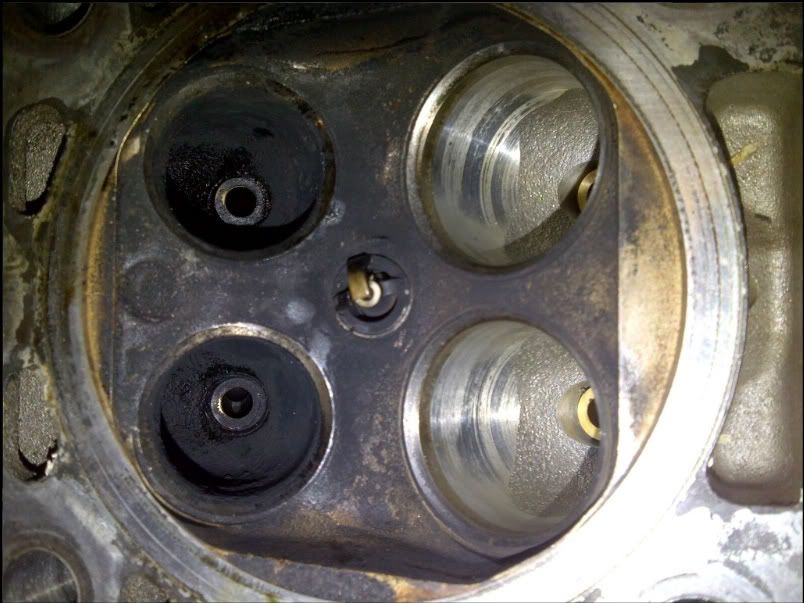

    I've never been 100% on the power output on the car, sure the torque brilliant and the cars light, sits well and corners like a good'un, to cure this I took a trip to RST again in leeds to see if the stage 2 could be given a little more poke... Paul mentioned to me the other week that the maps had been tweeked so he should be able to work around the issue with the engine not making power.
    whilst there i saw some amazing new goodies that he'll be putting out there soon, I was tempted but its simply not an option until i start to earn some more money... i've never been one to talk about power figures, I'm in the mind of rolls royce and prefer, chill, ample, b00st and Banzai! :wink: but I'll give figures in here in the hope that is shows reality and could be of use to people in the future. Anyway..
    after some messing about and finishing off some other cars i got on the dyno.
    the coilovers arent set 100% and the car needs the corner weighting sorting out again as on the dyno she was pulling all over, something I can live with as I knew it needed sorting out.

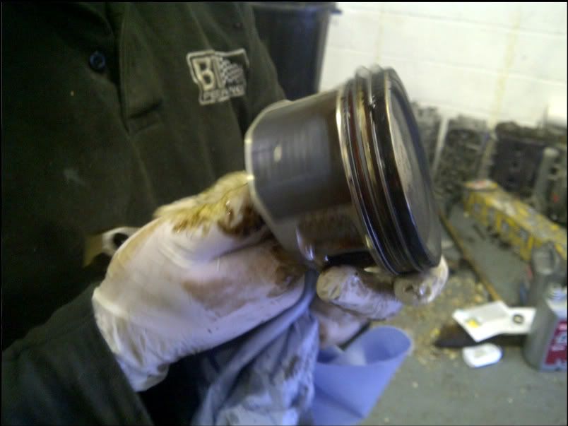

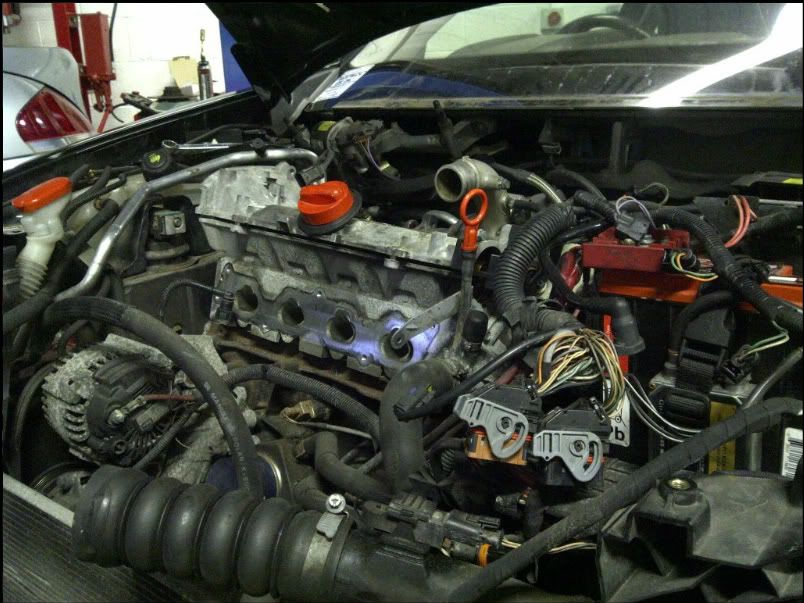

    so onto the dyno...

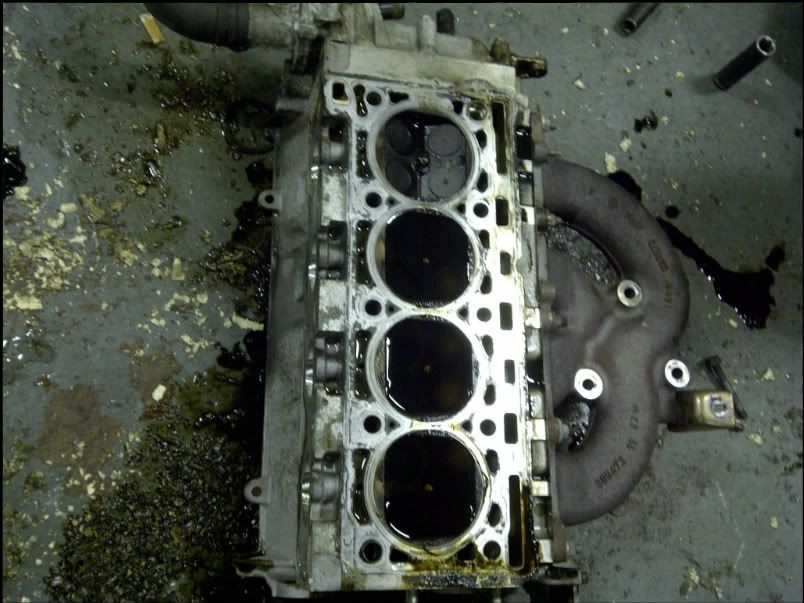

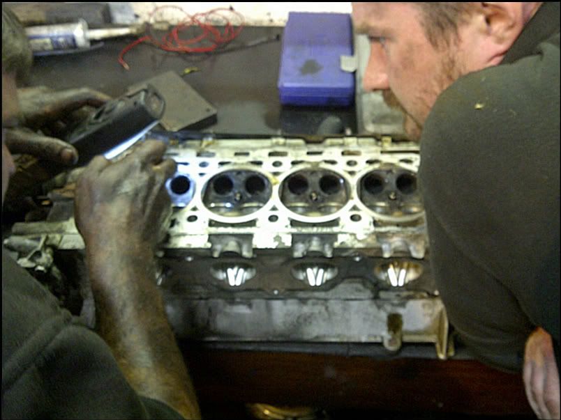

    first run... the car makes stock, on a stage 2 map... Paul looks worried, I thought he was joking. he tweeks and plays and asks how old the sparks are, old enough is the answer, so he bungs some of his own in to check, this instantly raises the low end power but again the car hits stock. So at least the sparks need changing regardless of the little problem I was thinking, little did I know...
    then we move onto the cambelt, it hasn't been done in a while, I was shown receipts for it being done when I purchased the car and that was four years ago, it needs changing asap is the answer to which i agree and know i need to sort as it might be the timing thats out.
    Exhaust issues and turbo failure are also ruled out.
    Paul wanted to rule out other things so he attached a booster to the battery and did a compression test with Wade (Hughesclio) who happened to be there at the same time.
    cylinder 1: 130 psi
    cylinder 2: 150+ psi
    cylinder 3: 140 psi
    cylinder 4: 70 psi

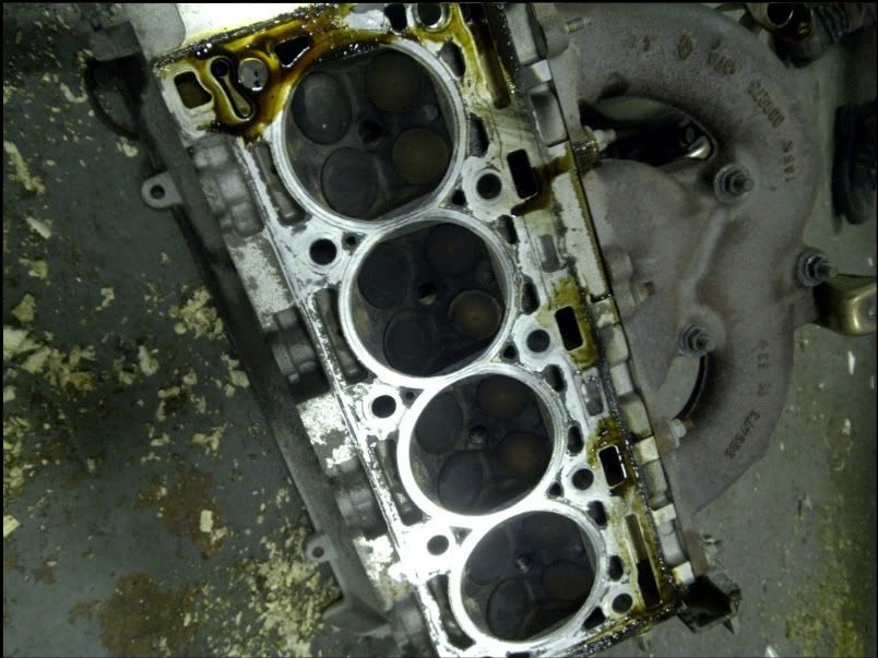

    And there in lies the problem, the compression on cylinder four is low, as in LOWWW. thats why the car has never made the power a stage two would and has/is gradually losing power, the severity of this shown by the fact a stage2 map (one that has been tinkered with for ages) only gives the car stock power.
    The car boosts at 1.3 bar and is still making over 30 ftlb torque so the turbo side of it is fine. Paul put the map up from his R26R and compared it to mine, the similarity between the maps was scary, they were exactly the same minus the fact mine was 55bhp down on his, but the curve, drop off and boost were identical.
    The general consensus is that there might be a water ingress into the cylinder head, as the car is losing coolant slowly (dumping the tank at Oulton in January, but only slowly since) something to do with it creeping into the chamber through a gap. Also one spark was discoloured and paul was certain of water present, along with mild frothing in my coolant tank during all the checks (no idea what it means, but it means something bad). in pauls words... 'its fcuked naithhh' :worried:
    I went to Leeds thinking I'd be in luck, came home with a bloodied nose.
    I drove home feeling sick, its a weird feeling when you crash/cars broke/stolen, im still sat here feeling sorry for myself if im honest. Even now I'm lost as to what to do. I've put too much time and effort into the thing to just break it for parts and at the same time noway can I afford a new engine (even if more work comes in)
    leaving Leeds gave me time to reflect...

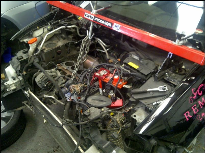

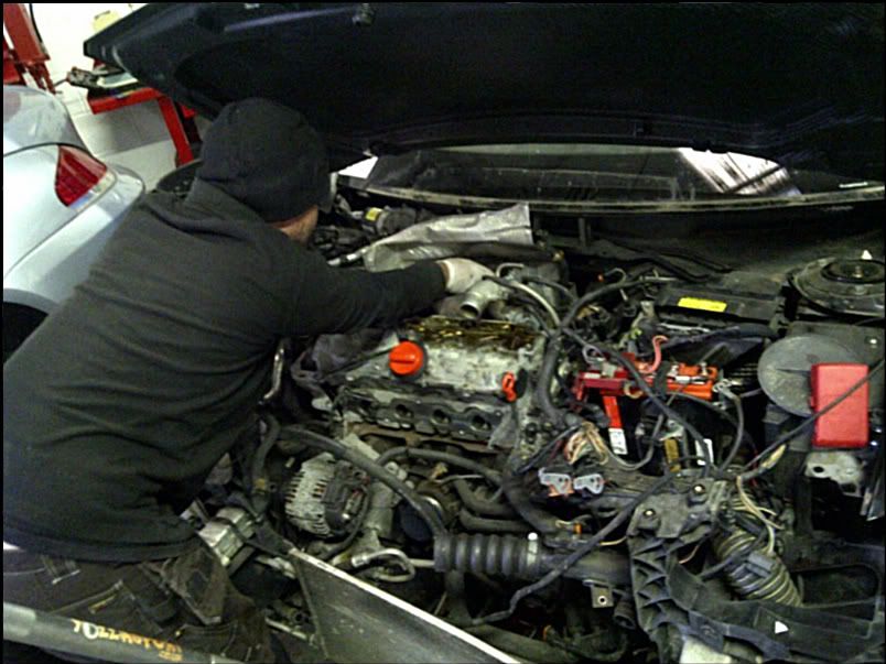

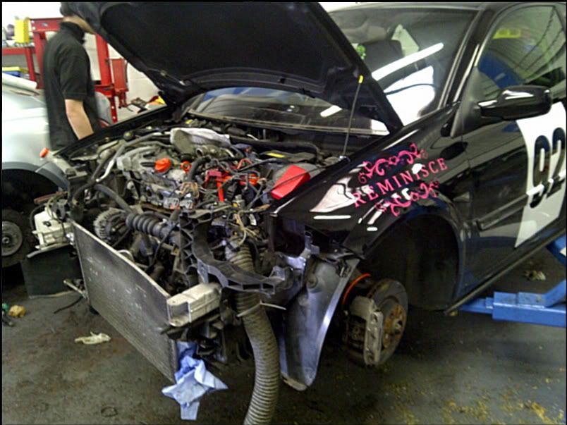

    As it stands the car will go to fred@btm on the friday before Renault world series to have new sparks, i know it wont make much difference but i'd rather the car struggle less before it has blows/gets a rebuild/new engine. (If you have any lying about in Dieppe RUK, look after a brother :wink:) Luckily RWS is a show and shine event, otherwise I'd be gutted, I have the car visually looking better than ever so on that front I'm lucky, on every other one I'm not so lucky.. lol
    After the show she'll be taken to BTM and endure a slow and painful strip of the heart. In my head I see it being the top of the engine coming off (which after seeing another meg engine this weekend is a bugger in itself) and the head gasket being changed along with the ring landings, cylinders (four is the problem) and all the internals will need looking at too. but due to cost it will be a long process, I have a decat lined up and the new RST uprated pistons will be sorted then too I hope (around the £600 mark) so the engine will be rebuilt strong and with the capacity, bar injectors (that arent working on megs properly still) and hybrid turbo, that can be added (if I have the time/ability/finance) to run more power.. During all this i'll run about in riads 172 which will be roadworthy very soon.
    the other option is to wait till finances suit and buy a well priced second hand F4RT engine (preferably with an R26 diff on it) and swap them, adding a decat and playing with the turbo wheels. then she'll see a solid 290/300bhp and 330ftlb torque all day.
    third option is to bin the car off...
    so yeh, FML. but at the same time I want to say a MAHOOSIVE thanks to paul for spending alot of time outside of the service I'd payed for trying to fix the issue, the care and knowledge is top drawer and also as ever to BTM who have said I can keep the car there whilst the work is done.
    as a friend said today, 'Phoenix from the flames Naith..'

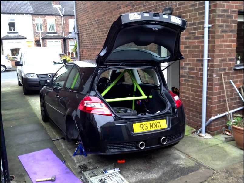

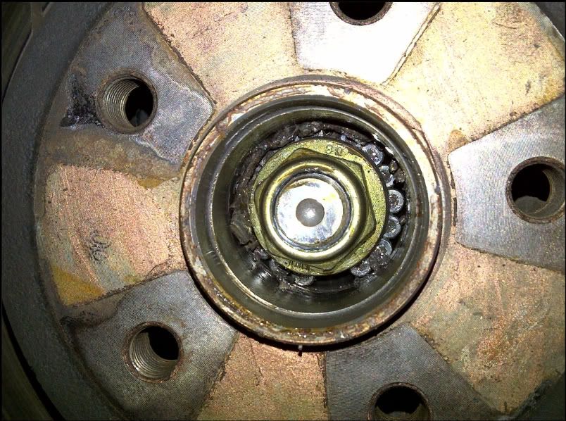

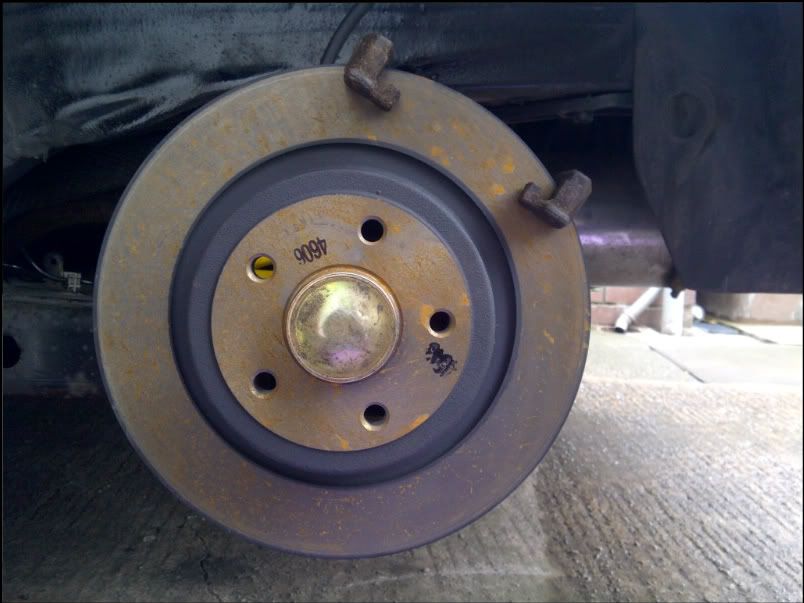

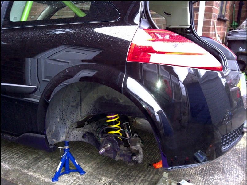

    On my birthday (last friday, 12th) i decided to take the car out for one last run before she goes to BTM in Birmingham, I was meeting BrownBear and Christopher for abit of food and a chat, cheers for that btw lads...
    on the way home i was driving along normal, exited a roundabout, warren about 100 metres behind, straight road and felt nothing like it before, the car snaps violently to the right like its swapping ends, the wheel had locked itself against the brake and with instantly felt like rear suspension failiure lifting the front N/S the back slammed into the curb..
    now i'm no Alonso but I can pilot a wagon as well as some, but there was nothing i could do... I pulled continued for about 50 metres saw a locked tyre and sparks...
    Getting out of the car i could do nothing but laugh and hi5 warren, i mean its just my luck.. on my birthday... my first words after checking it wasnt the suspenion arm were 'Bearing failiure'...

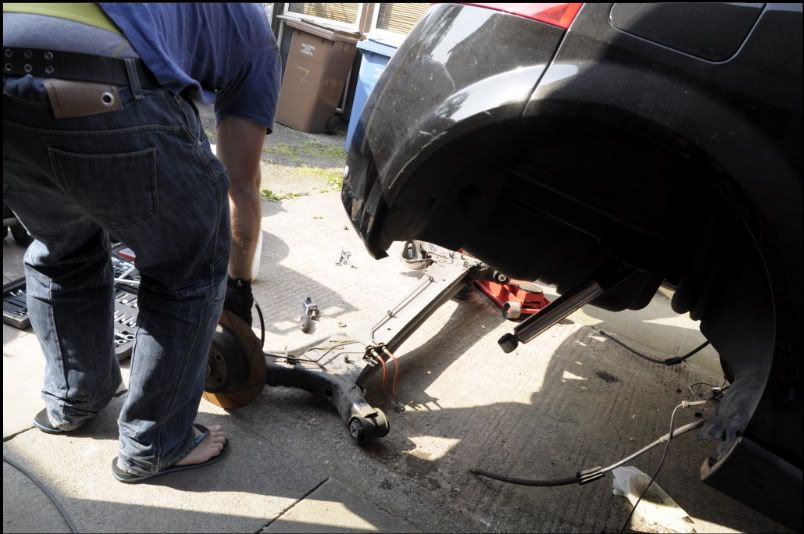

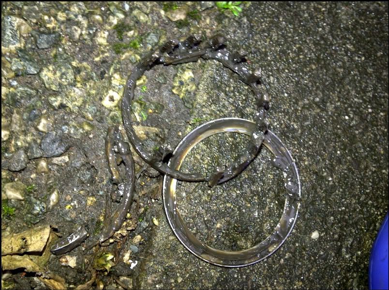

    Anyway long story short, I drove the car another 100 metres down the road before she had no movement at all, the brake had seized to the disk, the pads were instantly ripped to shreds, the wheel had loads of lateral movement . I rang flux and arranged recovery, 2 hours later in rush hour some old boy arrives and spends the next half hour telling me, warren, riad, sy and jon (the jesus) random stories about all his women and how he enjoys racing MG's?!

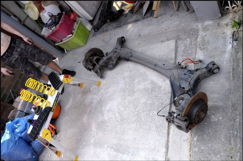

    anyway got her home, up the drive after 20 mins effort and spent the weekend getting ruined.

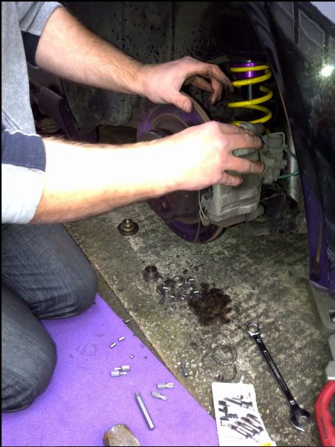

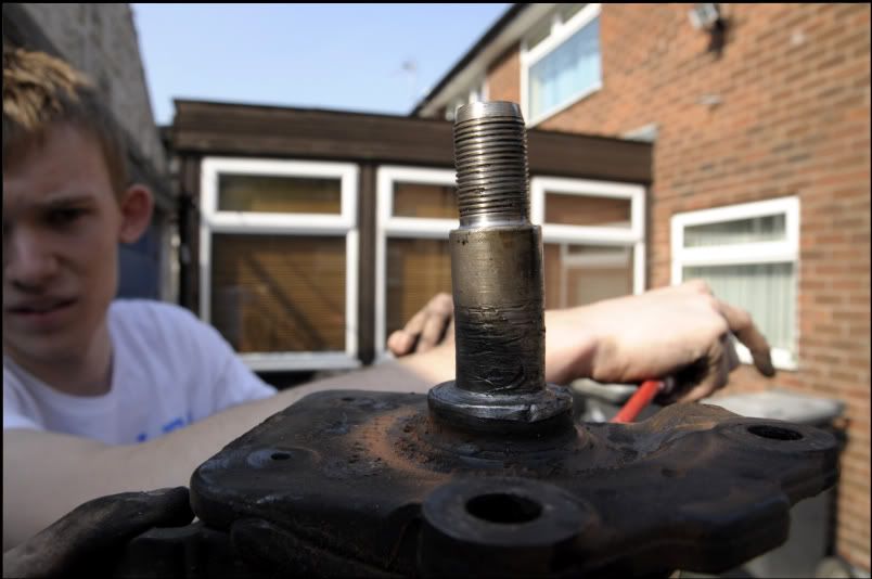

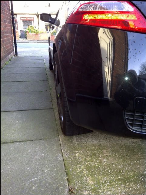

    monday morning, lets have a good nosey. from -1.5 neg camber to plus 4/5. nice. (luckily i'm after some very special rims that hopefully will be ok to use..)
    I asked around on the sly, the general consensus was the axle needed replacing, I obviously thought (maybe through hope) that it was just the bearing that had gone inside the disk. So this morning 'mat-nos' comes over and we strip the rear down.
    At this point i'd like to thank renault for building cars and assembley that have about 6 combinations within a wrench and allen key set for a single applience (the rear brake unit)

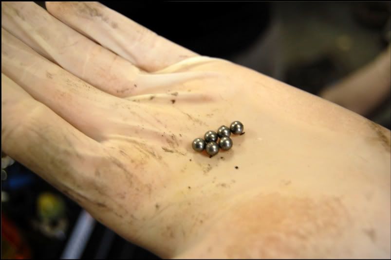

    yes thats the bearing internals on the floor :worried:

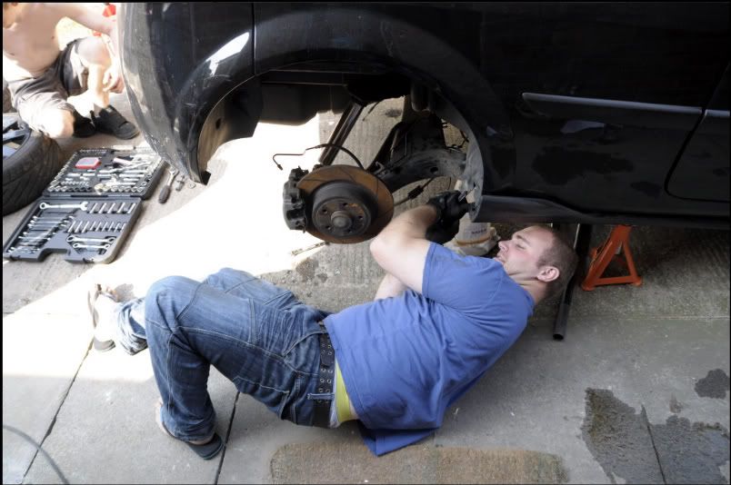

    we stripped the rear assembly down with alot of cuts and trips for tools to my local motorsh1tworld,
    getting to the hub nut... it was not on tight, when i say not tight i mean its most probably the cause of the bearing moving about and causing it to fail, I now know its the bearing that failed as upon pulling the hub nut cover off the bearing internals fell out like sick. We eventually got the caliper housing off too and the disk, which considering the impact and the ABS marks is in good condition (obviously bar the bearing it houses).
    In theory we could press the bearing out and have a new one put in but for the price and safety of a new disk housing i'll just get a new disk ordered in, im hoping the Stub Axle isnt bent, on first impressions its hard to tell as the cars sat on an axle stand. For money and time more than anything I cannot afford it to be an axle replacement, but i dont think it will be. but I also dont fancy dying yet, so if theres a chance it could be mashed its getting replaced.
    and here she is...!!1! lol, stub axle on show, sat on an axle stand with carrier bags covering the assembly, hardc0re.
    tax runs out at the end of the month and whether its via trailer or slowly driven there she's off to Birmingham to hibernate, she's not coming back for a while... time to get the blanket out and say goodnight for the winter me thinks.

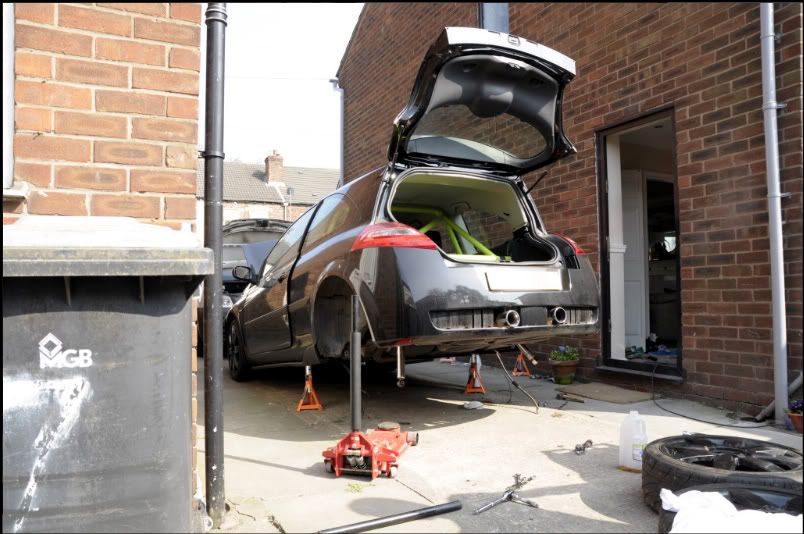

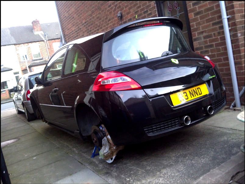

    And so it begins.... ALL wheels off, sat looking sorry for herself, not driven in 3 months. The wheels will go back on tomo and the OS rear has a disk so the wheel can click into the bearing and it will go on northys trailer for its journey south.
    in the event the stub axle is bent (i fear it is) i have sourced a whole rear assembly of a cup that will just be swapped over.

    Okayyyy, its been long enough now and fcuk all has happened, I wanted to forget about the car and was ready to break it but i opened her up and sat in her the otherday and slapped myself.

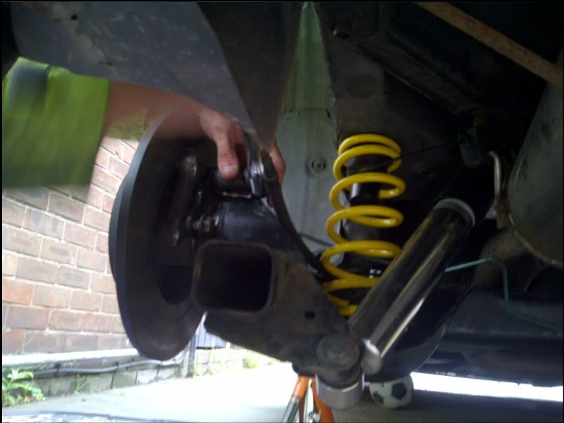

    so with the new beam bought we set about swapping it over today to the new stub, axle, lines, basically everything. I say we, I mean mat-nos and 'curtis' who put alot more graft in than me, I was site forman i guess :wink: excuse orange in pics and on the car, been having alot of house renovations done and the car is FILTHY.
    the whole process took about two hours and as everyone got cuts and bruises we eventually dropped the old rear beam, arb and axle which had seen better days.
    when the rear wheel went back on to see whether it was just the bearing that was knackered it showed (with about 3 deg of positive camber) that the problem lay deeper, beam off and inspected the stub axle shows the true story of the damage....
    Anyhoo, all rear components were removed and the new beam tidied up. The braided lines will be added back onto the new one tomo after they've been cleaned along with the KW springs and dampers/adjusters. And hopefully the calipers are erm, given a treat :smile:
    Anyway, the car will sit like this till sat morning when we add the beam back on, hopefully with new rear brake disks, the boot floor will be coming out too and replaced with a CF blank, to enable the exhaust to sit VERY differently...

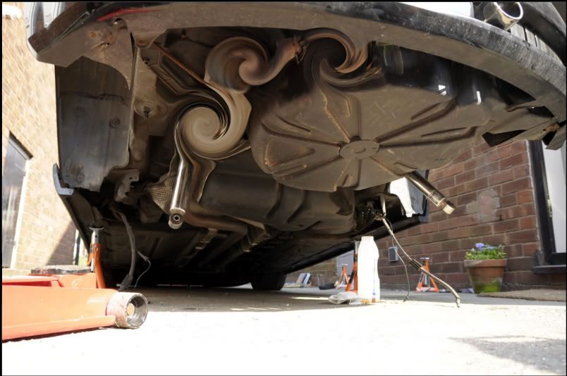

    I also thinnk it only fair to explain the exhaust seen as its asked everytime i'm at a meet, the in depth accurate pic is below
    :wink:

    full new phase 2 beam is on, curtis! and mat nos to thank for their sterling efforts, all 4 hours work as it wouldnt sit properly uintill we got angry and erm how do i say this, beat it in...the temp left rear disk i wanted to run was also cracked in the bearing so bought a disk from BTM this week, well from renault via BTM but whatever... its fitted in this pic just didnt have time to get the caliper and brake assemblys on unfortunately.
    going to build the brakes back up tomo, bleed them and get her dropped down. took the adjusters out from the back suspension so she'll look decked, not sure if i'll like it but its not hard to put back on so we'll see tomo....
    shaping up nicely. hopefully run her round the block with a jerrycan of 97 tomo/sunday, Insure myself back on her and MOT her....

    i wanted the car on four wheels sat ready to have the front taken off and parts layed ith to make her 'road going'. it was my plan to switch the insurance over this week back onto the meg but nooooooooooooo.
    when the bearing failed and the wheel went the side impact mashed alot of things up, we thought all the parts had been replaced. the caliper carrier however is bent, fitted to the new disk it rubs on the top and is wide on the bottom which tells the story of the bottom of the wheel hitting the curb the hardest and bending it. looking at the pic below it was so fcuking obvious too...
    i now have two options, i've emailed a guy on ebay breaking a 225 in salford, if he comes through then happy days as he'll be local. other option is a new carrier from renault, even after being 'looked after' it still rocks in at 80quid roughly. I'd need to soak the arms of the ajoining carrier and vice the bolts out too. whichever way i look at it, its a setback i didnt need. on the positive at least the new carrier wont be rusted up to the nines :clown:
    Beginning to wonder whether she'll be fixed anytime soon..

    Feel like all I'm doing at the mo is putting up the same pictures, but alas progress is progress for 'the pride of the fleet' :wink:

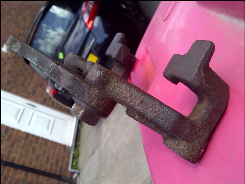

    cliospares came good with the caliper carrier i was after (thanks guys, great price too) truffs bought it over from doncaster and i test fitted it on monday...
    disaster, the carrier was sat about 7 inches further round towards the top of the disk....
    (and yes thats a brand new disk, oxygennnnnzzZz1!1!)
    so i moaped about tiil today, realising the cars GOT to go to Birmingham this sunday/monday i had a play with it and realised it was for the otherside of the car and all i needed to do was unbolt the spacer from the carrier and turn it round.... DURRRR.
    got my neighbour to hold it whilst i did it, talk about stuck on, tighter than a mouses ear.
    eventually all off, rebuilt and ready for matt to check it on saturday before she goes south. exciteddddzzed.

    Anyhoo it made it to btm and is there now having its guts ripped out. Fred and Sam are using the car as a platform to launch Potatoworks... The hardcore/pikey arm of BTM. yes I'm scared too.

    So on tuesday morning with 48hrs to go we set to work. Myself and sam started pulling the car to bits under freds supervision. He was working on other cars so we were kind of left to it and because i've had the bodywork off her before it was no biggy. To motivate and make the car look half decent i got on with my stickers for LeMans half cut by me, the others done in an excellent fashion by the bryan brothers.
    this sums up freds stance during the 48hrs...
    Being a really messy engine it took ages to pull everything off.

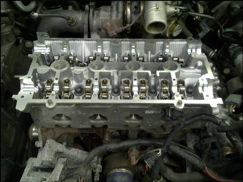

    we worked our way down assessing where and what the cause for loss of compression was, alot of people have said what they think it to be and when it boiled down to it Fred was in the right. I wont beat around the bush, the cars had a tough life, it was one of the first to be mapped in the UK and has spent ages on the dyno. This obviously wears parts down. The main problem we found though was that cylinder three in the head was the weak one, yet when fred did his 'tests' cylinder one was the one that dropped all its contents.
    F4RT Head.
    As you can see in this pic the apparently fine cylinder one has dropped all its contents obviously something major is up....
    Without going into detail to much the valve seats werent sitting in their seats properly. This annoyed fred as he'd pulled the pistons from the engine to check for scoring and damage and they were fine as he's always said they would be. So in essence we were left with a bare bottom block with a seperate head that needed all its valves reskimming. 24 of them and each need about an hour.... FFS. All along BTM had said it was the valves and their seats but hey ho.
    Fred called in a few other specialists for their opinion and it was the same, look in the pic below and note the build up on the exhaust side, granted it should get sooty and full of fuel but you could literally peel this off and feel it not letting the valves work properly...
    sump off
    Pistons checked, and checked again, no scoring or damage to the ring landings (is it?)

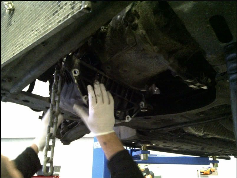

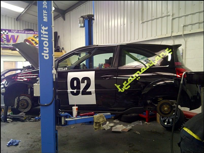

    Book time stood at 44 hours, We had Wednesday... On the way out of BTM on the tuesday night at 11.50pm fred had an idea. The Velsatis head is very similar to the meg (he thought)... A quick midnight call to Adam @ Renault Wolverhampton confirmed they are the same bare head. Fred had 3 Renault developed F4RT heads from Dieppe and bar a check or two would go straight on...
  26. Naith
    Wednesday 7am
    Fred 'Dont come near me till this afternoon, this is a BIG ask by even my standards so FCUK off i dont want anyone near me all day....'
    We left him with 10 redbull and some ciggies.
    Now I dont exactly know what happened in the time until lunch but when i arrived the engine looked like this.
    It had a new sump on as mine was bent, it had all the pistons pushed back in and new gaskets and thingys fitted, cams in and all timed up, the shiny new development head was on with new valves and valve seat, a far cry from the burnt and sooted ones that came from my head. fred showed me the new valves and how they should have a 2 tier level of colour, mine were a mess... 'overfuelling its tits off'...
    Throughout wednesday I carried on with the graphics and occasionally helped out, ie tightening the bolts on the top of my engine, so I could tell everyone I had done all the work :evil:
    Fred explained that he's also fitted a different 'BTM spec' headgasket that slightly raises the engine compression.
    On weds afternoon another of freds customers phoned in a mess as her BMW had broken down on the Mway.... 30 miles away. True to form of helping people fred set off and along with myself we towed her car back to BTM and fred fitted a new alternator... as you do.
    So another two hours lost but we were now getting to a point where we could not give up. Some of the LeMans lads arrived and fred sent them packing to their hotels as we had the rest of the engine to get in. I went to BAP engineering to pick up my severly buckled rear wheel which had been weighted, another thankyou. And sam set all the parts ready for them going back on.
    So cracking on the rest of the engine got built up during wednesday evening, at this point freds back, hands and head were fried, myself and sam werent in good shape but fred was f**ked. I learnt so much over the two days about engines but bar embarressing myself lets just leave it with the engine was pieced together slowly, a new water pump went on, a new radiator (leaking heavily), new cambelt and various other little bits. It was now Thursday morning 2am. We had to leave for the ferry at 7am....

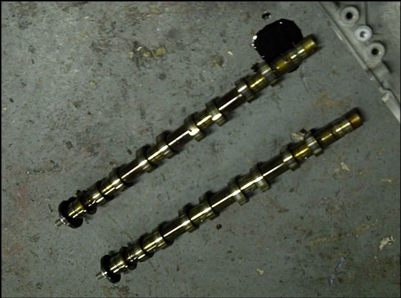

    Cams going back in... we were looking at Velsatis ones but due to a few unknowns we played it safe at went OEM.
    I'm sat there shaking in a chair biting my nails, fully aware that if the car doesnt fire and the compression is off then it wont go and indeed neither will I as the efforts to get the clio sorted would take days.
    Fred manually cracks the engine to get a flow into it and connects the battery. Now it being a dry lump i expected it to be a messy affair and fred warned me it might be. Exhaust reconnected... filled with oil and coolant, pipes, FMIC fitted, no leaks or drips, engine mounts on (that reminds me i need new ones)....

    Ok those that went to World Series would have seen us sardined in again this year. Wont be doing infield again as it wasnt a collectors area.... reete, the car...
    the engine is still fantastic, mappings not right but i've not had time to get it sorted since the rebuild. Regardless the BTM spec engine is fantastic.
    With the lack of work i've not been able to do much to the car but have done a little. Aiden (a chap off Meganesport) does short shift conversions for the megs, basically a cnc'd movement in the nipple that halves the meganes terrible throw
    Myself and mat-nos fitted it just before wsr and i did the traditional cleaning of airbox and airfilter which was thoroughly clogged up, joys of running a CAF.
    Well what can I say its fantastic, it gives the meg a shift feel and ferocity equal to that in our 172, you can literally punch the power in when before it was a long sloppy throw, a definite top cheap mod, especially when you see people spending silly money on things and this exchange basis mod is £35!!

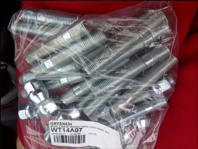

    I've still not got round to fitting my studs and nuts i have, purchased some 6mm spacers too now to accompany them. I've always hated the idea of spacers thinking them cheap and tacky, I felt that offset and stance should be because you have massive motorsport spec wheels, when we replaced the rear beam for a ph2 cup one we had the problem whereby the cup beam is a little narrower, the offset is equalised by wider wheels that the cup/R26/trophy have. At the moment I don't so needs must....
    They were provided by a friend in the motorsport trade and i'll have them on asa[/SIZE]p..
    Bedded the shifter in on the way to Silverstone last weekend and the car (apart from the issues i'll state below) was great, the shortshifter is a proper mod.
    (photo credit to Harpham @ RWS 2011)
    now to the problem... the ride on the car is crap, i really need to get it to a geo specialist or someone who can see whats up with the rear. When I damaged the car it was on the OS rear, but the beam has been replaced. I had the wheel balanced for lemans and that helped but thats the weird thing, turning right which puts pressure on the OS is nigh on perfect, its turning left which is bad, bad as in i have to back off and take corners, especially sweeping bends and about 60/70% of what i could do. its scary as the car basically tries to step out and wobbles.
    granted the tyres will get changed soon and the KW's need totally resetting but its top on my list of priorities to get it sorted as bar cruising along its stopping me enjoying the car for what it is :worried: the brakes need about another 2 litres bleeding through to as there seems to be air in the servo.
    Hopefully got some work on the way so when bills are paid i will have a few cheeky additions i'm sure, its far from over.

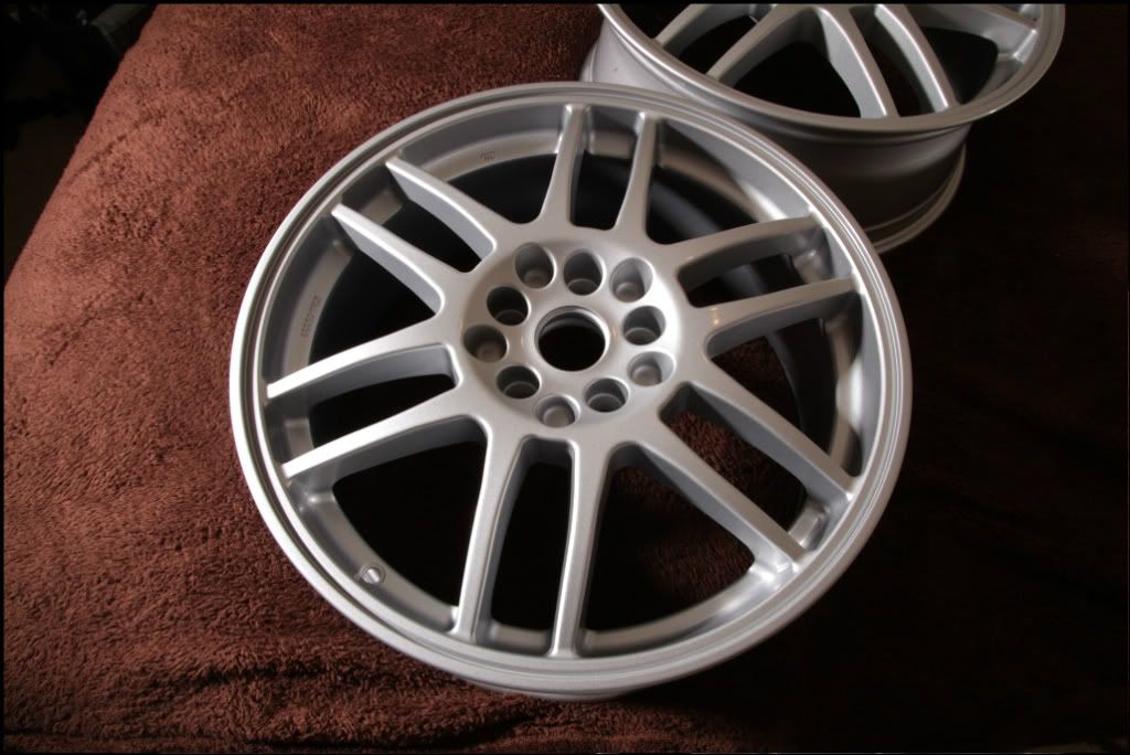

    All has gone quiet on here recently, truth be told the megs been the least of my worries, some will know I've been running the KA now for abit anyway. It was my birthday weekend just gone so i bought something i've been after for a long time after saving for abit.

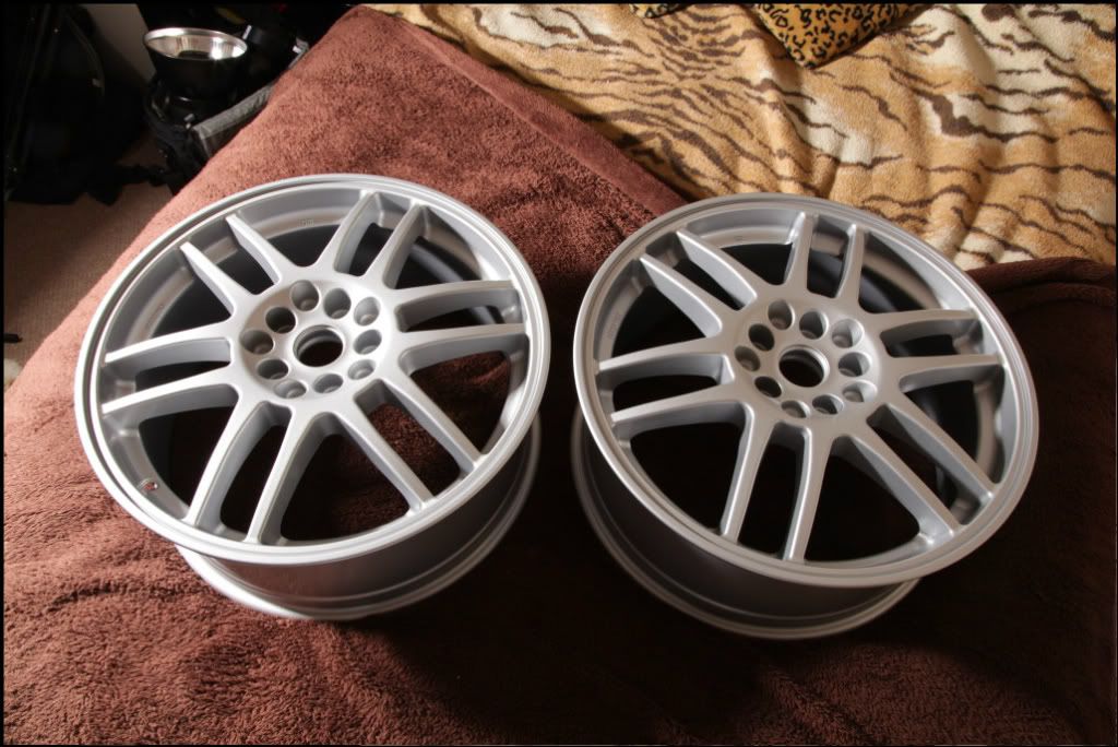

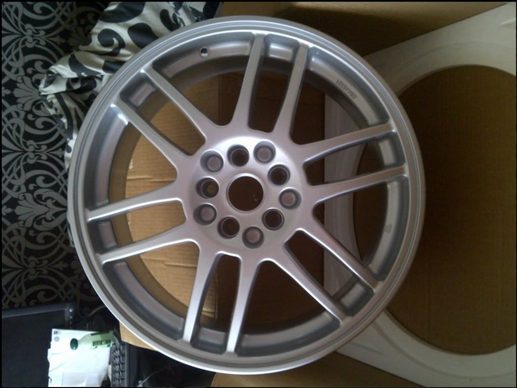

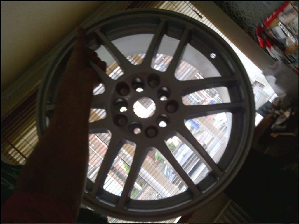

    not only are they rare on megs, they are rare full stop.

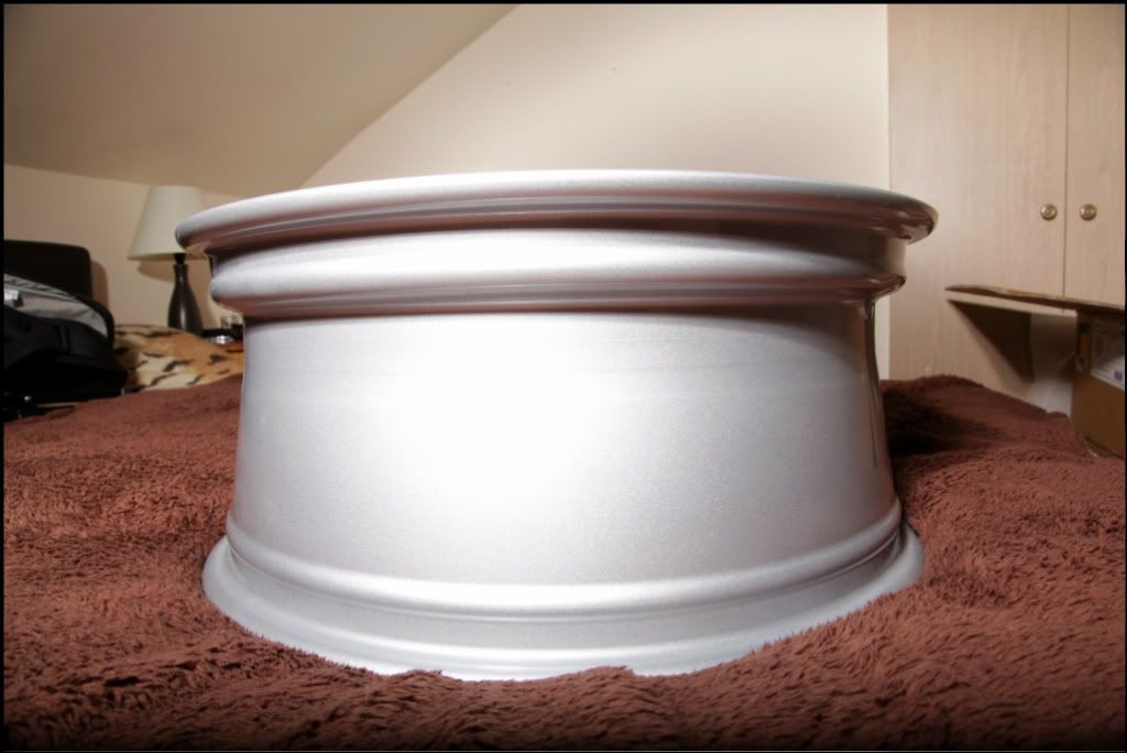

    In 18", their offset sits at ET50, which in plain english means they will be wider in the arch sort of giving a touring car look, I honestly nearly squealed when i opened the box, they are absolutely stunning, r riad has took some proper pics but i'm putting these up now as i couldnt wait. I was noseying around demon tweeks last week and one of their experts ended up telling me the wheel is heavy, old and crap...
    old? brand new in box....
    crap? used from F1 to lemans
    heavy?
    not that i need to justify it to that random or anyone but there we go...
    Huge thanks to Nic at Renault specialist breakers in Accrington, friendly service as always. Next week the wheels will be getting powder coated. Part of me loves the silver and the OEMness but its not what the car is all about. I know they'll look mean as hell in gloss black too, so there we go... the rear is off next week too and new chassis plates are going on before BTM fit the studs and nuts.
    Missed out on ebay by 50p for a rallyesque battery box, with the cold the race battery is bobbins, it cant hold its charge to save its life, so i'll be getting a clio battery (slightly smaller than the meganes) and running the wiring to the boot floor, thus freeing up some bay space where the new intake will go that i'm having built...

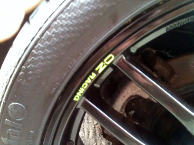

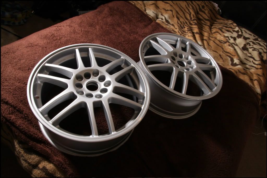

    * 18" OZ F1s fitted after being powdercoated satin black, rears shod in 235 ContiSport SP3s.

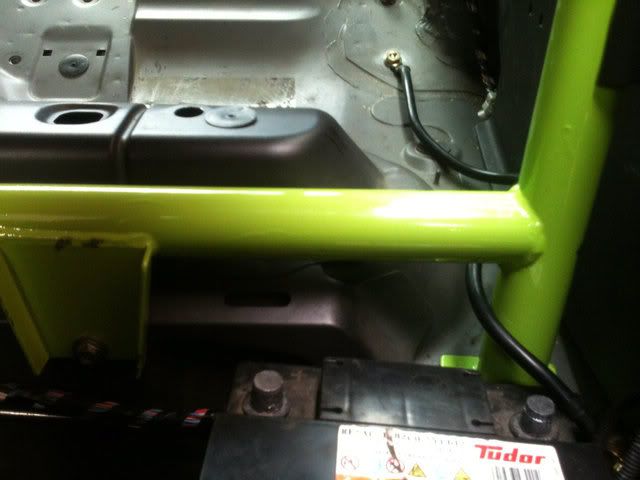

    * Battery moved from bay to behind pass seat, Negi feed run to chassis point and posi created with a BMW E46 M3 cable, clio battery used.

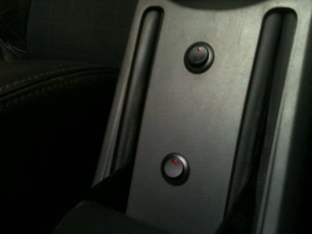

    * In car TC switch toggle binned and replaced with 2 LED switches

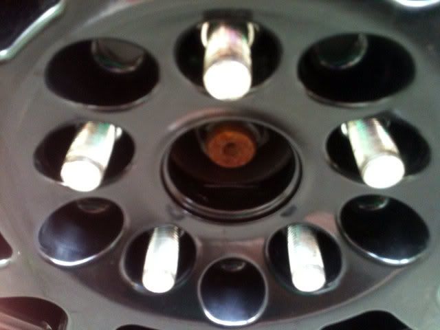

    * Studs and nut conversion done to front hubs, marked and set in.

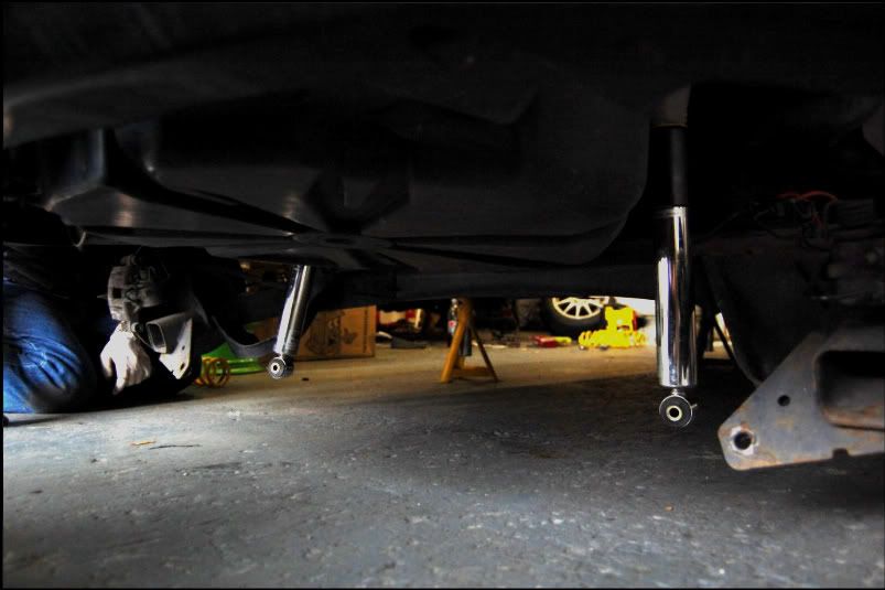

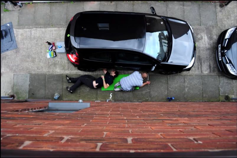

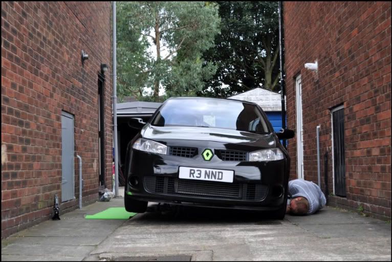

    So... set about sorting some problems on the car yesterday using a friends ramp. really happy with the progress made to be honest. didn't think the car would make it into the garage but after using alot of wood and hopes and dreams she snaked in.
    IMG_0014 by NaithanAriane, on Flickr
    IMG_0012 by NaithanAriane, on Flickr
    all the bits of rust above were powersanded and sprayed to protect it, looks like new underneath now tbh.
    Had the rear beam off in about 10 mins to bolt the replacement plates in, brake lines off and plugged plus all other ancillaries, licked the underside with protectant whilst i was at it too, so the car now has 100% Phase 2 cup rear end inc roll bar (thinking about it the only thing thats ph1 225 ff is the shell, side and rear windows!) Pulling the rear plates off theres no visible damage but the cushioning ring for the left spring has deteriorated and stretched, showing left to right stress movement, anyhoo we fixed it and replaced it.
    I then worked my way around the car removing any scum from stickers on the windows and headlights, such a small thing but massive difference.
    IMG_0039 by NaithanAriane, on Flickr
    Tom and riad then reckoned they could fix the handbrake, so i left them to it as the missus showed up moaning i hadn't seen her all day, hard to explain the meg handbrake but it failing is a common problem. basically the two cables hook onto a teether under pressure, if one is a little more slack the teether bends until it fails popping it off the cables. To my shock they fixed it and we timed it tight so it only needs two clicks to bite.
    Onto the other lift we removed all the rivets and connectors for the skirts and remounted them, miles better now and i'll seal them this week with some black sealant i picked up over the winter. i also sprayed my centre caps black (bar one i got stuck testing the fit) no biggy to fix though, having some green oz centres made up to finish them off this week.

    Also fitted the LED fog light, will take it off today to spray the surround too.

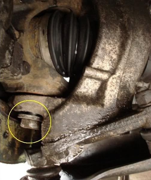

    The car was suffering from the above problems (for the lazy ones it was basically uncontrollable!) I was at a loose end but p@blo came to the rescue and sold me a new hub, I was about to update when ready to fit...
    My mate tom had the car up on his ramp and noticed that the lower arm bolt connecting to the hub was bloody finger tight....!
    I'd already wasted 100 on the cars tracking at this point, P@blo said he'd be happy to take the hub back and I could have a pair of driveshafts off him instead as a straight swap... So all the issues over the year and the trouble in LeMans was due to a loose bolt, thats life hey! Scary to think if that had gone though, well I dont know what would have happened but not thinking about it, Tom has said he'll check the car over after track, long runs so i know its safe hands if not being tinkered with at BTM.
    Basically bar a few nuts and bolts the only bit that needs sorting on the car. Bought myself a Scangauge 2 that sits where the clocks used to be, seeing realtime figures of what she's upto is great, due to this i've binned the analogue gauges off, water temps, inlets, boost, volts, RPM, the list goes on.
