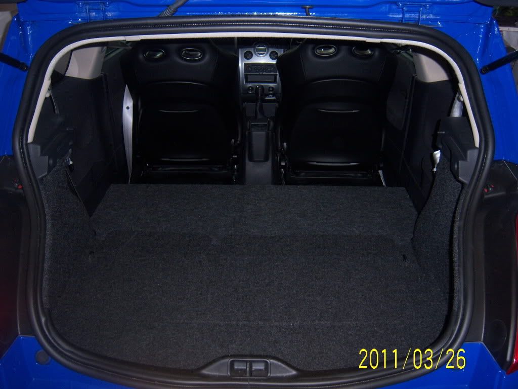

  24. Get those back seats out Steven, with the OEM+ style of your car a nice lightweight floor with carpet and a strut brace like an .R without the cage would really set it off :cool:
  25. I should have a picture somewhere of my old blur one, just get it all out mate, you'll love the wine from the rear brakes
  26. Without the rear bar [​IMG]
  27. I just put the rear bar in and hung a cargo net down to the hooks on the floor, looked mint , I just used a piece of 6mm MDF board covered in the same colour cloth

  29. That looks really good mate!
    The stripped out interior is starting to grow on me. At this rate ill have the car stripped, buckets seats fitted and at cadwell chasing you and sheep all day. Lol
