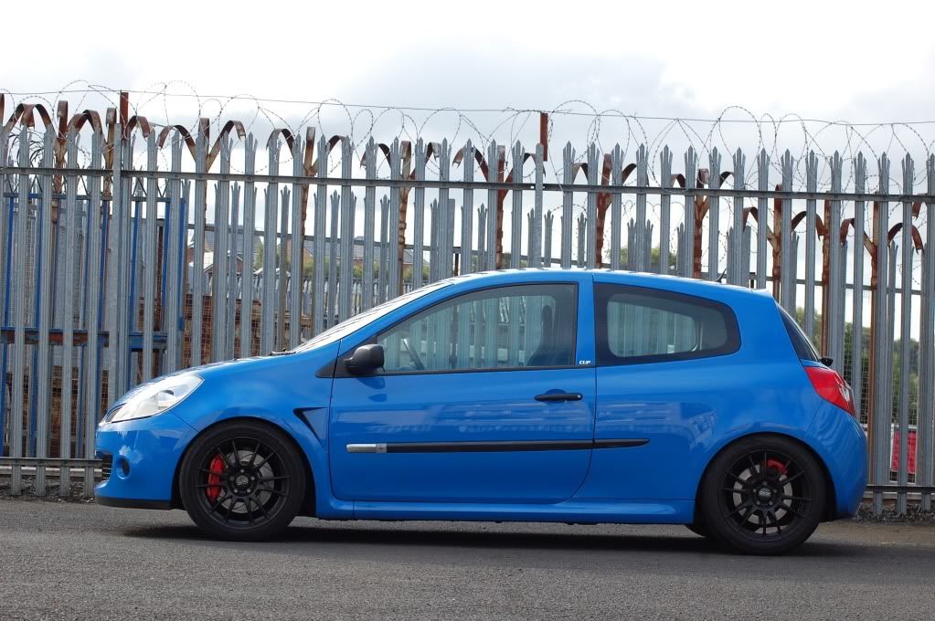

  2. I have with the AST's on my 197 Cup.
    I had AST Sportline II and their 'track bias' kit was 80n/mm front and 110n/mm rear
    Their 'Road bias' kit was 50n/mm front and 50n/mm rear
    Some pics...purely because I loved that car and miss it
    :blush: ( I think KamRacing still use one of my pics on their page for the ASTs too:cool:smile:
    [​IMG][​IMG][​IMG][​IMG]
