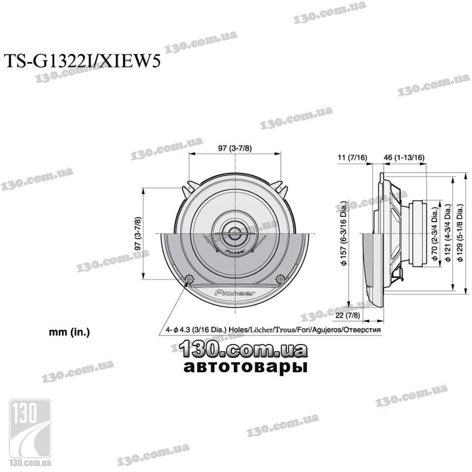

  11. Looking at the tech spec of the Pioneer TS-0131Cs it appears (if I'm correct that is) they were 46mm deep, which was the reason they fitted as they had to be shallow.
    So I'm thinking any speakers that are 13cm and a depth of 46mm or less shouldn't be a problem.
    In fact these models show the same depth as the Megane specific Pioneer speakers -
    http://www.caraudiocentre.co.uk/product_m-pioneer-ts-g1322i_p-27493.htm
    http://130.com.ua/published/publicd...tures/Car-speaker-Pioneer-TS-G1322i_3_enl.jpg

    They are the same mounting depth as the Pioneers so can't see why they'd problematic.
