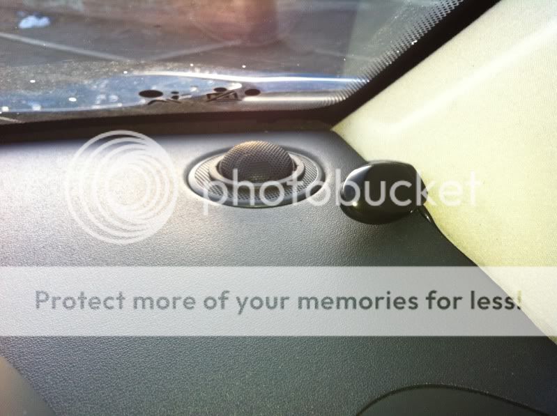

  3. I've managed to squeeze a pair of Hertz in there. You have to cut the plastic shield in the door to get it to fit. The Hertz are a component speaker with Matching tweeter.
    In my experience you'll not benefit much because the standard megane hu isn't that good.

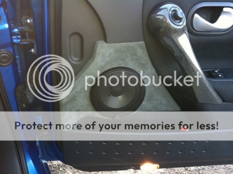

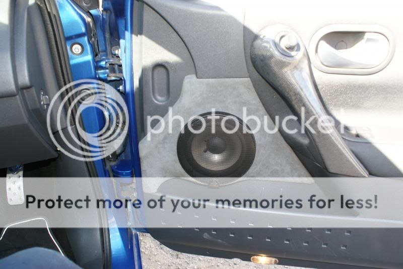

  4. I have these in mine. They were made by an old forum member & allow for larger speakers.
    Lee
  5. Thanks for the replys, I manged to trim the modify the speaker itself and cut some of the inside of the door panel off to allow more depth. Those speaker panels look pretty nice Lee
