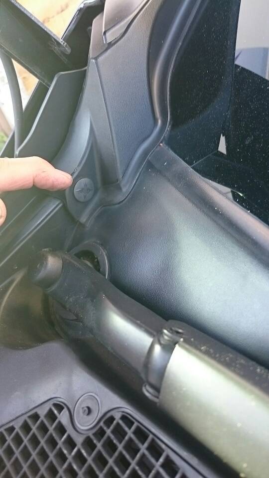

  20. Got the puller, bit different from yours in the pic L-1011 but assured it will do the job. [​IMG] is this one of the grommets I need to remove? The mesh cover seems to Hinge on these,shit, being under the bonnet makes me nervous!
  21. Hmm.
    Mine is different. Yours a mark 3 then?
  22. Yep, think so, it's a sixty plate. Got the puller and have now sent it back, found one the same as yours just waiting for it to arrive
