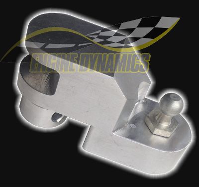

  1. Modified vs engine dynamic. Which is better?[​IMG]
  2. Think the consensus is that the Engine Dynamics one is fine for a phase 1 car but not for a phase 2 R26 as it's not up to the task. Better modify your existing one if you can find someone to machine it. Would like to get mine done sometime.
  3. @chappers2000 i already have the mod. But was told the engine dynamics version is better? What's different ph1 to r26? Thanks mate
  4. I quote " If you have the earlier twin spring smaller actuator,then buy the engine dynamics linkage, it will work fine on the earlier phase 1 cars.
    Just dont fit it to later 225s on..this has a single spring actuator, and a far larger linkage..so the engine dynamics shortshift is to light to function correctly.".
    Just what I've read.
