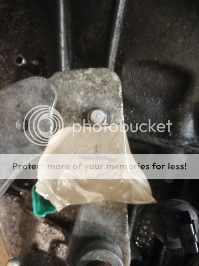

    This is a picture of the gear linkage on the Megane DCi 175

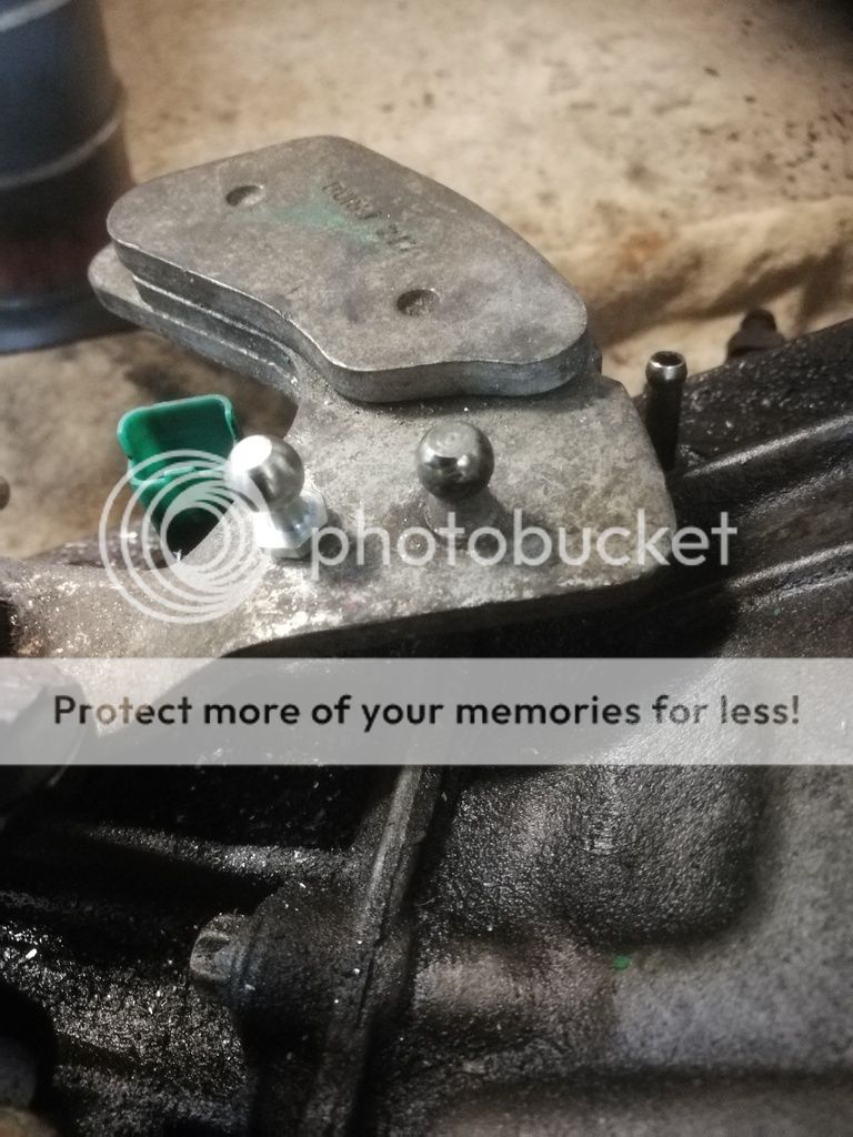

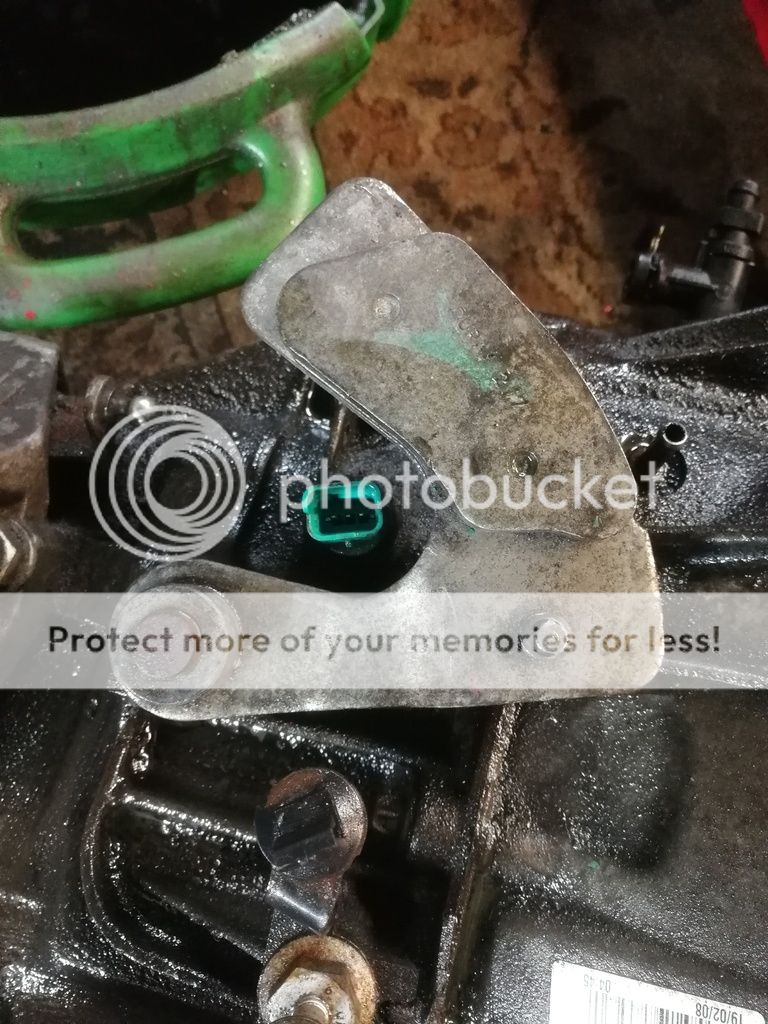

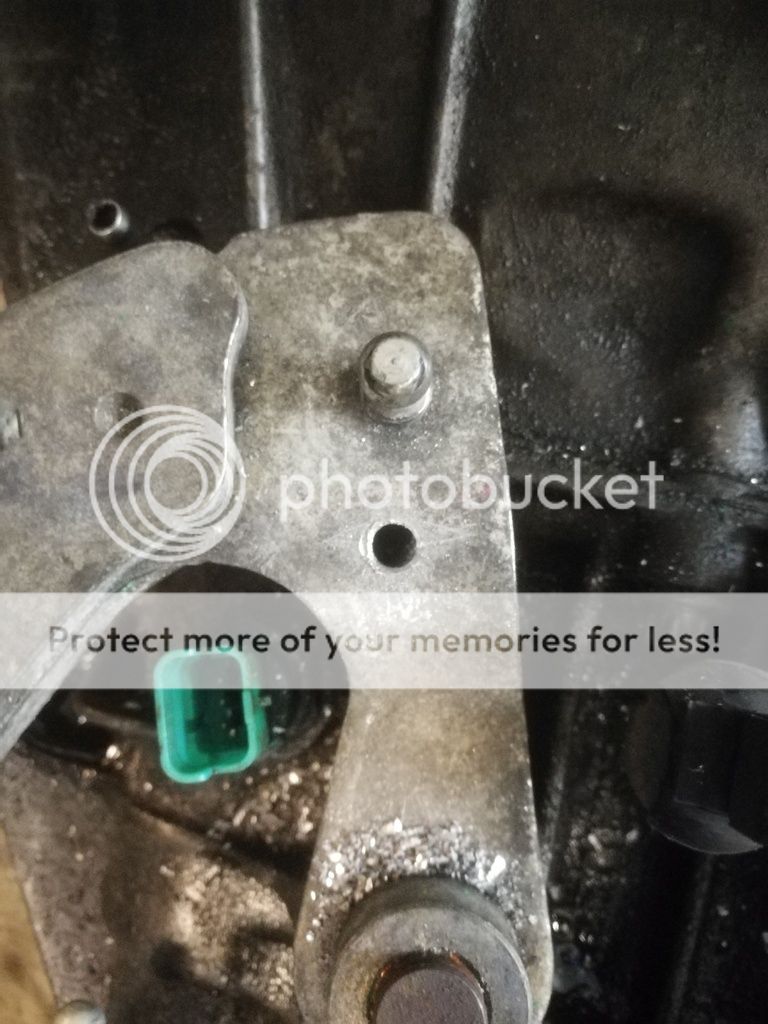

    First mark a point 20 mm from the original ball, pilot drill a hole on your mark, i used a 2.5mm drill bit.
    Just double check the measurement and then drill to the tapping size of the thread, there are 6mm studs available but i went for 8mm as it should be stronger.
    then tap the hole, then screw in the ball stud, i put a lock nut on the bottom, but i think it might be a bit tight to do with the gearbox in place, so if it isn't possible to put a nut on then use a thread lock glue.
    the end result
    I think this would be the same for the Mk3's as it is the same gearbox
