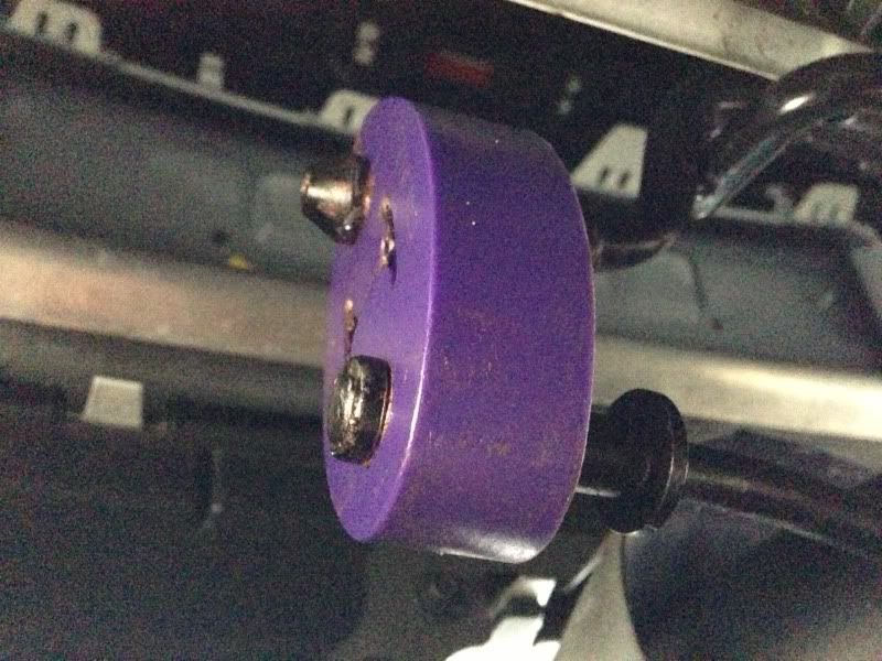

  27. Mine was a pain in the arse to get fitting right as well.
    Took it back to the garage a few times. Had to cut the centre down, and the rear section kept knocking on the metal insert in the diffuser. Used a powerflex bush on the last mount and moved it about a bit. Fits perfect now and sounds great. Only issue is that it can knock on the chassis over big bumps.
  28. Think mine needs to get looked at. Its not knocking at the moment but like yours it is ocasionally rattling against the heat shield that sits in the diffuser. Once i get that sorted it will be perfect!!
  29. This mount helped -
    It doesn't knock on the heat shield anymore. Which was incredibly annoying. Only knocks on big bumps now, I can live with that.
