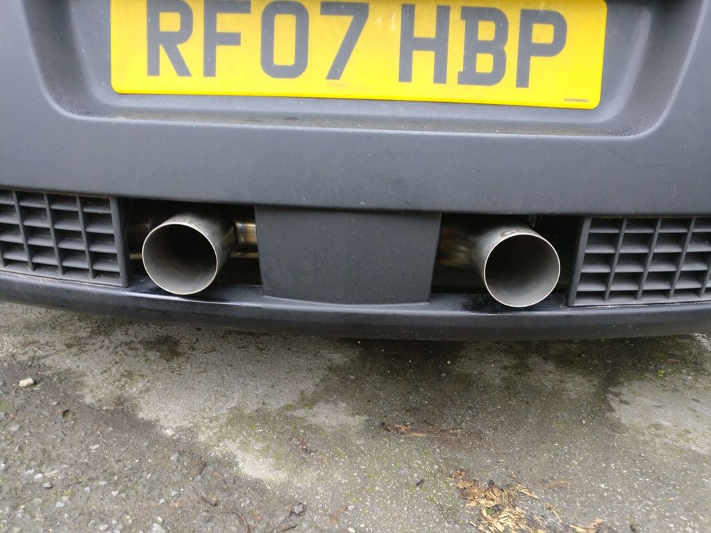

    Some photos from when I picked her up:

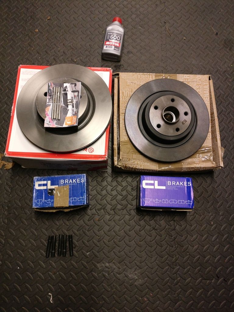

  6. New brake parts ready to be installed:
    Brembo High Carbon solid front discs
    OEM solid rear discs
    Carbon Lorraine RC5+ pads all round
    Motul RBF600 Brake Fluid
    MrPink's front caliper pins
    KTec Stud Conversion Kit
    Braided lines are already fitted.

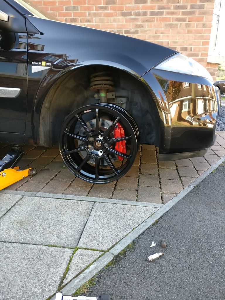

  9. So, I've got my CL RC5+ pads fitted all round, and Brembo HC discs fitted at the front. Had to give up on rear discs for now - the two bolts holding the caliper guides in place seem to have been tightened by a man with ungodly strength -
    after 2 evenings of extreme frustration I've decided to leave it for a day when the car is up in the air on a lift - hopefully then I'll be able to get at them with a breaker bar.
    I used this guide for the fronts:
    http://www.meganesport.net/discandpad.htm
    and this guide for the rears:
    http://rsmegane.com/threads/how-to-guide-r26-rear-pads-and-discs-change.11603/
    The front pads on the inside of the caliper had taken a right hammering at Donnington; one of them worn down to (and beyond) the backing plate - I should've been keeping a closer eye on them, lesson learnt!
    Fronts looking much better now:

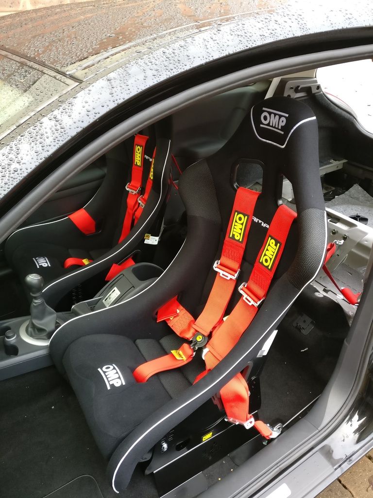

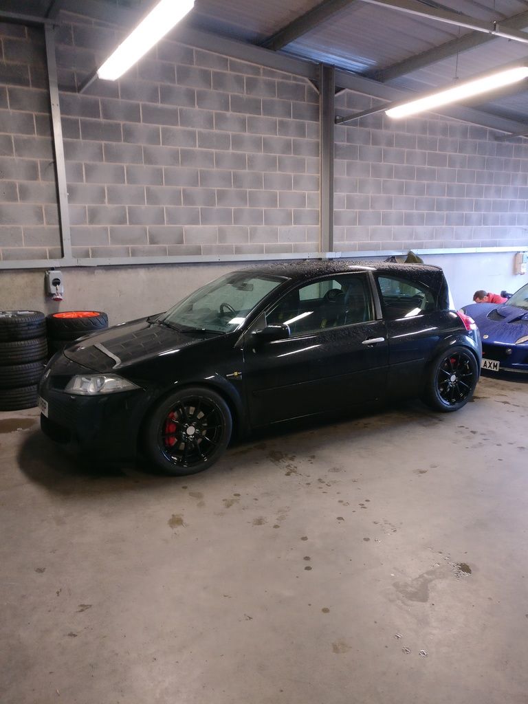

  18. I'd been looking forward to getting a bit of car time over Christmas, including the use of my brother's more skillful arms which came in very useful.
    First up was installing the OMP Champ R seats, on OMP side mounts and KTech Subframes. I also went for OMP 6 point harnesses (only use the crotch strap on track to prevent submarining under heavy breaking). These are mounted using Scrotch harness brackets and high tensile bolts all round. They're tiny, probably narrower than the Tillett B6's I had in the Caterham, so no big passengers for me (also helps keep the weight down :wink: ).
    The big installation job was BC Coilovers. I went for the DR series ones with 7kg springs all round. DR ones are digressively valved and only slightly more expensive. 7kg all round is what KAM Racing recommend for a car that's going to be used on track (normally the kit comes with softer 4kg rear springs).
    On getting them out of the box the first thing you notice is how small they are compared to the OEM stuff:
    All the BC stuff seems to come with camber adjustable front top mounts:
    I got the rears done in about an hour. The fronts were a different story. I'd decided to replace steering arms, anti rotation links and drop links while I was under the car. The nuts on the anti rotation links had 105000 miles worth of rust on them, meaning we snapped 3 T40 torx bits while trying to hold the bolt still to remove the nuts. Ultimately we drilled the old bolts out! Utter ball ache. Anyway it's done now.
    Back on the ground:
    I set the dampers on '15' hardness all round (on a scale of 1-30). With these 7kg rear springs it certainly is firm - I don't think I could drive it every day like this, but for running up and down the motorway to track days it's bearable!
    The car is booked into CGR Automotive for a full decat system, with a swappable straight pipe/sports cat front section, in February. The following day she's off to see Paul at RS Tuning for larger injectors and remap to take advantage of all the new hardware. I will also get her booked in to Wheels In Motion for a 4 wheel alignment & fast road/track setup.
    That's all for now - in the garage I still have the Forge hard pipes & oil temp\pressure gauges. I'm working on the gauge pod right now.

  23. @essIII Where did you fix the front part of the harness out of interest?
  24. I'll take a couple of pics tomorrow to show you.
  25. Nice one thanks.

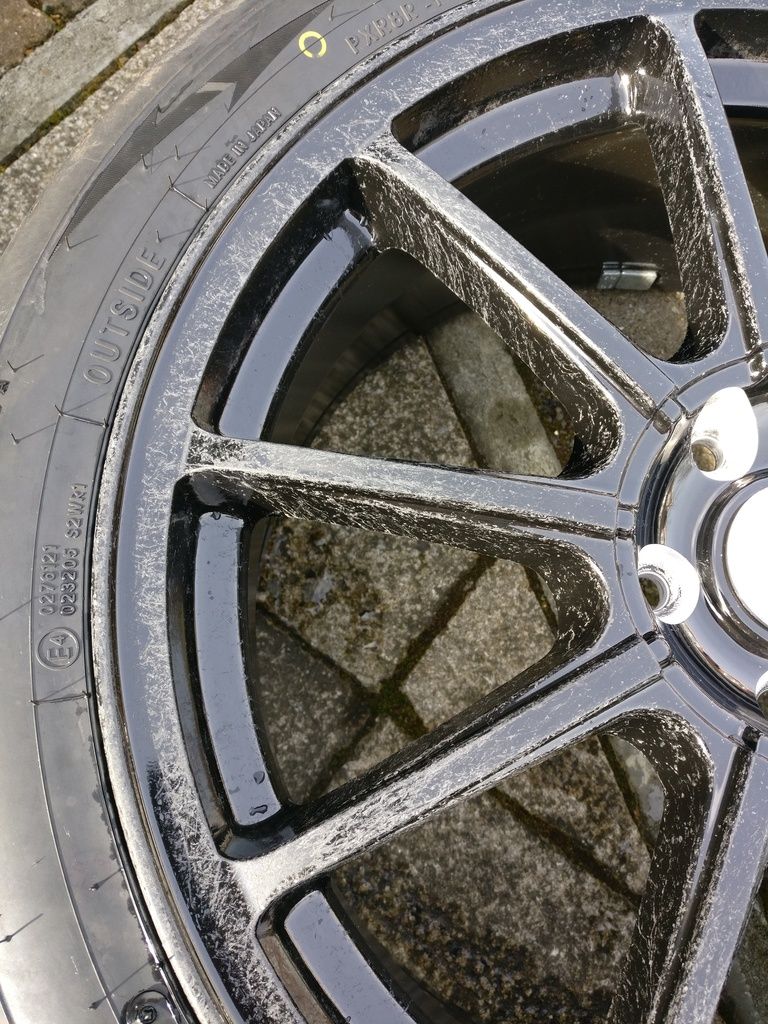

  26. Been ages since I updated this (and I realise I left Audio Addict hanging waiting for pics - my bad!).
    At the end of January I took the Meg to Donington for my 2nd track day in her - the first one had also been at Donny. Since then I'd fitted new Brembo front discs, Carbon Lorraine pads all round, new brake fluid, larger intercooler, DIY ITG Intake, BC Coilovers, bucket seats, harnesses and had some R888R tyres mounted to my track wheels. Needless to say I was excited to see how differently she performed.
    Mother nature had different plans - the track days started 2 hours late initially due to ice, then fog. It remained a cold and wet day once the track had opened, so not really an opportunity to test the changes to the car at all. Towards the end of the afternoon I made the schoolboy error of saying "right, I'm coming in this lap" only to change my mind at the last minute due to getting a bit of clear track ahead. Cue me lifting off in the middle of the craner curves, travelling sideways across the grass before ending up buried in the gravel trap on the outside of the circuit. Spent a good hour removing gravel from wherever I could find it (including some wedge between the wheel rim and the bead of the tyre), then trundled home with a glum expression on my face!
    Having cleaned up the car and wheels, here's the 'finish' that the gravel trap left on the two wheels that took the brunt of the gravel:

  27. Sounds like you've had a nightmare with it, those wheels look a mess. Hope you get everything sorted without too much pain [emoji1303]

  32. Cheers pal, they're certainly not pretty. Means that getting them refurbed in red might happen sooner rather than later!
