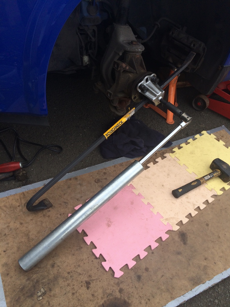

  7. Yeah I can split the shaft out easy enough. Well the first time it was a pita but I've a bolt on press which did the trick with an extended breaker bar.
    It's removing the actual hub and then bearing afterwards I'm interested in.
