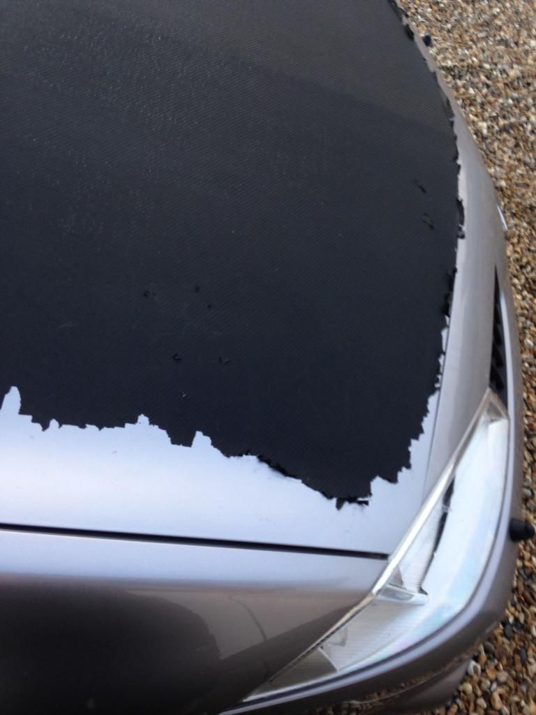

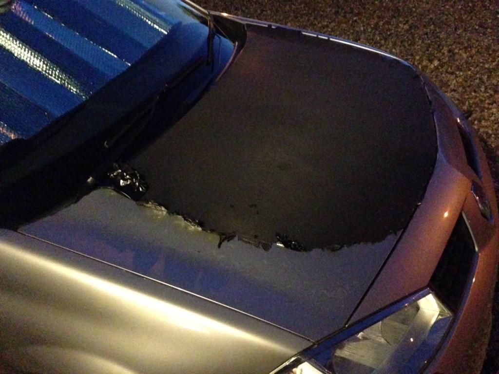

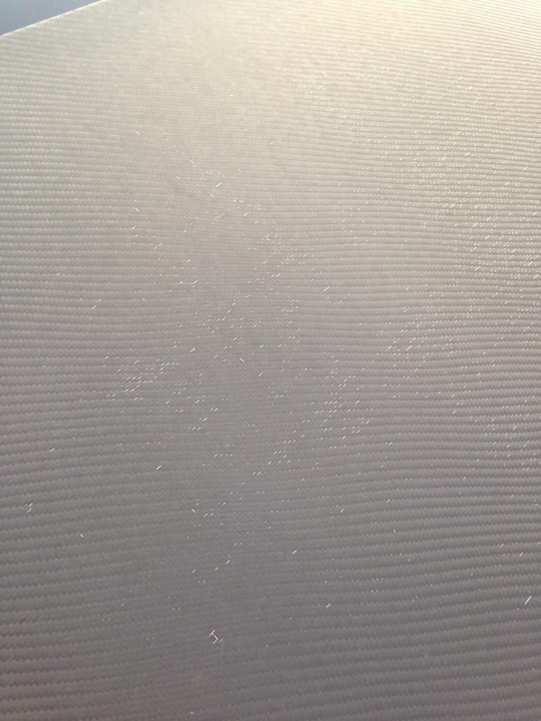

  4. Aaaarrghhhh this is doing my head in. This is the state of the vinyl wrap prior to removal, the white marks are where the vinyl has started to split and break apart.
    So I've made a start on it with a hairdyer and peeling off slowly.........apart from it's impossibly slow. This is the result of the vinyl breaking into tiny pieces constantly. If you don't apply enough heat, the wrap snaps and you have to find an edge again. If you apply too much heat the wrap stretches too much as you peel it and it snaps again.
    This took me 90 minutes to get this far so I gave up last night to carry on this evening......
    Does anyone have any other tips for this? The vinyl has clearly perished (5 years old) and is proving to be a total pig.
    Sadly I think it's just going to be time consuming and there's no quick way round this but help!!!!! lol

    You need the right amount of heat mate, too little will result in it breaking of in tiny bits too much and you will melt it in small strips. Heat gun is much better suited to a hair dryer. Steamer is best but stick with the heat gun.

  9. Well the heat gun has certainly helped, as I hoped it managed to warm the panel enough to retain heat in the wrap to peel it off.
    I managed to remove about a quarter of the wrap last night. Got a friend coming round tonight who said he'd help so hopefully we'll get the rest done.

  11. Thanks mate. I spent another hour outside with a mate last night. He's removed wraps before but never seen one go like this.
    Basically when you heat parts of it, the wrap comes apart and comes off in tiny pieces!

    I spent another hour going at the vinyl last night, noticing that on the few stone chips it had the paint/lacquer was lifting from what I assume was the heat (although not overly hot!) and the glue coming off. Trouble was the vinyl was lifting off the glue and 90%+ of the glue was remaining on the bonnet. Another job which would have taken me hours to finish.
    Anyway, a friend of mine came over who does smart repairs, I've seen his work and he's really good. Owns a VW show car himself so I know he's not all gung-ho with bodywork like some sprayers might be.
    He suggested trying a Caramel Wheel, which I'd never heard of but turns out to be a rubber wheel that's effectively softer than lacquer and used to remove decals etc. Well my bonnet didn't like this one bit, as it removed the vinyl it also removed the lacquer more significantly than the stone chips...........so that'll be a respray then.
    Gutted but to be honest I was at a loss at that point and had nothing too lose as I was already at the point where I was close to calling my usual bodyshop.
    Lessons learned? One, don't ever use textured carbon wrap and if you do don't leave it on the car 5 years and 2, don't use a Caramel Wheel to try and remove it if you have.
