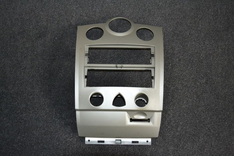

  1. As above, after the large panel that houses the radio and wraps around the climate control panel from a Megane 2

    like this?
  4. Yes that style! For sale?
