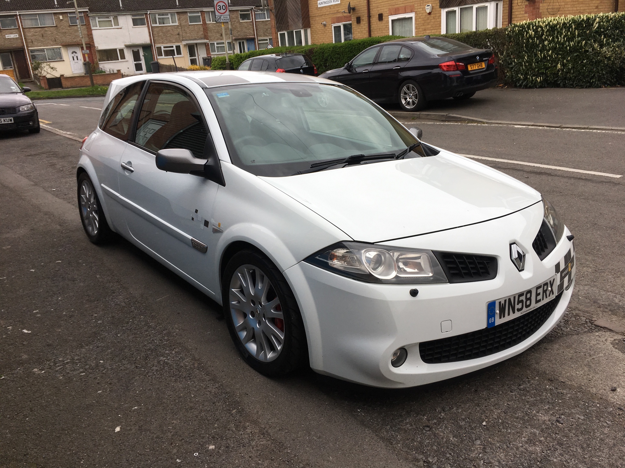

  4. [​IMG]
    That's my setup. Laguna 17 alloys with some ns2-r tyres.
