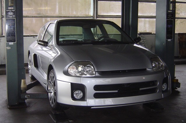

  1. a familiar picture. start:

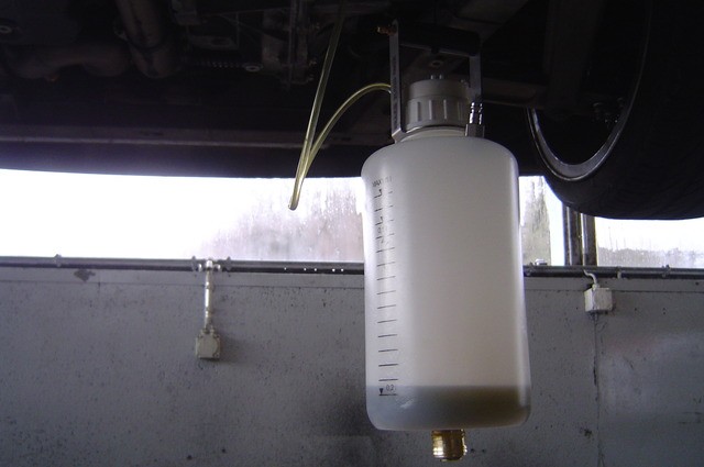

    bleed:
  5. bleed:
    finished:
