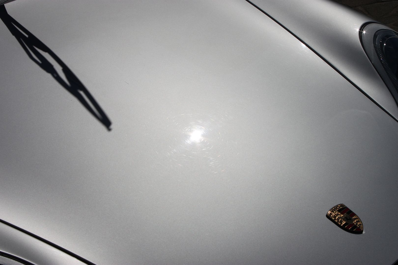

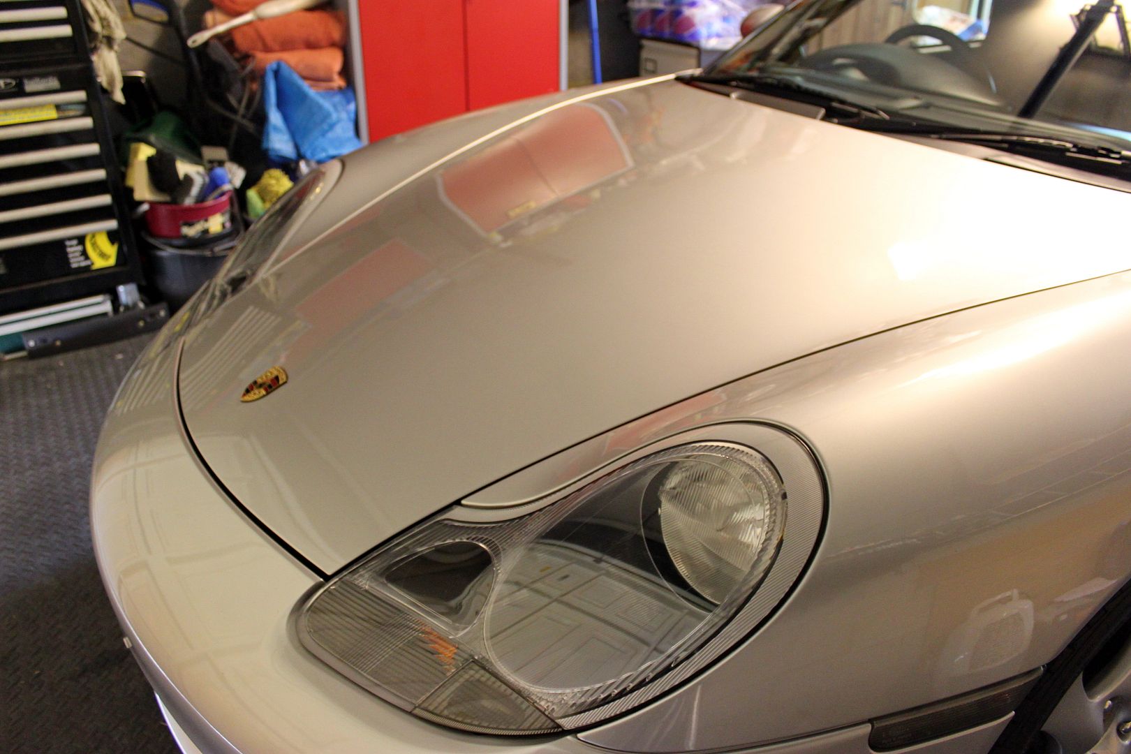

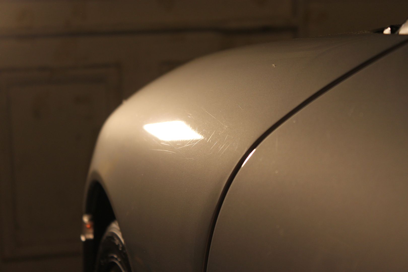

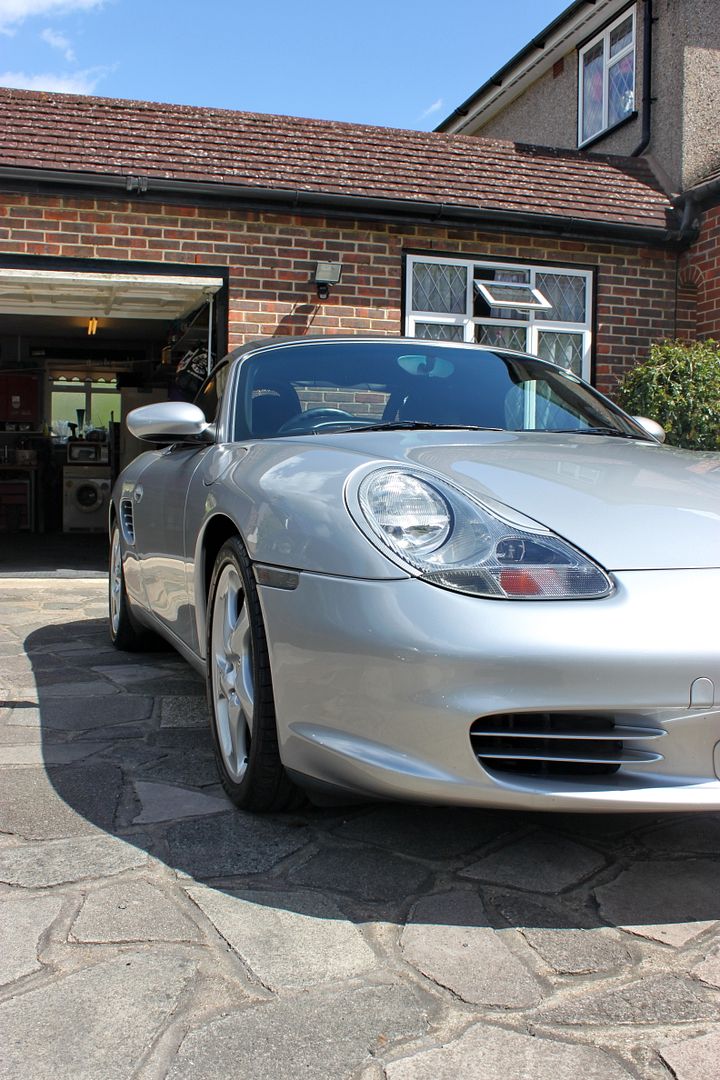

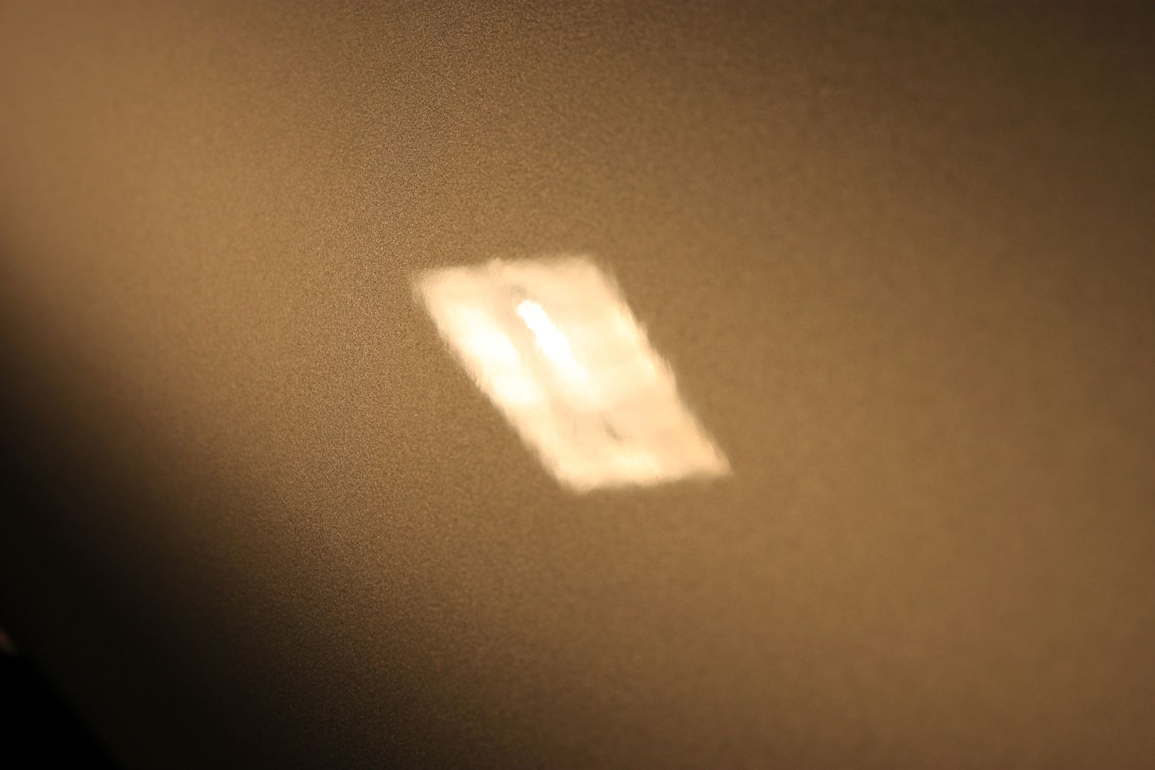

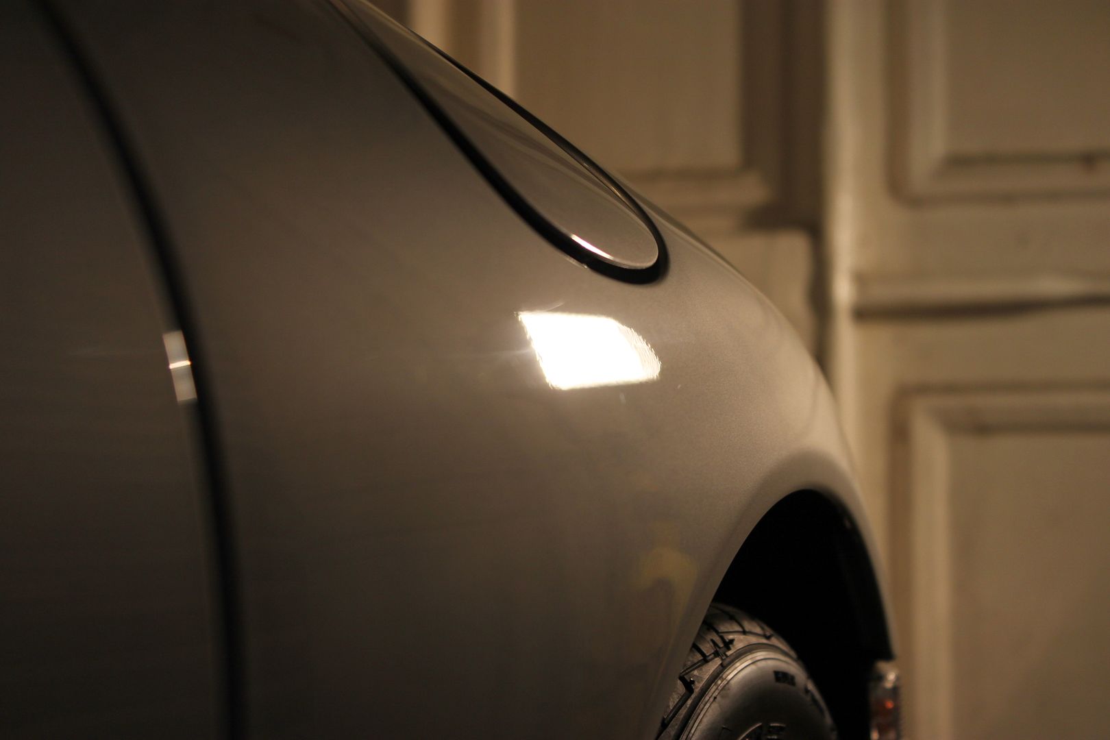

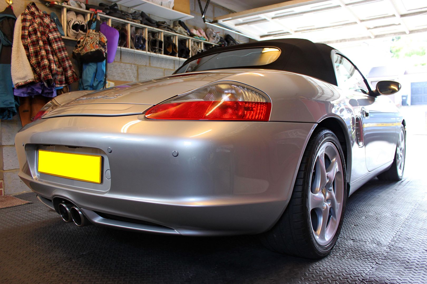

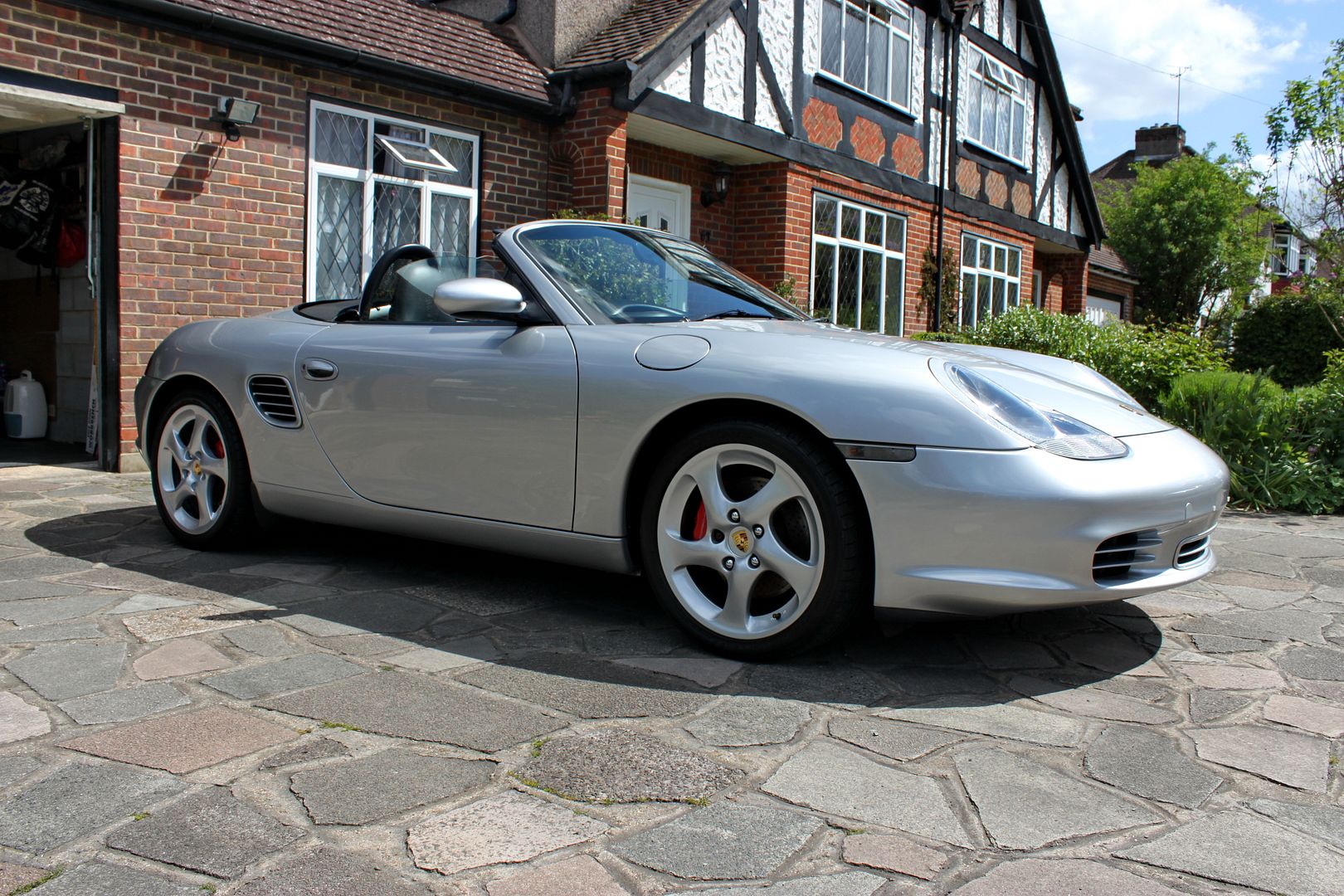

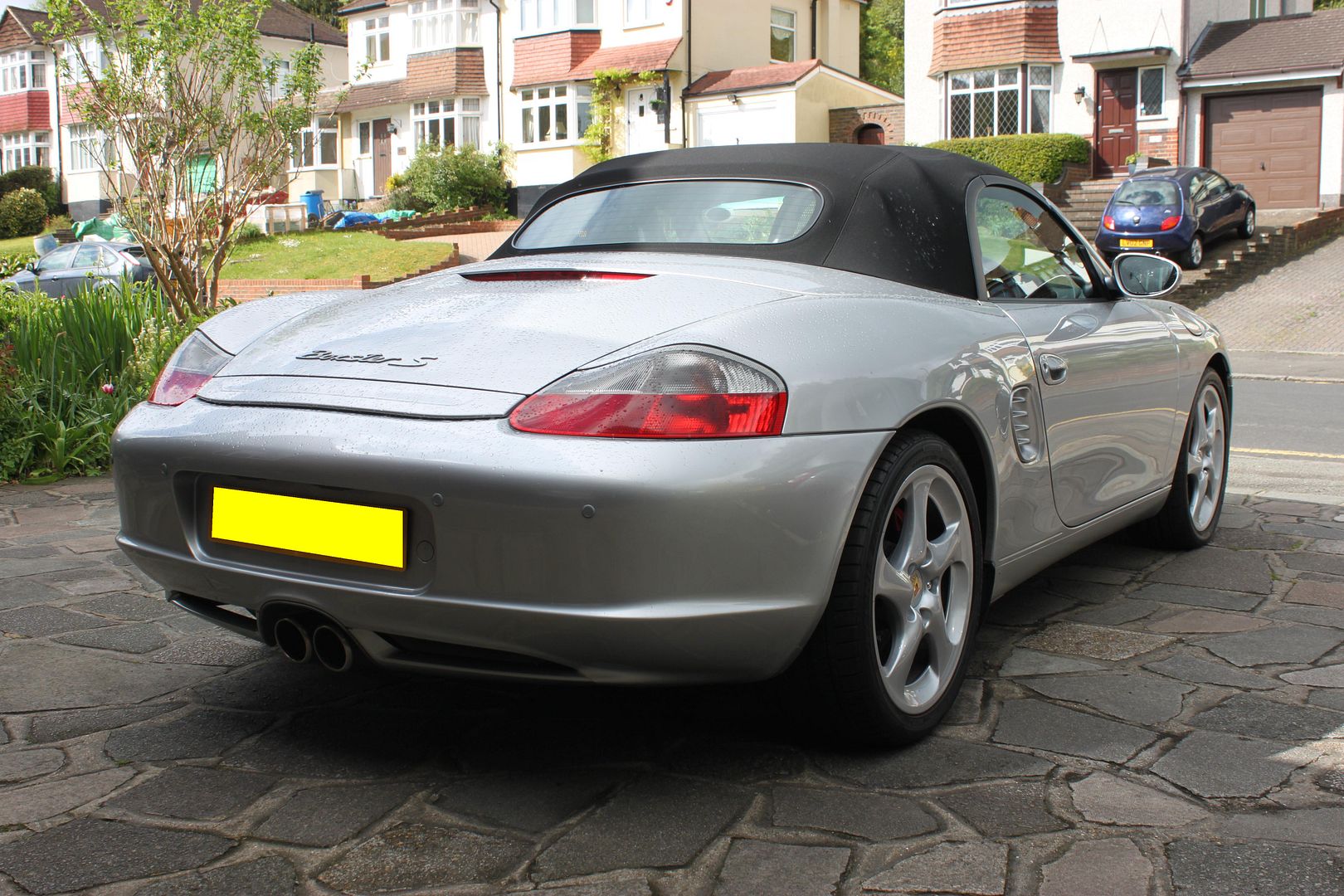

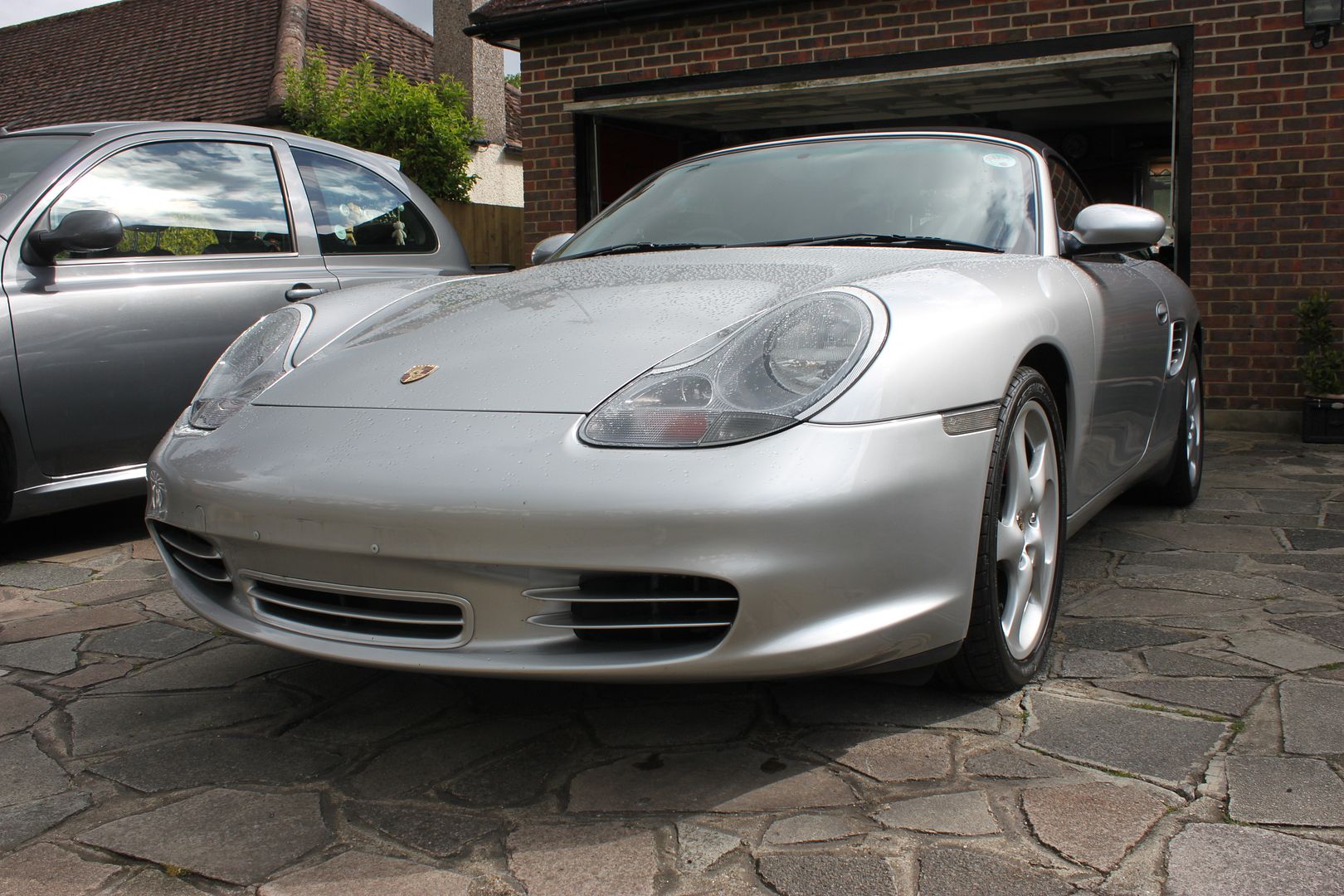

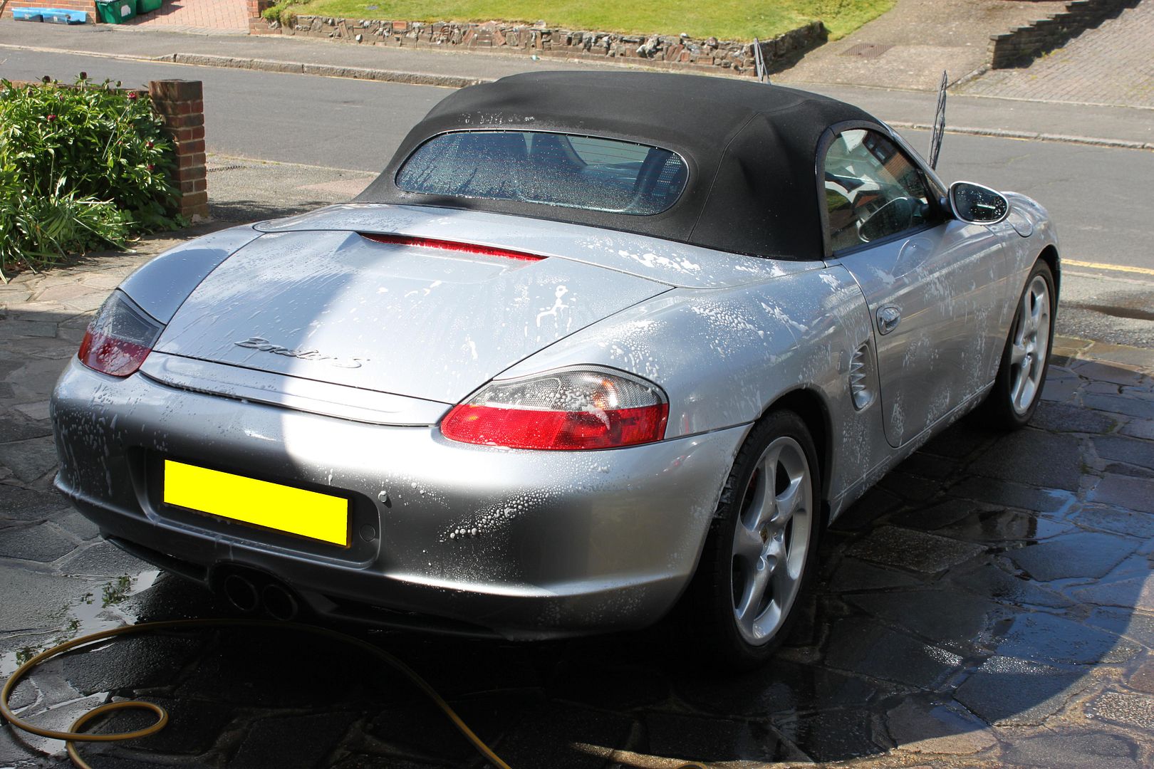

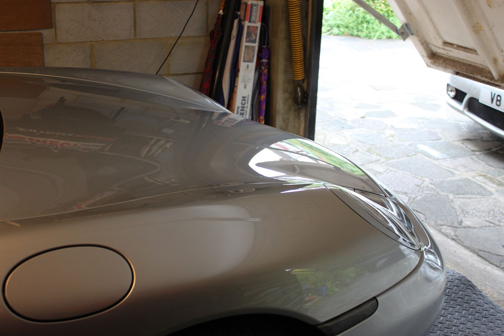

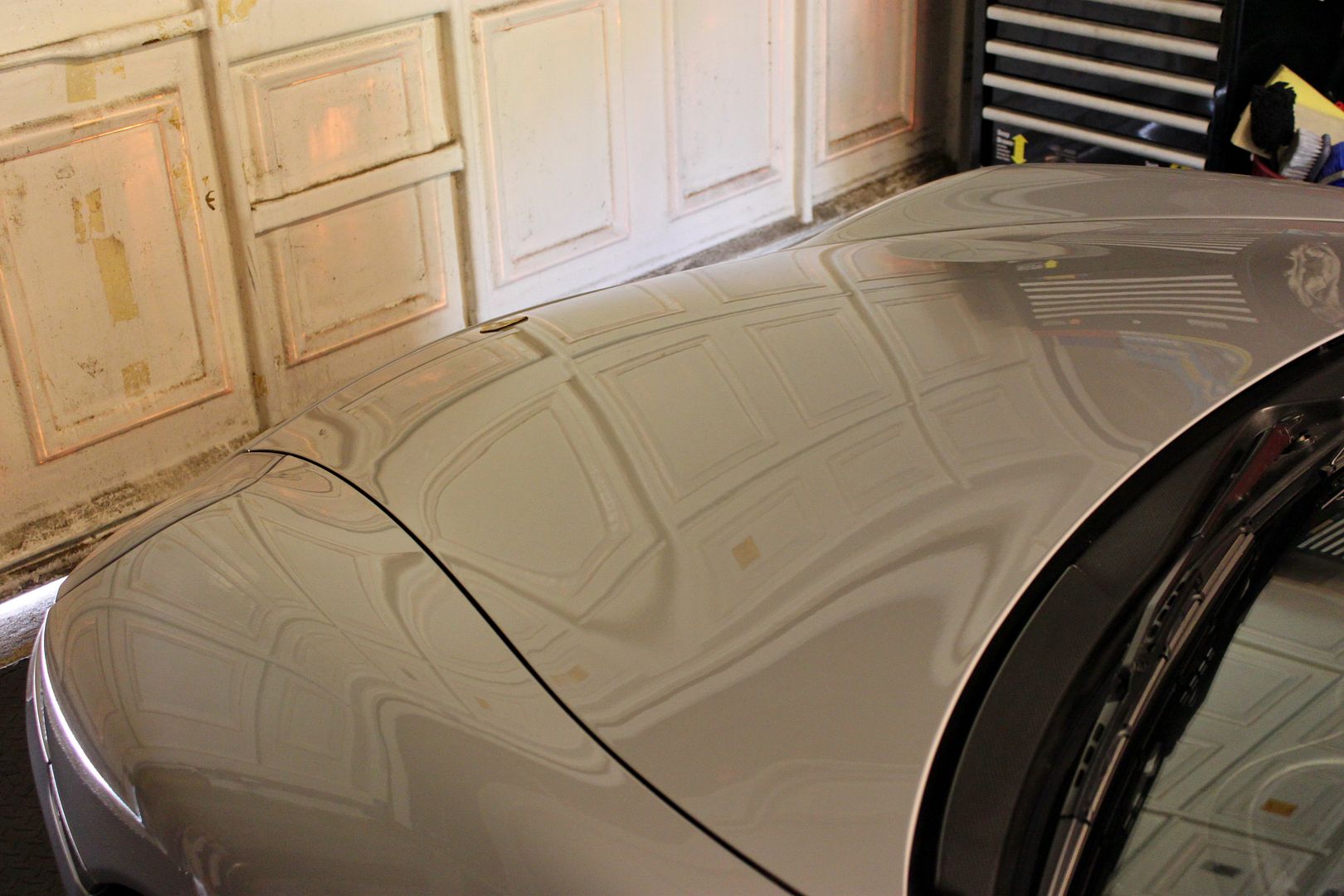

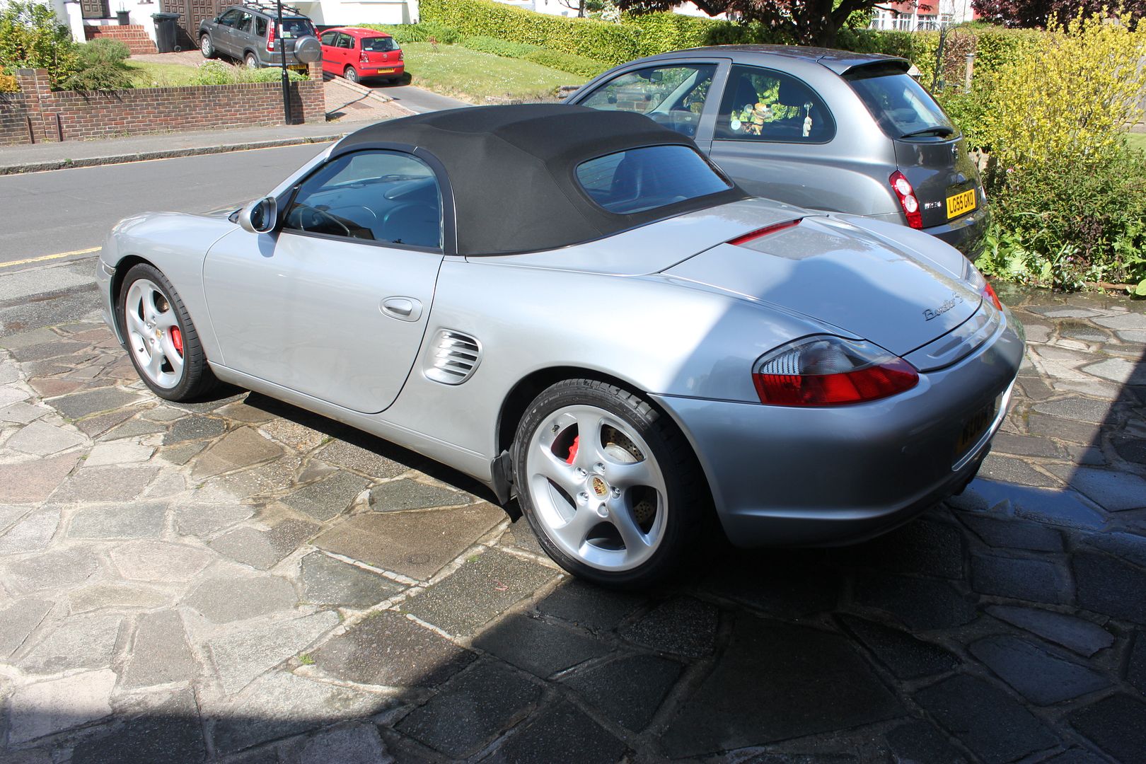

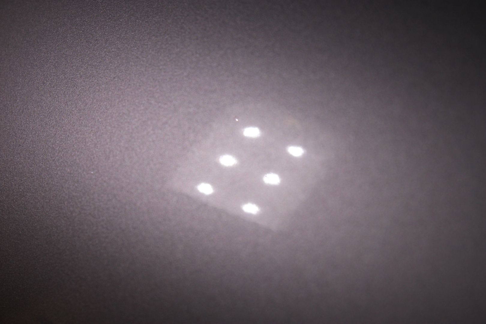

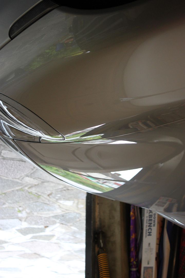

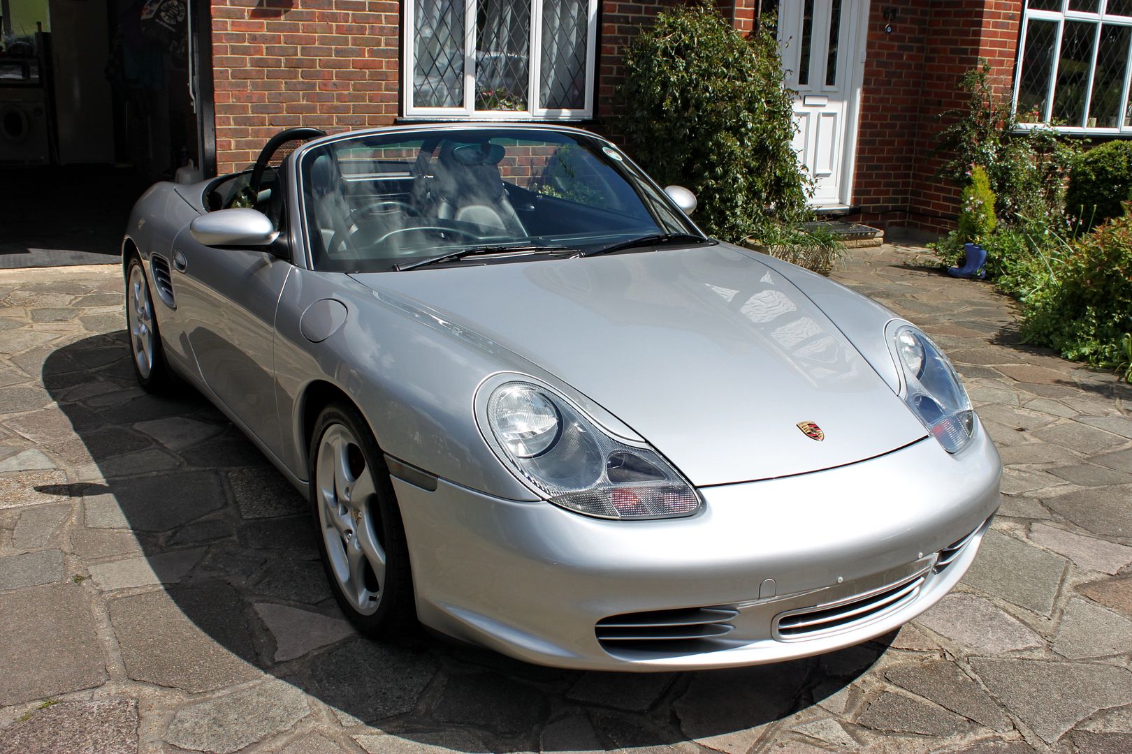

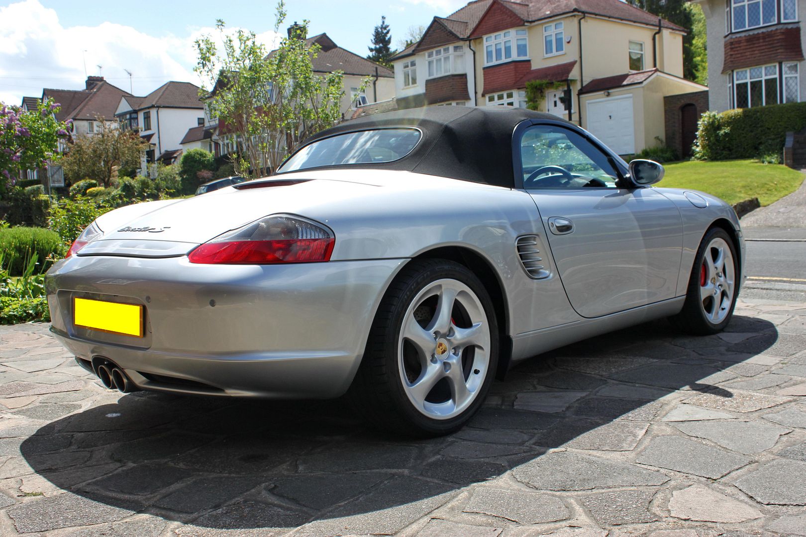

Here is a detail I carried out on a Porsche Boxster s. So upon arrival: Onto the wash stage, wheels were cleaned with various brushes and britemax iron max. Whilst doing the wheels the body was sprayed with a citrus pre wash to remove any loose debri which could mark during the wash stage: Then rinsed off and washed with the two bucket method: Bodywork was then coated with iron max: Car was then sprayed with tar remover, rinsed off again, clayed then re rinsed and dried off, I could start to see the condition of the paintwork: After it's wash:

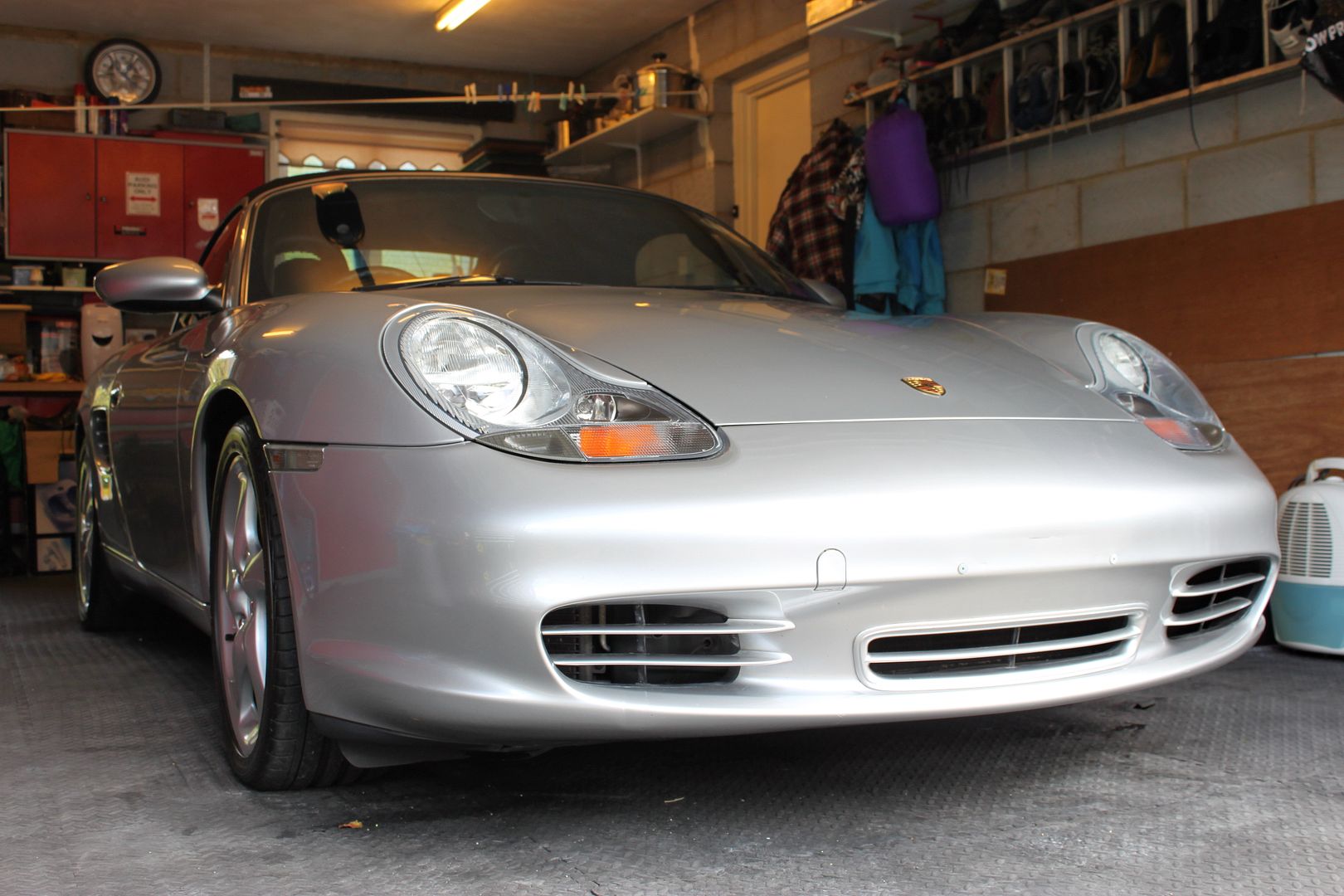

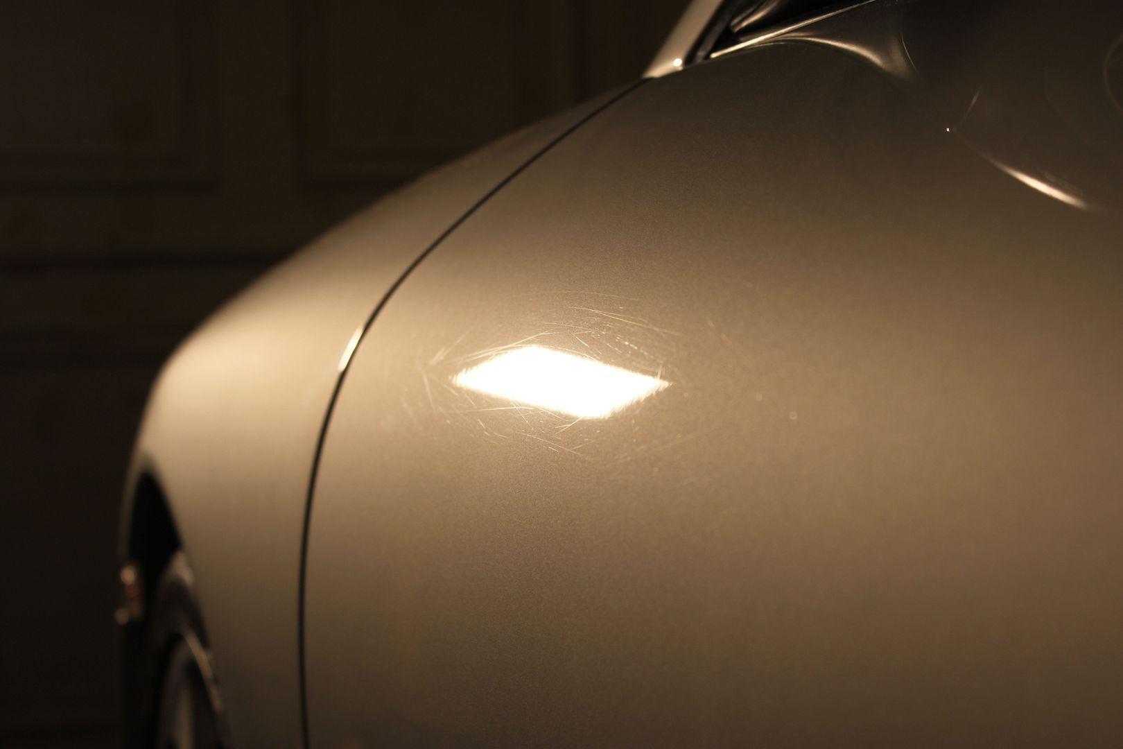

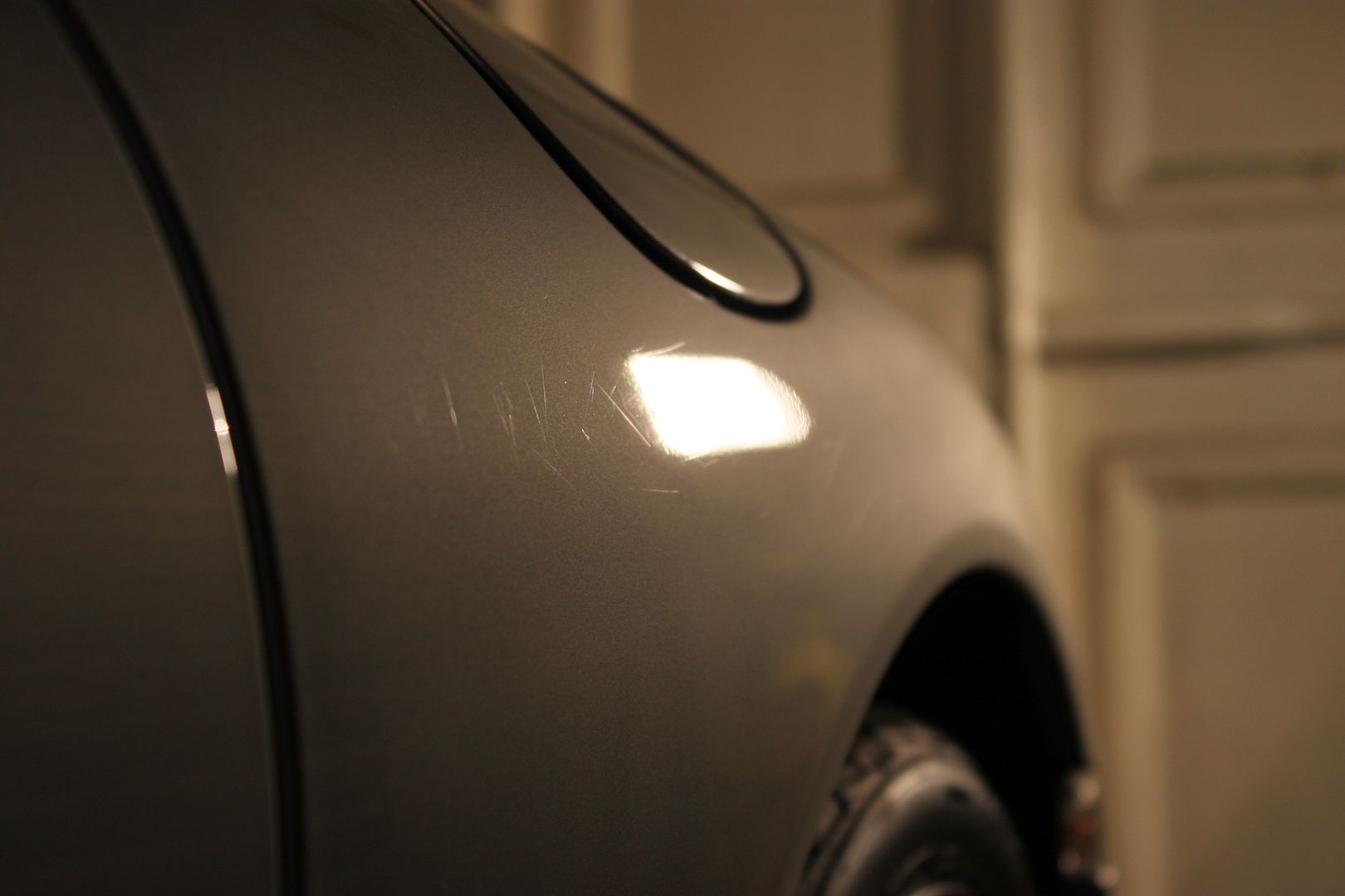

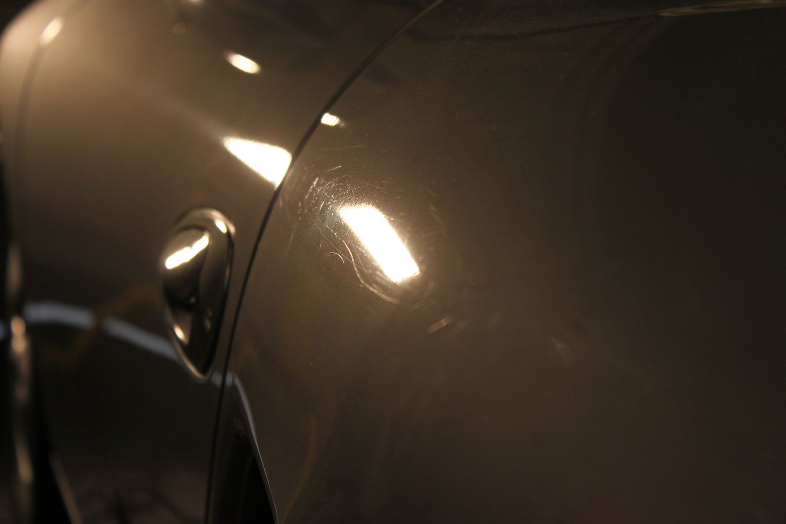

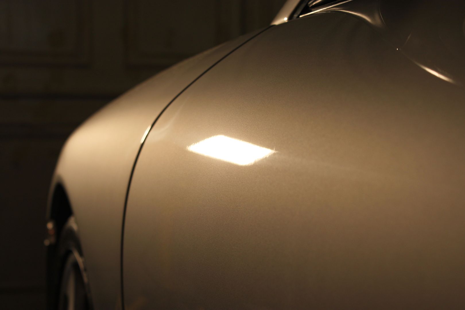

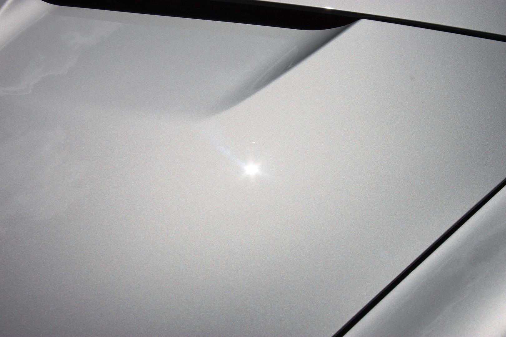

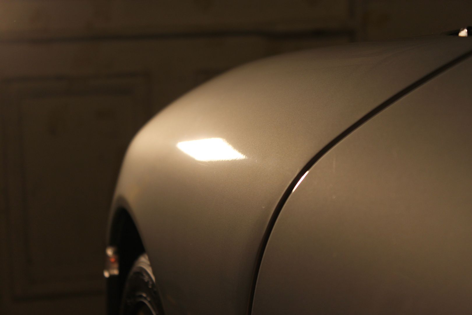

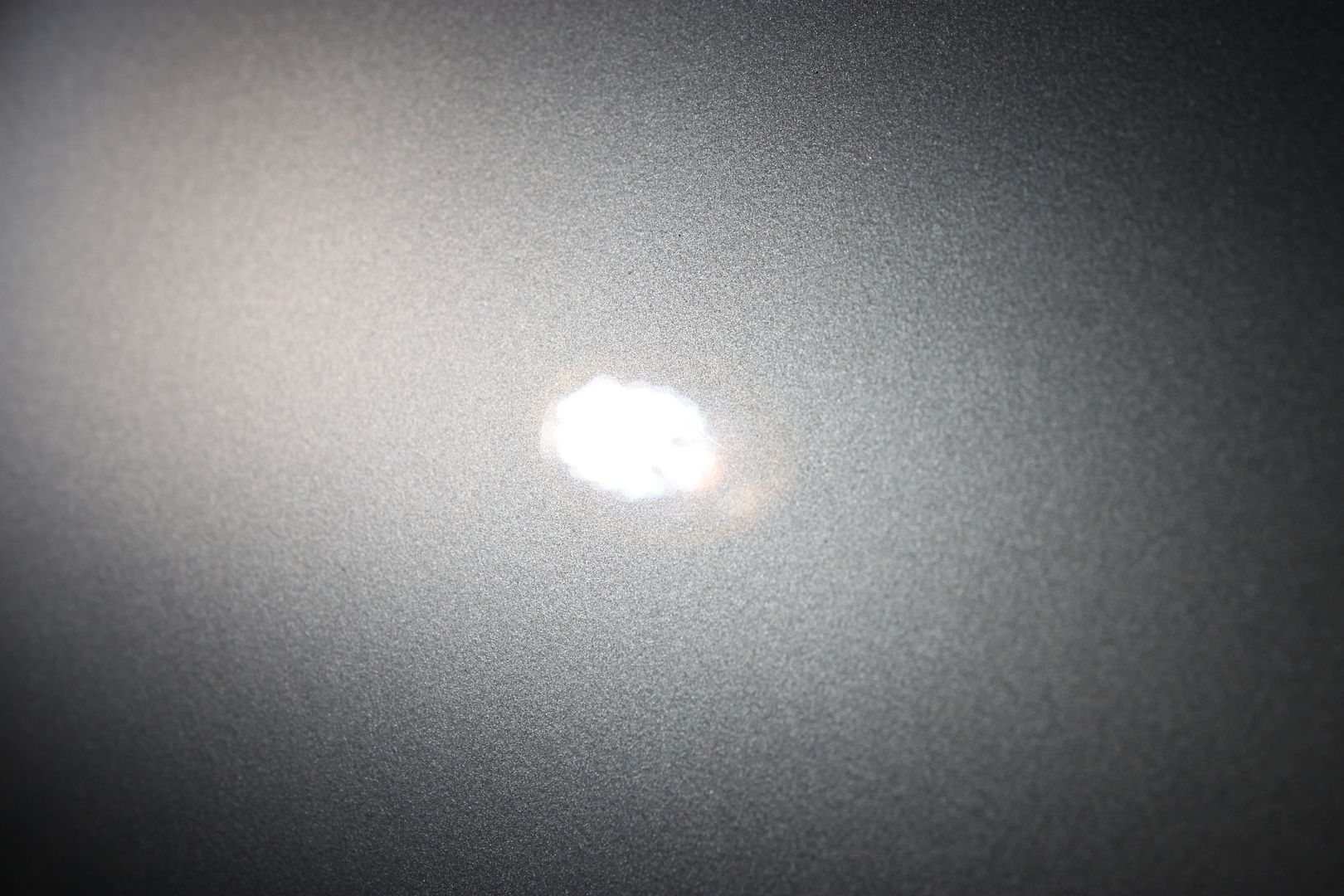

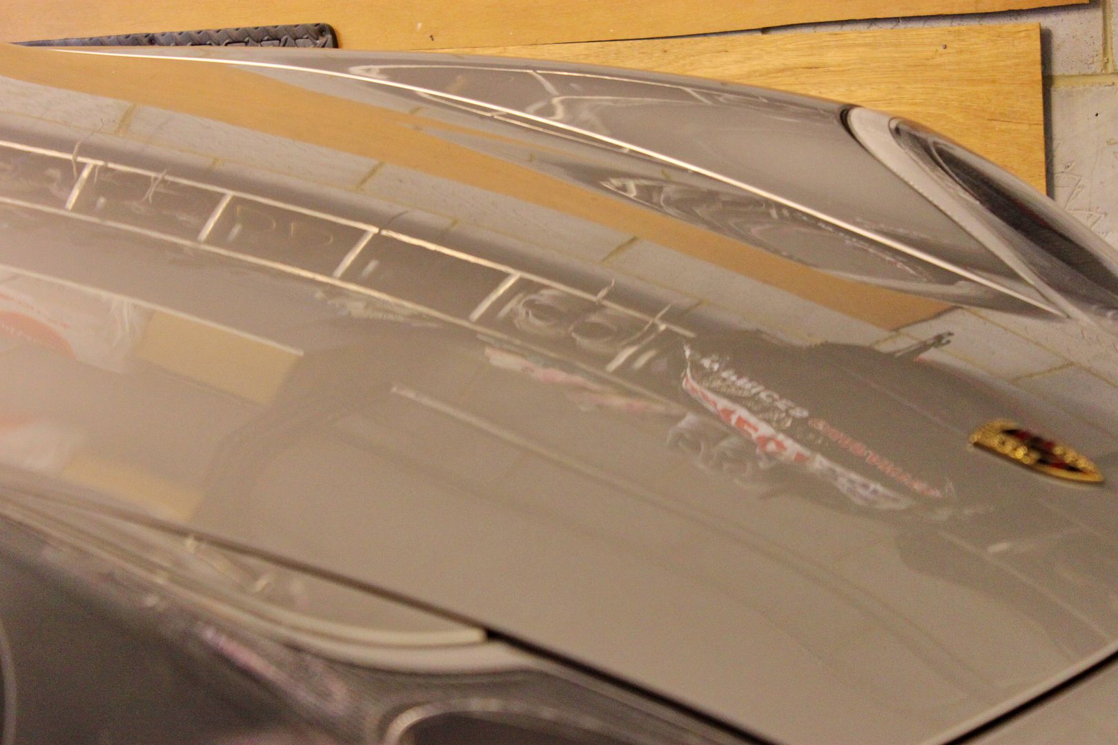

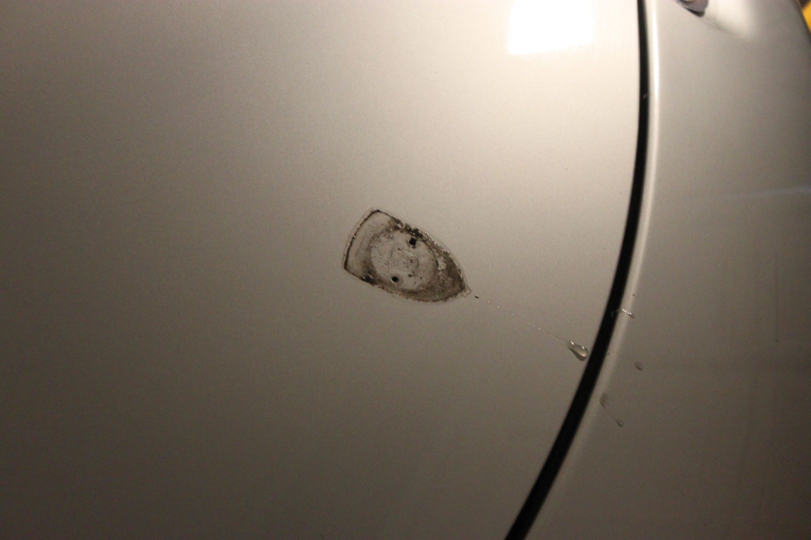

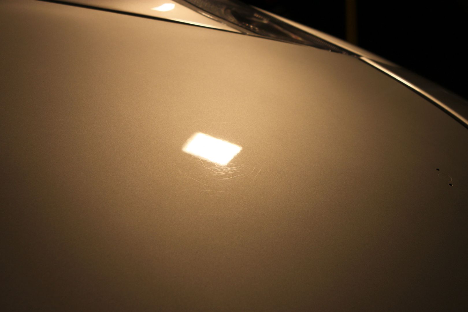

Then rolled into the garage,front badge removed and paint depth reading's taken: Then onto the the first stage of correction: After this stage the car was rolled back out and re washed to remove the dust from the first stage: Teh after the other two stages all the polishing was done:

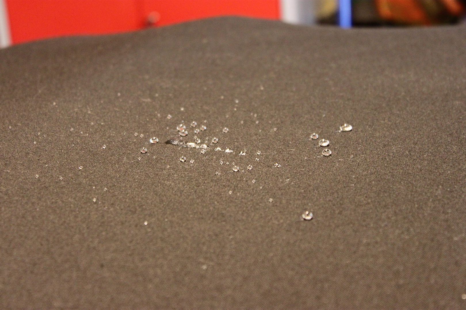

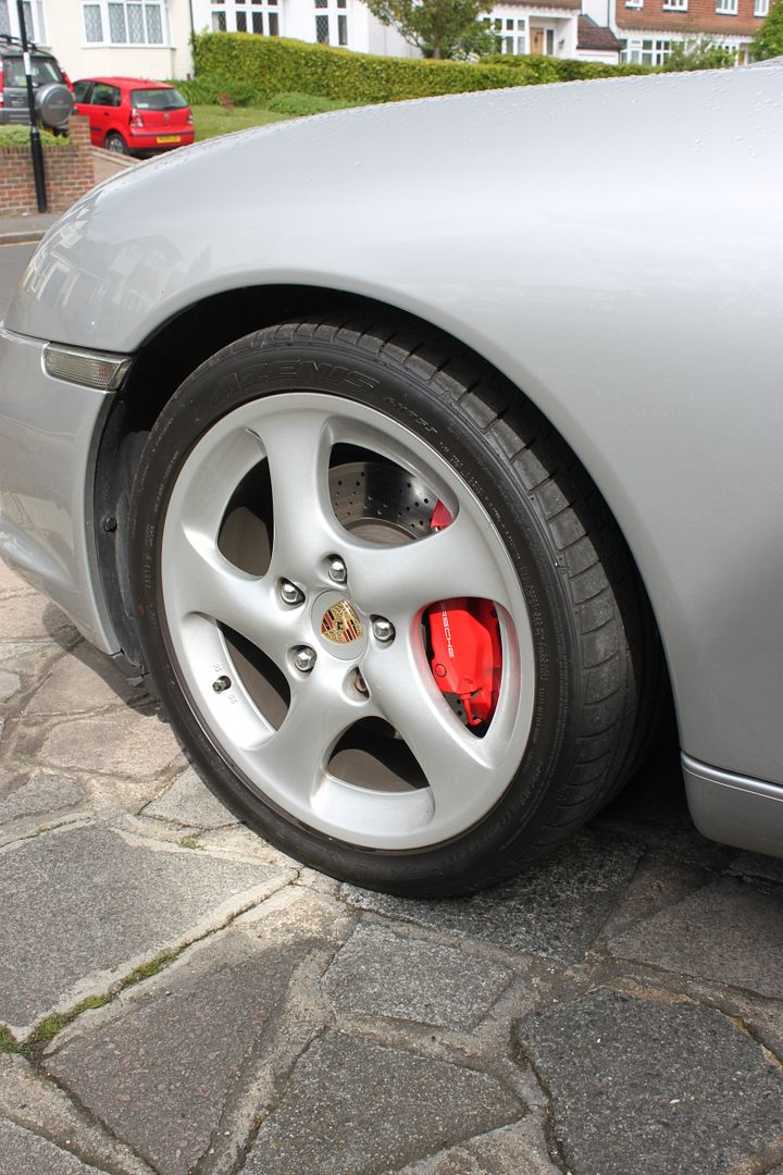

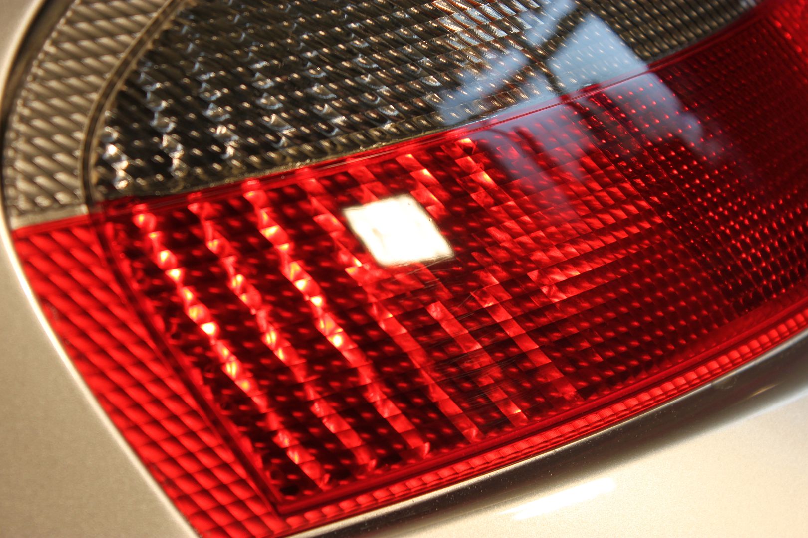

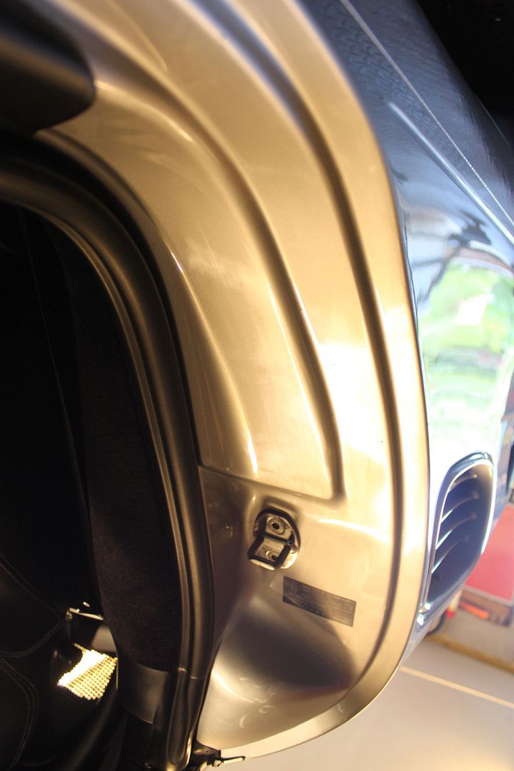

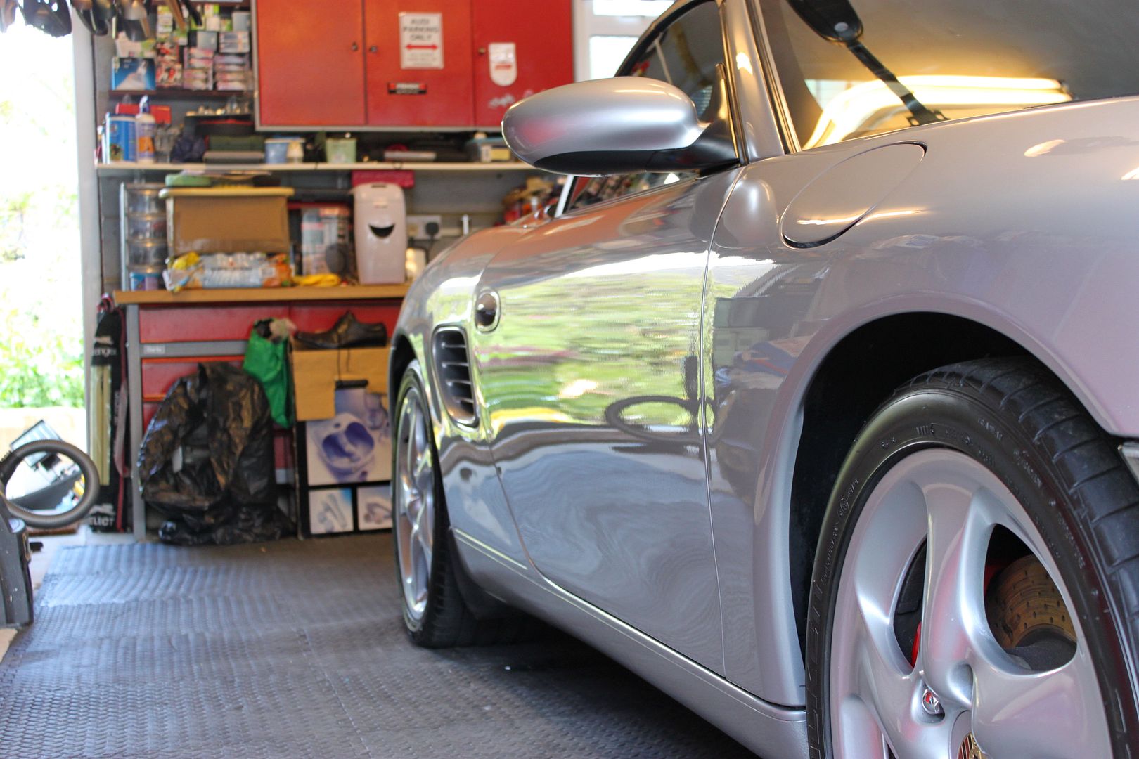

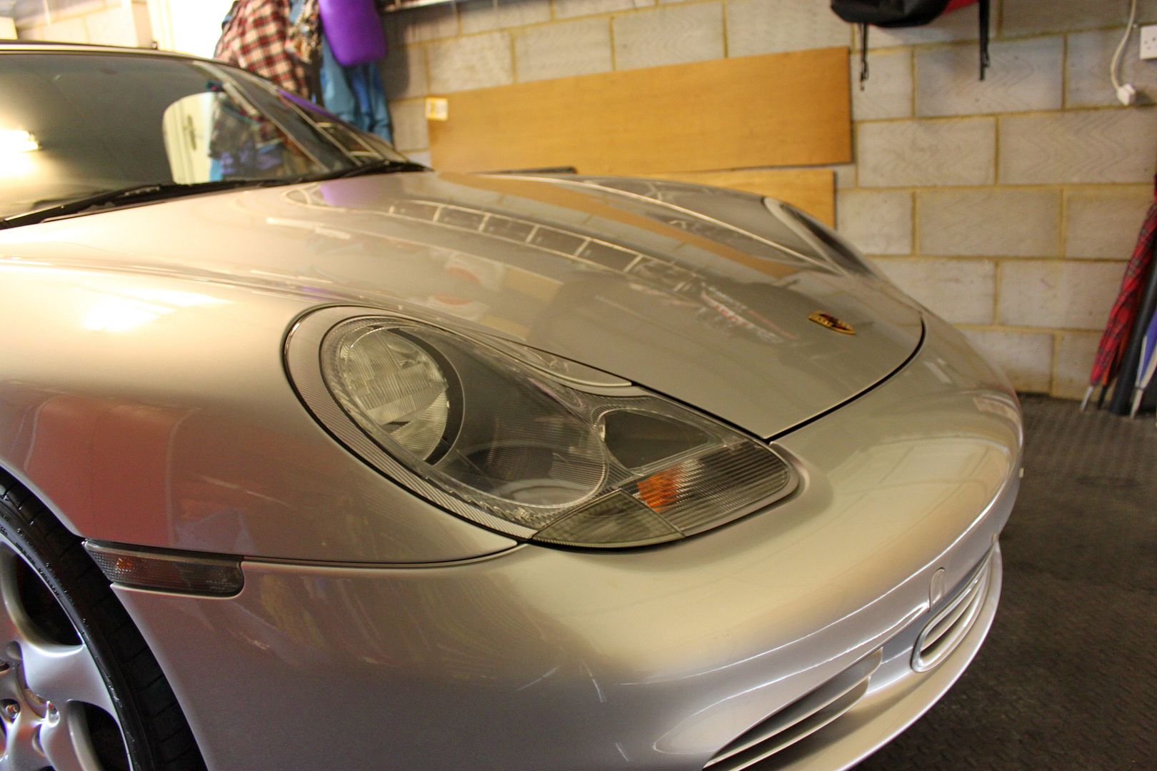

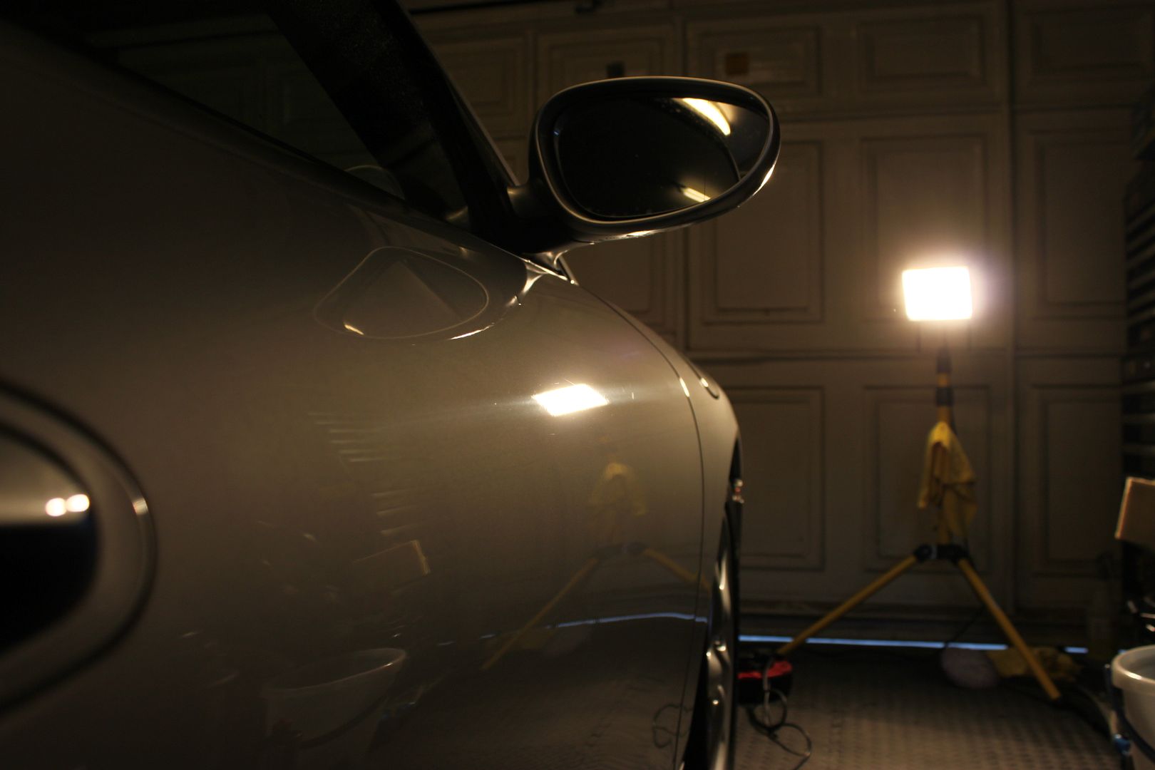

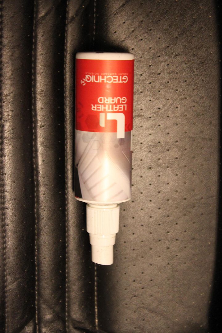

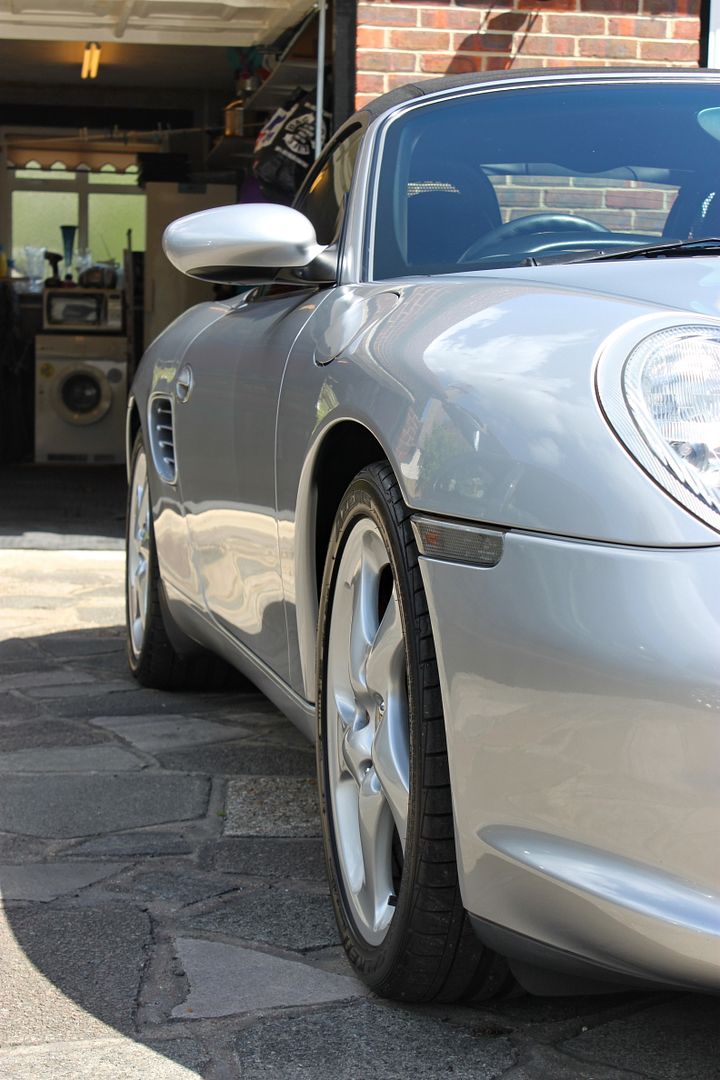

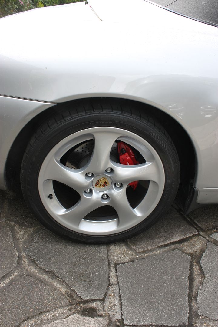

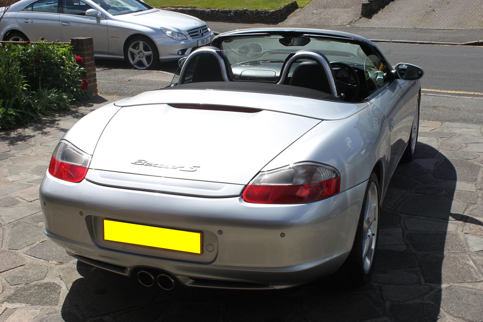

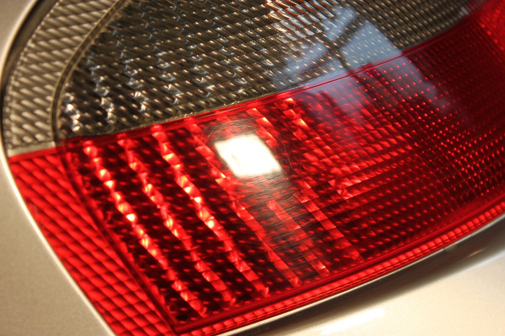

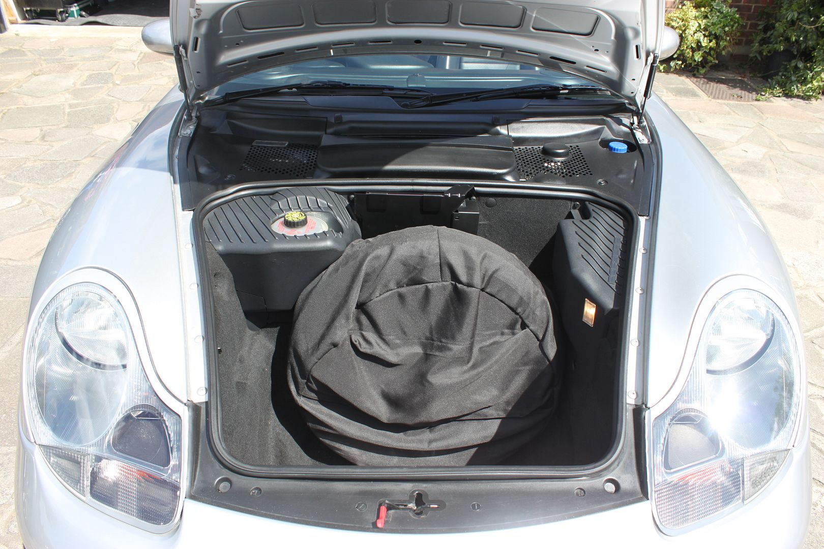

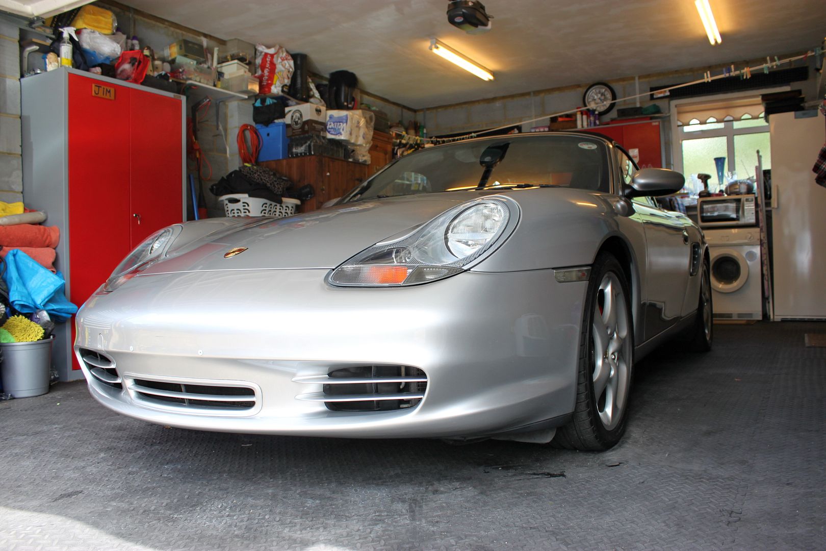

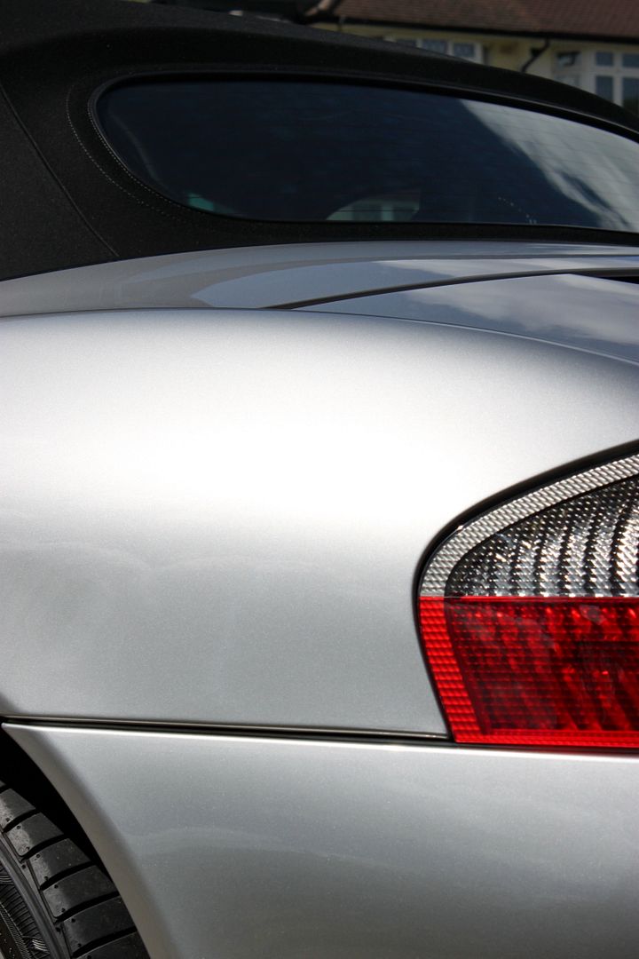

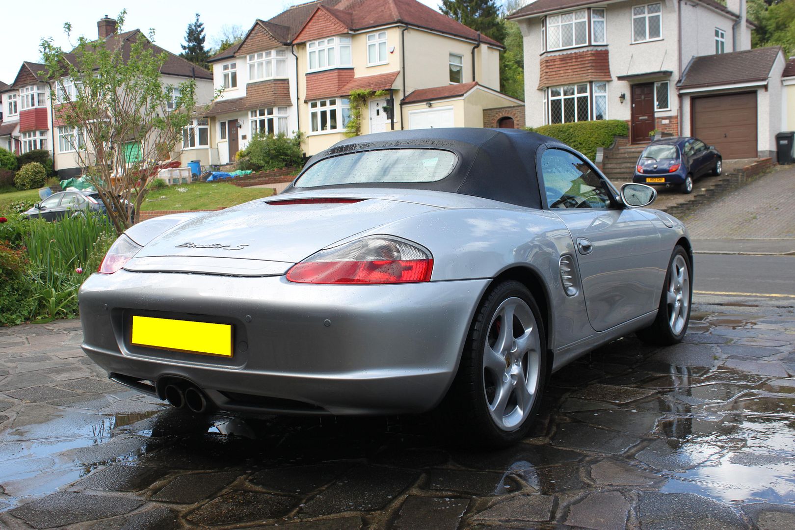

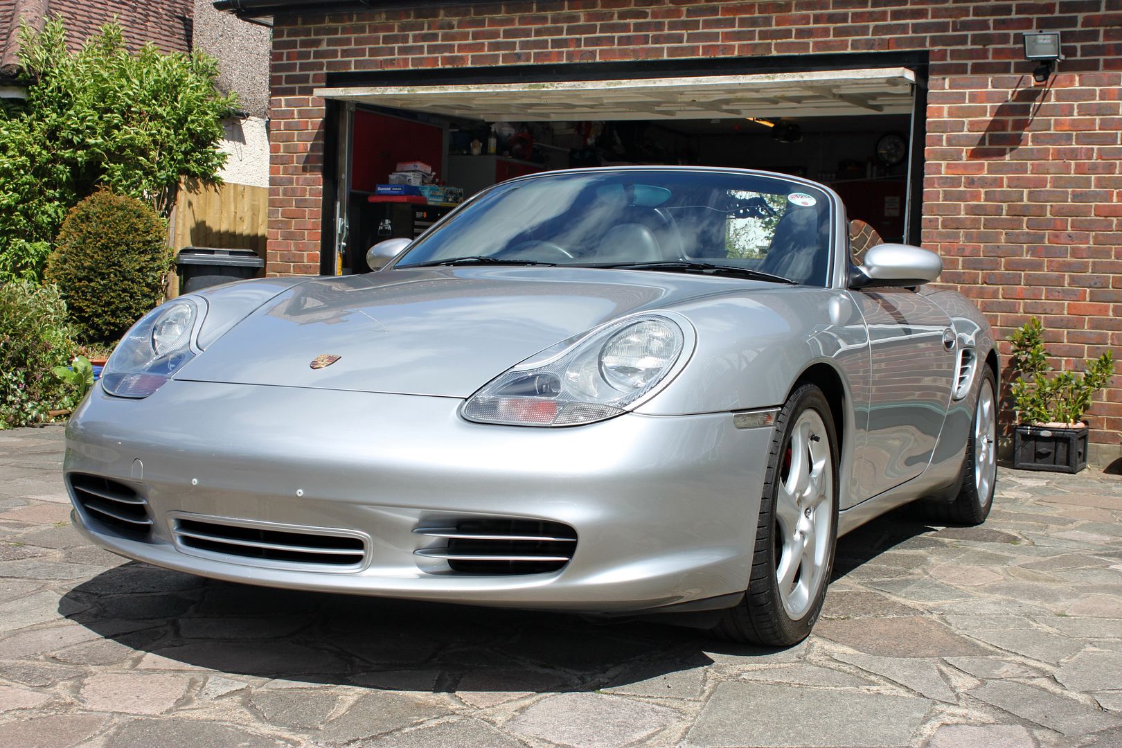

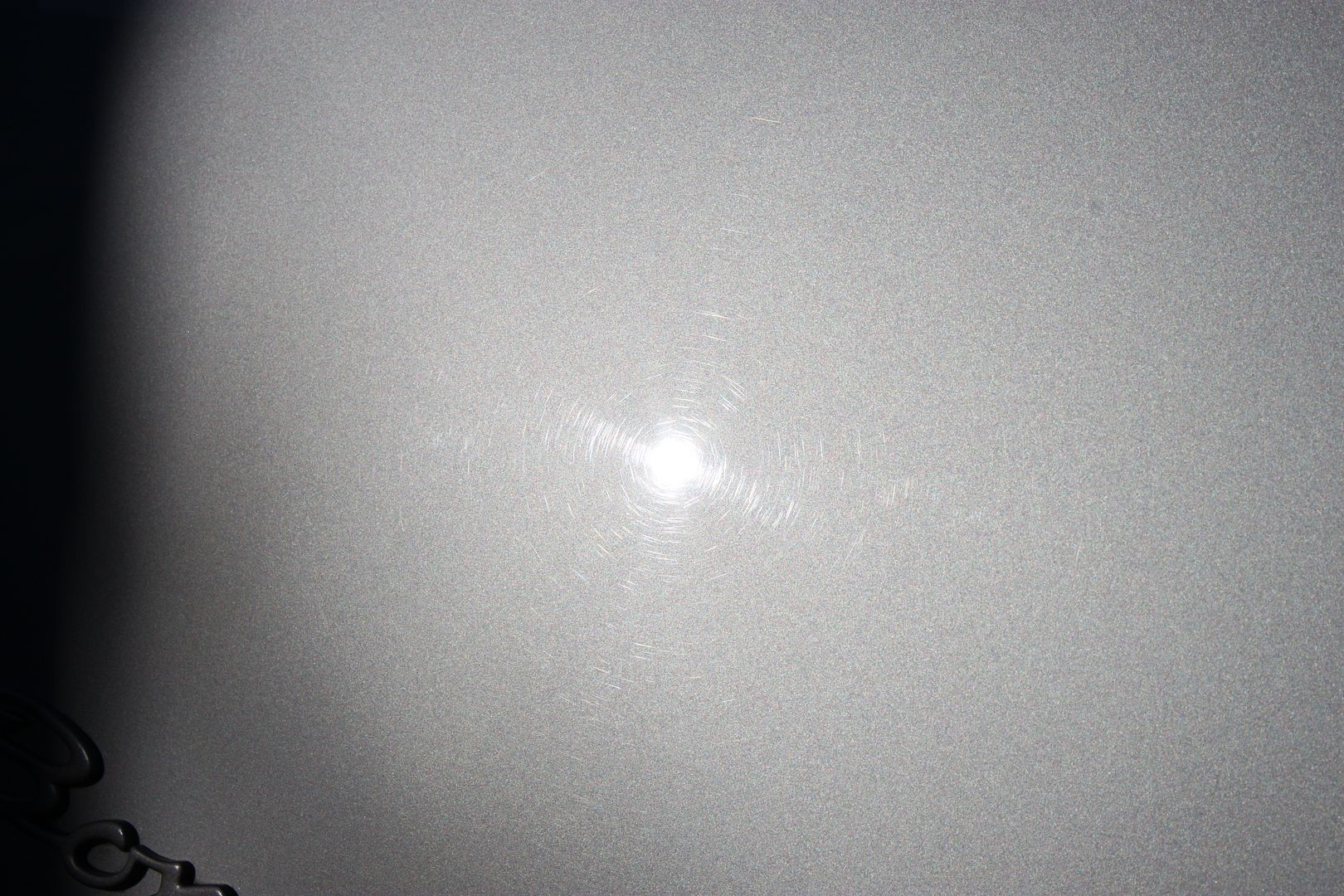

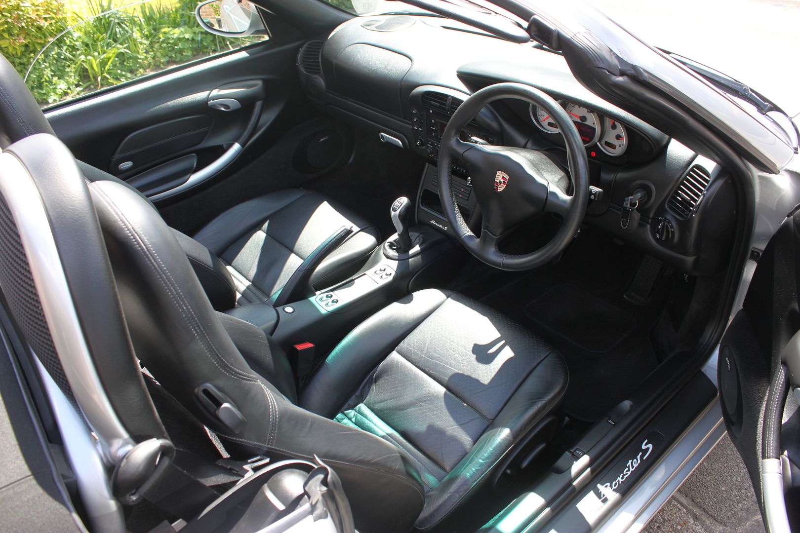

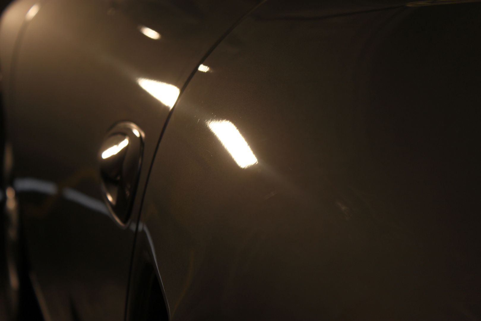

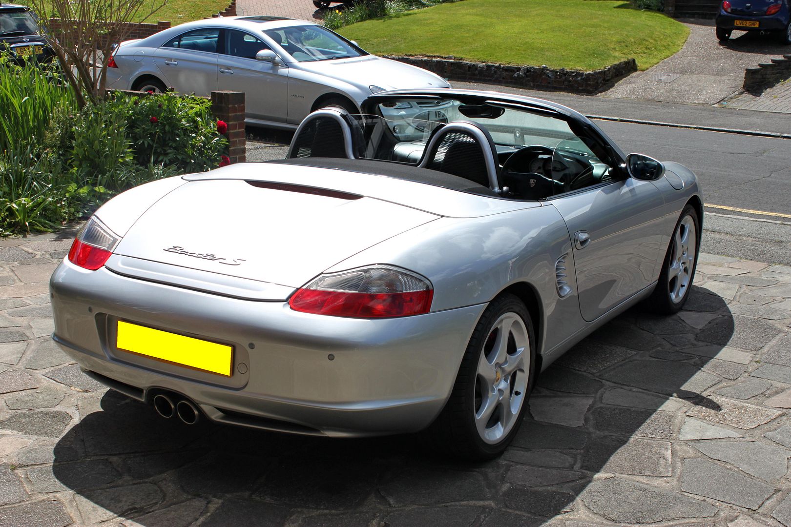

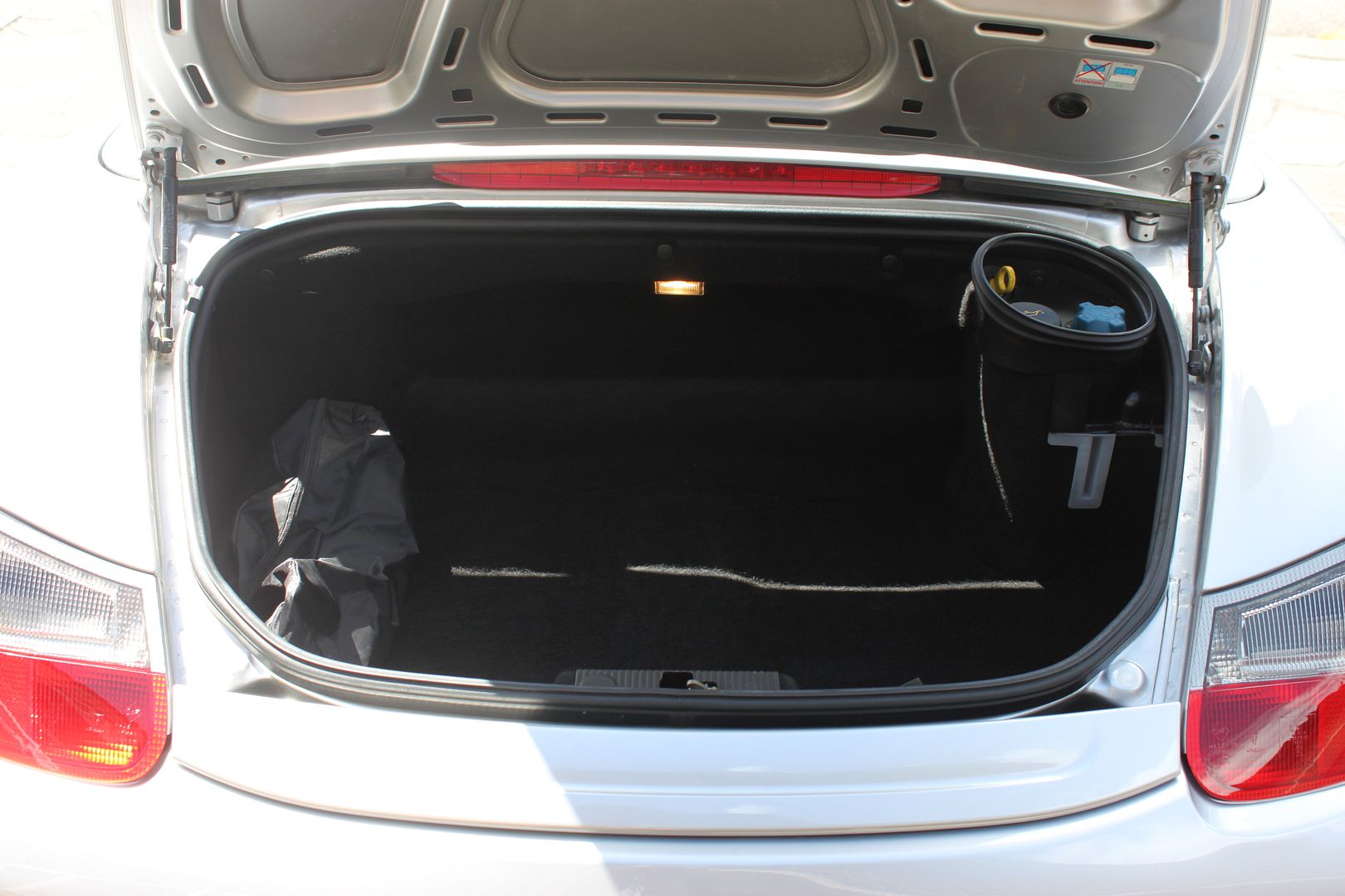

Then wiped down to remove and oils and fillers left behind and checked with various light sources to make sure no trails or hologramming was left: Onto the wax: Including the door shuts and insides, rear light's also cleaned and waxed: Interior was hoovered and various items coated inc the roof with gtechniq The final pictures (there's lots)
