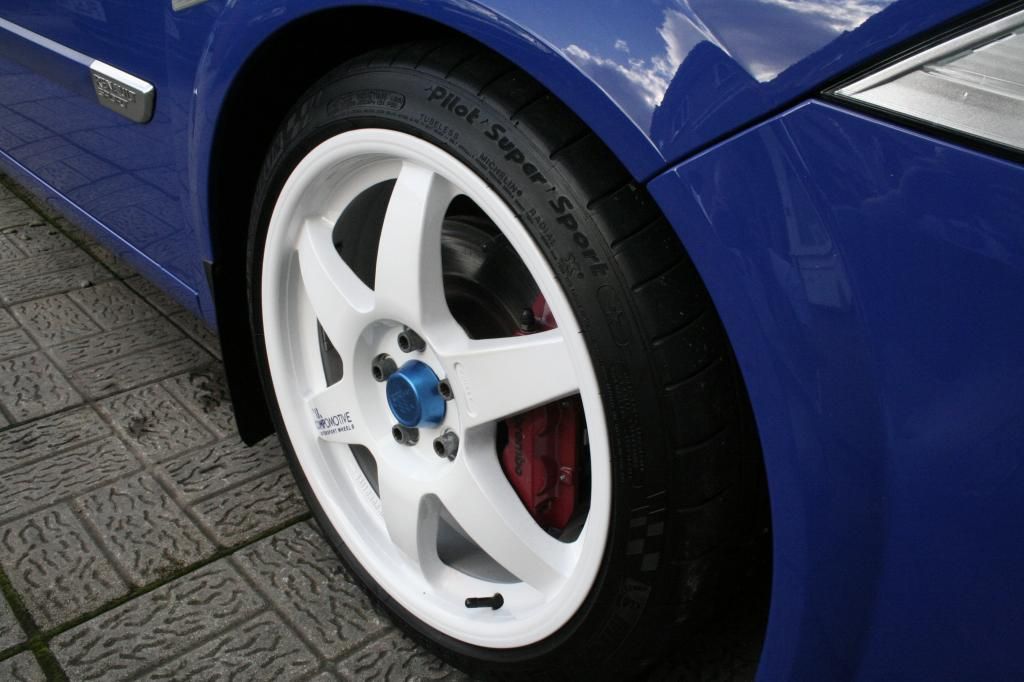

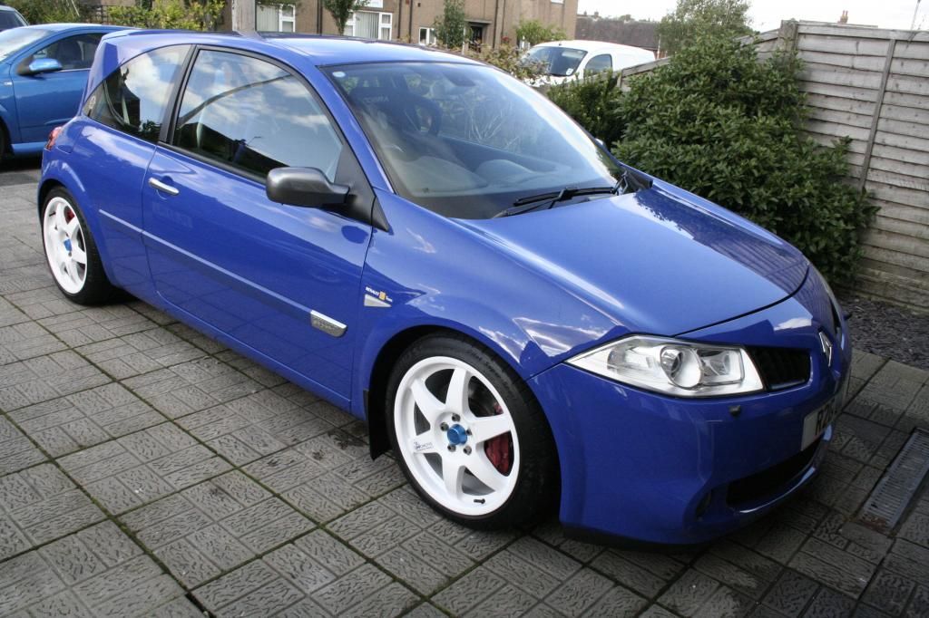

  5. Compomotive M06
  6. nightmare to keep clean tho lol
    them Oz do Look nice too :tongueout:
  7. What are the wheel specs on the compomotives? Width offset etc? And is yours lowered at all john?
