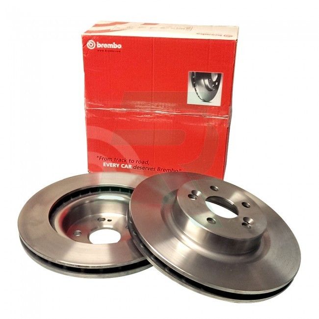

    The R26.R discs had seen 14 hours of tracktime, were fully worn and also had hairline fractures in them.......so they had to go.
    So off with the expensive R26.R discs and on with the a lot cheaper and more robust HC plain Brembo Discs...
    Pads were down to 35% or so, and they didn't look too great when they came off anyways, so it was like for like, and new DS1.11's went on the front as well. Call JJC Race and Rally and ask for a discount on them :wink: - never ask, never get and all that :wink:

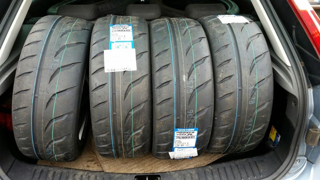

    Wanted to go back to a more agressive trackday tyre, so decided to take the plunge with R888-R in 225 40 18 92Y config, GG compound.
    Local Mobile tyre fitting specialist at knockhill really done us proud with the price - not a lot more than PS2s would of been from blackcircles.
    For the record - they came with 5.0-5.5mm
    As the AD08Rs have loads of life, and I thought the PilotSuperSports would be easier of the tyres to sell if I decided to, I stuck the 888s on the OEM rims :smile:

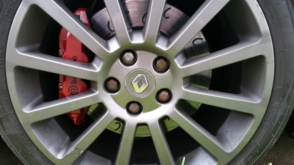

    I really wasn't getting on too well at all with the HC Plain Brembo discs (previously used the R26.R ones with DS1.11) - they were getting so hot after 5 or 6 mins that I was actually getting practically no retardation at 60mph on a 110-35mph stop - a bit worrying. Here's a little video comparison of the HC Brembo Discs (1.) and the R26.R Discs (2.)
    So ended up opting for a cheap option of the new 312mm J Hook discs from Godspeed, as the DS1.11 pads had loads of life left and would of wanted new pads if I had shelled out £550+ for a 330mm kit.
    Felt good when I bedded them in, felt even better when I managed to track them - I do like the grating feel that grooves give you under heavy breaking on track as well, in a way its kind of comforting.
