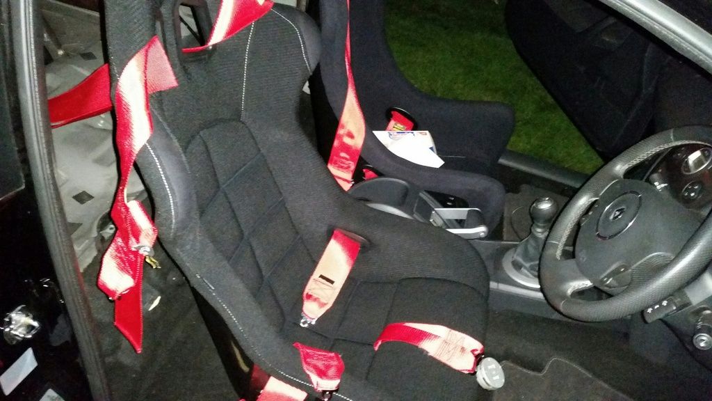

    This will hurt the ego and the wallet, but the seats are ever so slightly too narrow on the thigh bone basically - below the waist line I'm basically pinned in, was stuck in traffic for 1.5 hours and it wasn't a lot of fun, also the more I was pushing on with the car the more it seemed like I didn't have the adequate reaction in my right foot to switch from throttle to brake pedal quick enough......
    I'm in a bit of a catch 22 at the minute.....The wider Sabelt seat would fit my hips and legs no problem, but its not as 'tall' as the Large size I have, therefore it would mean that the shoulder strap slots may be too low for me......
    I'm probably going to hold fire until I've physically sat in a seat I know fits me properly. The options seem to suit if you're either tall or wide - not both lol and this will end up probably costing a fair bit more than the retail on the seats I have atm.....

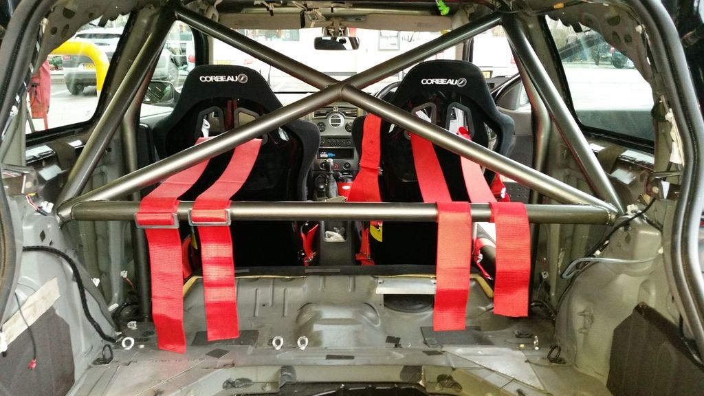

    Got 1 Corbeau Sprint bucket in the XL size and had that fitted to the car - the Ktec subframe had to be drilled out to get it to fit - but its a very comfortable seat, one that I could easily sit in for 4 hours at a time.....The lower thigh exit in addition to it being a good 17% wider really makes all the difference...
    They don't look as pleasant as the sabelts - but hey ho.

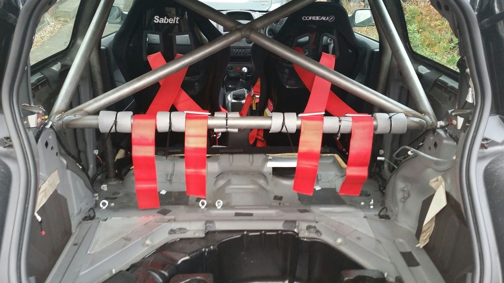

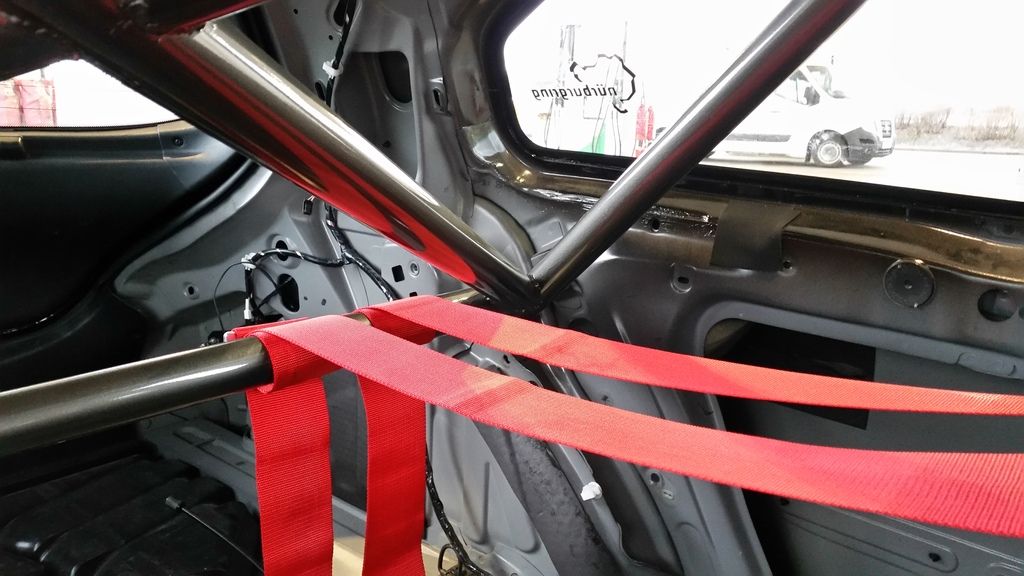

    Had a fully welded rear cage installed by Scott McMinn Motorsport fabrication in Ayrshire up here - its allowed to harnesses to be run off the harness bar safely now - all I can describe how you feel when belted up properly now is that you don't feel that the harnesses are pinning you in at one particular point, but you are totally fixed in and can't move at all - its a very comforting feeling. The result is a cage that should be more rigid and lighter than the bolt in equiv, and it was a hell of a lot cheaper also.

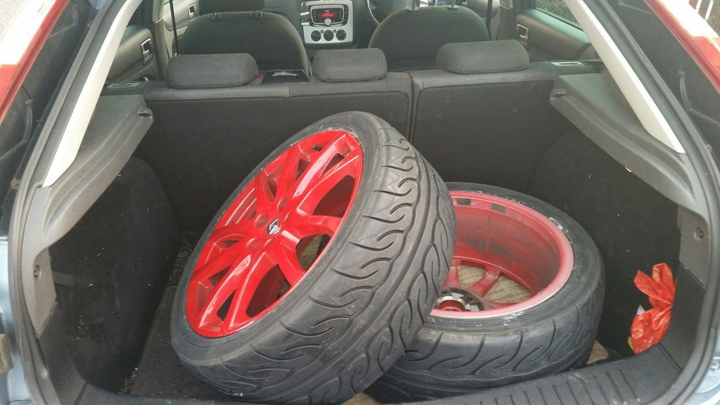

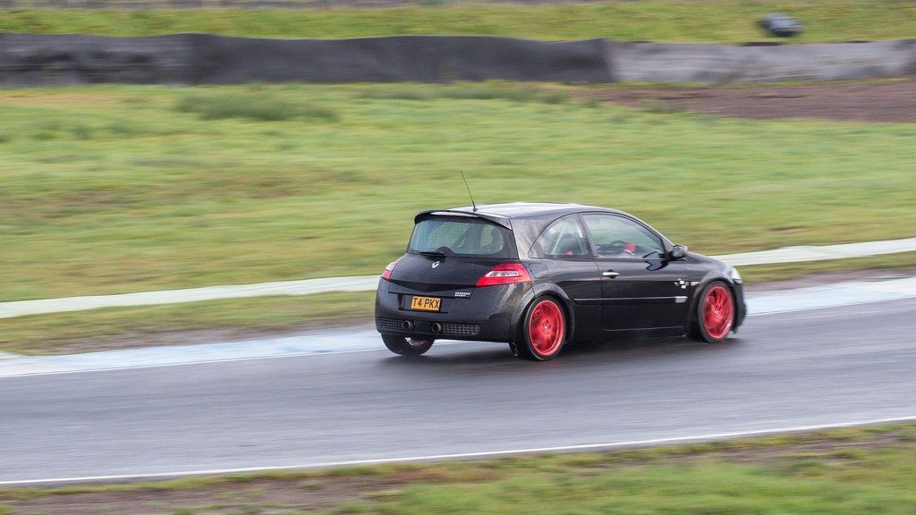

    Needed new track tyres on the red wheels as the R888s were totally shot - went for AD08R in the end, mainly for the value they offered, the jury is still out on them, need another trackday to be able to give proper feedback...they were very good at getting the power down and on the brakes in a straight line in the wet though....
    TD at Knockhill at the weekend - and it was very wet to begin with for the 1st hour, dried out for the next 2 hours and then finally a dry line appeared at 3pm with about 1 hour let in the 4 hour session.....
    It meant I got to experience the full range of conditions from wet & raining, to wet, to drying /greasy, to dry. It was a very steep learning curve, especially set-up wise on the coilovers and tyre pressures.

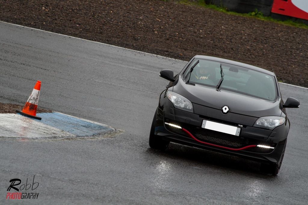

    and a couple of pics of my meg in the wet.....

  4. Did you see the curtain airbags being removed before the cage went in? Wondering if they can be removed and still save the headlining?
  5. Fantastic mate, cage looks great... My next step was a cage before I sold it. Would have finished it of nicely.
  6. Yes mate - they were removed by the cage fitter, and you can still keep the head-lining - the curtain airbags are like long tube sleave type things - be careful though with the explosive charge and all that :cool:

  10. Would it all have to come down to remove the airbags or do you think they could be accessible from the rear? i've got a fear I'll never get the headlining back how it was
  11. The curtain airbags are about 3ft in length and maybe weight between 3 to 4kgs each - I'm pretty sure you'd be able to slip them out with only sliding half of the roof lining off its plastic covers, it depends on how they are fixed really. - but I didn't really see the job being done - I only saw the aftermath in my boot - he did get the lining all off in 1 piece in mint condition but it was too much hassle for me to drive it back - I'll be going to the scrappy up the road for another one most likely.

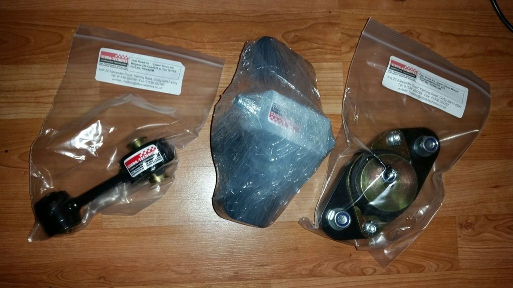

  12. Hopefully getting this lot fitted next week............

    Yeah these will be pretty hardcore most likely - I have been in and driven a 172 with the vibra dog bone in it, it felt lovely, but it did have a lot of cabin vibrations on idle
  16. Yeah I had that exact setup in my 172. It did drive really well but just unbearable on the road.

  18. Alright mate - its an upper torque link - located in the back left (drivers side) of the engine bay as you look in.

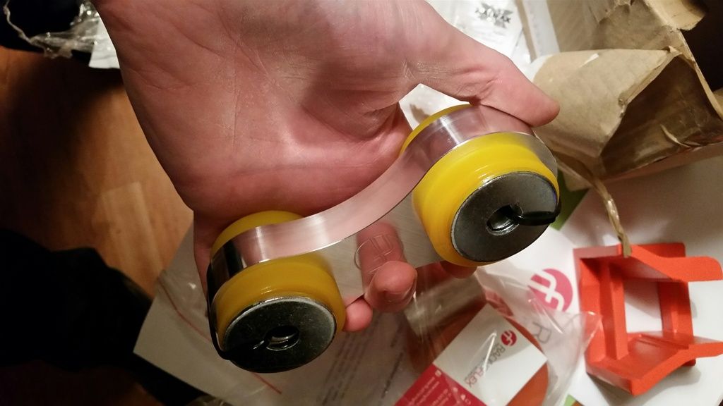

    It was bought from racingflex.pl - I wouldn't recommend the service, some of the parts didn't fit at all hence the need for the vibra kit- myself and others have had to wait months after payment for delivery - up to you.....there's a feedback in the traders section.
  19. Ah ok.. Thanks for the heads up... I might go for a little mixture of vibra and powerflex uprated standard items... Been holding out for the after market steering arms but it's looking like I may need to go for new oem ones.
  20. steer clear of racing flex, customer service and delivery are shite, shame because the part i eventually got is top quality.

    I picked up the car late last week during the storm and it feels night and day - the cabin vibrations stopped after 10 miles or so - the main side effect of the mounts is increased engine and exhaust noise.

    KTec just slashed their prices of the mounts as well - would of saved over 50 by waiting a week. They are 350 from them now - cheaper than anywhere else I could find......

  26. Not at all mate: I fitted the 3 Vibra engine mounts, Upper Engine, Side/lower engine & gearbox (Ktec is actually the cheapest by £50 now for them, Ktec branded but exactly the same) http://www.k-tecracing.com/show_product.asp?id=3950&appid=12
    The only racingflex mount I fitted was the shiney torque link - I think its the only uprated one of the market to replace the OEM part - powerflex don't do inserts for it etc

    how have you been finding the seat? I have the one up with the higher side walls really cant wait to get it in, just struggling with mounting it atm. Don't suppose you have more pictures of how you've mounted your harnesses do you? especially where you've mounted the crotch strap?
  33. Thanks mate!
    Sure no problem - I'll try and take some for you, might be monday with the weather situation we have, and its a little tricky as I have the sound deadening and carpet back over it, no proper trolley jack to get under to show you either - but I basically had a spreader plate welded very near to where the base of my spine would be when seated drilled and welded into the chassis, it was a bit of a pig of a job for the garage as the fuel lines are on the Drivers side of the car - so they all have to be disconnected etc - also had protective sleeves put over the fuel lines at the point they are nearest the fixing plate for added piece of mind.
    Ironically I only have a 4 point on the pax seat which would of been a lot easier to fit a crutch strap.
    With the inner lap straps (outer lap straps used an eye on its own and the existing bolting position from the old seat belt point) they had spreader plates welded and drilled into the side of the exhaust cavity (no idea what thats called) part of the chassis, so exhaust and heat shield needs to come off.
    Hope this helps.
    Best technical reference guide I know of is this one - sucking eggs to a lot I'm sure - but worth a read on the protocol for fastening a harness properly even. http://www.schroth.com/installation-instructions/en/index.html
    Getting on very well with the seats - a very relaxing driving position actually, but much much less lateral support than with the Sabelts - there's always a trade off sadly, if the Sabelt's had of been a few cm wider on the hip they'd of been perfect for me - very happy with these though, the 3inch/3inch 6 point sabelt harness doesn't take any prisoners and holds me very very firm in place.

  36. Update:
    Cage finally painted, went for anthricite in the end - maybe should of had more balls and gone for 727 Red - but I am happy with the way it is, and most importantly won't be rusting any more.
  37. Looking good papps, I like the cage in anthracite, gives a nice contrast against the red harnesses.
  38. Looks awesome mate!
    one of my fav builds on the forum!
  39. Thanks guys!
    Was a really tough decision on colour - and still would of liked to have seen it in 727 Red - but would like keeping the roof decals and wing mirrors - so thought the anthracite would fit in well
