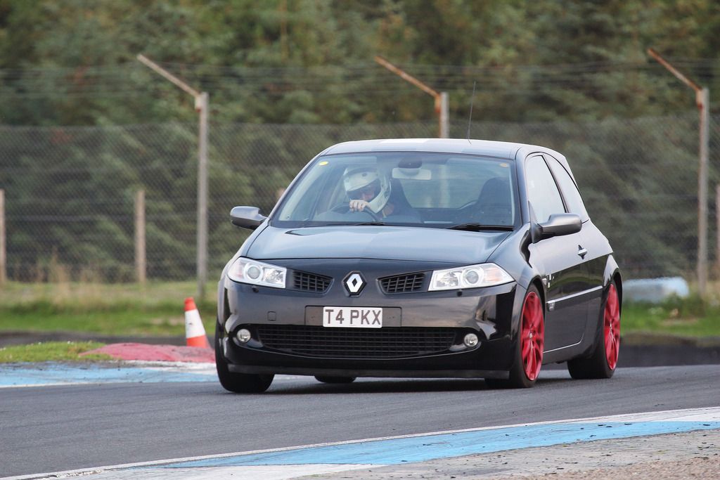

    Here's what the car looks like with them test fitted:
    I've used them a couple of times on the road, they are really loud, and also make the ride even worse with the BC's - putting the Pilot Super Sports on again for the road was a breath of fresh air lol

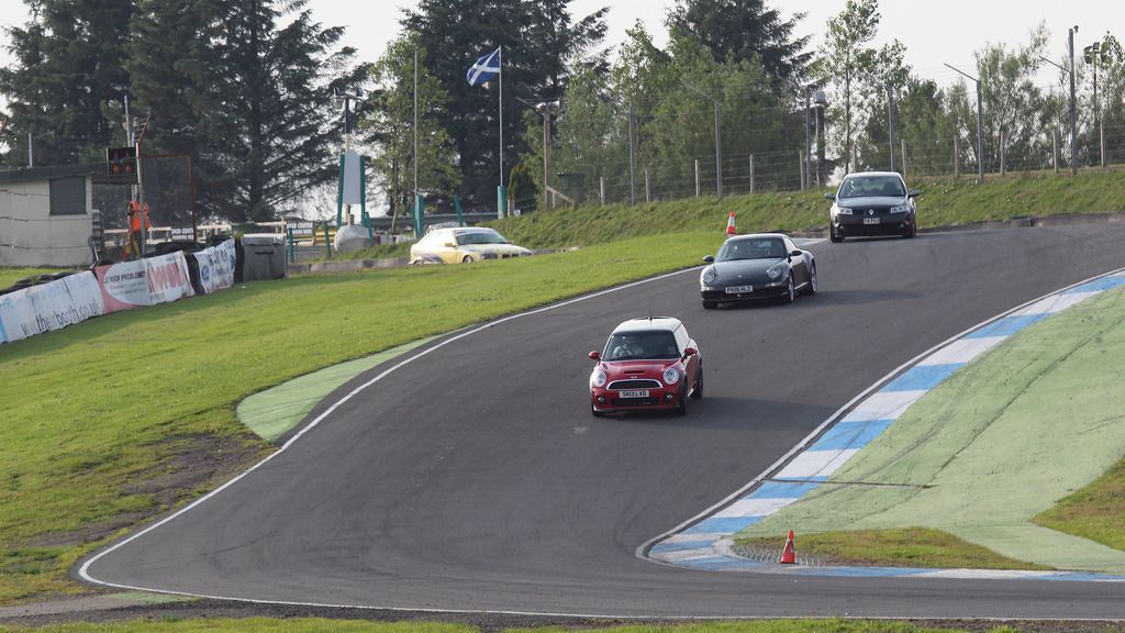

    Here's the car in the pit lane at KH with some of the compact cup boys who were in attendance:

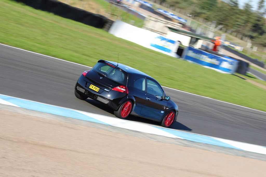

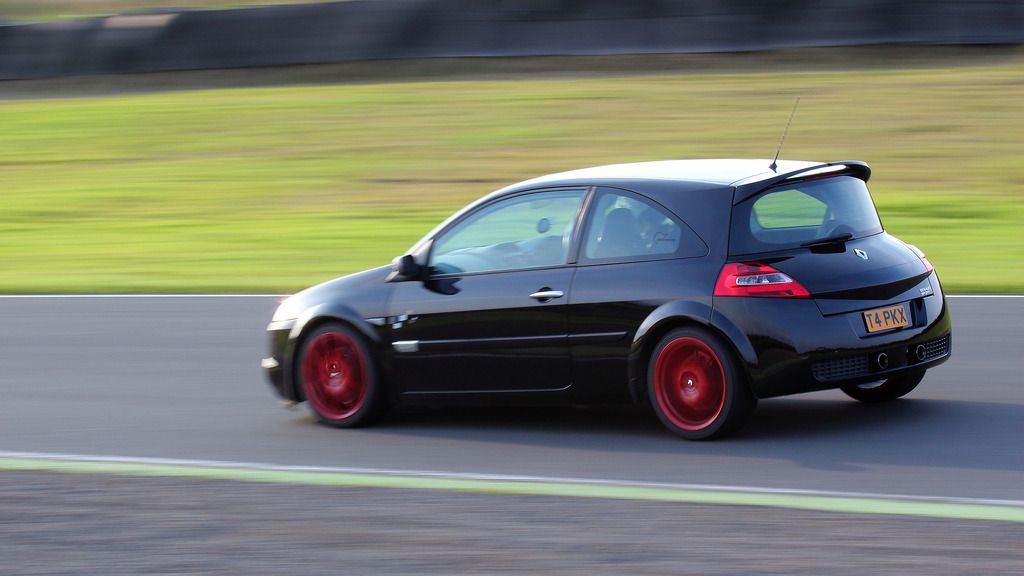

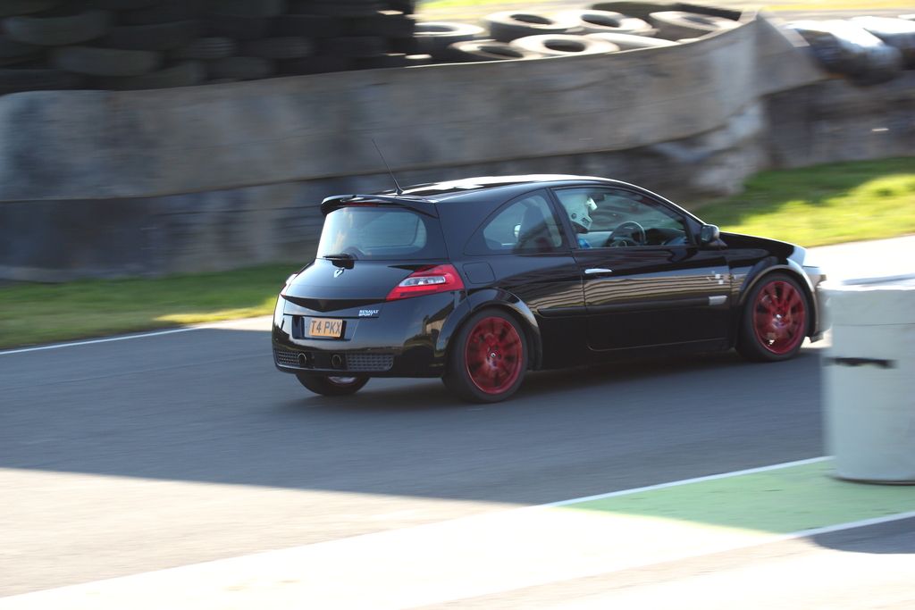

    Here's some of the pics from August on track I never got round to updating on this...[​IMG]Meg's
    and probably the all time favourite pic of my car...this will be tough to beat..

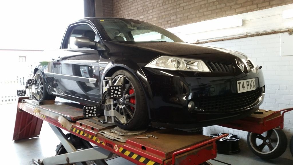

    Got the car back after some powerflex bushes finally turn up: So it now has black series front arm front bushes, and pure motorsport front arm rear bushes, as well as the new hubs and wheel bearings...
    Needed to get the alignment done again therefore.......used CLCM in Edinburgh and was delighted with the service and results,
    The big change is toe out - I should of had this in the 1st place, much more neutral on exits now and allows to get on the power much earlier and with more vigour.
    The car was aligned using a John Bean machine
    Printout of the vital stats: probably will dial in more camber as track confidence increases next year....

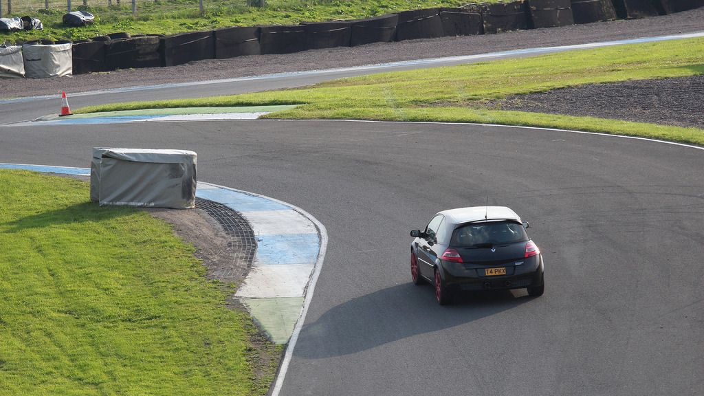

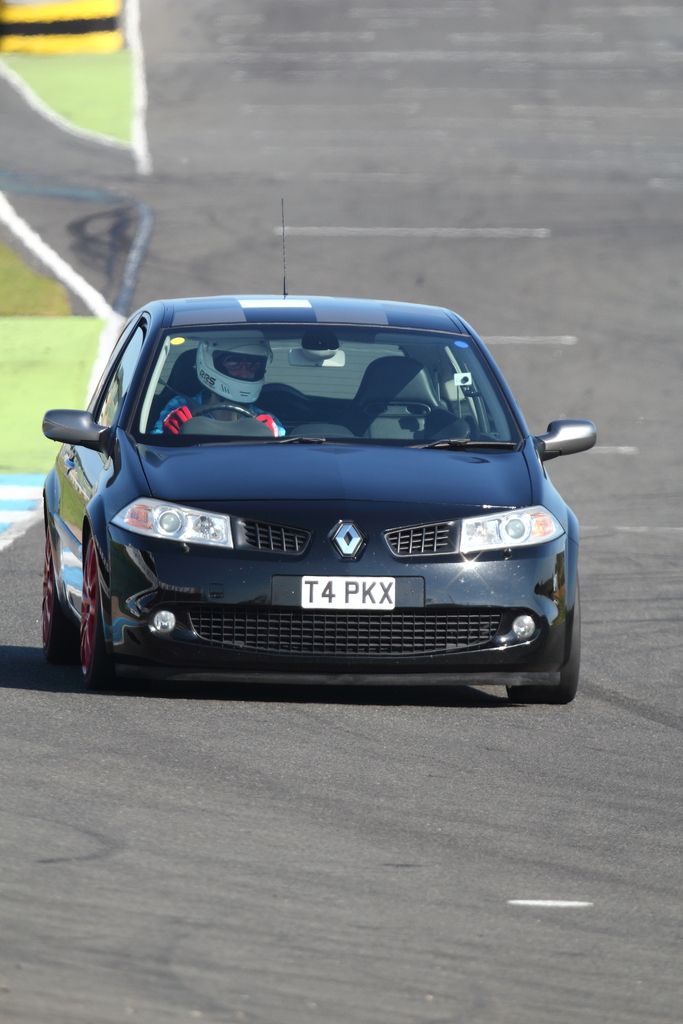

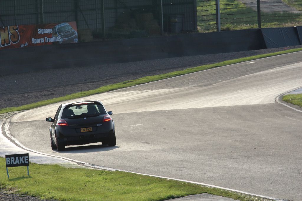

  25. Some nice pics from Knockhill last week......
    Think I may have to get a few of these for wall :smile:

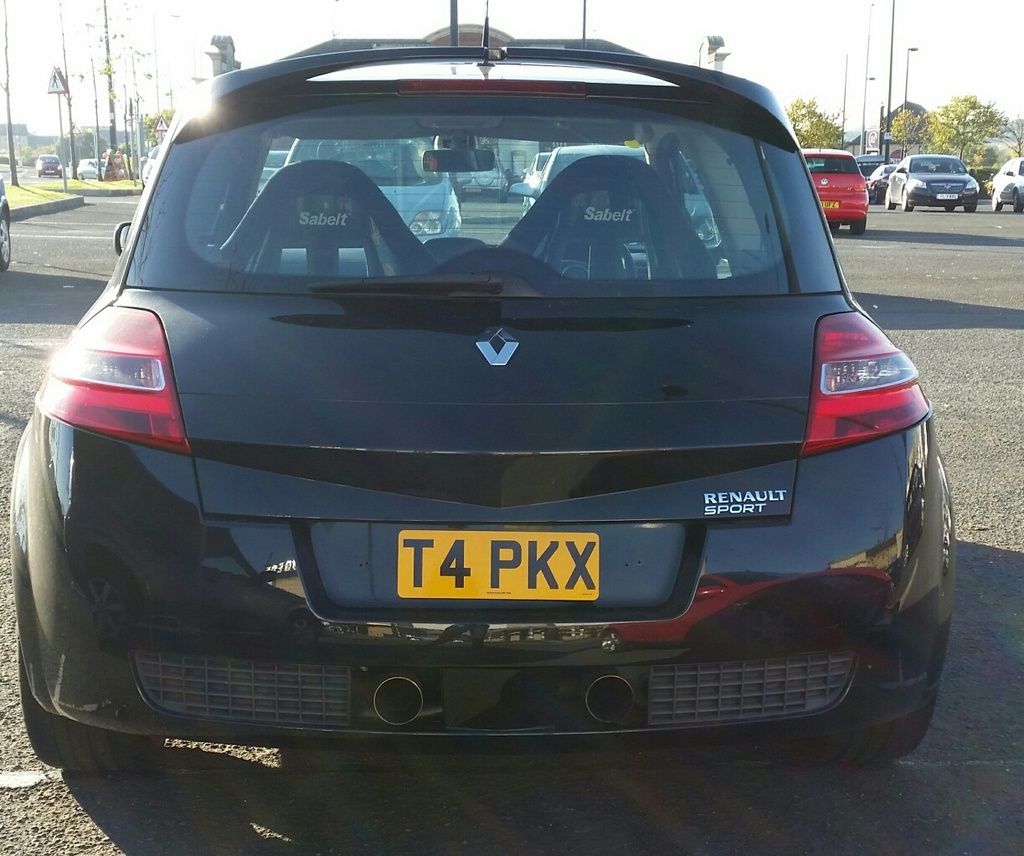

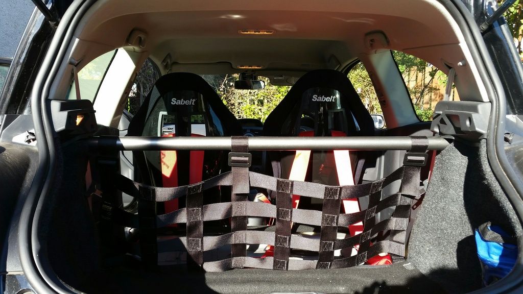

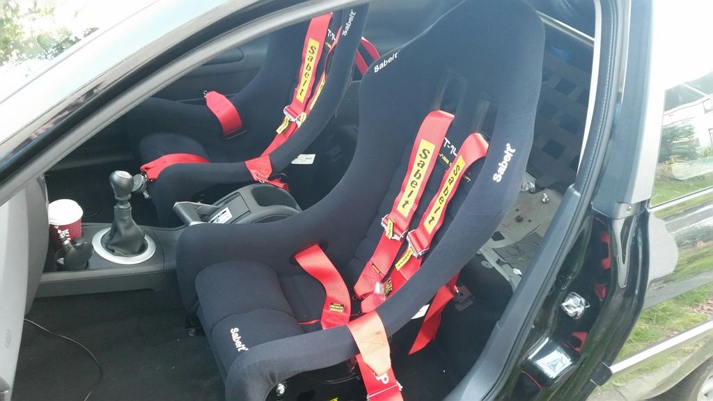

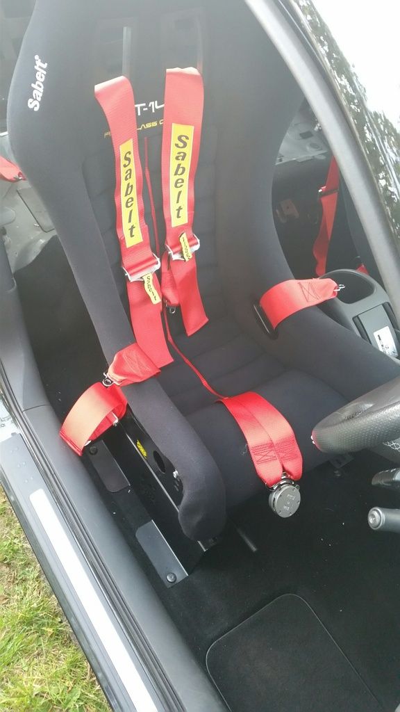

  33. Fixed back buckets now fitted in the Meg.
    2nd hand Ktec Subframes and OMP side mounts - along with Sabelt GT-140 seats in Large size.
    They have massivlely lowered the driving position - at least by an inch - which for me has made a huge difference - even a little thing such as the change in the angle of attack on the gearstick is great.
    They are very very snug lol - a lot of people may struggle to fit - oh well lol
    Had the lap strap and crotch strap fixing points drilled into the chassis with spreader plates and eyes.
    Completely changes the way the car feels - need to be careful as won't have falling out of the recaros to remind me that I'm maybe loading up a bit too much through the bends.
    Chat of a fully custom welded rear cage for £400 next on the agenda - then I can start removing the airbags etc.

    Did you make the rear cargo net?

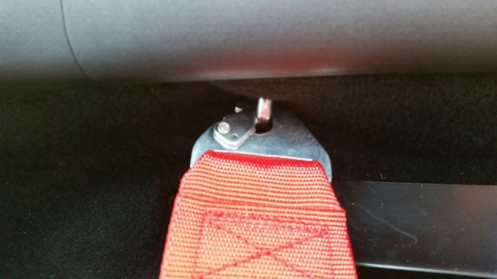

  37. Can you take a picture of how you mounted the belts on the tunnel side (lap belts)?
  38. Cheers mate! - and likewise with your car!!, great to hear your really enjoying it as well.
  39. Thanks mate!,
    Sadly not, I paid too much for the item direct from Sabelt in the UK - they had to source it from Italy - it was rather pricey given what it is, but apart from the R26.Rs I've yet to see it in another car!
  40. When I get it in the ramp this week I'll take some pics for you.
    The garage I used, drilled into the chassis (removing centre section of exhaust, heat sheielding also - then they welded in a spreader plate for the 'eye' top go into) - they mounted this parallel to the positioning on the seatbelt bolting position opposite.
    Hope this helps a bit,
    The real PITA is the crotch straps - as they're positioned near the brake and fuel lines (may not be the case on the LHD car), I only had those done on the drivers side.
