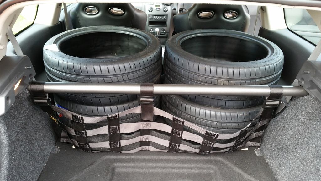

  2. Had all 4 tyres replaced today at CLCM in Edinburgh. .went for PSSs in the end
  3. Like the way you packed the tyres
  4. Haha cheers mate :smile:

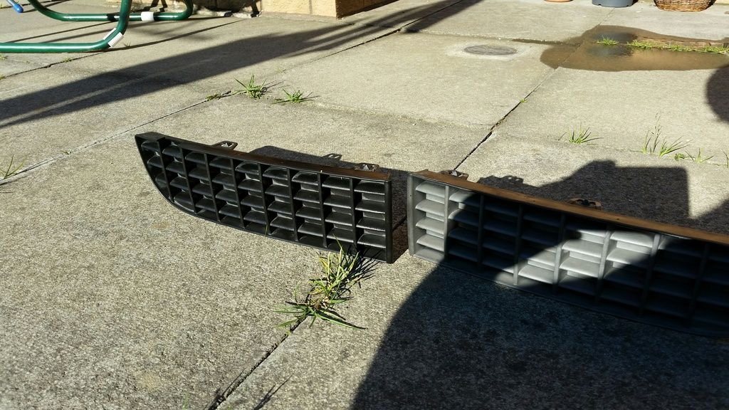

    Managed to get the rear grills off (Big thanks to Steve1 on this for the pics on how to get them off), and get them treated with a sample of Sonax Trim Restorer I got from cleanyourride.uk a while back, quite happy with the results, will give them another coat in a week or 2.
    and back on the car...

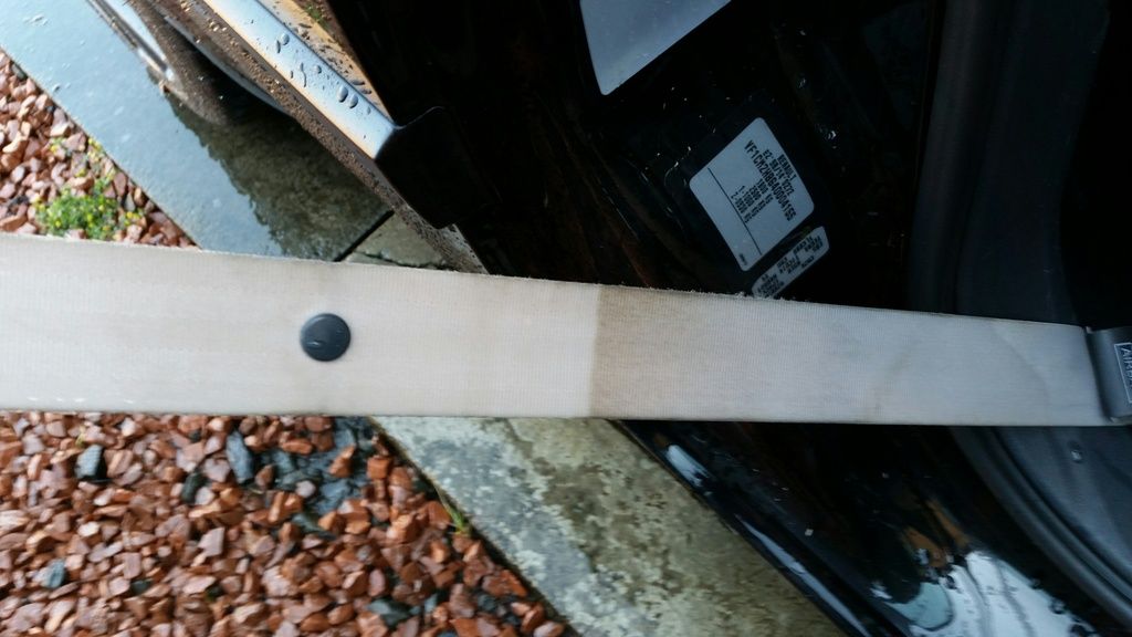

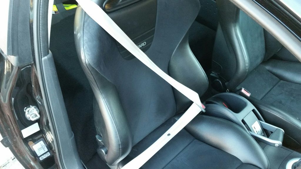

    I had used a nail brush before on the seatbelts and didn't really make a huge difference on them....so it was time to turn it up to 11 and get the Nilfisk pressure washer on them...with great results
    Someone informed me afterwards that it may not be the best plan to use a pressure washer (due to potential weakening of the seatbelt) - so there's my disclaimer lol, too late for me anyway :tongueout:

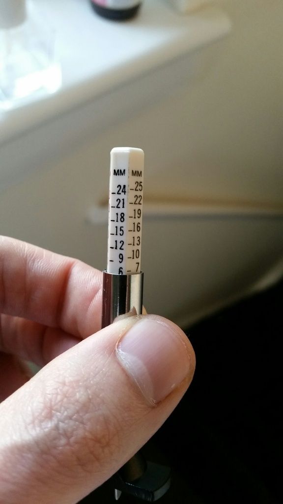

    PSS been on for about 800-100 miles maybe, and wearing pretty damn fast - down to about 6.5mm on the front, and 7.5mm on the rears

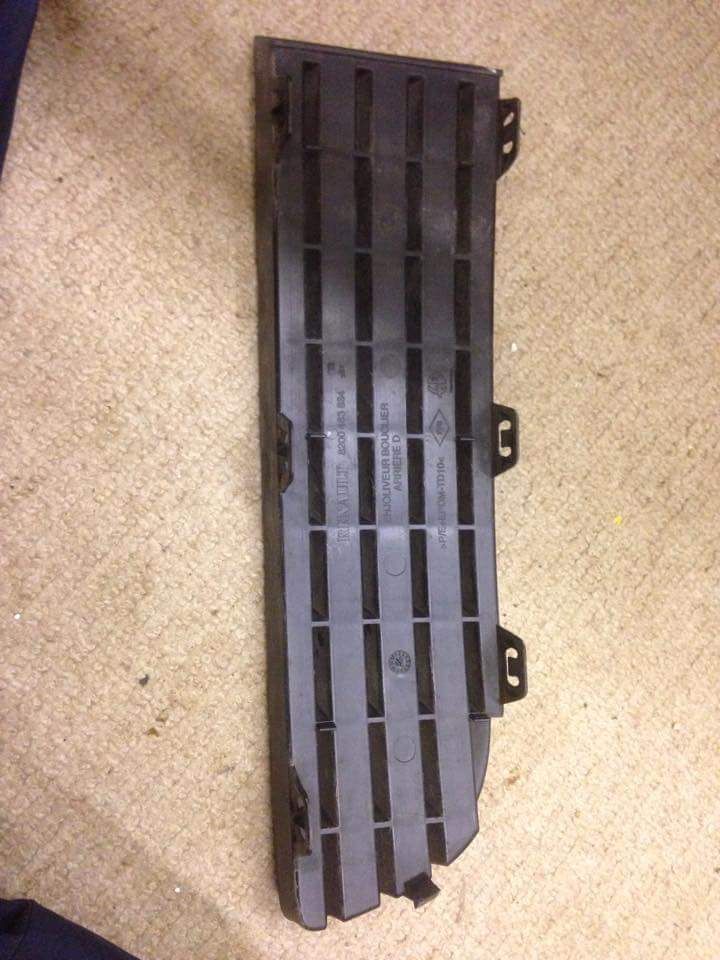

  26. the car looks great mate, I may do the rear grills the difference in your pic of one done one not was great. How long did it take getting them off?
  27. Your car is looking beautiful andreas
  28. Cheers mate!
    Very quick to get them off - each one has 6 clips, 3 across the top and 3 across the bottom....
    Start with the one on the drivers side as you have more room for your arms: Get down low (lying down) and start with the 2 clips nearest the exhaust - press them down towards the middle (Top one down, bottom clip upwards) with one hand on the outside pulling gently, once the clips click the grill will pop out slightly - do the same for the next 2 and pull gently again from the outside, it then comes off very easily.
    Very easy to get back in as well.
    The Sonax Trim restorer I have used is already looking a bit tired though.....I've been recommended 'Black Wow' or Gyeon Trim, so may give them a shot in the next few weeks or so!
