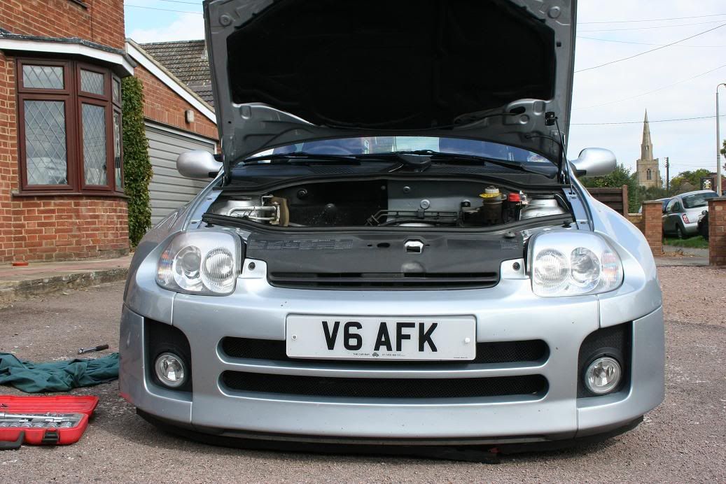

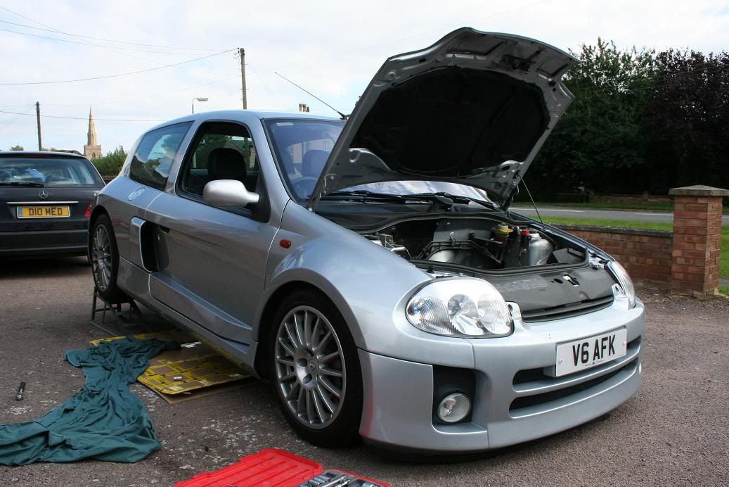

  29. Wonder if a Megane engine will fit in the front :tearsofjoy:

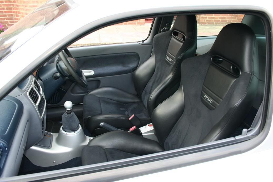

    Nice front splitter in true Renault Sport fashion broken
    This was when was removing the horrible front seats for a set of Recaro Trendlines.
  30. Beautiful, those seats look like they should have always been in there
