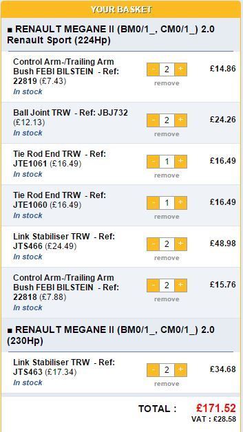

  2. Great thread. I'm just sticking this order in... does it all look correct for an R26 refresh?
  3. yes thats the same as I ordered last week and then the inner tie rods from RPD as they were £10 cheaper a rod (£40 each)
    hopefully getting it all installed this week, the deliver came pretty quick aswell
  4. You got a link for the tie rods?

  12. Thanks folks, full kit ordered as above [emoji41]

  16. hi all. sorry but had a read of this thread and can't seem to see the link on mr auto for the correct INNER tie rod (just track rod ends)?
    I need one for the passenger side (R26).
  17. Only Renault part mate. Aftermarket parts are short for the sport range
  18. Buggery bollocks. Ok thanks.
    Mark B suggested that mr auto sell them and ive got a credit note for them after they cocked up my civic shocks.
  19. The renaultpartsdirect one is the right one. Mister autos part has a different number. I am pretty sure that iner tie rods are only renault part.
    essIII likes this.
  20. Cheers for that - I was leaning that way, appreciate the confirmation!
  21. Yep inner are renault only. Had mine done last week
