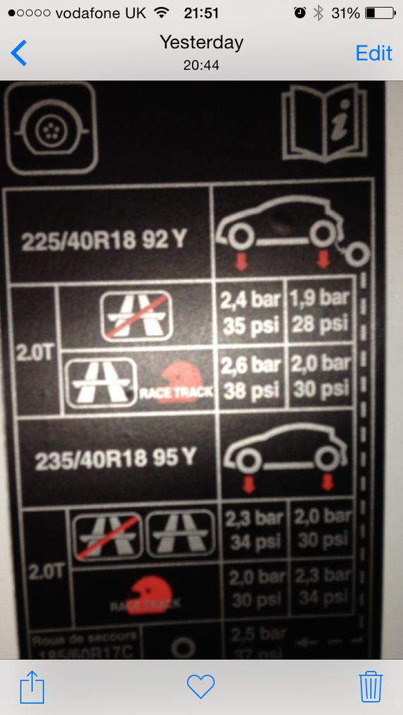

    Manufacturer Says 30f29r for normal driving on my 250 I'm guessing r26 is the same
  34. Sure mine is different Dru
  35. [​IMG]
    R26.R door Sticker
  36. Front seems too high to me so I just try and keep them 32F 30R
  37. Strange that the 250 is that pressure and my 265 cup says more when it's exactly the same car. They must of revised them.
  38. dru
    dru
    That's because the 265 cup came with 225/40/18 not 235/40/18 for some reason
