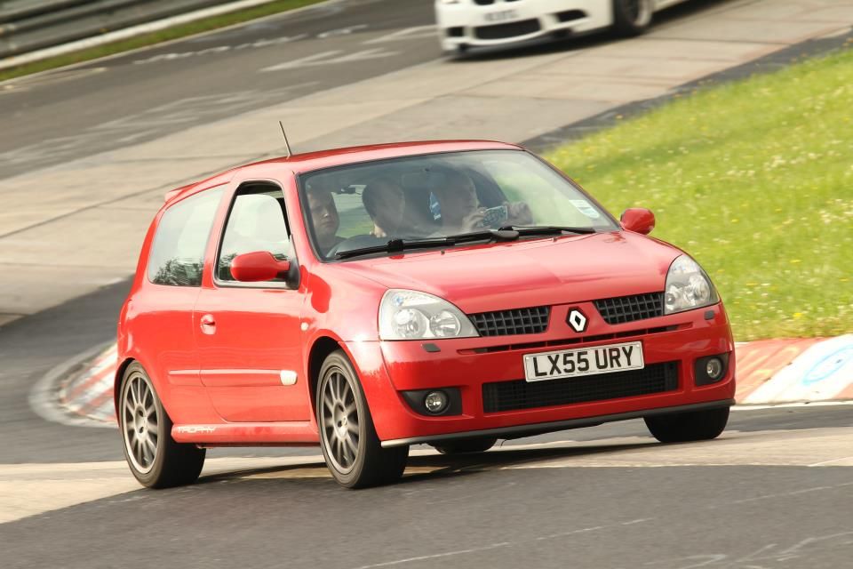

    Very shiny and bright! The joys of being a photographer ☺️
  37. That looks mint Steve , you need to come over and do some of mine mate like we discussed , I don't mind paying mate
  38. Cars looking immense Dan,
    Great pics SteBurns!
