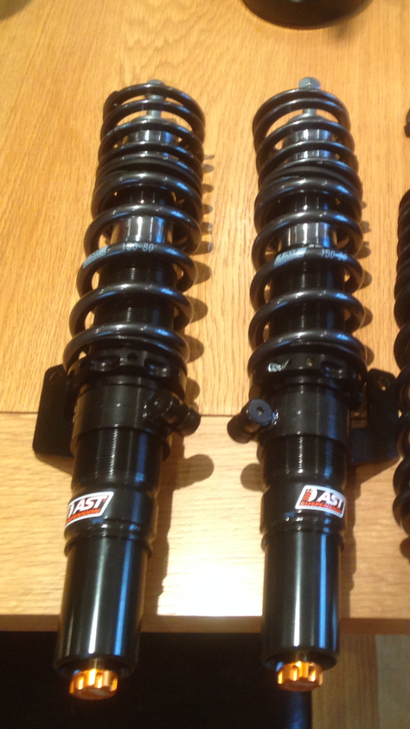

  30. Mr black will be fitting my AST kit
  31. I'm a trained mechanic, worked for volvo before I went into rail and I have access to workshop and still have all me tooling so I always do all me own stuff.
    Then me and me pal will be setting the geo and corner weighting the car down at cornering force

  34. ASTs are 450lbsall round not too hard at all for road when on full soft
  35. your spring rates seem softer than a standard spring rate to me, they seem very low for a coilover kit , the Asts are perfect for both soft for the road then when their wound up even half way their hard enough for track
  36. Exactly what I thought which is very surprising for a kw coilover kit especially the v3 as it more track day focused
