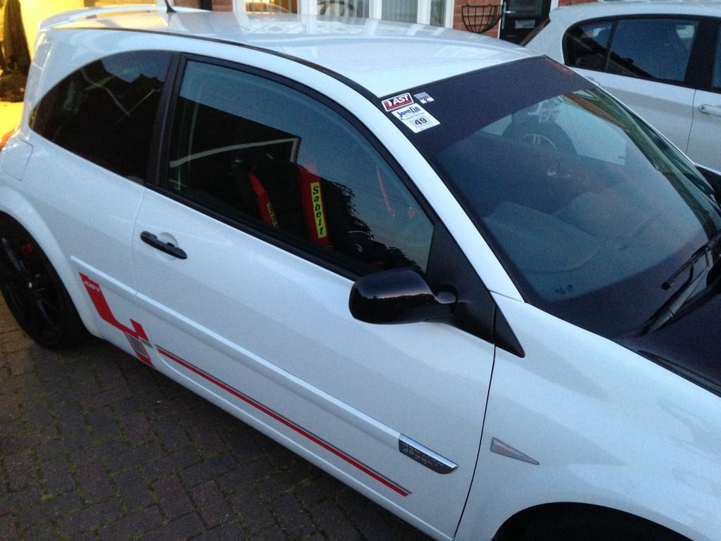

  17. Can you put a link up for your sun strip mate
  18. HK56 my son just sent me a pic of it with a custom roll cage built by the guy who did his .
  19. Plenty on eBay for under a fiver , 200mm Matt black same as mine
  20. I've just this minute bought another one £3.99 free delivery mate
  21. Cheers mate

  22. Can you post a pic of your car so I can see your sun strip so I can judge the depth to get. Thanks
  23. I'm not sure if mine was 200mm or 300mm lol
  24. [​IMG]
