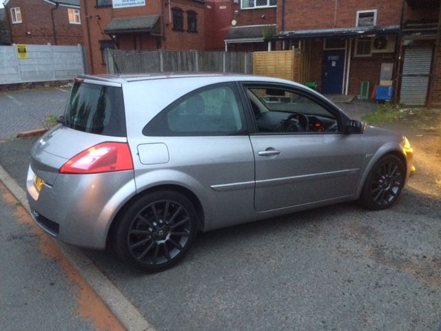

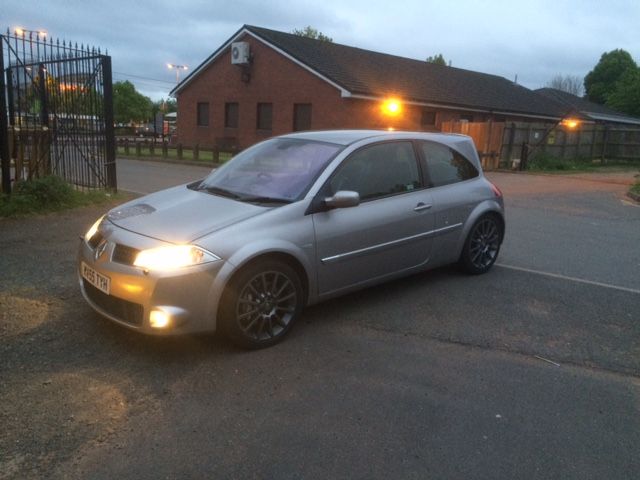

    After years of begging my other half finally gave me the ok to treat myself to my turbo megane. So here she is, my 225 Trophy. Completely standard with just 50k on the clock. Unfortunately its a cat c due to being stolen recovered a few years ago.
    Picked her up last night and im in love with it. Then spent a few hours scouring the net and ordered a Ktec Racing dump valve kit, Uprated alloy intercoler with hard pipe kit, K&N 57i kit and a set of samcos. Also priced up a Miltek turbo back system inc decat but if anyone can recommend an alternative i would really appreciate it.
    A couple of issues need sorting with the car, the first being the gear selector is really stiff which i believe is the nylon bush needs re drilling but ive seen alot of people saying to take advantage and fit the short shift kit at the sane time so i need to source one, again any recommendations would be greatly appreciated. The only other issue is that when the car fires up you can feel the car shake. Apologies for the terminology but it feels grumbly and grindy, like engine mount shot. Alot of vibration if that makes sense. Has anyone come across this?
