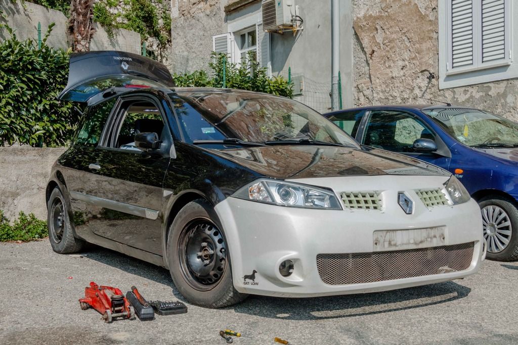

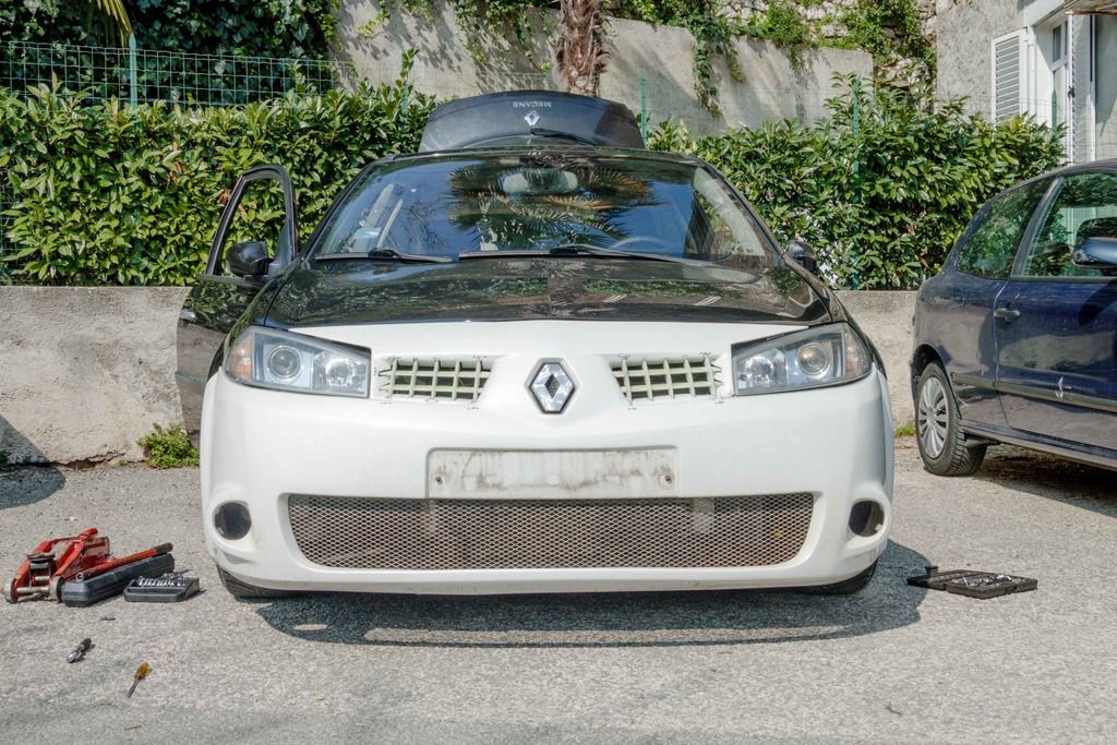

  21. slowly getting there with the front bumper, its cold here so I cant play with it :worried:
    and a slight mod on the renault emblem :smiley: how do you like it ?
  22. First sunny day and had to get it on a car :smile:
    but the grill that I am making isn't cut to the side, so the grill hit the headlights and that is why the bumper sits funky.

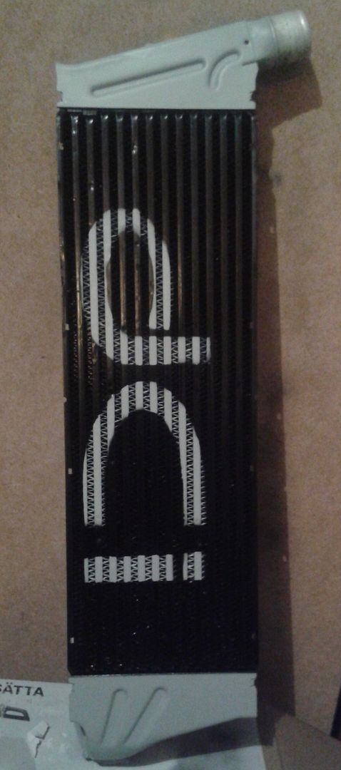

  23. I sourced a new (uesd) intercooler as mine was sligtly bent and didnt want that to show throught the "new" RS bumper
    Got it cleaned as much as posibble on presure washer (with citrus cemical treatmen to desolve as much of the dirt as possible) bit of light sanding and straightened all the little cooling ribs and he is ready for painting. Primer
    Finished
    Ill maybe apply one or two layers of clear coat for added protection and to make it easier for cleaning

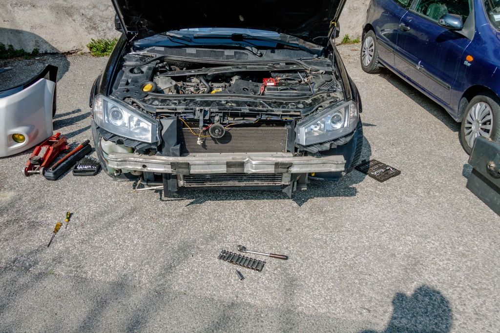

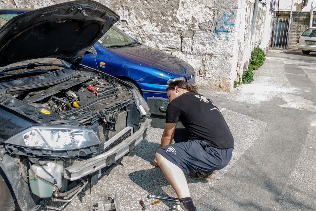

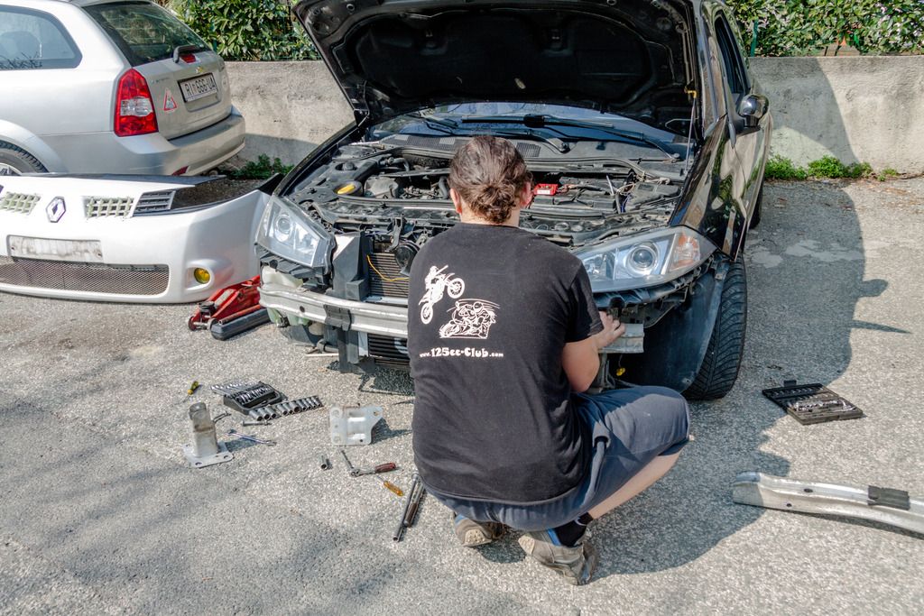

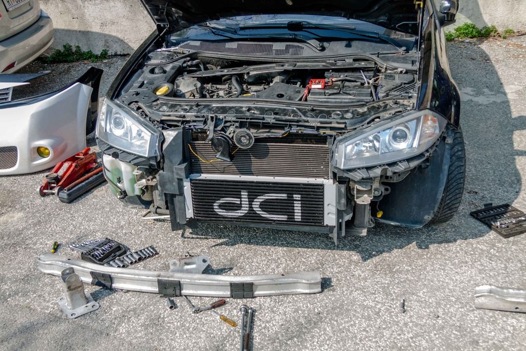

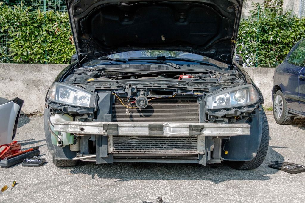

  24. here the old front bumper cross member, she is finally changed for a new one.
    Old FMIC in the background, and the damage on it is visible, it is the reason why have I changed up to one in pristine condition. the old one didn't leek but it bugged me
    New FMIC mounted, much much prettier to the eyes than the old one :smiley:
    and finaly a new cross member fitted
    mounted RS front bumper:
    Sadly the front bumper is not nearly in as condition as I thought, it is is much worst, and will require much much more work to make it up to the standard than anticipated.
    the line between the bonnet and the bumper is chaotic, starts on right hand side at 0, at middle it is at 8-10mm and ends at 4mm (which is super :smiley: and I will try to make the rest to be in same distance) also in the middle the bumper is much lower than the bonnet, it does not follow the line of it. Most of the mounting points are misplaced, and in one area, the bumper is to thick to mount nicely.
