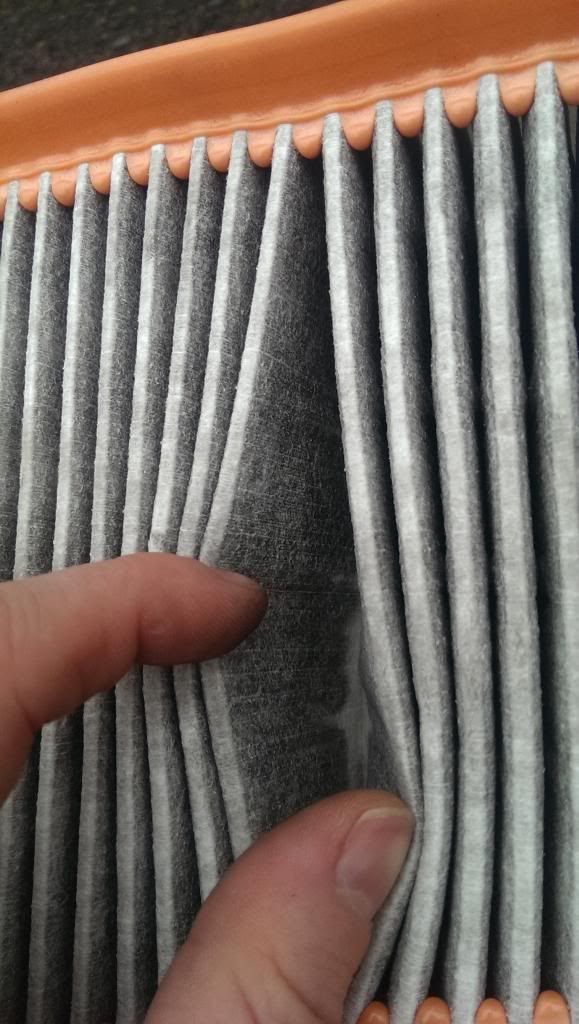

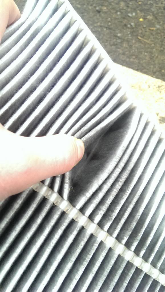

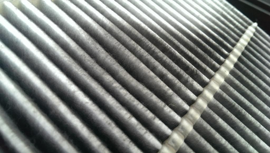

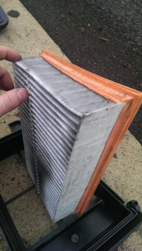

  1. So, after a dispute with Renault recently about my servicing plan the car went in for its first service. I do not trust this dealer one bit and they have a bad reputation in general.
    So I dipped the oil, they have at least changed that, impressive.
    Now how about the air filter, I just popped in out and this is how it looks. My question, does this really look like an air filter that was put into the car brand new 2 days ago? Would it really blacken up that fast? Or are they liars?

    Massive fucking liars.
    Unless you've been driving around Xingtai in China.
