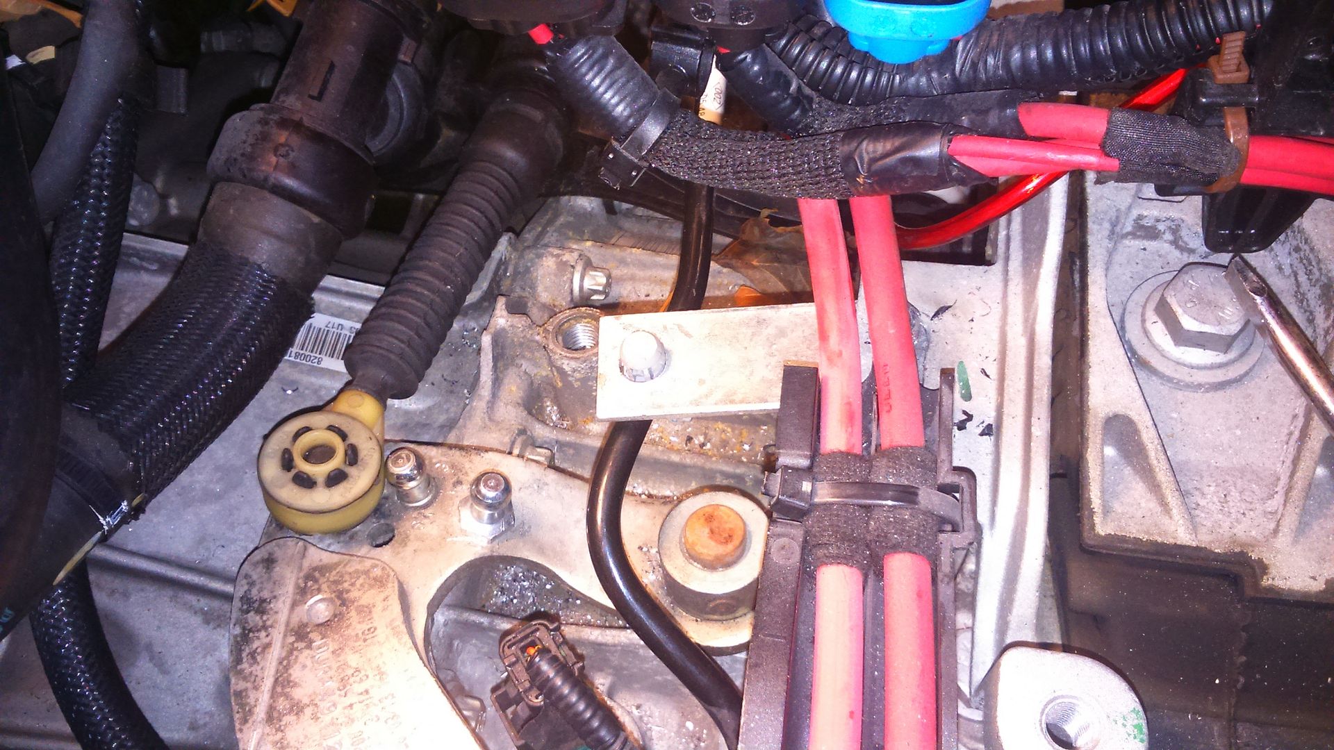

  33. You really are over complicating things. It simply is not a difficult job. Same end product. Easier to fit, easily reversible if needed and costs £138.49 less. But by all means by the m-tech if it makes you (or anybody) feel better.
    M tech shifter Mtech-PK4018-Shortshifter-for-Renault-Megane-20-RS-250bhp-322017004517-3.jpg
    Diy ball stud £1.50[​IMG]
    Studs are in the same place giving the exact same shift.
    Remove battery and tray
    Keep in nutral and remove shifter cable by pulling or levering off
    Drill 10mm hole 15mm- 20mm away from original stud (see pic)
    Bolt 10mm m8 stud inplace
    Remove 18mm bolt holding slave cylinder pipe bracket
    push gear lever cable onto stud
    (optional) Small bracket to hold the slave cylinder pipe instead of zip tieing (my choice but may well be ok zip tied)
    Job done 1 hour tops. It would probably take me 30 mins having done a couple now.
