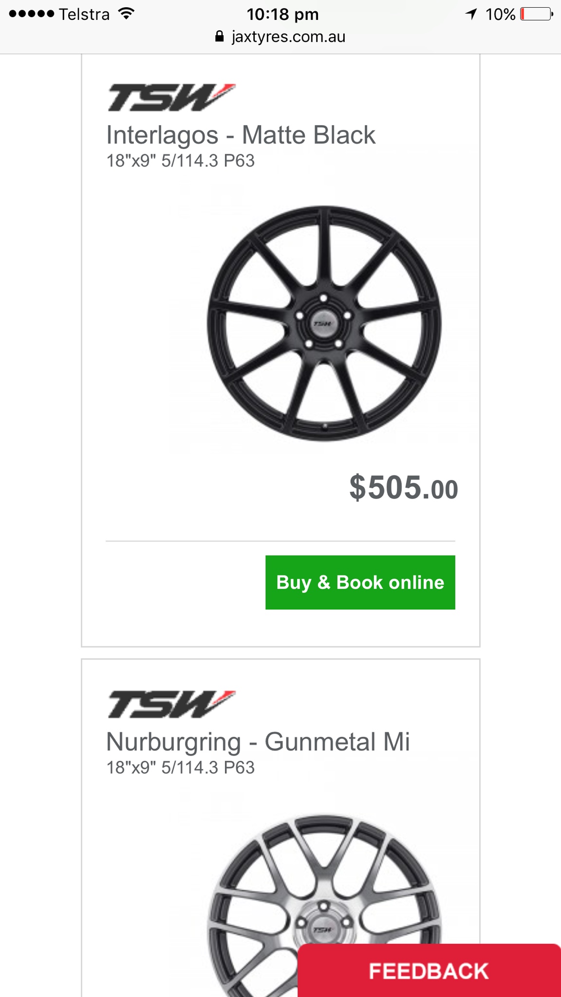

  15. Did you check online ? [​IMG]
  16. I did, but without luck the first time. This time I found your screen shot. Thanks!
  17. Haha no problem. The Nurburgring ones look decent too and I think they have 3 colours.
