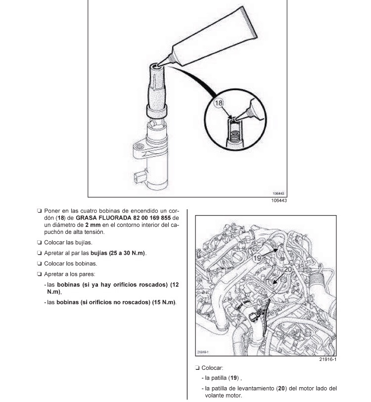

  2. Hi, what kind spark plug you have? I have iridium denso IK24 whit 0,6mm light. Put in your coil extreme a Little lubricant fat. Look Picture, os very important what fuel you used. I hope help you [​IMG]
