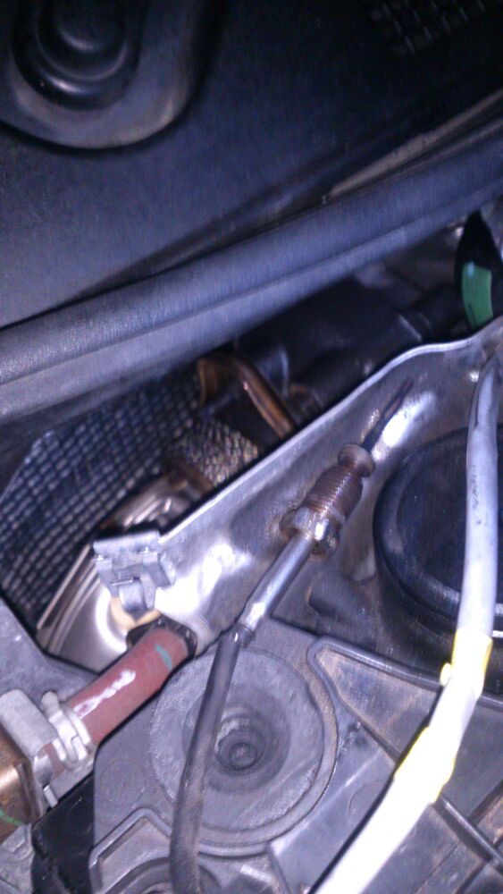

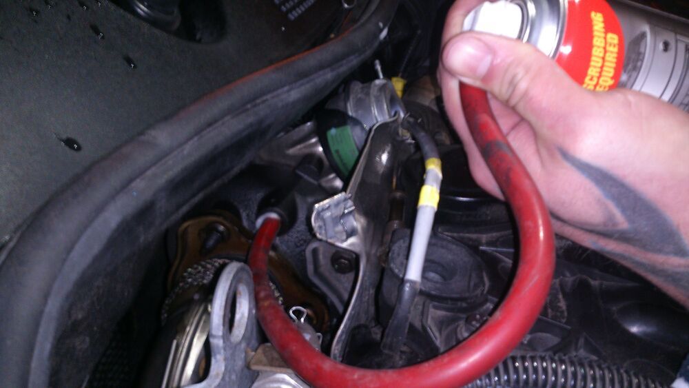

    For anyone with a Megane Renaultsport DCI heres a few pics how I dosed turbo with mr muscle.
    What a difference although think it could do with this process again
    Took EGT probe out of turbo 14mm on this unit
    Then with silicone hose and another cap to take the hose filled turbo with mr muscle
    Then started up to clear EGT port put back in and took for a blast
    Huge plume of sut and awayyy
