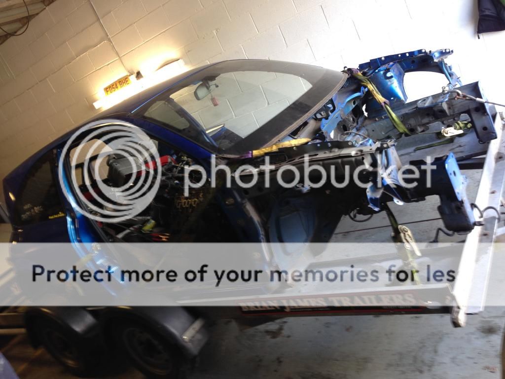

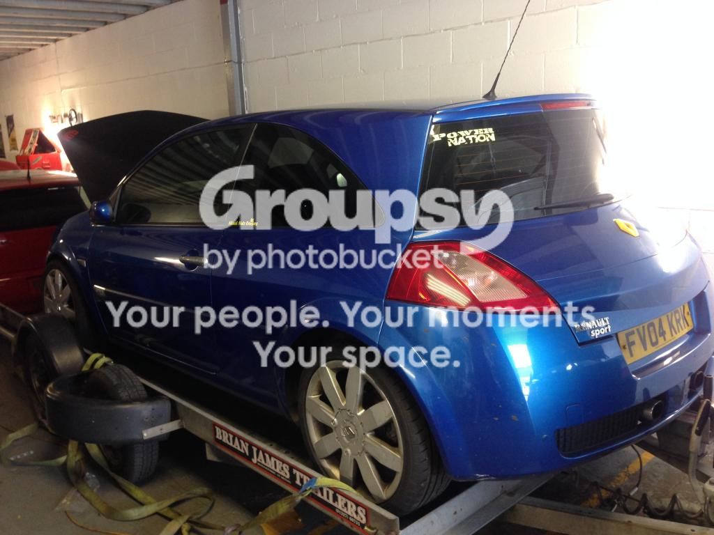

    Onwards and upward, basically I came across a full megane 225 car with minimal damage I had never intended on doing the conversion but the car was to cheap to turn away so enter the megane 225 with slight suspension damage and no key!
    We stripped everything off the car, and either kept it for the conversion or sold it to fund the project.
    Off it goes to the scrap yard as a shell
    The car in question for the conversion this was September 2014 the very same day we removed the engine and box ready to start the conversion

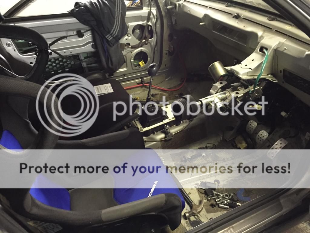

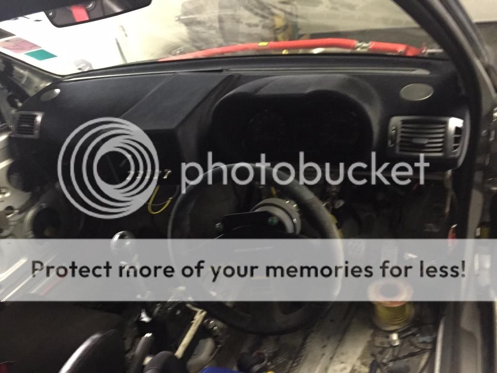

    first thing was to fit the seat so so we could mount the steering wheel/pedal where we wanted them. Our resident welder ste has fabricated all this in our unit with a super £150 welder!
    you can see the electric steering, custom pedals and the megane shifter mounted on top of the tunnel instead to bring it closer to the steering wheel.

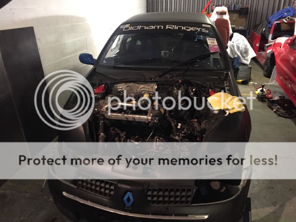

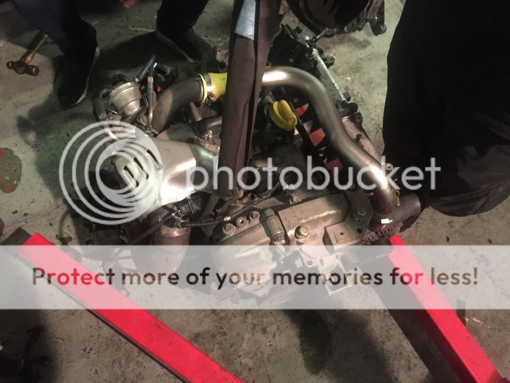

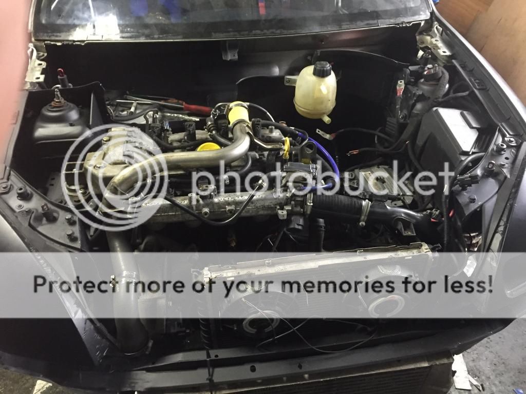

    Next was to actually fit the engine and gearbox to see if it actually fits. in short no it doesn't but its not by much, it requires the passenger side chasis leg to be cut and notched to allow clearance for the gearbox. a bit of hammering to the subframe also so nothing fouled. We had to make up 2 engine mounts to go along side 2 of the standard mounts. few quick pics of these.
    rear dog bone mount

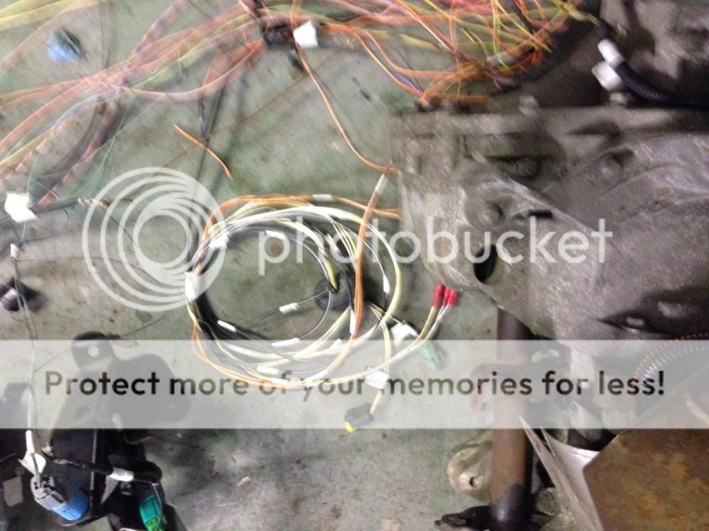

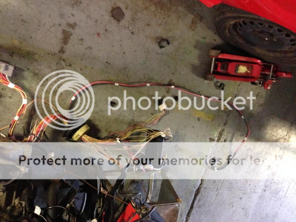

    Next step wiring! the plan was to get the engine running on the floor to see if we could bypass the meagane system. after a bit of head scratching we managed this so far so good. did have a vid of this somewhere but will have to dig it out. Next step was to remove all the megane wires that aren't needed. This was by far the worse part as one c**k up here we would never be able to retrace. But again it was managed with a bit of head scratching we managed to remove pretty much 80% of the megane loom with the engine still running.
    left over loom

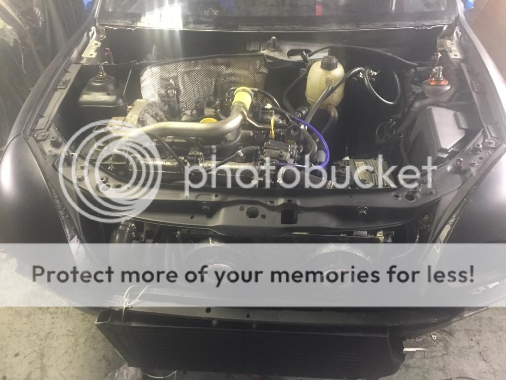

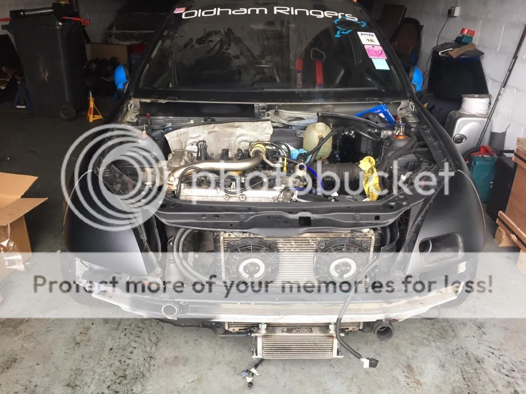

    at this point the engine was fully in and mounted level. we started to add the megane ecu and loom and plumb in the boost/water system
    trial fitting the megane 225 intercooler and all plumbed in and wired.
    The turbo at this point was found to have allot of play so was sent away to have a brand new core
    it was after this with the loom ecu and new turbo fitted it was time to start it for the first time!
    this was with no exhaust and lambda sensors etc but it does run and rev etc so that's a bonus!

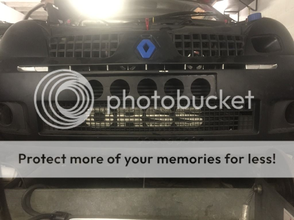

    the car is away at the minute with a friend who is fabricating the exhaust, intercooler and custom driveshaft's, but is due back today. Tonight we should be able to start it with the new full 3" turbo back exahaust, driveshaft's aren't quite ready yet so cant actually test drive it just yet.

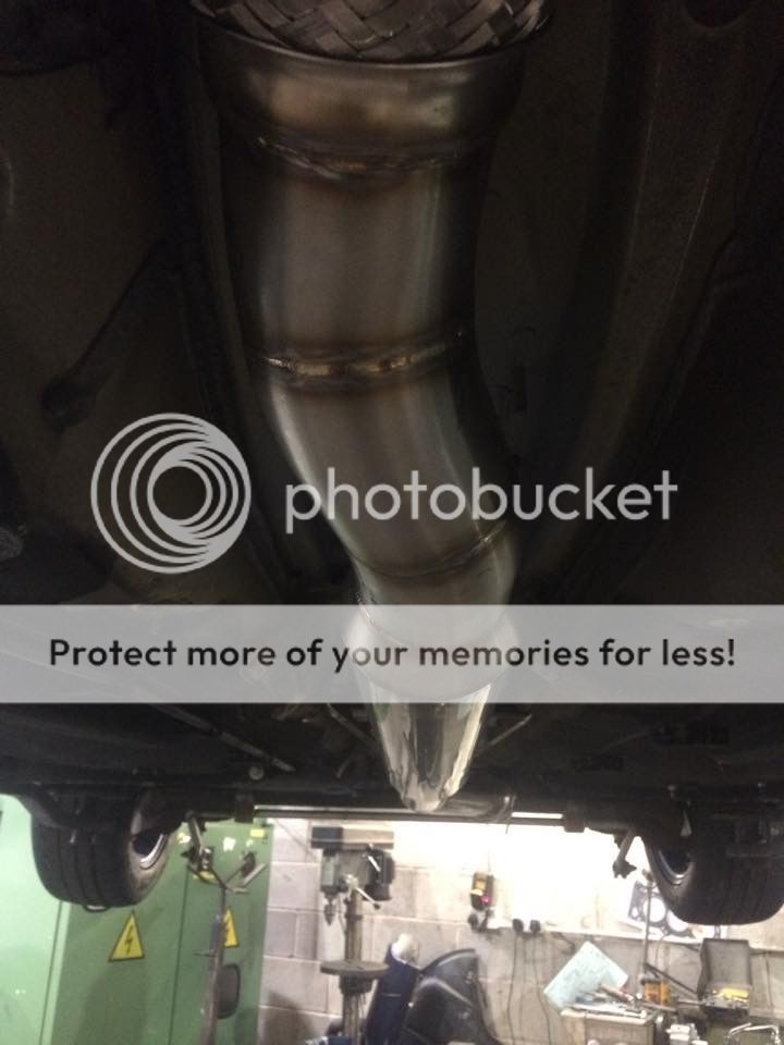

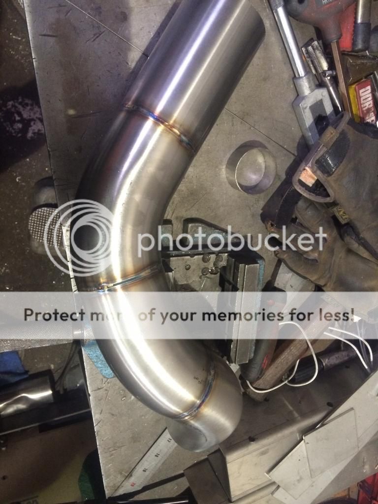

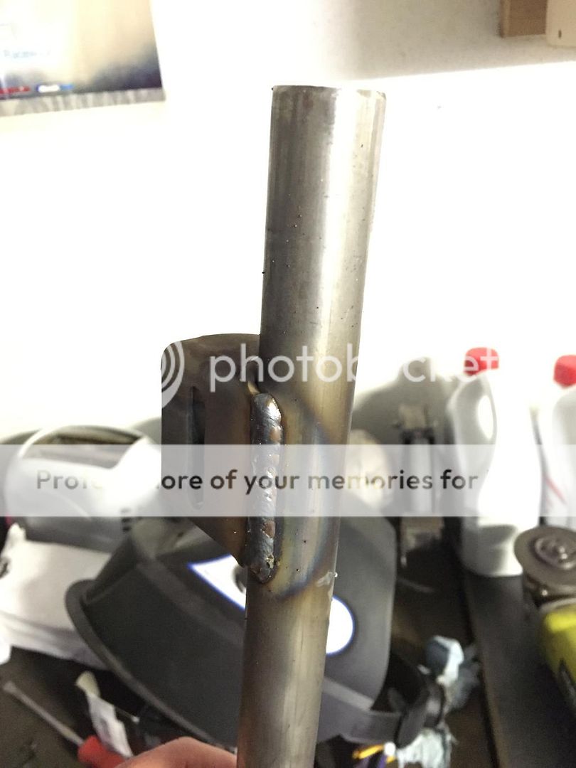

  2. Few pics of his exhaust work
    3" downpipe, apparently this was a pig to fit in!

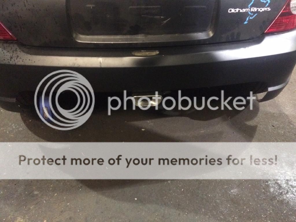

    megane 250 tailpipe
    very impressed with his exhaust work, if your in the market for a custom exhaust this is your guy!

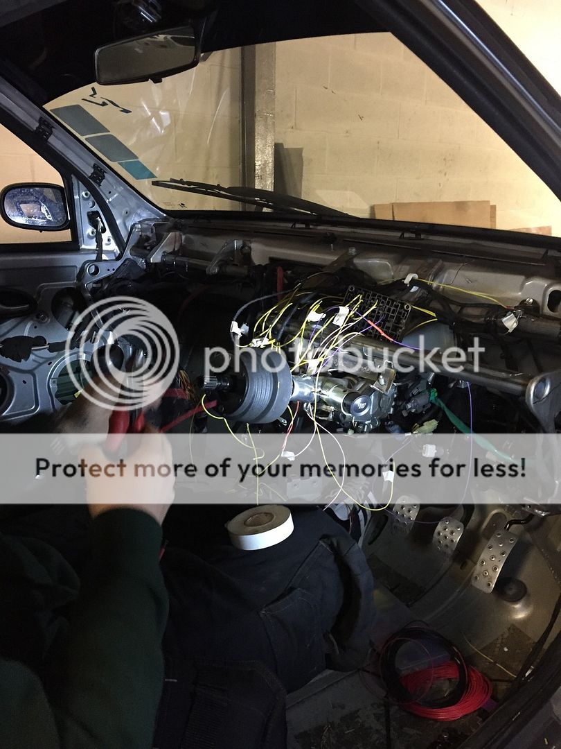

    That's pretty much where we are up to. Have the custom loom to finish off fit the dash properly fit driveshafts check and double check everything and give it a road test. Its off to EFI parts for a rolling road run before any track time to check everything over and give us an idea of the power, expecting a touch over 225, and will probably remap the standard ecu at a later time if everything is ok.
  3. fitted a new CV boot last night and carried on with some more wiring for the indicators and brake lights all working now. Just the hazards to sort out now. We also sprayed up the intercooler
  4. Kurt has finally finished the wiring, custom indicators and hazards that I couldn't do. Just needs a few more wires soldering and job done. Dash is all in now but no pic yet, just a shot of the wires!

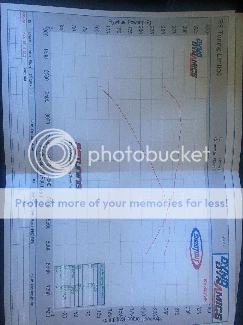

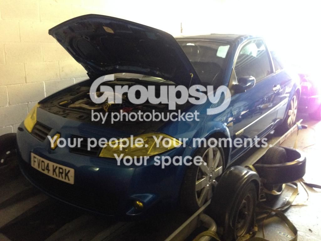

    Its off to EFI parts on sunday for a diagnostic rolling road will get some new pics and vids then
  5. car went to EFI parts on Sunday for a couple of runs. Chris was happy with the fuelling and boost etc which was good to hear. Slightly lean as it came on boost very low down but very safe everywhere else. Made 235BHP and 239Torque so very happy with that on a 100k standard engine.

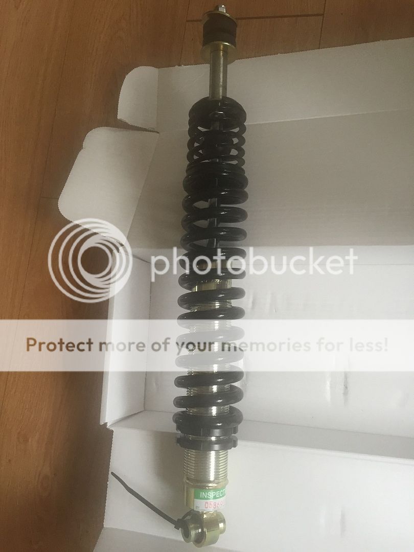

    Before I left we fitted some new rear shocks as my old setup had become seized

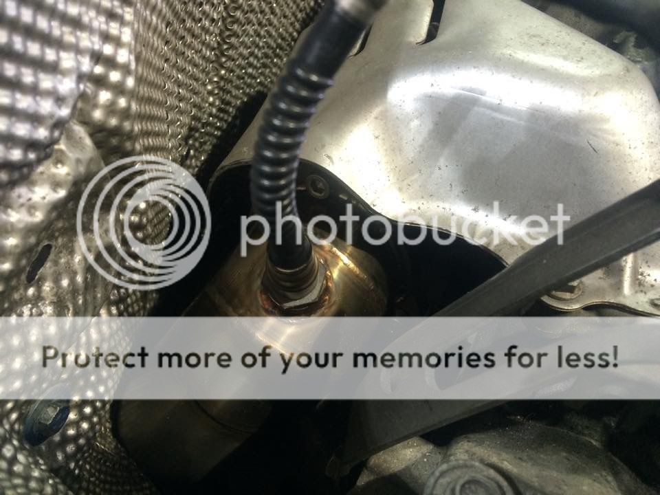

    hand booked oulton park for Tuesday the 4th but on last nights once over one of the manifold to turbo bolts has come loose and gone again, this is the 2nd time so going to try and get a nut on the other end this time. The exhaust has been blowing a touch ever since it was made, so we also removed the down pipe and discovered they don't quite mate up properly. Ste has addressed this today and a new gasket ordered hopefully back together before Tuesday.

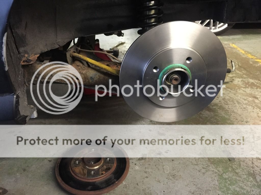

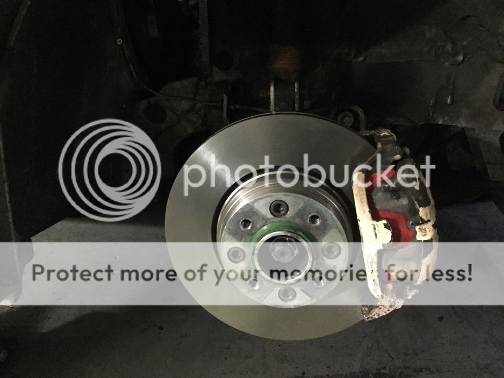

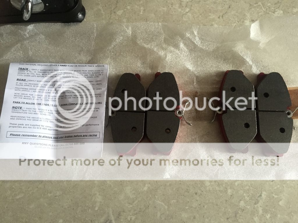

  8. did oulton park a few weeks back and car still behaving as it should, but brakes have been suffering stil.. Work for a few laps then too much heat and start fading away... about half 4 on the day I felt the rear end twitch a bit. jacked it up and the off side rear bearing had some play in so packed up for the day.
    I then set out to sort the brakes out, so this week have ordered a new set of brembo rear discs to sort the bearing issue out
    Next onto the fronts, I got a set of new brembo HC Discs up front, mine were juddering on the last track day and for the cost of new discs thought I may as well! fitted these and went for an upgrade in Brake Pads. After speaking with Ian he advised with the new power level the old pads were worn and had took a beating and recommended going for the next grade up, so ordered and fitted those.
    We are booked on Donington for Bank holiday Monday so shall see how the brakes go then. Will have to brake them in on track sadly as I cant use the car on the road. Will look at some ducting soon also, but these pads to require heat to keep them at their best so we shall see!
    Car is also booked in to have a remap at RS Tuning on the 26th of September, not sure what sort of power levels it will rise too but we shall see!

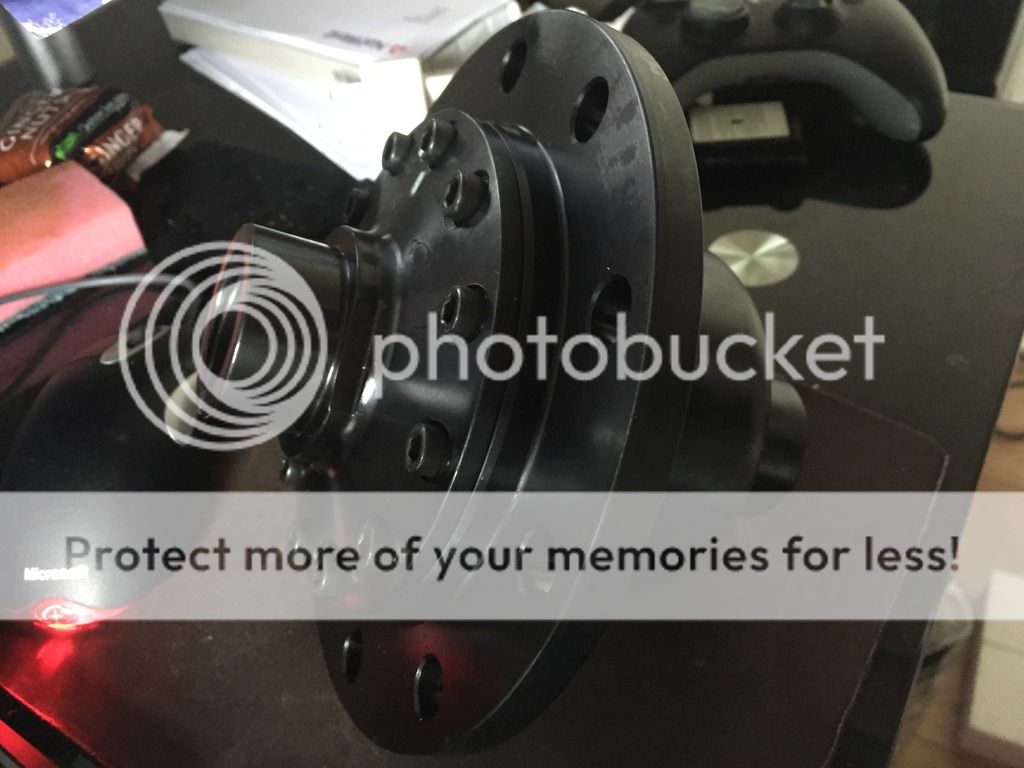

    Engine box coming out of the clio to have a gripper diff fitted and a full weld in roll cage is being fitted and a good general check from the past year, apart from some handling/braking issues the car has done better than expected!

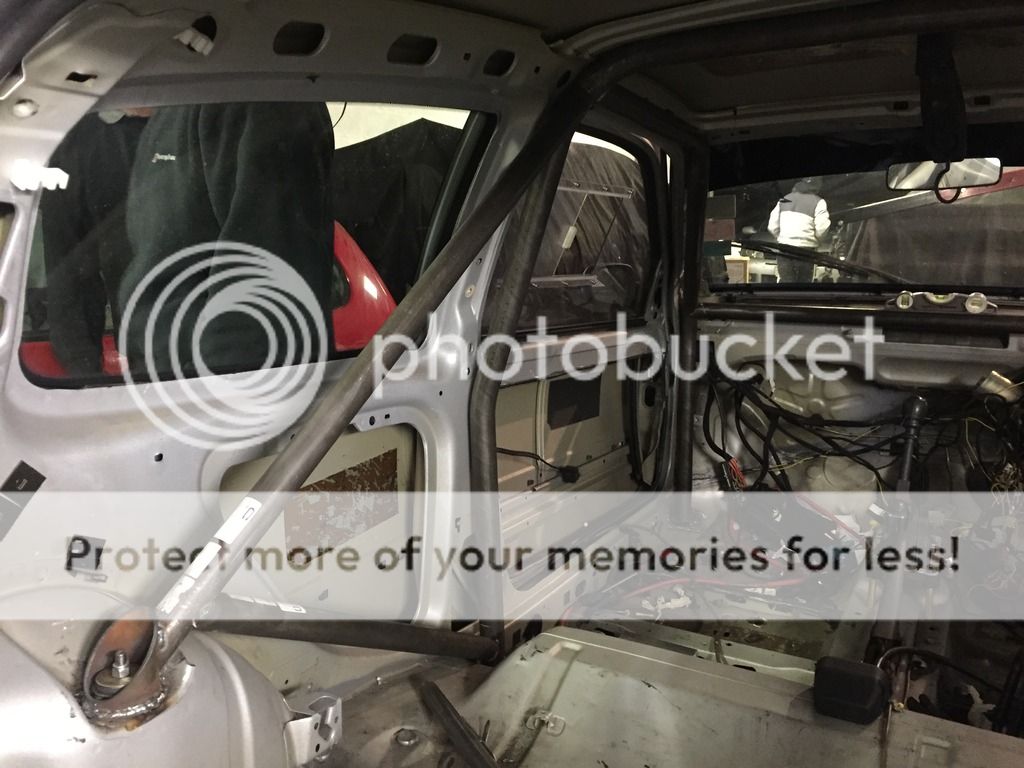

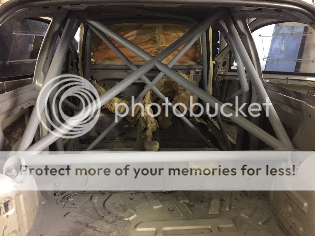

  23. winter update:

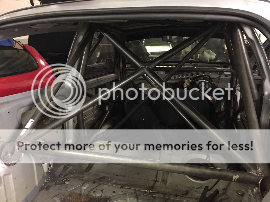

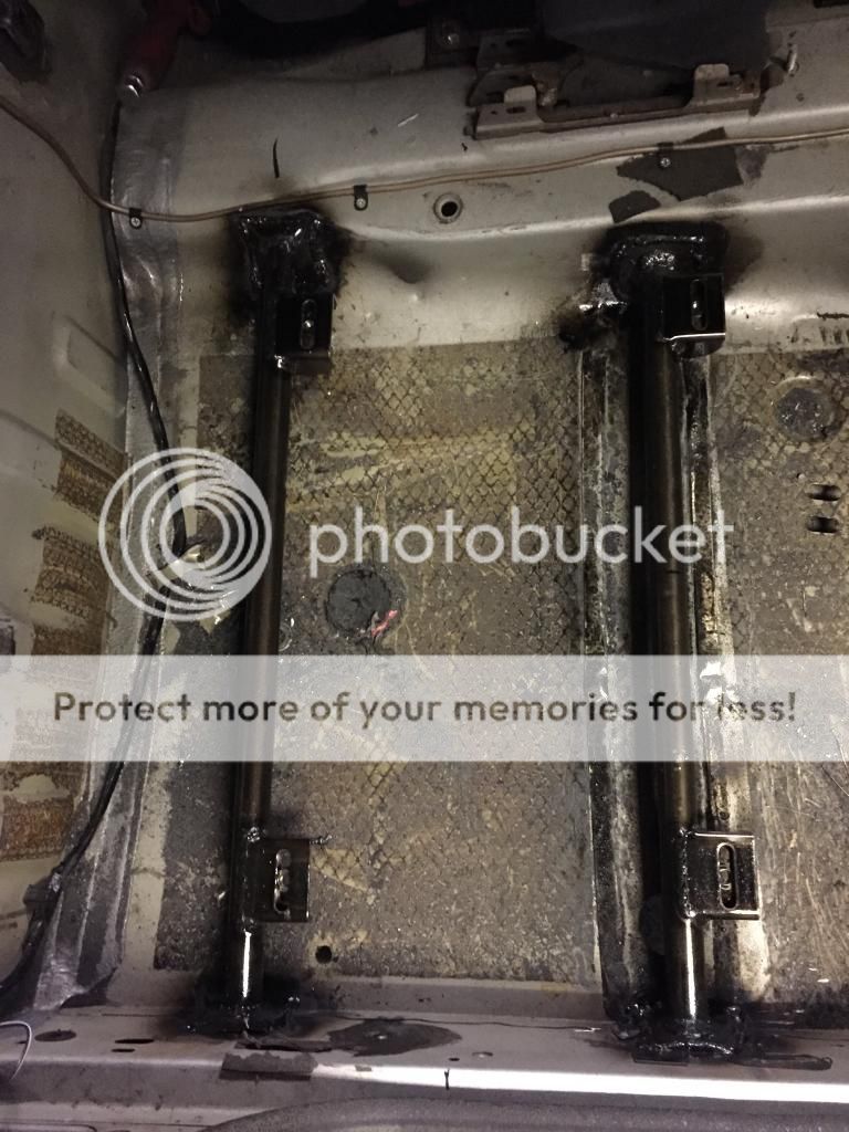

    over the winter we have removed engine and box to fit a gripper diff and give it all a check over after a year of track use. one of the rear engine mounts we have used has started to give in a bit so will be uprating that a bit and a CV boot has given in. but apart from that Gripper diff is in place in the gearbox and about to be all put back together next week
    We have also stripped the full car and fitted the roll cage, mammoth job and big thanks to Mr H for spending every Tuesday in the clio welding! a few more bits to finish off but 95%in and welded in!
    going to give it a quick freshen up inside and start bolting it all back together. hopefully back out in march some time

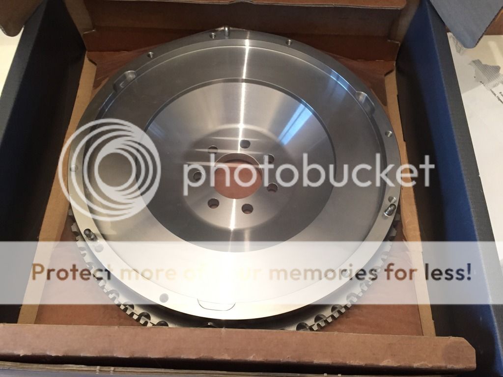

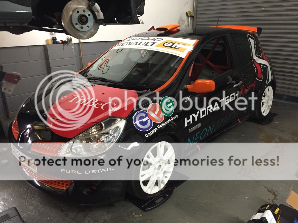

  24. R26R Clutch and Flywheel are here single mass!
    Also mate is cracking on with painting the inside and cage etc, this is todays progress
