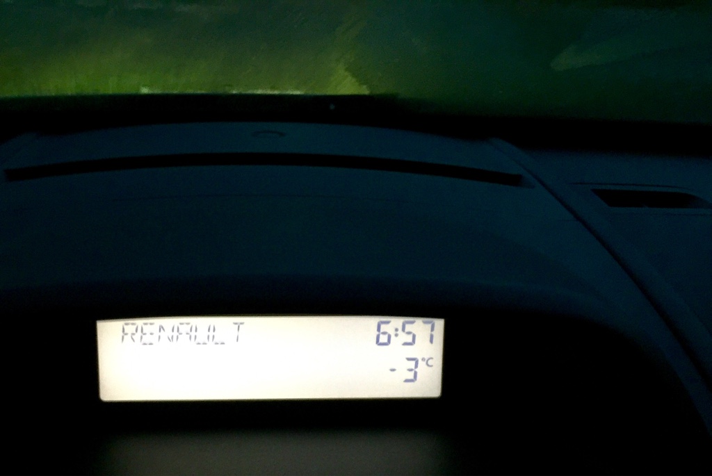

Decided to take the Megane to work today..... would appear that winter has arrived in Aberdeenshire Sent from my iPhone using Tapatalk

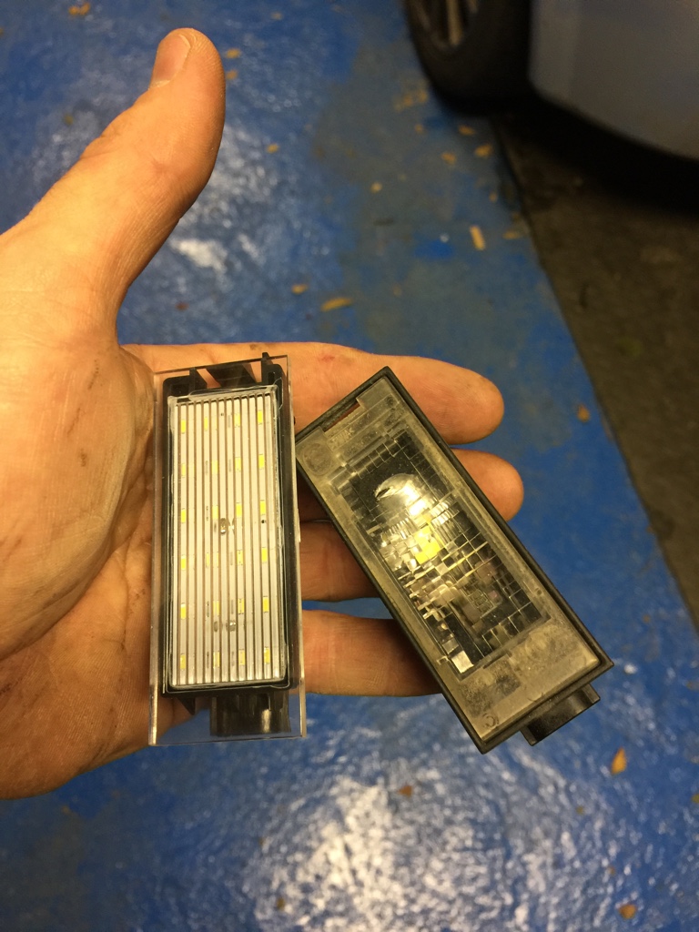

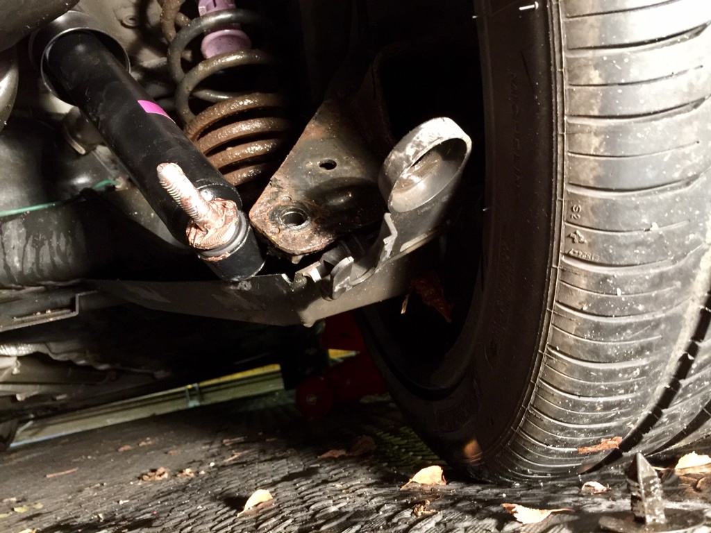

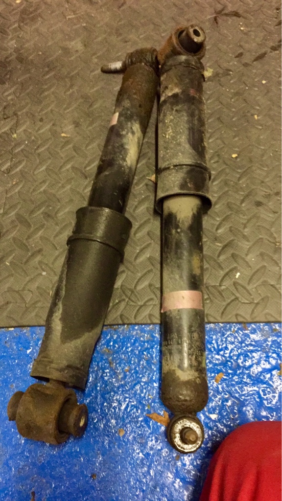

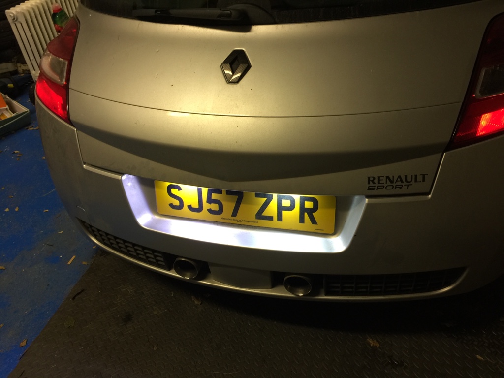

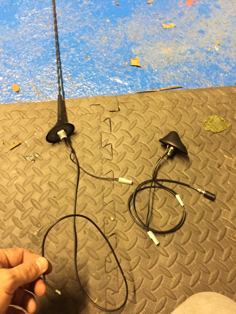

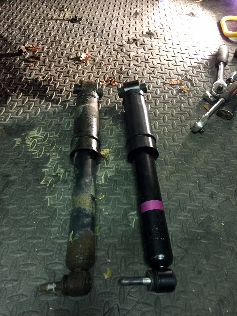

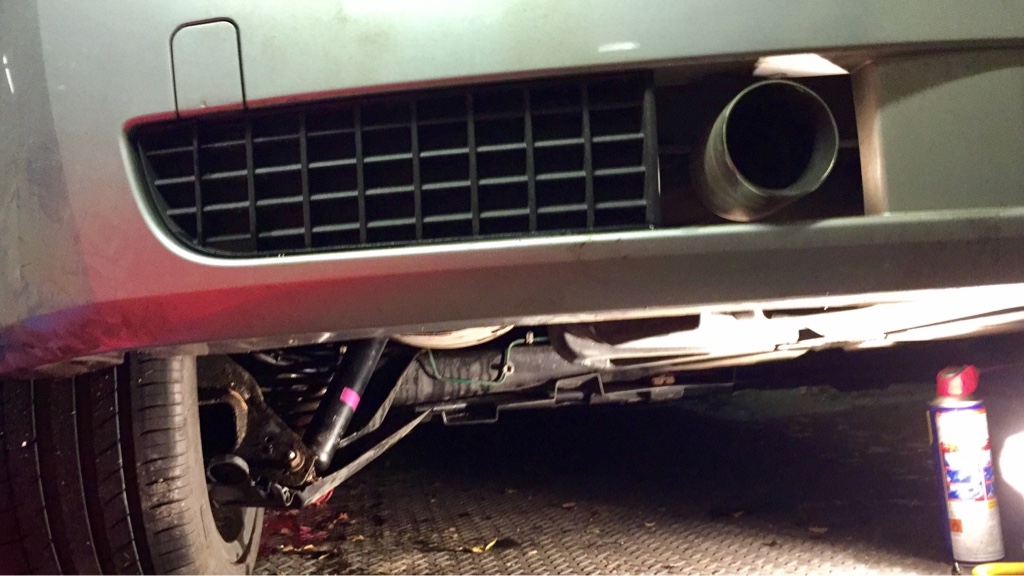

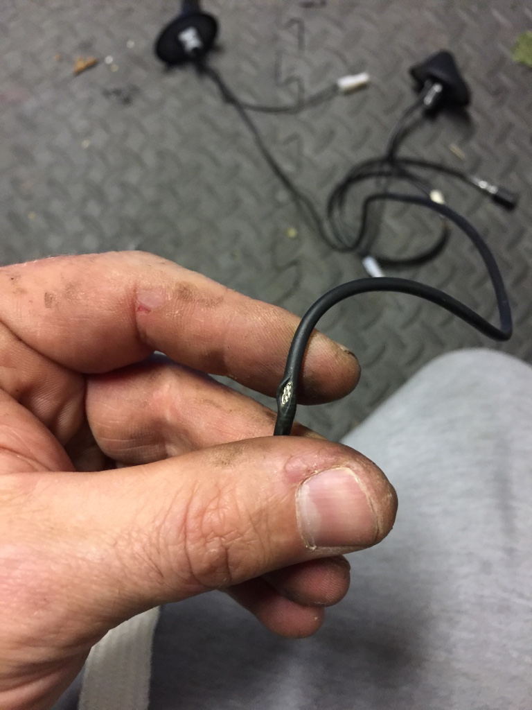

With a spare weekend on my hands, mrs working until late and only the internet for company... to help preserve my eyesight, I thought I'd tackle some of the minor maintenance issues that have been piling up... This update is therefore a mix of both 'wear and tear' and 'preferential' engineering. FIRST JOB- New rear shock absorbers. Been noticing the old ones are providing a less than reassuring 'thud' going over any rough ground... a quick call to RENAULT PARTS DIRECT and Paul had sorted me with 2(of) new rear cup struts. An overnight soaking of WD40 made this easy... All replaced and ready for the bin... SECOND JOB- Radio Reception I don't listen to the radio (at all), it's Spotify all the way via the apple carplay app... that is until that one day you forget your phone.. Radio reception was TERRIBLE. RPD again to the rescue with a new amplified antennae base. Old and new With the possible reason for failure..? This job is a real, REAL PITA... limited access and the fear of creasing the roof liner... along with the wiring clipped into place... takes time to do properly. For anyone tackling this job it's a 22mm nut that holds the aerial in position. Also note that there's a channel within the nut that holds the cable in place, hence only one way it can be re-assembled. I also taped the new base to the roof to aid getting the nut started on its thread.. THIRD JOB - Installing new number plate lights... existing LEDs would only last around 2-3months.... Tomorrow, gearbox work and HID replacement . Sent from my iPhone using Tapatalk

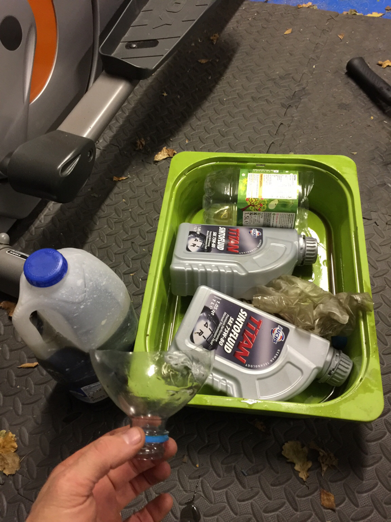

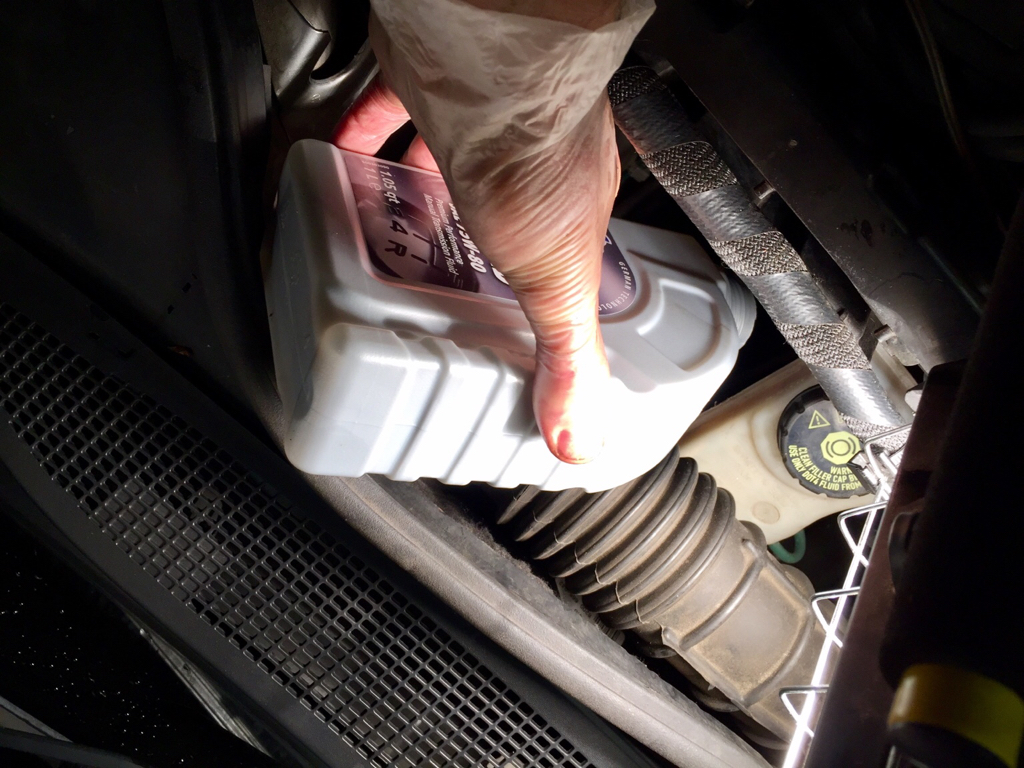

Today first up is an HID bulbs' replacement Both OEM HID bulbs still work... I just wasn't overly impressed with the light outputted from them. I'm still undecided on the (Moot) point over the degradation / ageing affect of HIDs with time.. I reasoned that the 9yrs old existing items, I've had my monies worth and they've served their purpose. A couple of OSRAM XENARC 5K D1S bulbs from HIDS-DIRECT to replace.. Bumper off... New bulbs in... Feedback is that they appear to be a LOT brighter and the Visibility on country roads is improved. Without a LUX meter, I have no scientific basis for this claim so you'll just have to take my word on it. I also replaced a failed LED sidelight at the same time. Next up- Short Shift Install Had this lying around for ages... today's the day for fitting (Andrew Jeffs / boardy do a great guide on this replacement), while I had direct (and easy) access to the gearbox, I did a quick gear oil fluid change to freshen things up... It's a 10mm Allen key to remove the gear oil drain plug. OPIE OILS obliged with some Fuchs Titan Sintofluid 75W-80. A quick funnel from a diluting drinks bottle and the new fluid was much easier to pour in rather than via the 'recommended' fill point. The throw with the short shifter is a HUGE improvement over standard. Can 100% recommend this to anyone with a 225 As the car stands today, all engine / brake / gearbox fluids have been replaced in the last 1K miles, belts have been changed in the last 2K miles and everything back to 100% working order Sent from my iPhone using Tapatalk

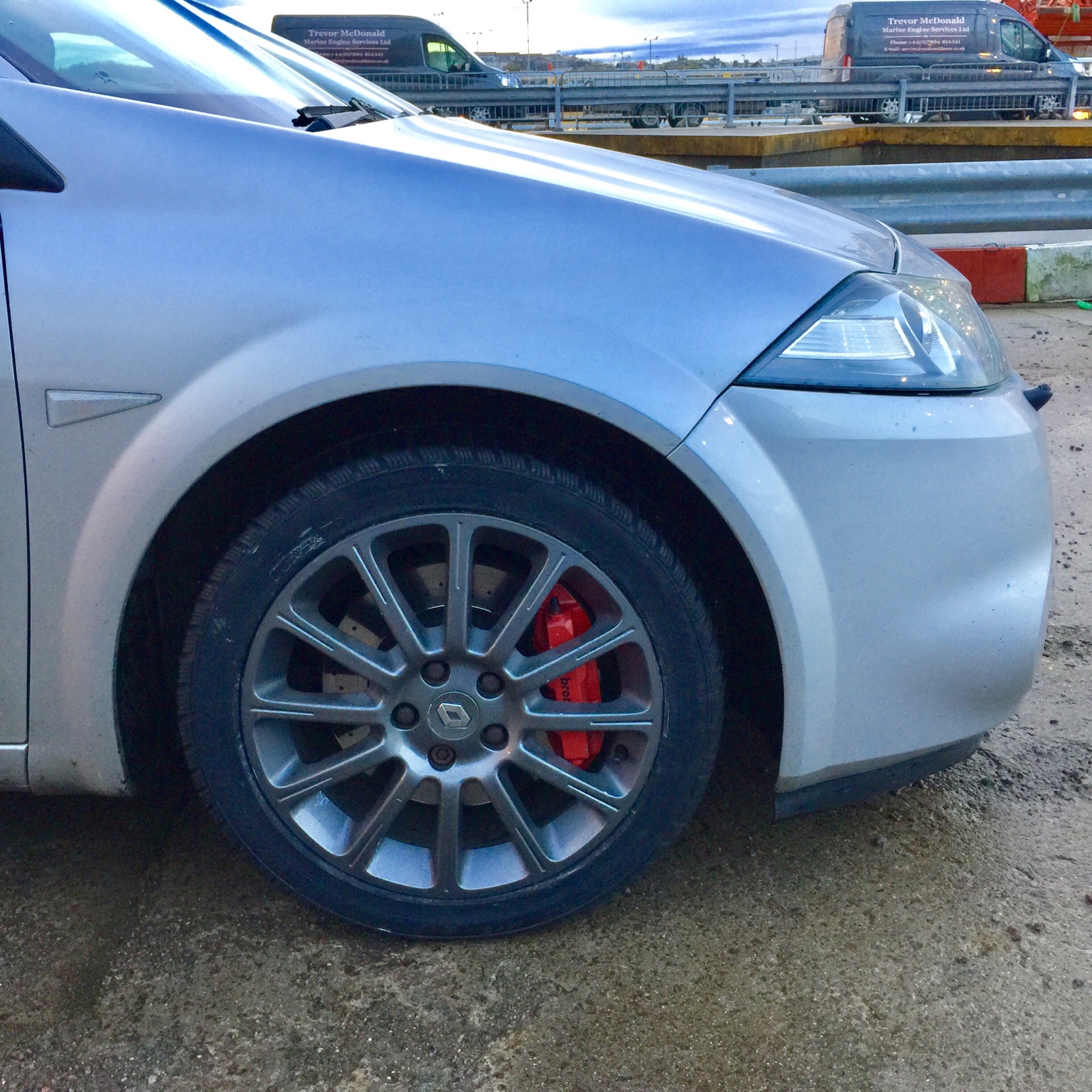

Picked up a set of second hand 17" Clio 197 wheels to fit the winter boots on. Cooper Weathermaster Snow. Awesome in the white stuff... with the gauge at -5 degrees C yesterday.. ready just in time! Sent from my iPhone using Tapatalk
